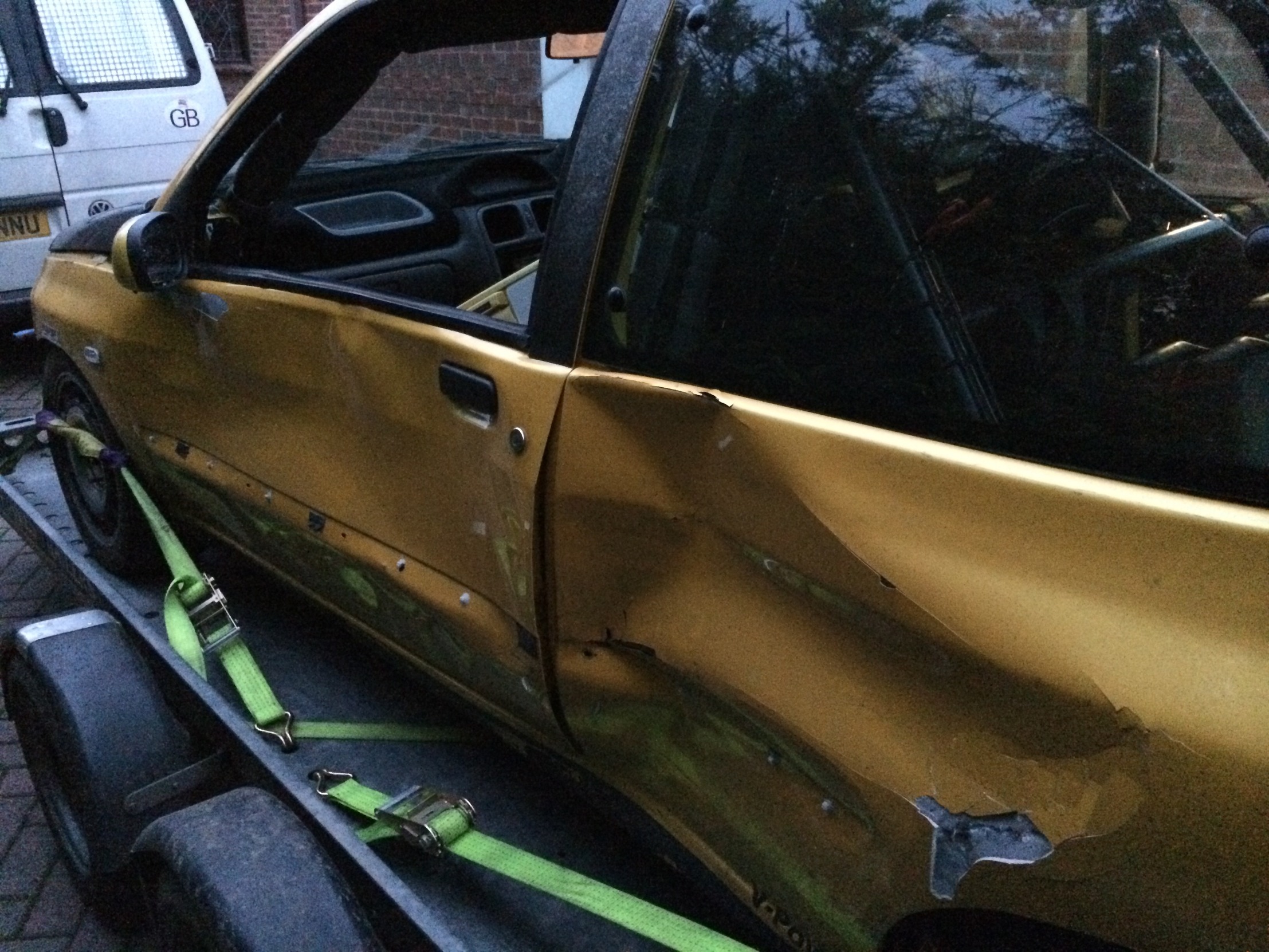

PLANNING? I do that already
As much as I wish that were true, I haven't got the bottle to do that sort of driving, nor the money for fines and replacement parts haha
I had more bottle than talent at cadwell on thursday, I wouldnt recommend it, lol.
