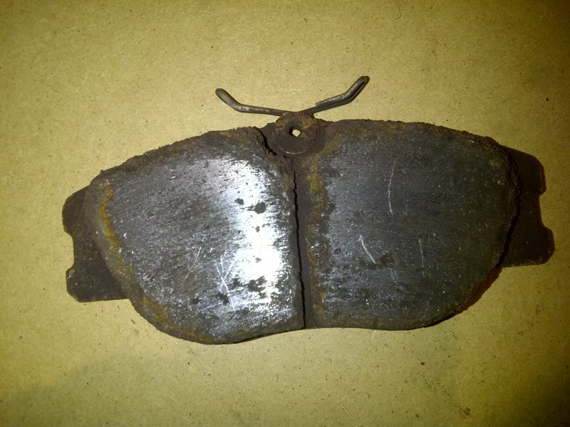

i'll post some pics tomorrow of what happens to the pads if you dont grind the back plates down/leave the shims in - whatever way you want to do it

here's the pic
as you can see the edges of the braking material has disintergrated completey (you can crumble the material off with your fingers)
i had to use a hammer to get those pads out of the carrier, they should lift out with just your fingers
