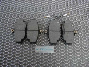

If you remove the shims, they fit straight in ...
still too tight though, you need to file the paint off or they will stick as soon as they get hot
Odd, i havent noticed that with any of the sets ive fitted. Mind you, thats only 5 sets, you've probably done hundreds lol
Must be the luck of the draw ...
what are the symptoms if they do?
I dont use my car for tracks, so what you recommend then? also if i filed them to give a tolerance whould they be ok?
Whats peoples thought on Greenstuff?
Odds are they'll stick when hot. People don't grind them down for the fun of it!
JS_182. If you just using the car on the road then use the OE pads, they are the best ones for what you need.
