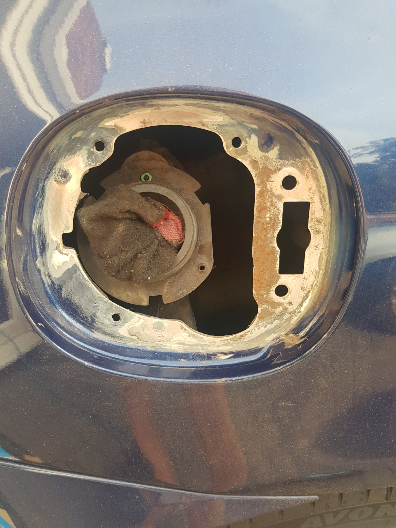

Finally got around to starting the fix on my filler flap rust.
So i started by drilling the 3 rivets off to get rid of the plastic cover.
Drilled the bottom bolt of the flap out and half of the top bolt so I can leave the flap on for now as it's going dark so I'll continue tomorow after work.
The rust behind the plastic I was expecting isn't bad at all which I'm happy about, seen much worse on the thread of the petrol blue 182 but I'll rub that bit down and paint anyway.
The bit behind the flap is a different story though, the metal is mega thin now, but hopefully I've caught it just in time.
So tomorow plan, drill rest of the top bolt out and start rubbing down.
Clean the rear and rub down and just stick a big thick layer of hammerite on as it's out of sight.
Prime paint and clear coat the main side, again doesn't need to be perfect so I'll be using a rattle can.
Assuming m5 stainless nut and bolt will be best for fixing it back on, assume I can get them at toolstatiom?
My main worry is what I'm going to fix the plastic bit back on with.
I don't own a rivet gun so I'm wondering what's best to use to get that back on?

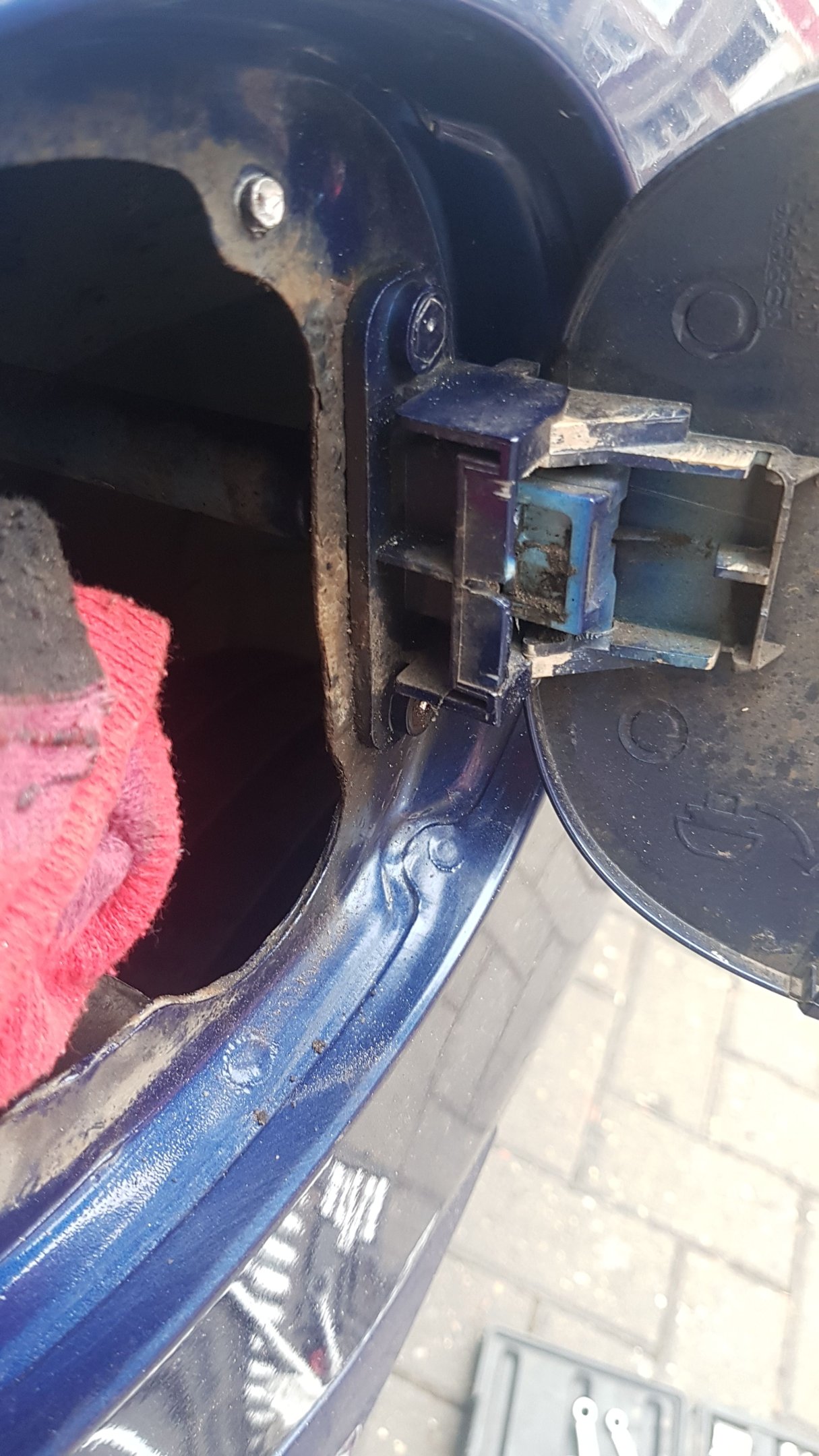

Get it while you can mate, I have been putting it off for 2 years and now the metal is wafer thin where the flap bolts on
The metal on the left is still solid so it shows how much has rusted away

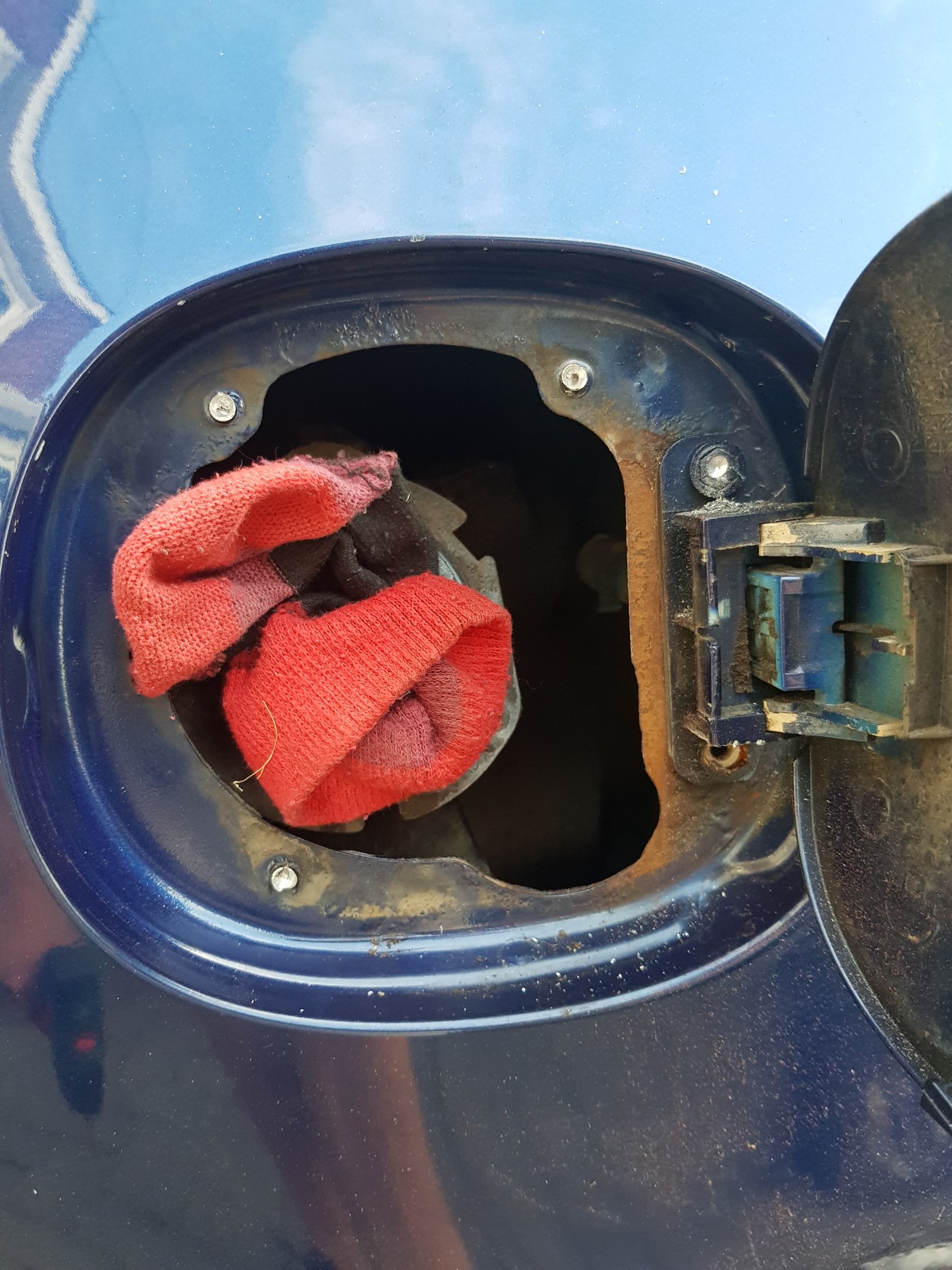

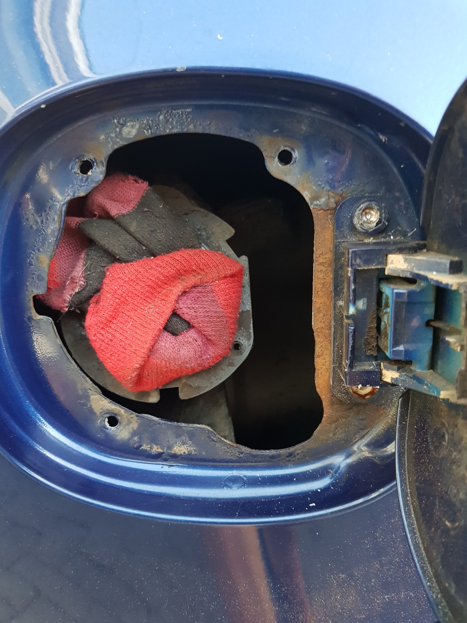

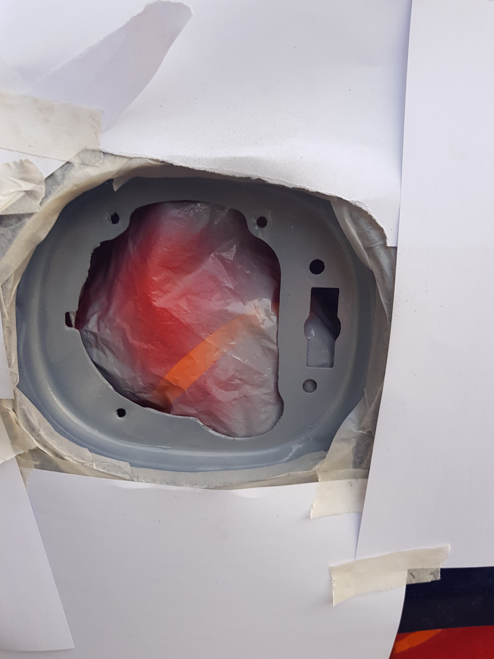

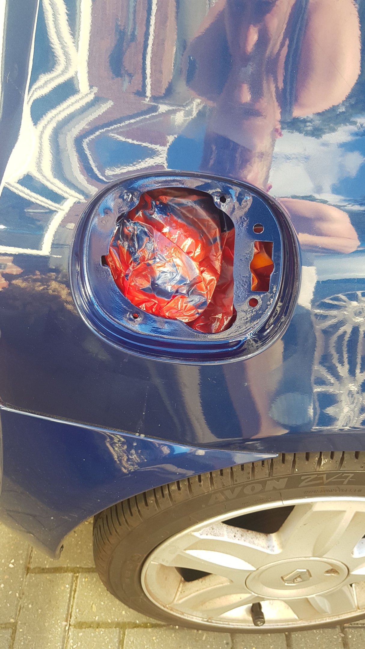

Well, this is as far as I am up to now.
I could find anything local other than kurust so after sanding down I put some of that on and allowed to dry before priming.
Metal is mega thin at the flap side but hopefully I got it just in time.
Hard bit tomorow, getting the colour on and hoping the rattle can I bought blends in ok.

So, I'm not trying to burst your bubble but... with all the brown rust you have left in there it will be only a matter of weeks before the rust bubbles through again. Only way the make it last a while is to wire wheel as much as you possibly can out. Then use your rust convertor. Not much point in a zinc rich primer as it won't do much. Straight on with etch and then primer.
Only way to fully sort it is to weld a new fuel filler neck panel in, but then 1/4 would need painting. Other than than your going the right way about it.
The bolts you want are called button head bolts, either torx or Allen key
  dan's cast offs.
Yup, the rust is going to come back through.
For paints or treatments as a rule anything that forst sell is good, especially por15 stuff.
Don't be afraid to use a good wheel acid to get rid of dust as well. Rinse it with vicar mixed in water to neutralise it fully.

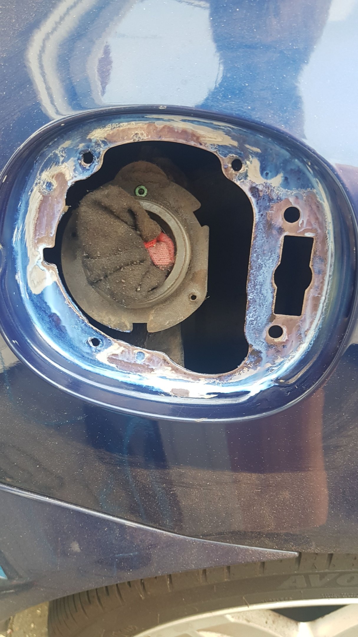

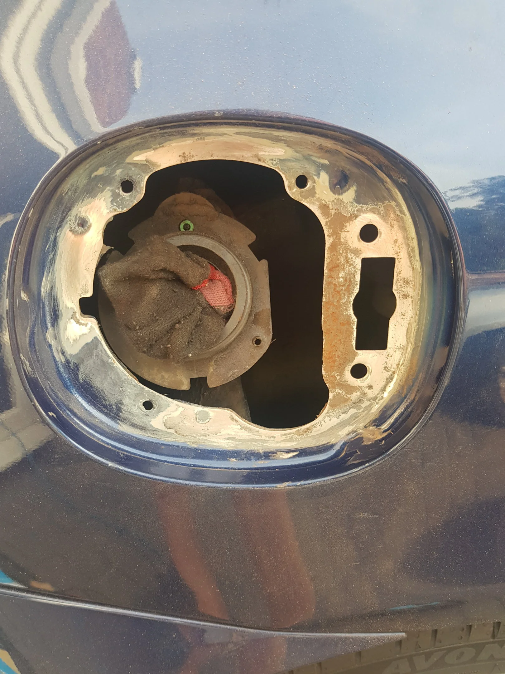

Looks... rusty lol.
Lol, I stripped the primer back from the first pics and had the drill and wire brush attachment on it for about half an hour but it was going nowhere so re treated it and primed again.
It turned quite black and solid so hopefully converted alot of it.

Hmm we'll see how long it takes to bubble through again, I just keep an eye on it.
I've been wondering, would fibreglass and resin be a good solution to thickening the panel back up?
Mine must have lost more than half it's thickness to the rust and thought about using resin and fibreglass to thicken it up, and it would seal the existing metal?
Or is that a really bad idea?
1985michael182
I wouldn't as if water gets between the glass and steel it cant get out so it will rust it's way out. Black wax oil the rear of the panel, but remove any lose crap first. Could also put clear wax oil between any matting faces to reduce water sitting behind your fuel flat base and the filler neck.
