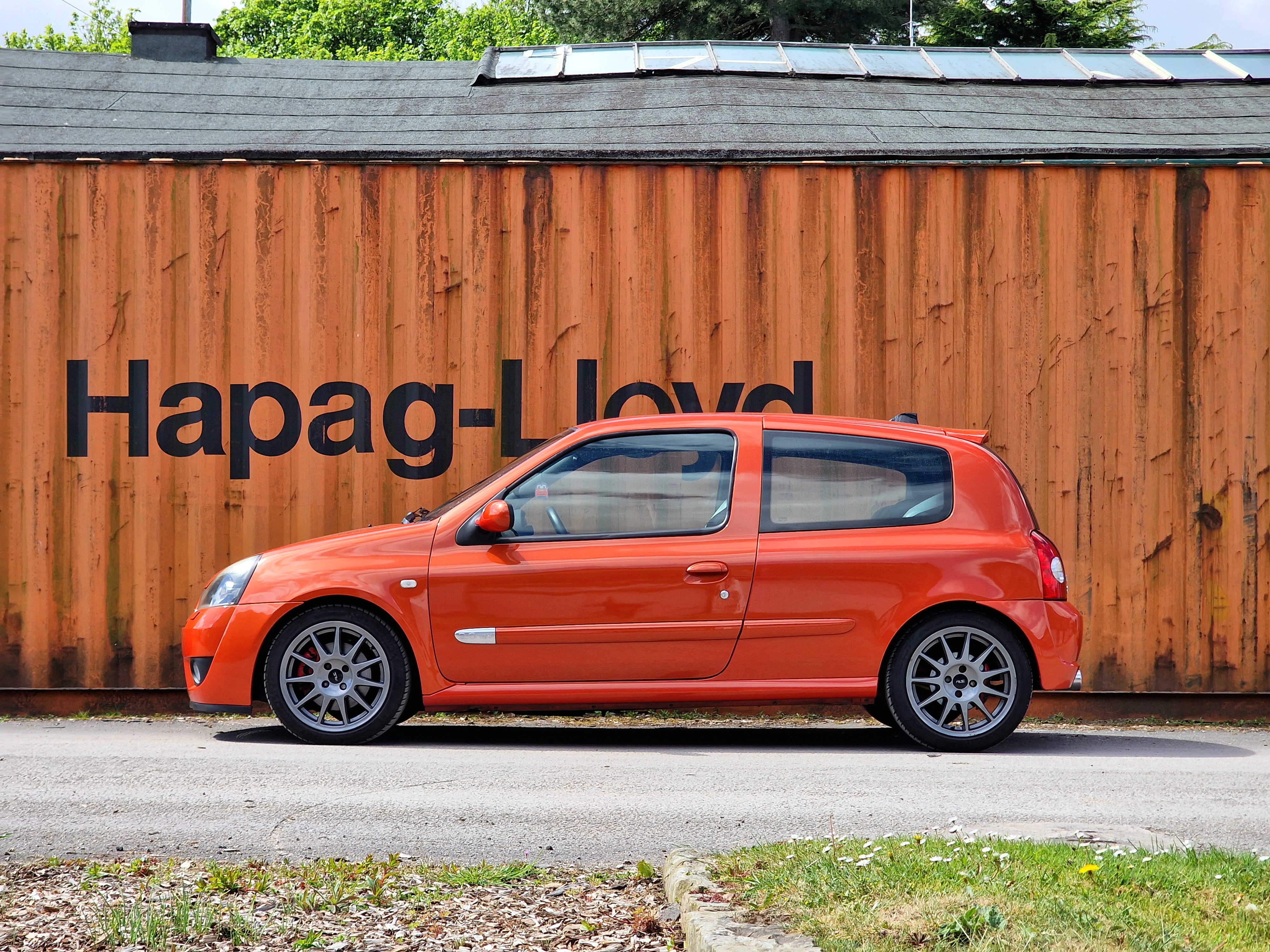

Been meaning to start a build thread for just over a year, coincidentally that's also how long I've owned my Clio having bought it May 2024.
Previously had a Twingo RS with a bunch of modifications which was great. It was set up mint and cornered spot on but wanted felt like it needed more power when on track, I looked at doing the F4r engine swap like a lot have done in the past and I was so unsure on which direction to go as the Twingo had a good amount of money spent on it. It had a fully redone front end including powdercoated subframe, full powerflex bushings on all steering components, camber bolts, PMS Solid top mounts & strut brace, Evol engineering dogbone mount, a modified scorpion exhaust, plus bucket seats with a rear seat delete and a rear brace bar. But after alot of pondering I decided why not just get a Clio and then I can build a new car, so that's what happened.
I spent quite a while looking for the right one and ended up buying my Clio from chesterfield with just under 100k miles on the clock. While doing my research on it, it turned out to have an interesting past having lived in the isle of man for many years being confirmed by the seller after it was missing a lot of MOT history.
When I bought it, it definitely wasn't perfect. It rubbed horribly as it was fitted with 17" Turinis, needed belts doing, had no ac, had a coolant leak and the paintwork wasn't and still isn't perfect but I don't mind a project, I actually wanted one to make it mine and gives me something to learn on.
Photo from the day I bought it. With my mates Clio 197 F1 Edition which has had a Meglio swap done to it.
I instantly swapped my 16" genuine Clio turinis on to it, off of the Twingo
After a year of ownership it doesn't look too different to when I bought it but its had quite a bit of work done

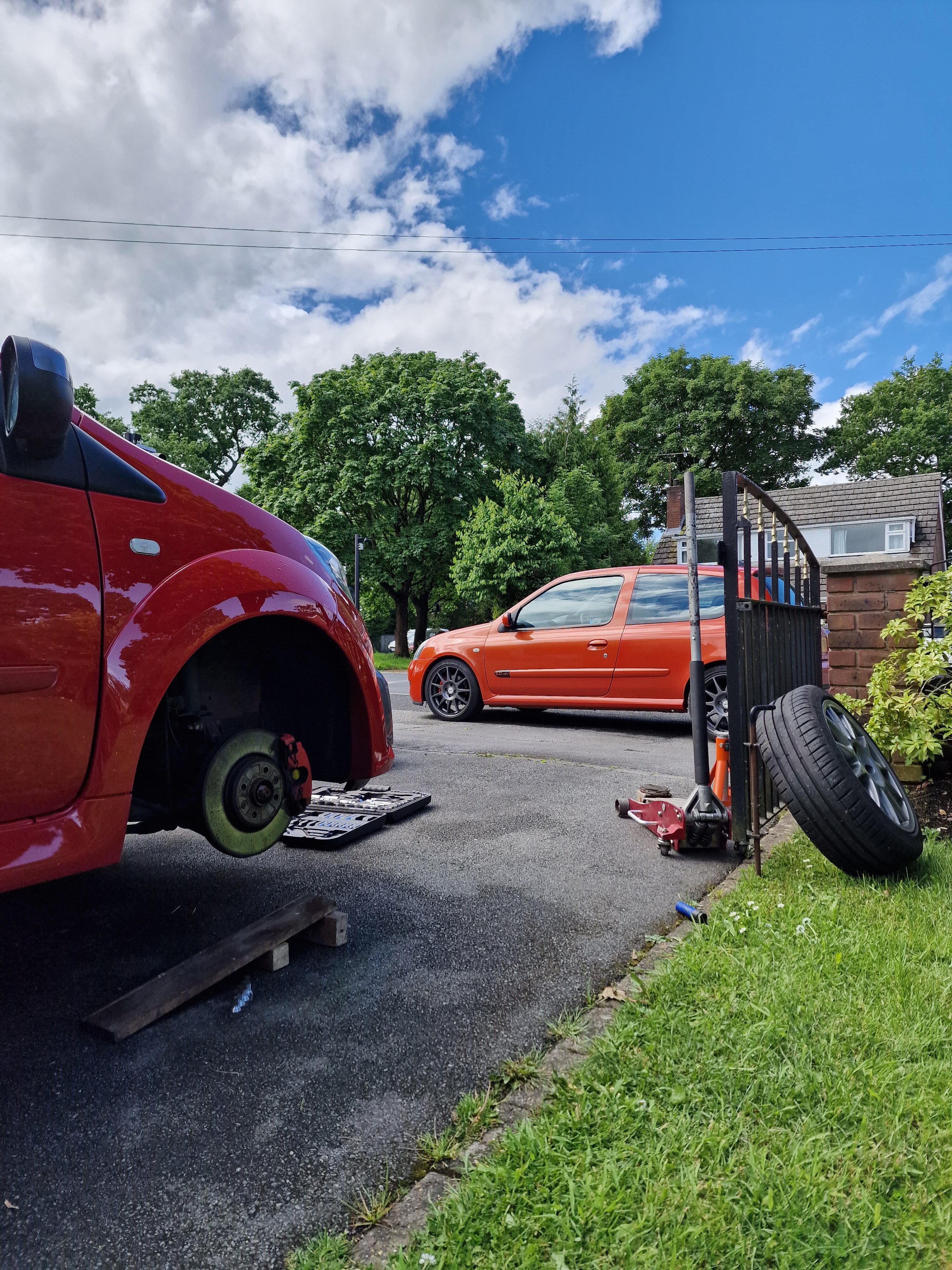

Since owning the car the list of work I've done includes:
  • Swapped my 16" genuine Clio turinis on, off of the Twingo
  • Serviced
  • Fixed the leaky exhaust
  • New cambelt, dephasher, solenoid etc @ Birchdown (The lads at Birchdown are legends!)
  • New radiator, power steering pump & full ac setup replaced @Birchdown (fitted at the same time)
  • New front & rear badges and door bullets back to own (Wasn't a fan of the black badges)
  • Stopped it leaking from the boot and dried out the interior after the scuttle panel blocked up and the interior became a pond (including fixing the blockage in the scuttle panel so it doesn't happen again)
  • Fitted Powerflex Suspension bushes
  • Replaced inner tie rods, track rod ends & boots
  • Powerflex Camber bolts fitted
  • Alignment @ Demon Tweeks
  • Fitted Recaro trendlines seats
  • New alternator fitted
  • Cleaned up the front seatbelts with the pressure washer
  • Plus a bunch of other bits I've probably forgotten

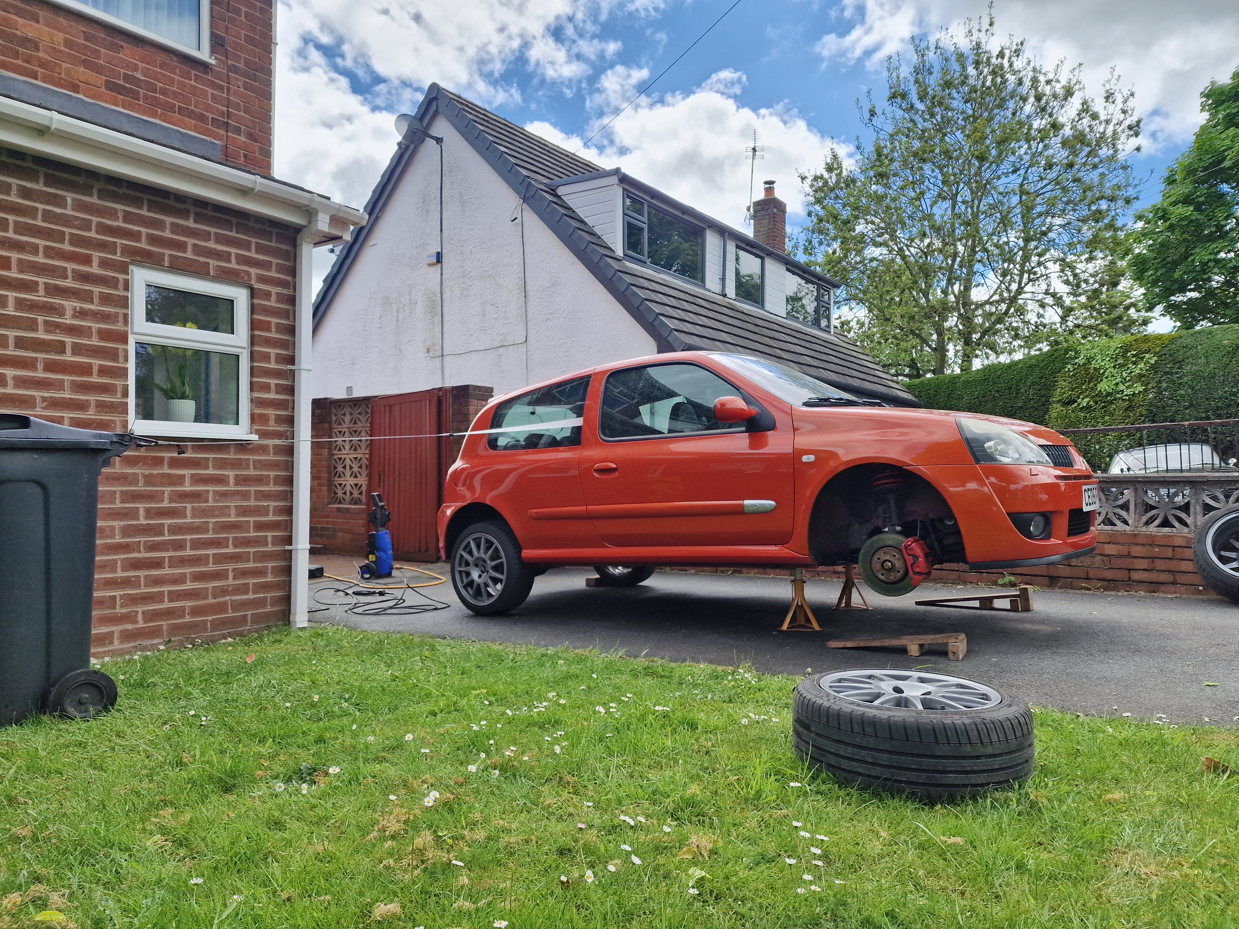

Cleaning up the seatbelts and a bit of maintenance

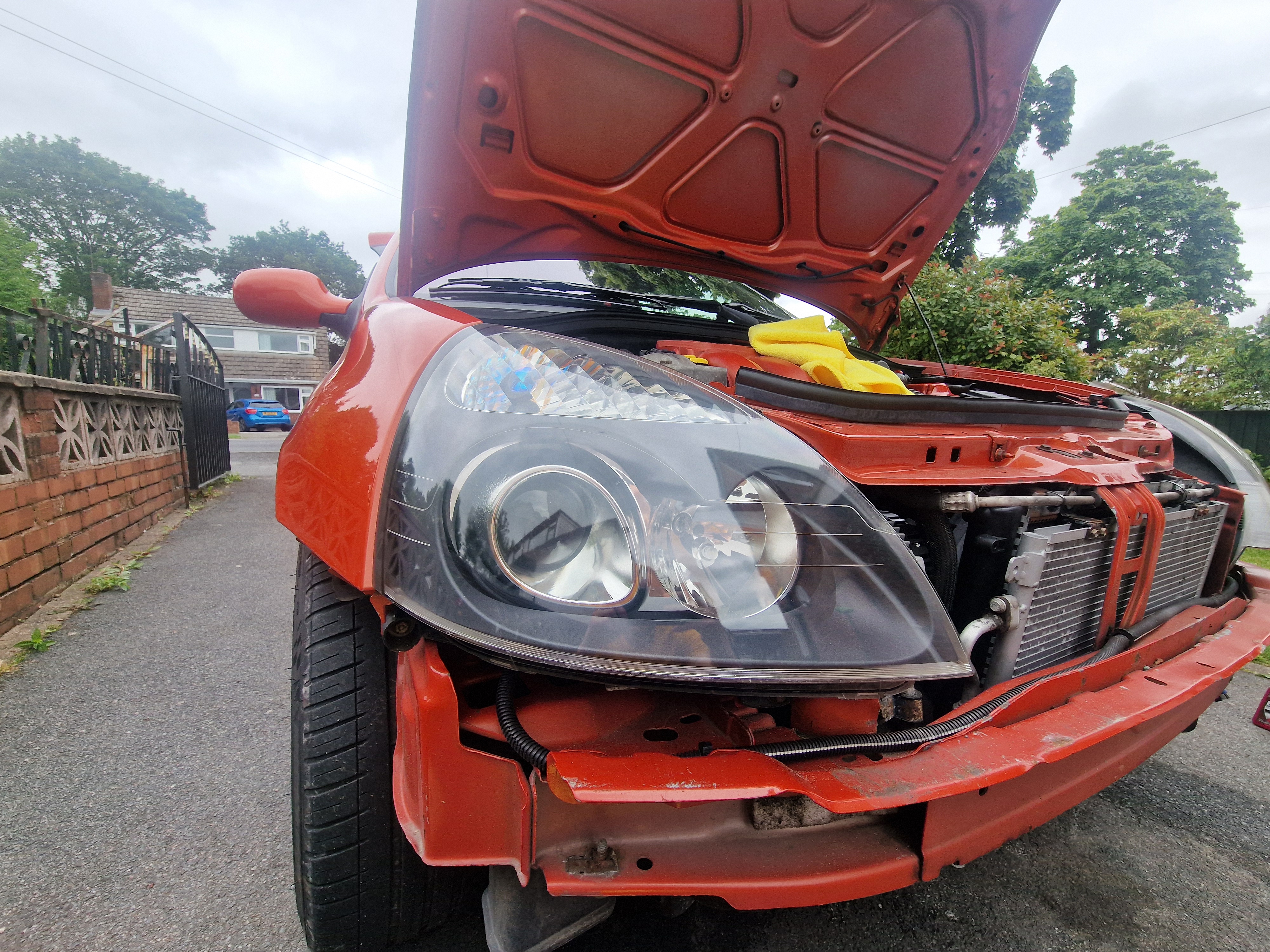

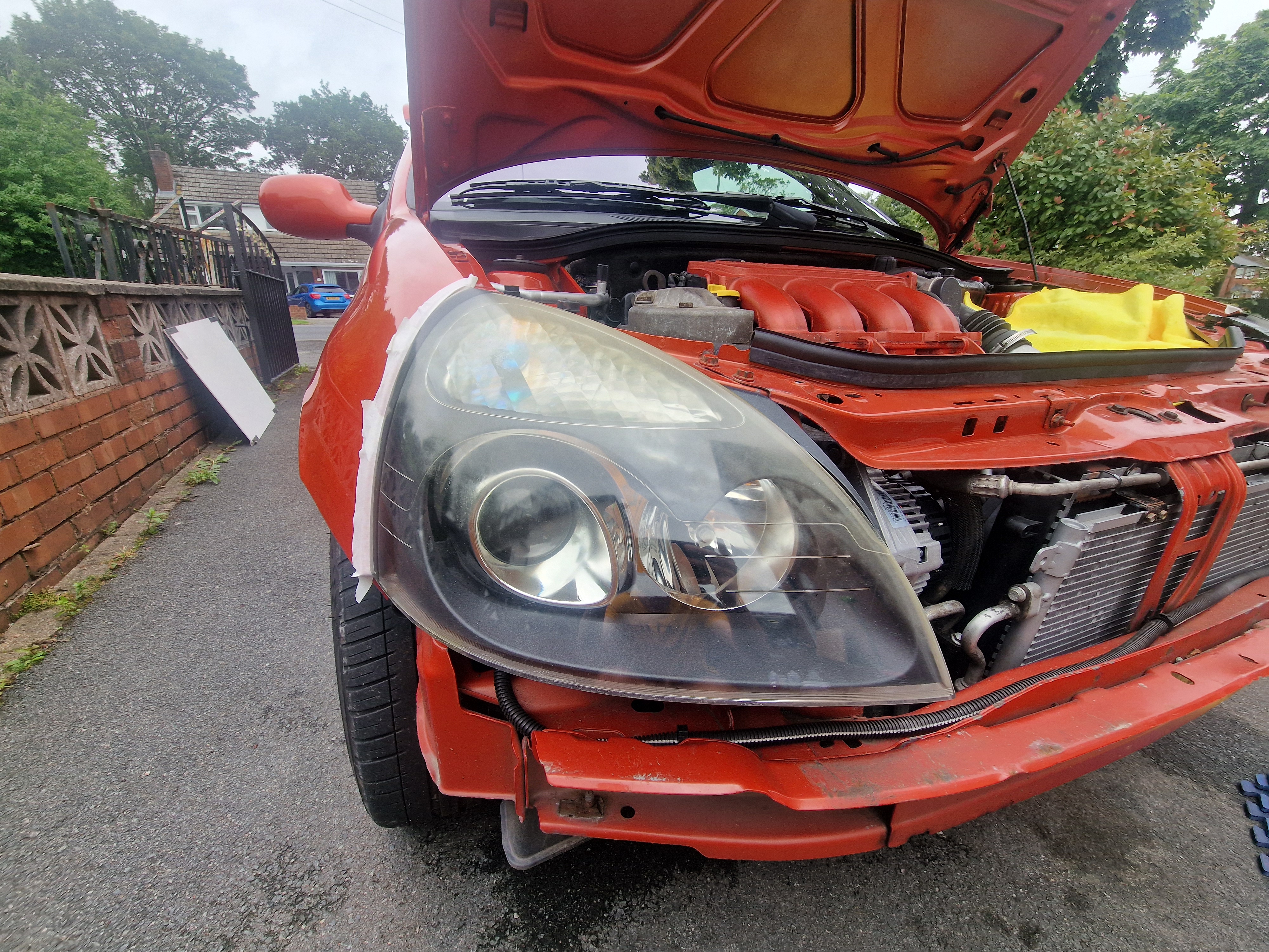

  • Polished Headlights
    • The headlights had some yellowing on them but I'd never tried to rectify this on a car I've owned so I was putting the job off. Originally I planned on using wet and dry paper before polishing but decided to give them a once over with a polisher, some menzerna 400 and then meguiars ultra finishing polish as a first try and if it didn't work I would get the wet and dry out. Luckily they came up great just using the polish and they are now really clear. I applied some fusso wax and sealant afterwards to them to give them some protection. I'm really pleased with how they came out and now knowing how simple it is to do I should have done them way sooner!

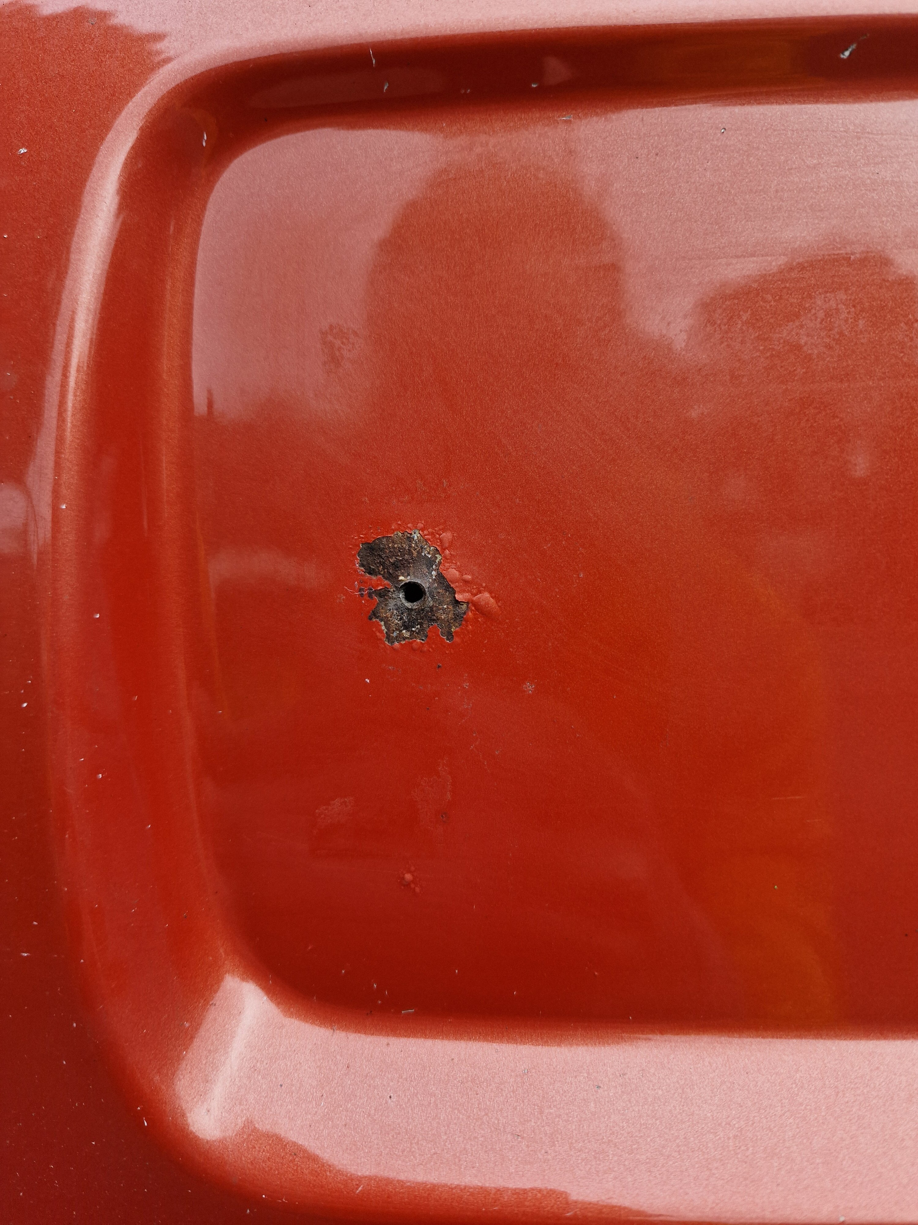

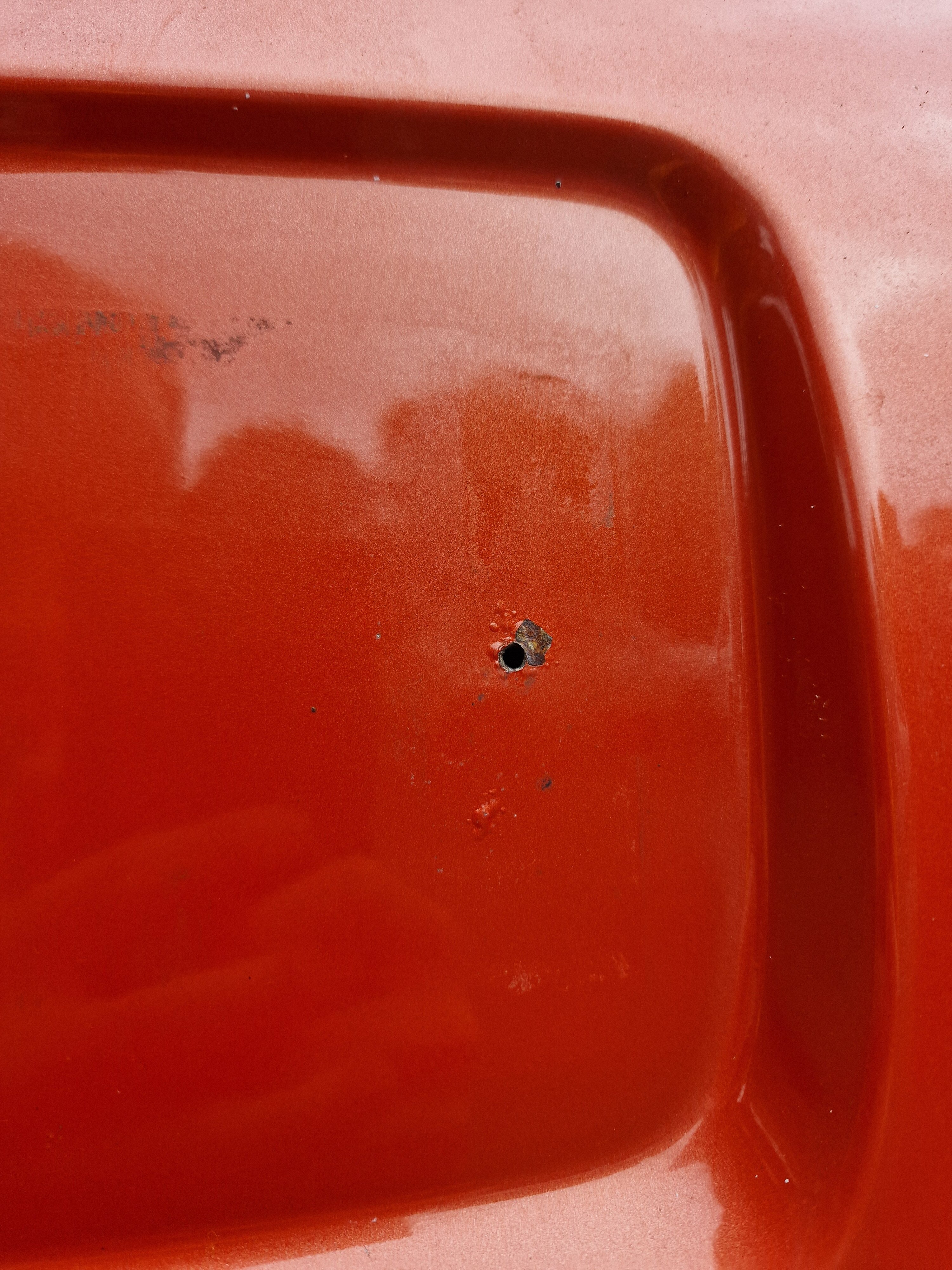

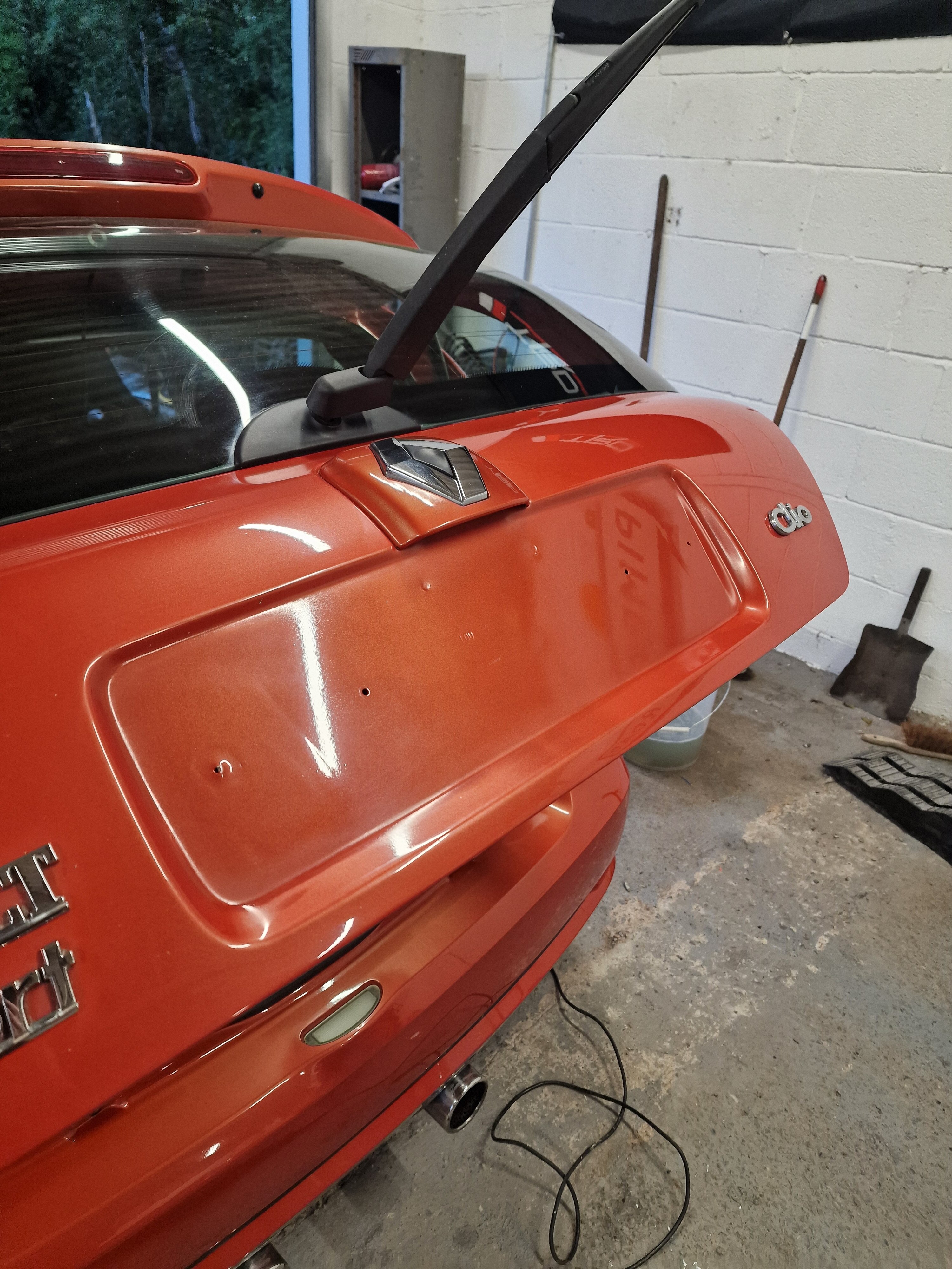

  • Removed some rust from behind the rear number plate
    • I found some surface rust bubbles when going to fit the new rear number plate. So as a temporary fix I sanded it back to clean up all the rust and then got some colour matched spray cans and gave it a quick paint. Used a 2k primer, the colour matched spray paint and then a clear lacquer. The lacquer didn't come up very well and I didn't blend it all perfectly but it was again my first time doing it so I got out the polisher and managed to bring the clear coat up really nicely. It's definitely not perfect but as a first try I think it went well and the boot needs a full repaint anyway as it has a bunch of scratches on it so I will do that properly at some point.
Some photos of the rust
The finished paint job

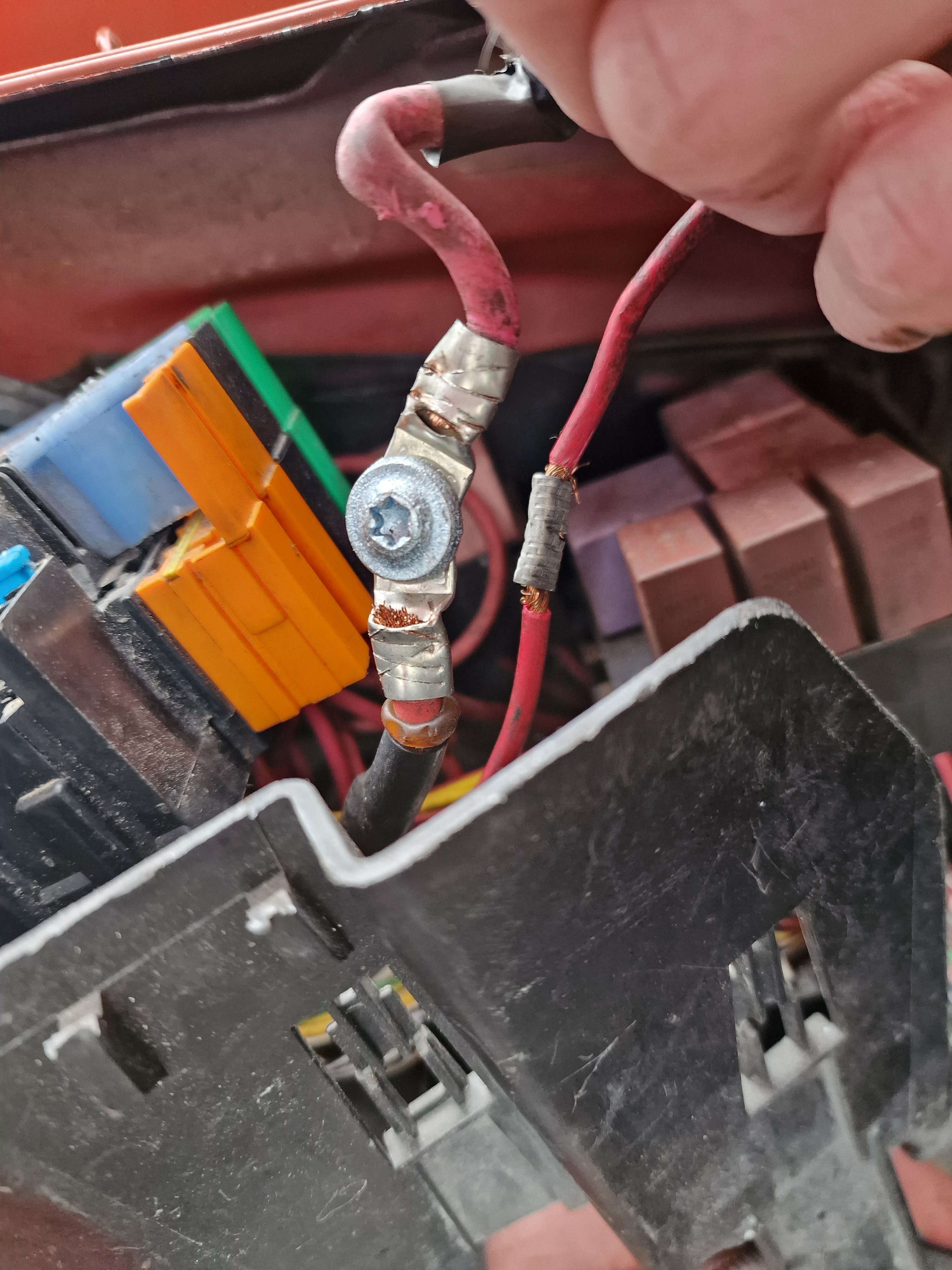

  • Tidied up the fuse box so the lid could close and found a bunch of bodges (this is in preparation for the battery cover I will be fitting soon)
    • Ever since buying the clio the fuse box lid hasn't closed properly and so I took some time to figure out why. It turns out the positive cables from the battery to the fuse box have previously been cut and re-joined which was pushing the fuses up stopping the lid from closing. I tidied them up with new tape and properly separated them which allowed the fuses to clip in properly and the lid to close. I'm in 2 minds about fixing it as I want to fix it so its done properly but I'm scared of the french electrics. So I'm thinking do I just leave it as it works. Any advice would be appreciated.
Photos of the bodges

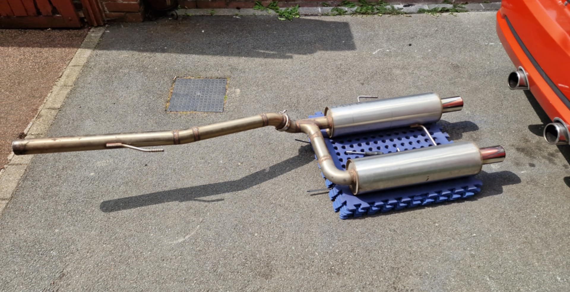

In the meantime I've bought more parts to fit. Been and picked up a CGR exhaust from @paul806 to replace the ktec system currently on the car. Will be test fitting it soon will try and remember to get a before and after video. Need to order some new exhaust hangers before I fit it.

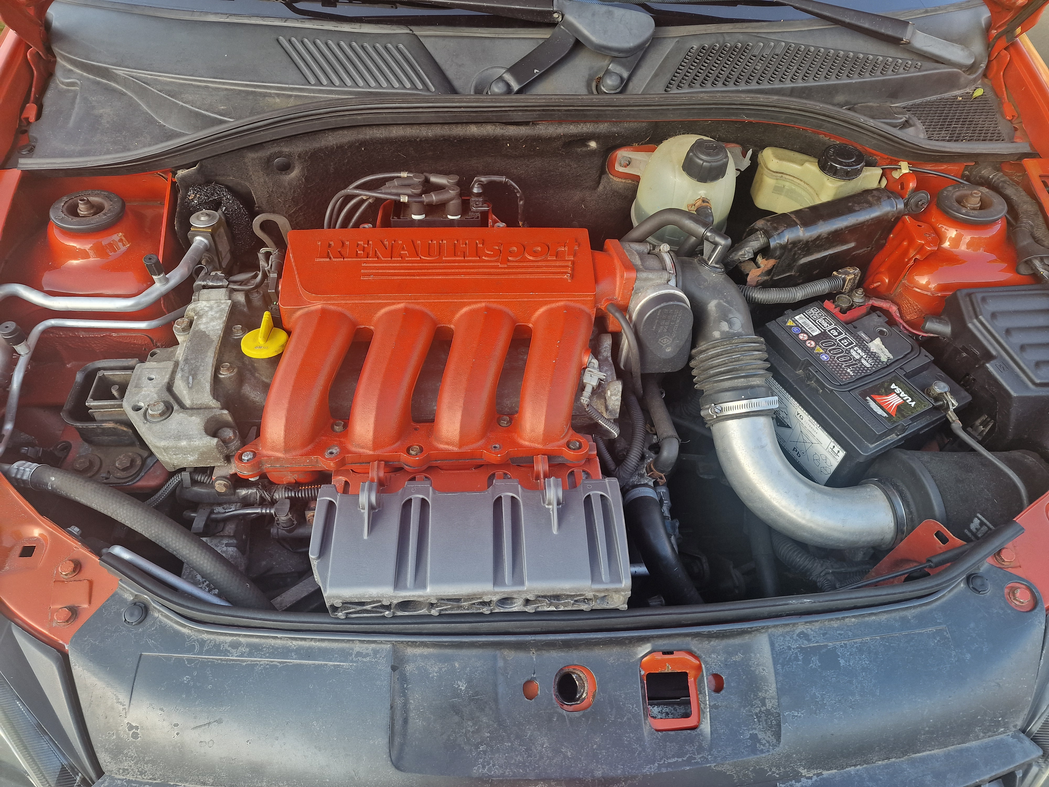

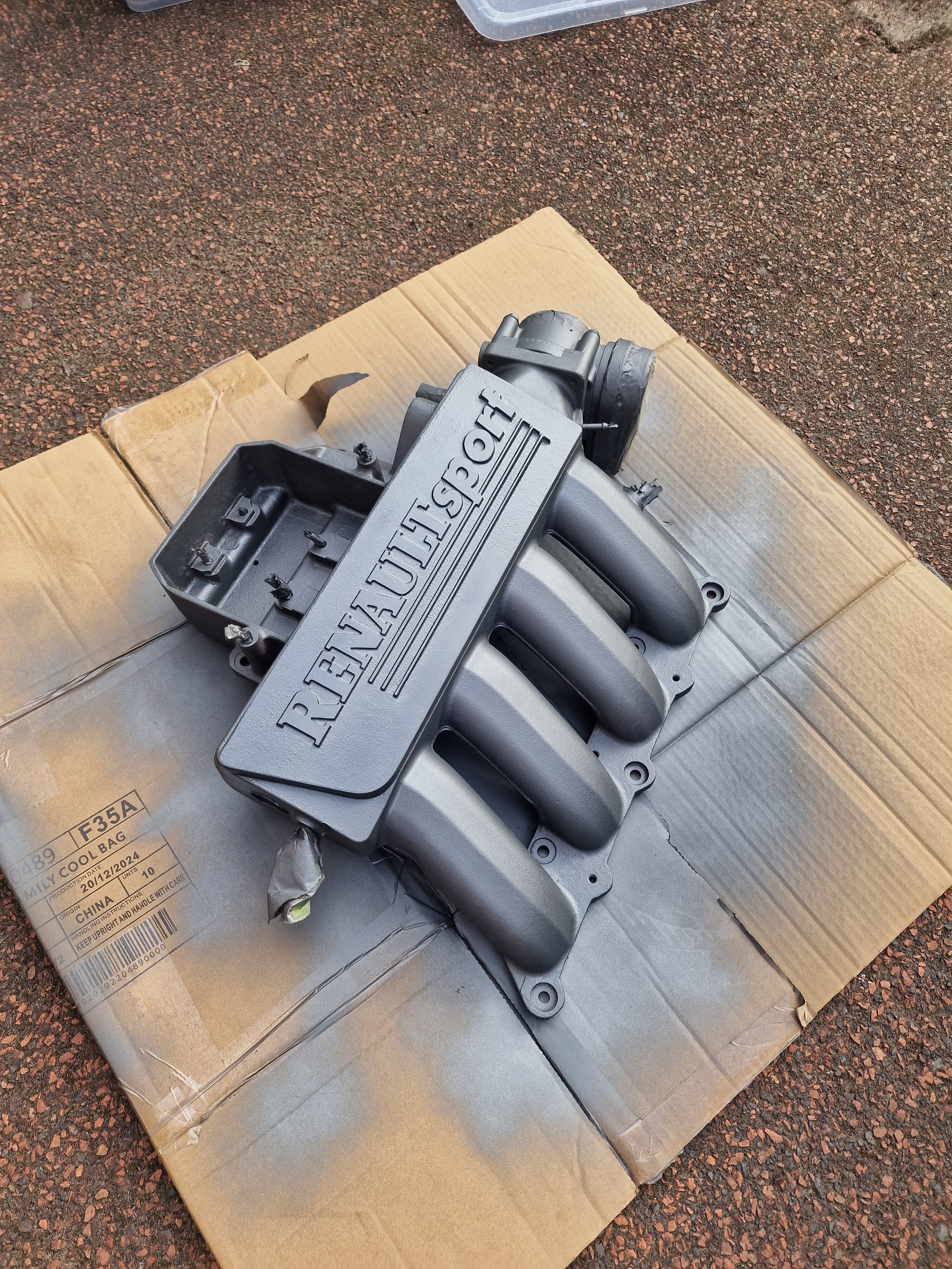

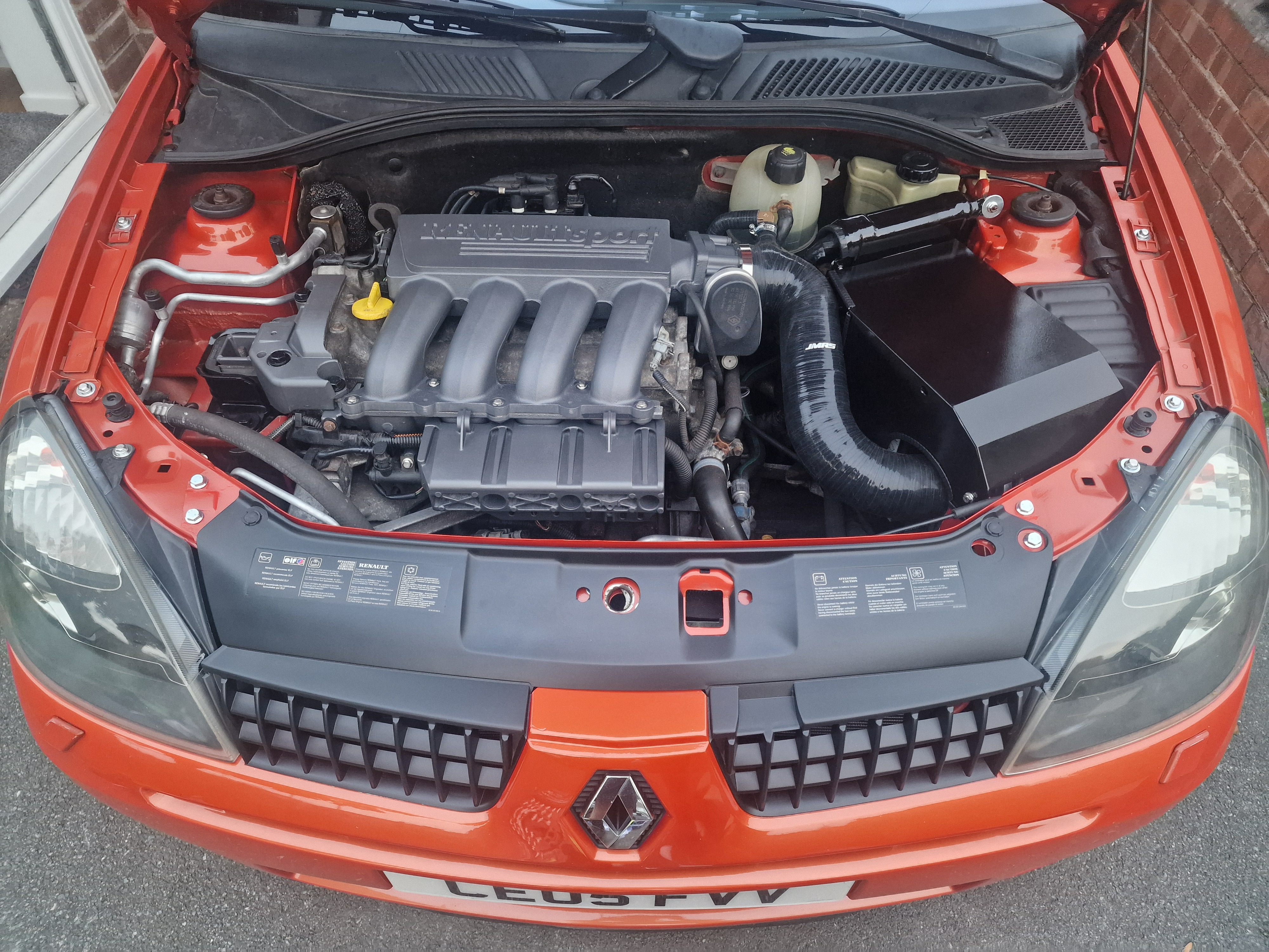

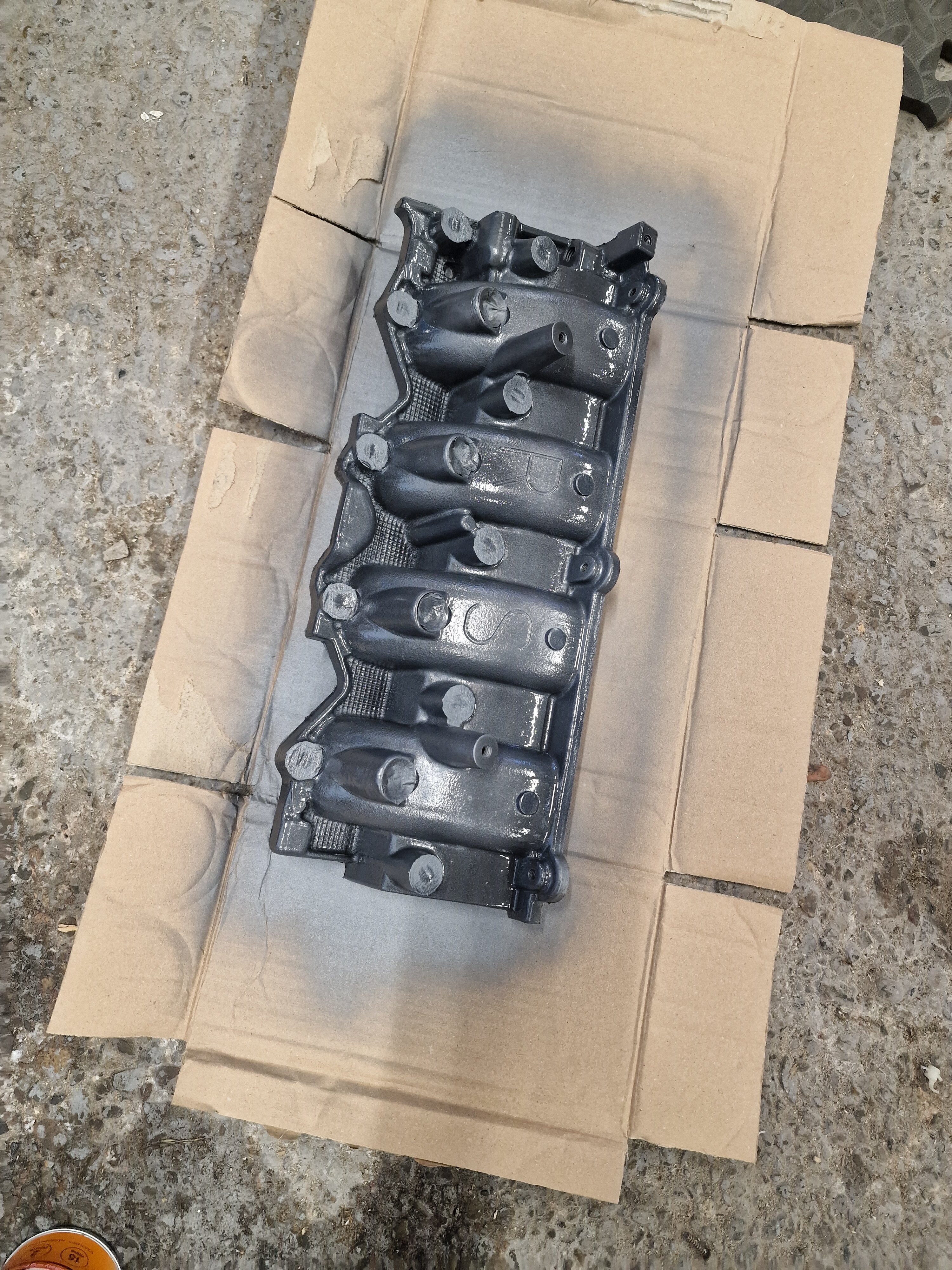

Been a while but I've been working most evenings on the Clio (not for very long between how quickly it goes dark or how changeable the weather is now 🙃) trying to tidy up the engine bay and remove the dreaded orange manifolds 😂
Here is the before and after of the work with a list of all the work done. Overall I'm very pleased with it. It isn't perfect but it's a million times better than it was.
Before
After
The work that's been completed on the front end includes:
  • Cleaned and repainted the following parts
    • Fuel rail cover
    • Cambelt cover
    • Engine mount
    • Upper and lower inlet manifold
    • Throttle body
    • Front grille with new stickers
    • ECU cover with new rubber edging
    • Battery cover
    • Front end orange metal parts including plates above headlights, top of crash bar, radiator supports and piece behind front grille
    • Upper bonnet catch
  • Fitted new gaskets for inlet manifolds both upper and lower
  • Cleaned bonnet release
  • Fitted a JMRS intake
  • Fitted a replacement fuse box with intact clip
  • Fitted a black series powerflex upper engine mount insert
  • New bolts & washers throughout baring a few which were repainted
  • Fixed the retaining clip on the coil pack electric connector as it wasnt holding it on
  • Fitted a new air intake sensor
  • Fitted a new to me coolant bottle cap to bring the colour back
  • Remove drivers side weight block (behind headlight)
  • Cleaned engine bay where possible

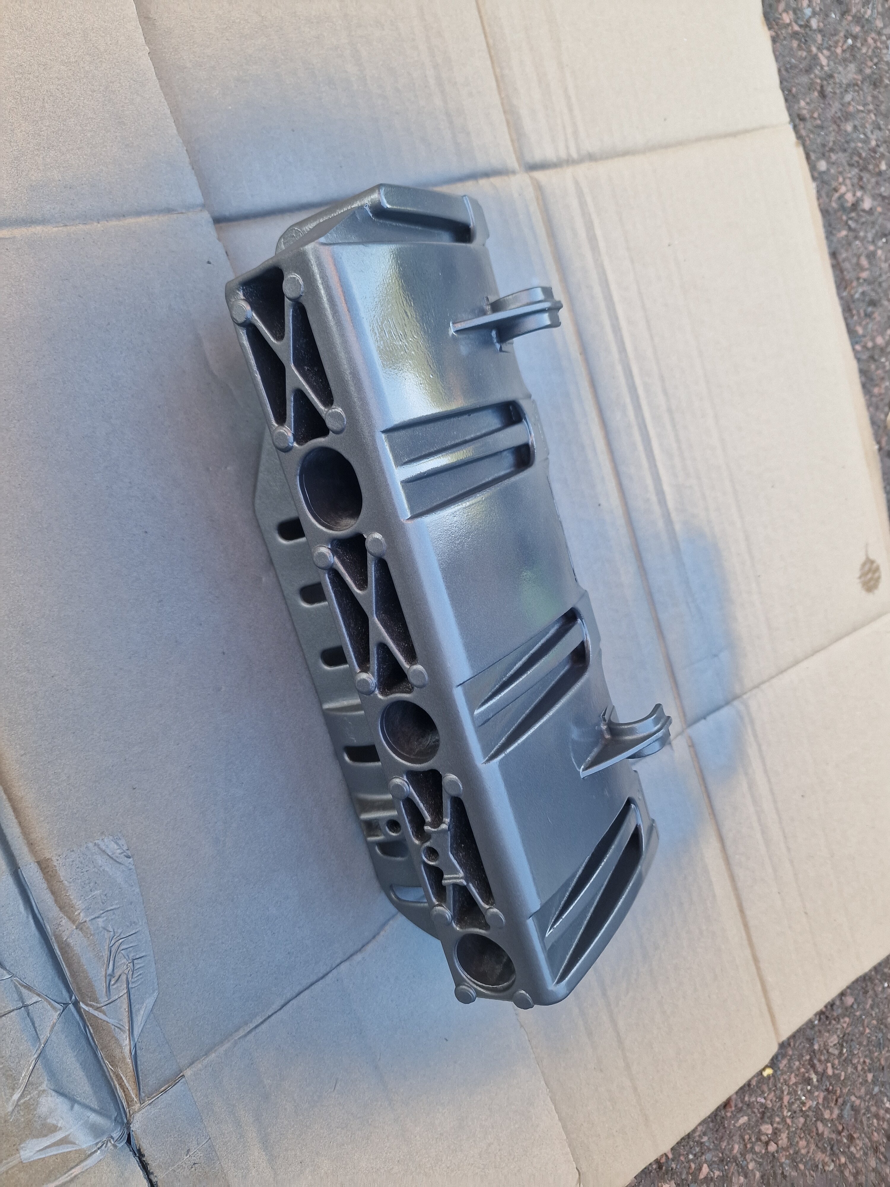

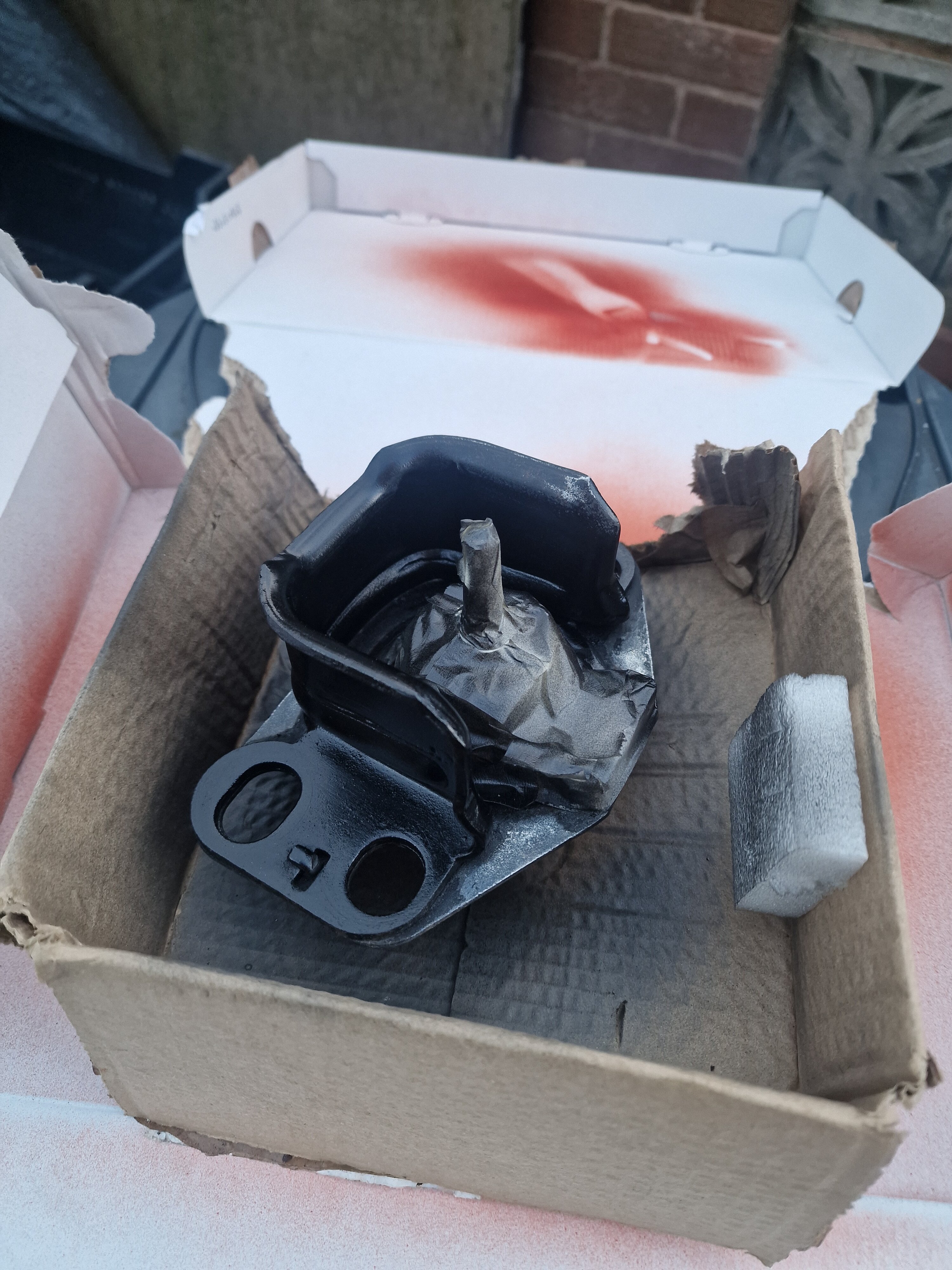

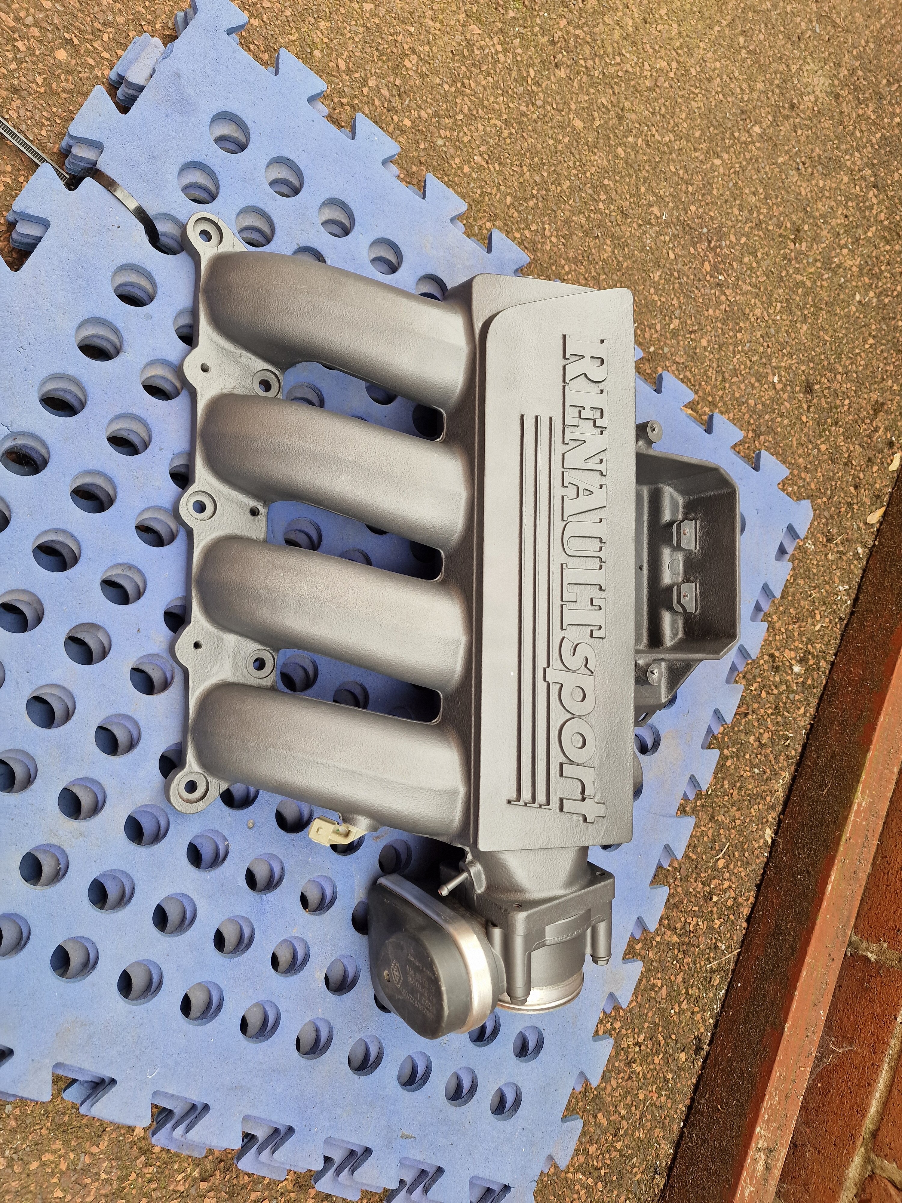

A collection of progress photos as the work was being done

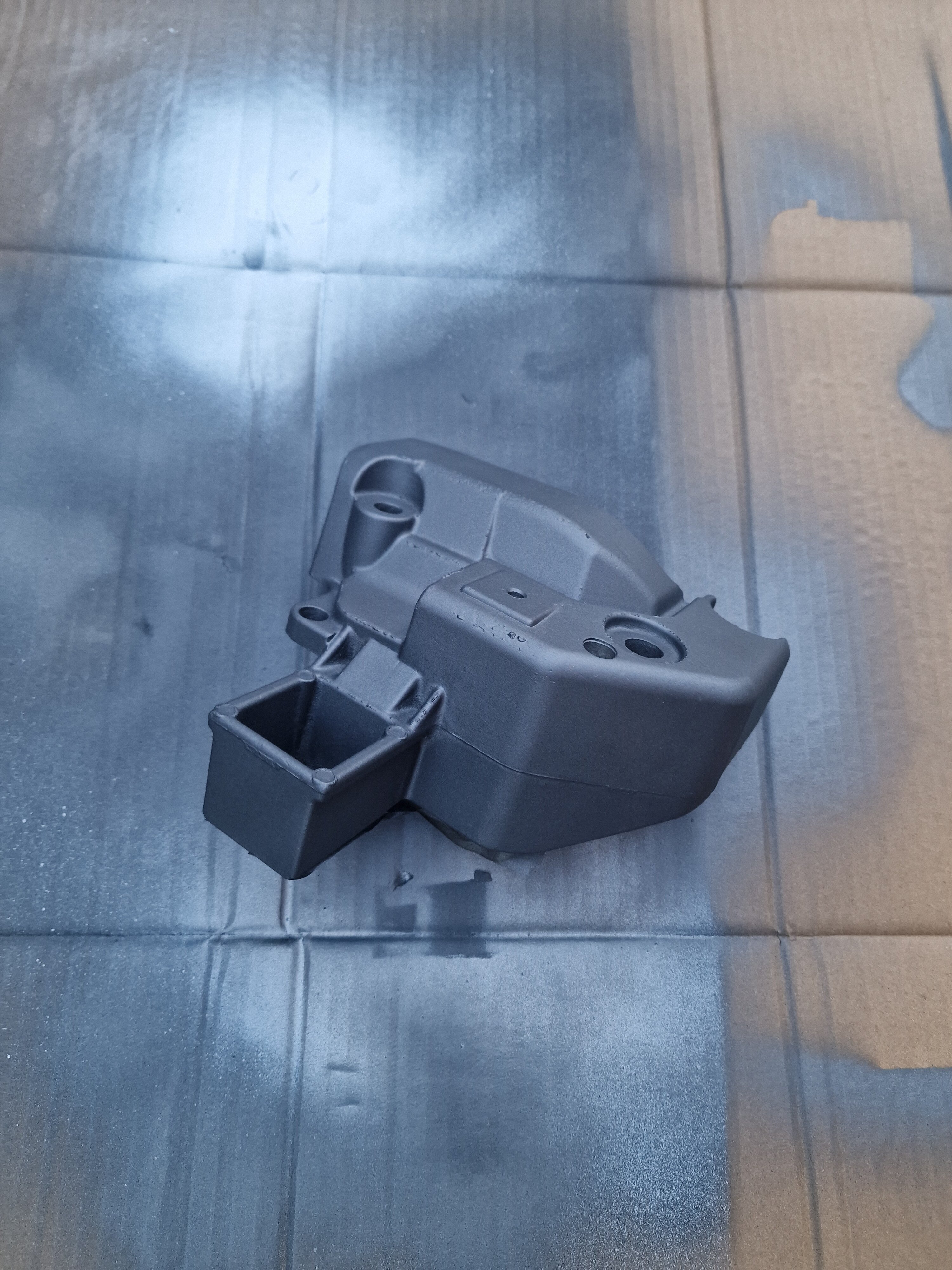

Painting the cambelt cover, fuel rail cover, throttle body and upper & lower inlet manifold using Halfords VHT dark anthracite
Painted the engine mount
