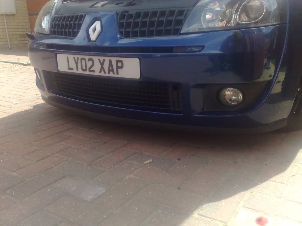

I didn't have to cut the splitter to allow for holes.
I marked off the centre of the bumper and then using masking tape I positioned one half of the splitter (not the curve I left that hanging free). I then drilled holes in the bumper to line up with the slots of the splitter, starting in the middle. I fixed it in place with self tapping screws and washers. Doing the straight section first makes the curve much easier, but you could do with someone else to give you a hand and hold it in position.
I think I ended up cutting off about 4 inches.
From start to finish it took about 30 minutes (2 people)
Hope that helps.

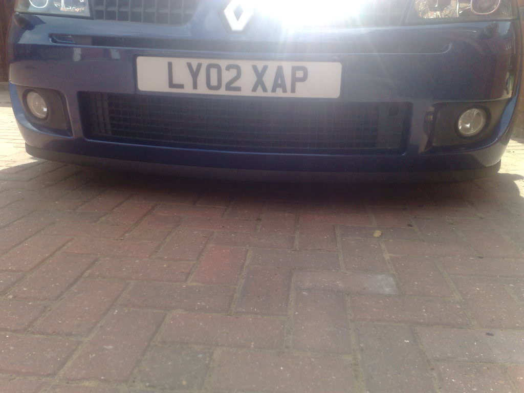

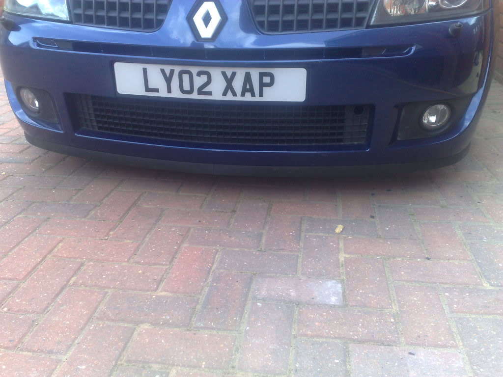

I bent mine around quite a bit on the small 307 one I got.
I Basically pulled the bumper off. Flipped it upside down on some chairs in the garden and lined it up. Then did a few test holes in the centre.
From there I lined up the rest and the corners. I also cut part of the corner (the inside part of the splitter) as I found it easier to bend once it was able to be moved.

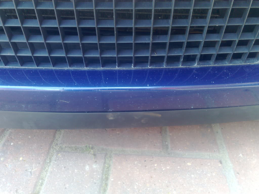

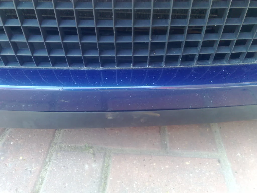

What im on about is this..on the left splitter (as you look at it) you can see 2 small bits of plastic with holes, followed by a rigid part, one with hole, rigid..etc etc.
I cut one of those(cant remember which one!) and I found it easier to get it to line up and it had less tension on the splitter itself.
Helps ot to look like this :)
If im being picky I need to sort this part out...
but its hardly noticeable unless up REALLY close!
