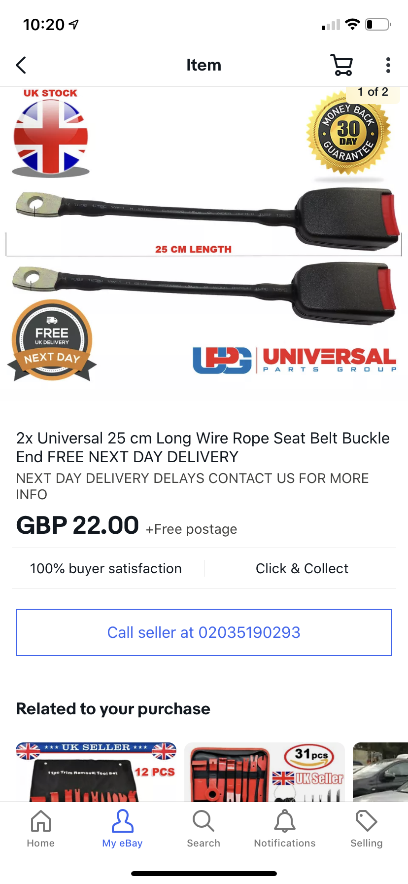

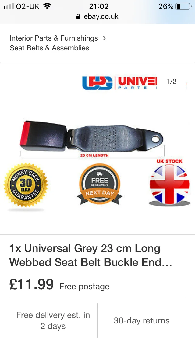

Fitting buckets soon with cage/harness’s etc but I want to retain standard belt for driving to work. Looking at these:
Look suitable?

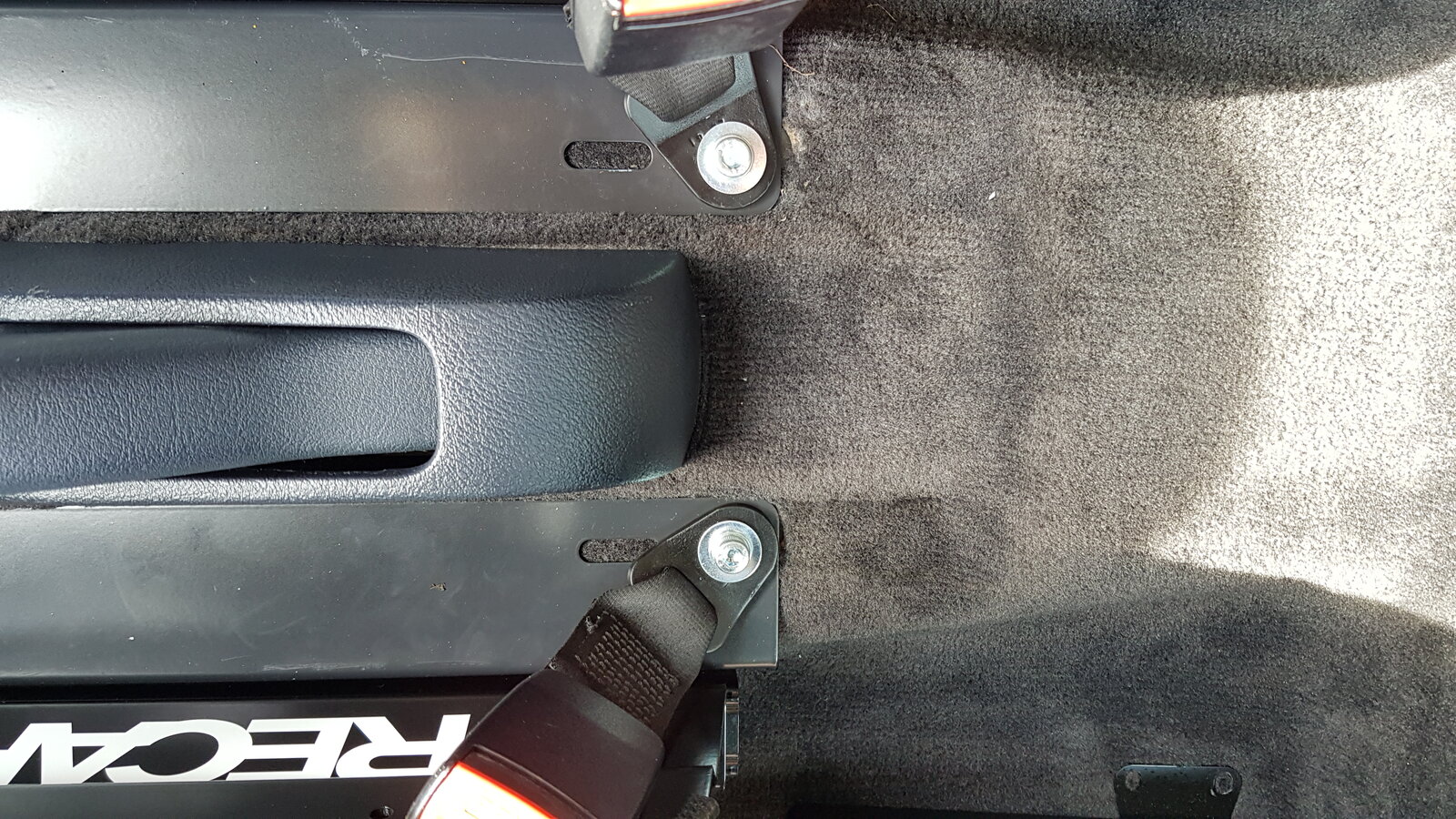

Also should I bolt it through the subframe/ floor here:
Any help appreciated. Cheers

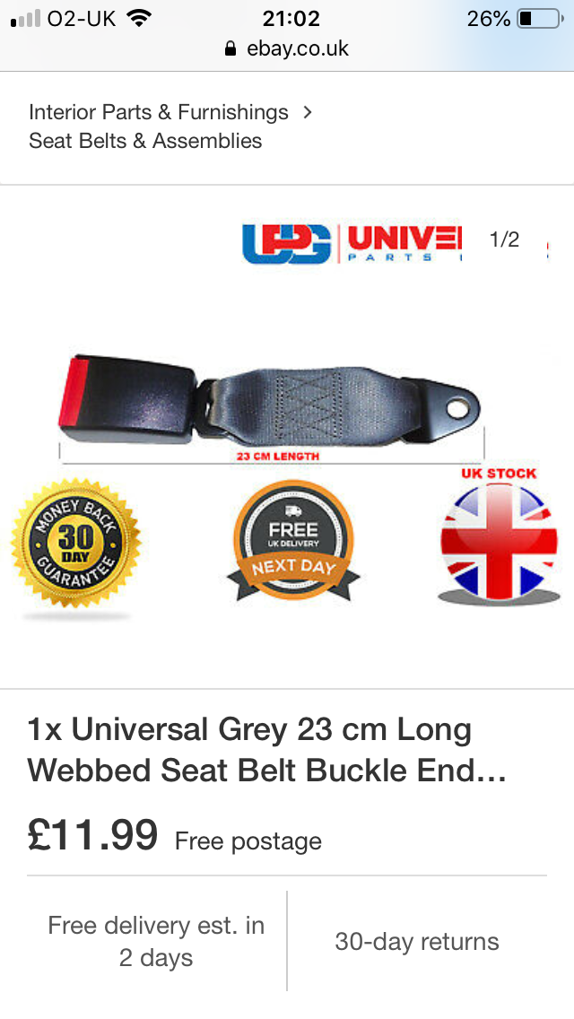

Cheers mate, that makes it even easier. Is there another buckle you could recommend or should I stick with that one?
Cheers
haimsey
  ph2 172
I think LUKE do one, can't for the life of me find it though.
Sure a few on here have used a Peugeot 106 (iirc) rear buckle
New2RS
Thanks for the input chaps.
The Peugeot buckles were my next port of call after trawling through threads but the cable buckle seems a much smarter option. I think I’ll go for those. Cheers

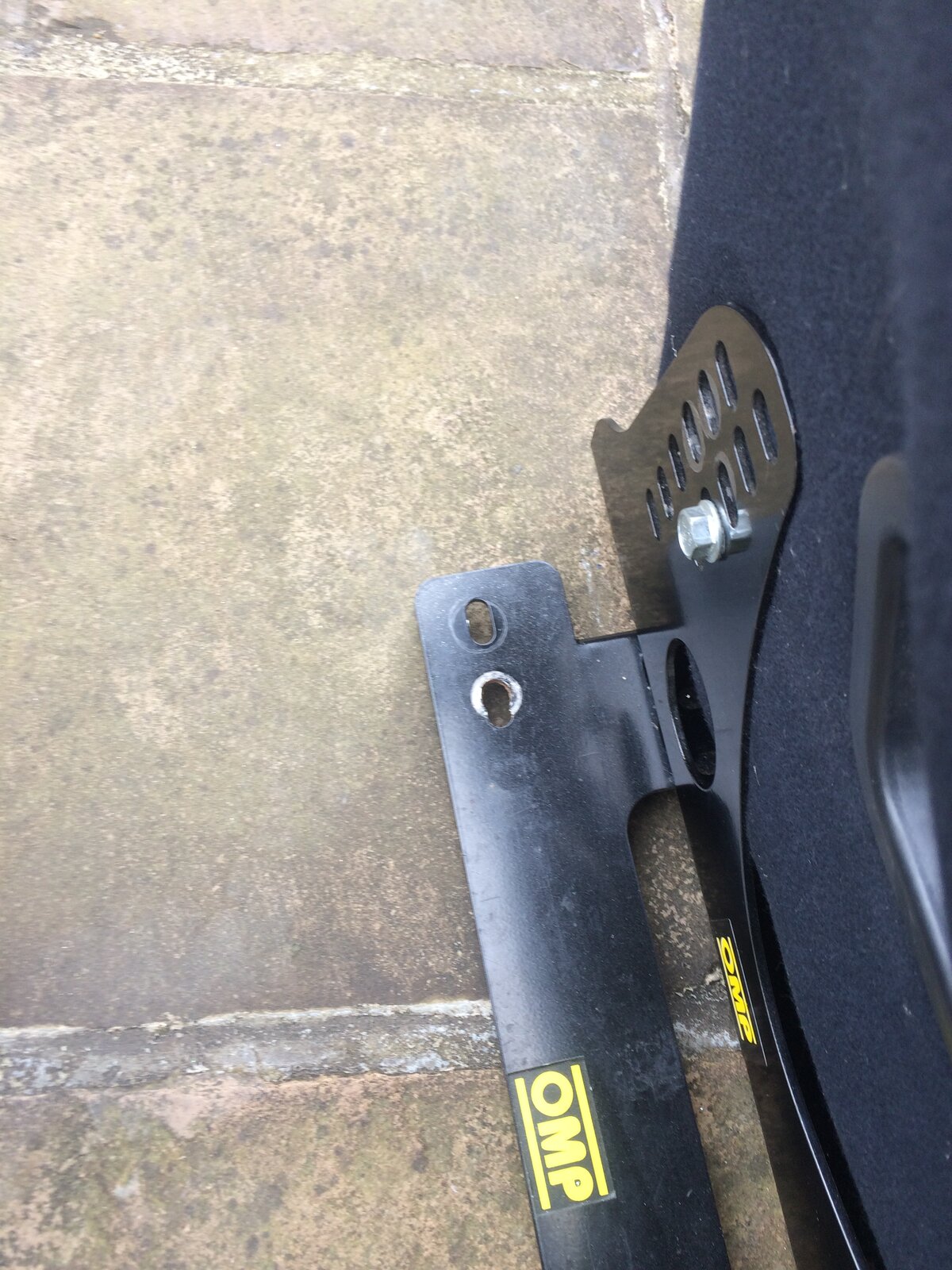

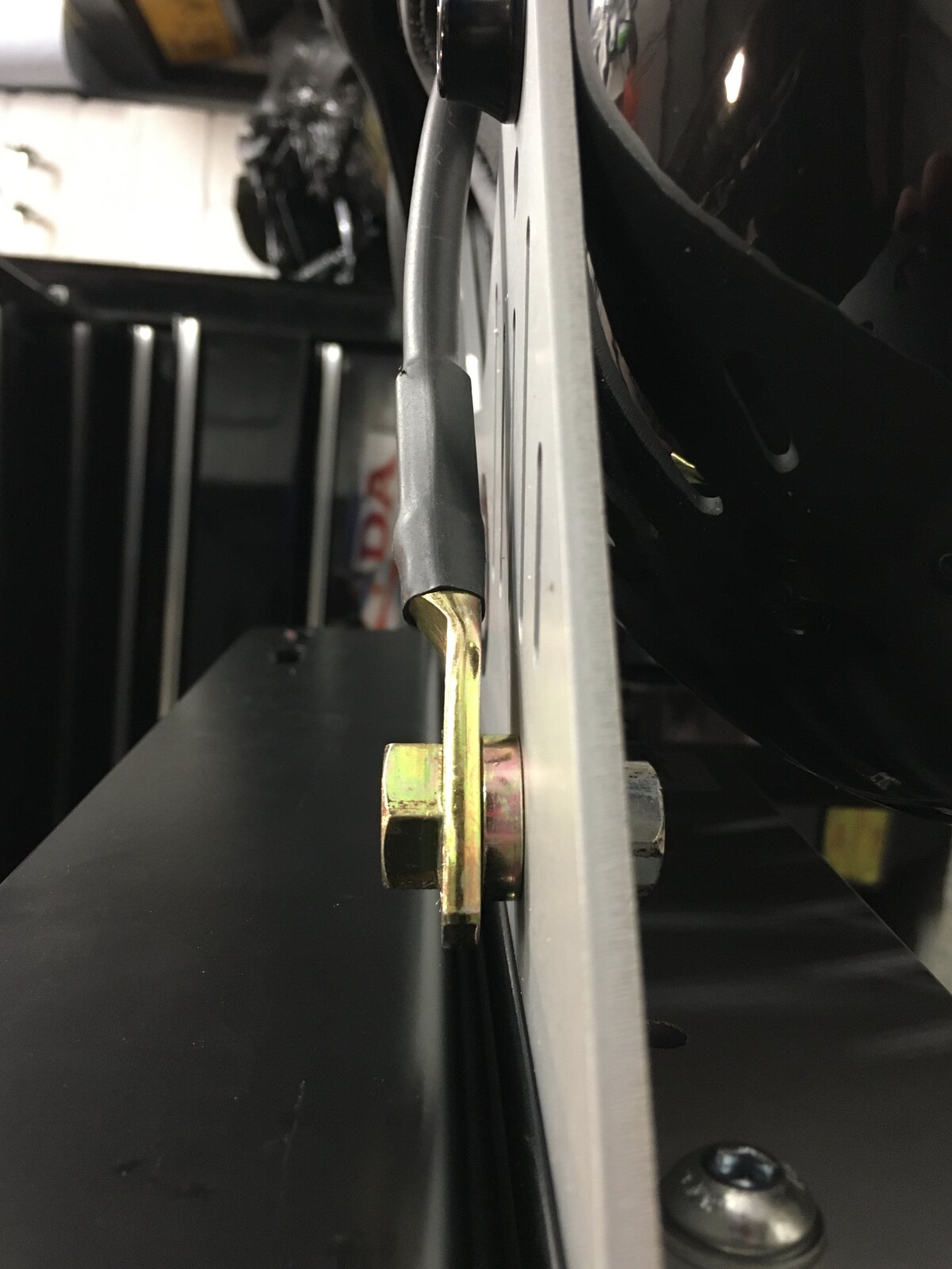

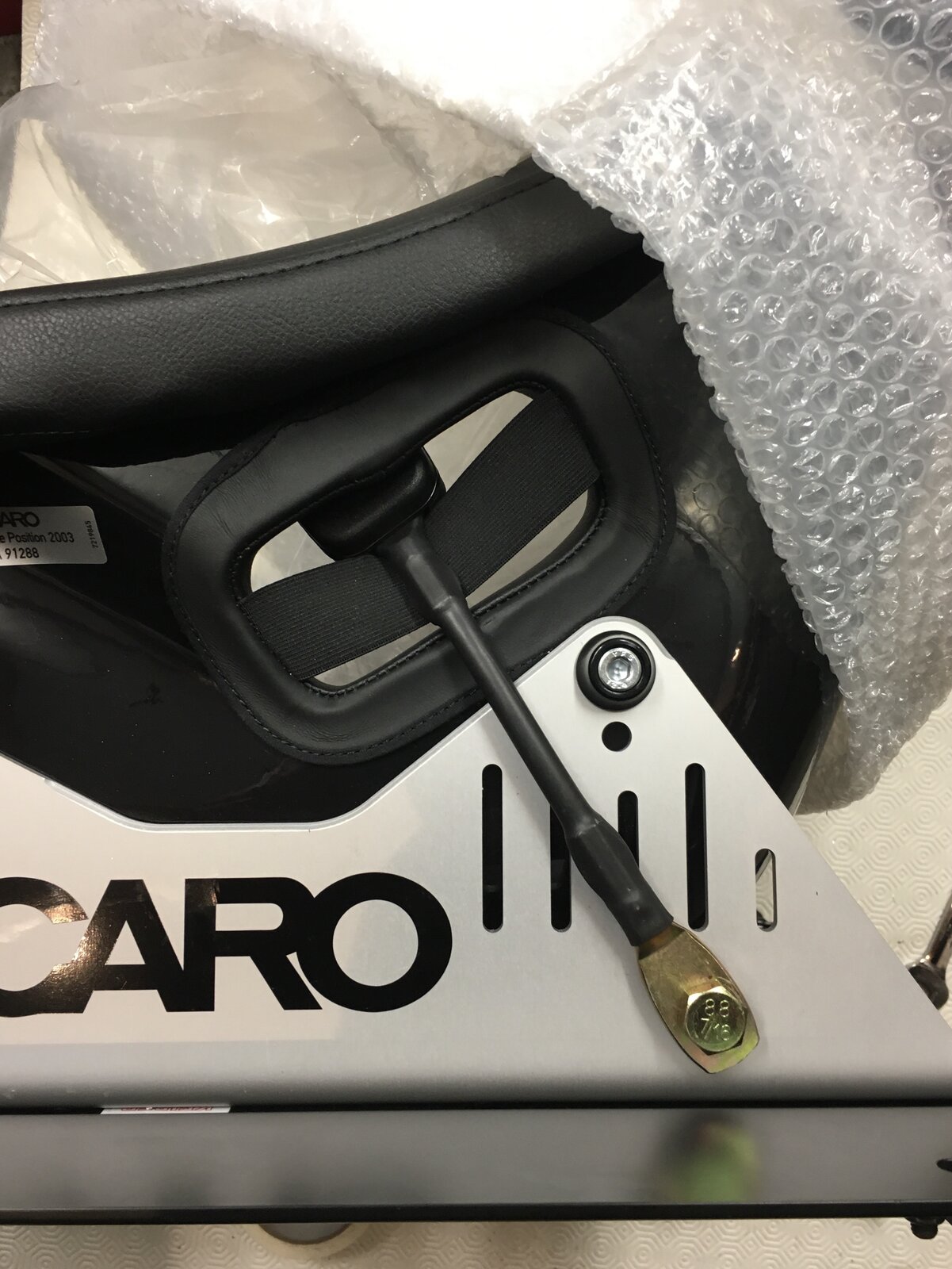

I’ve ordered a couple of wire rope buckles which I’m going to bolt to the side mounts hopefully.

These are what bought. Can sell them for 15 quid delivered if you’re interested - as I say they are brand new

Think other kind of said it but make sure the buckle doesn’t side too high and causes a gap from the belt to your body. I’m sure that would be ‘fun’ if in an accident
