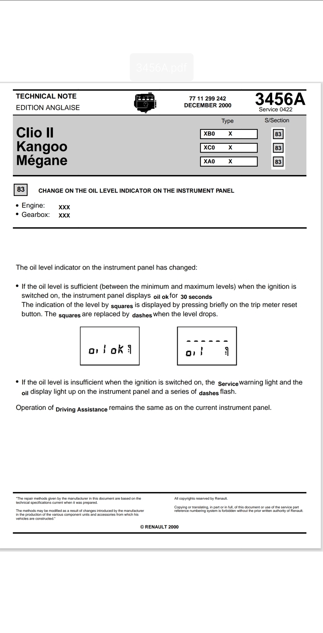

Dipstick and sensor are usually reliable, if its under minimum on oil the bars flash. Absolutelty top it up if dipstick is under min.
That might extinguish the serv light too as that comes on when oil level sensor registers low.
Oil light is for low pressure only, if that comes on then its usually engine rebuild
Workshop manual for ref.

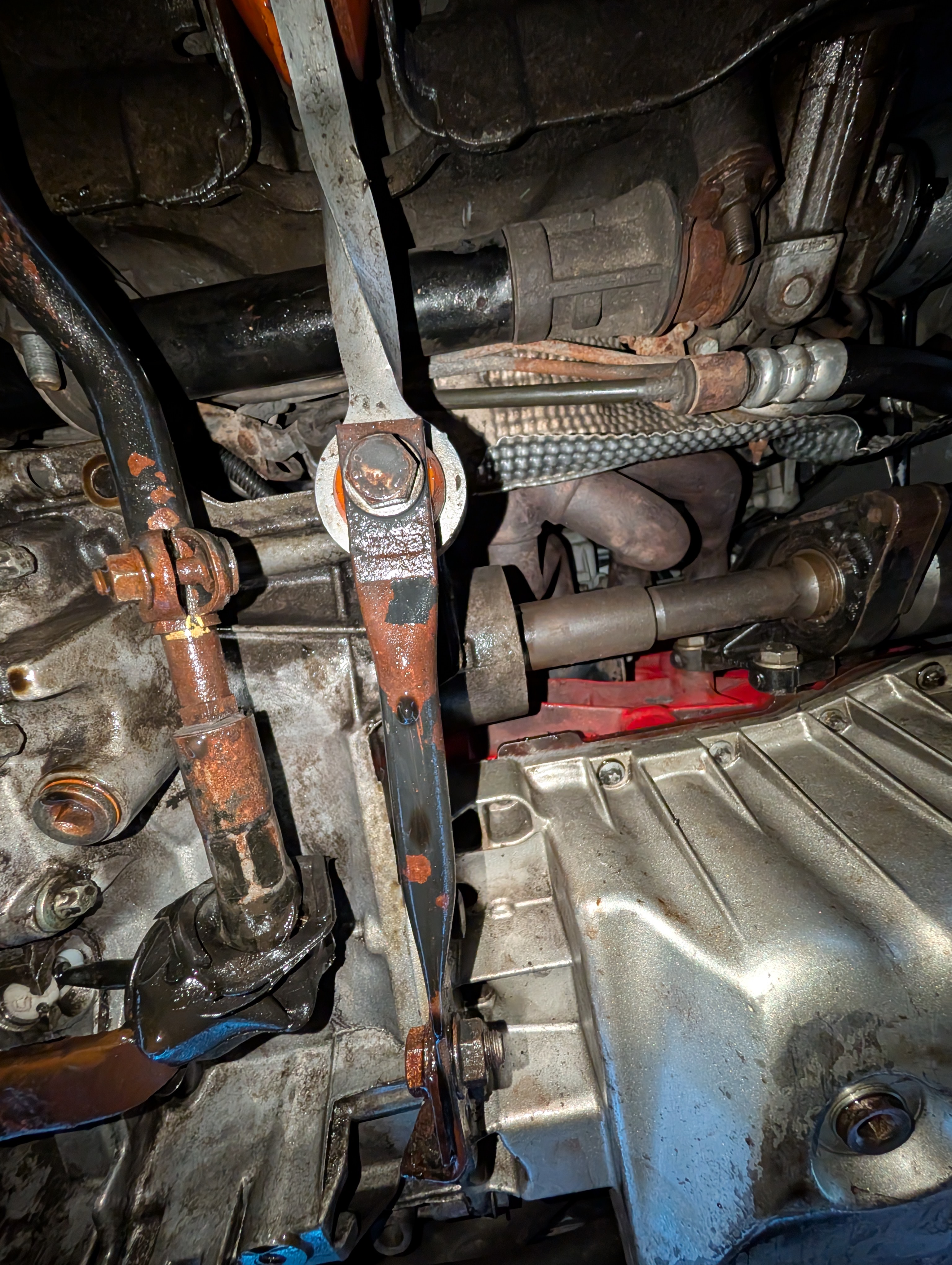

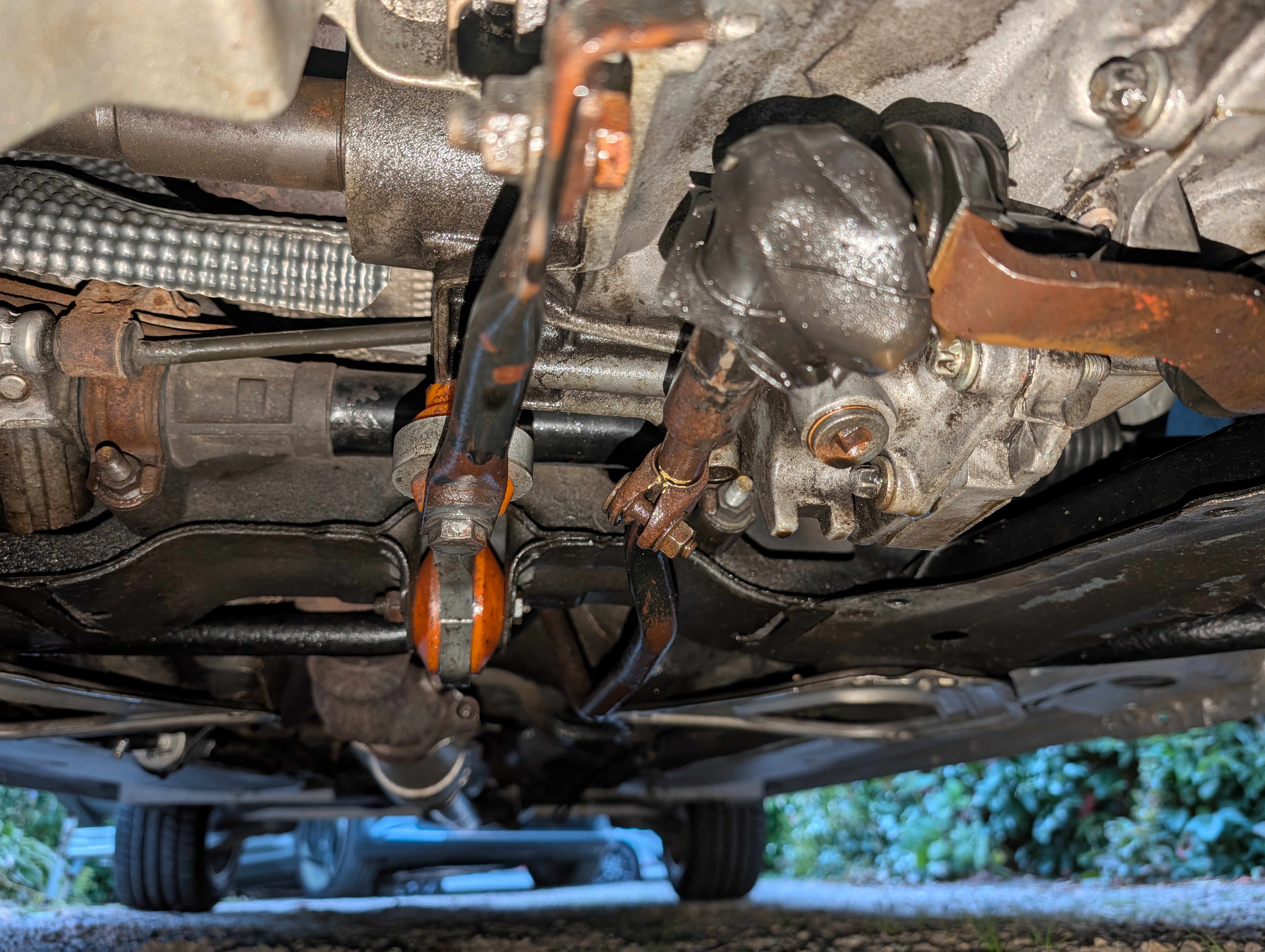

Extremely good local garage no problem with them. Attached some photos and a vid you can't see the oil that well on the pics but it's there for sure. Doesn't look too bad tbh.
Looks quite wet to be fair, id clean it up and go from there. Wonder if its crank seal leaking or main cap, its quite often misdiagnosed. Also sump can crack if bolts torqued up too much.
