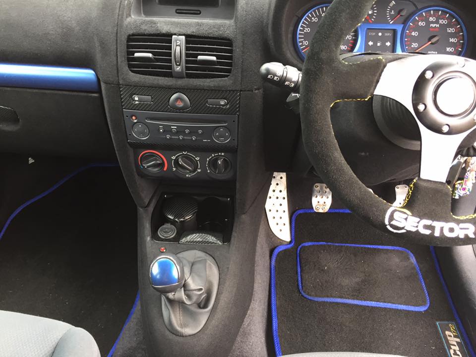

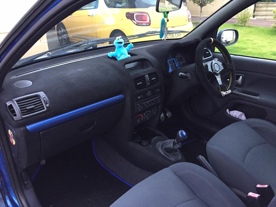

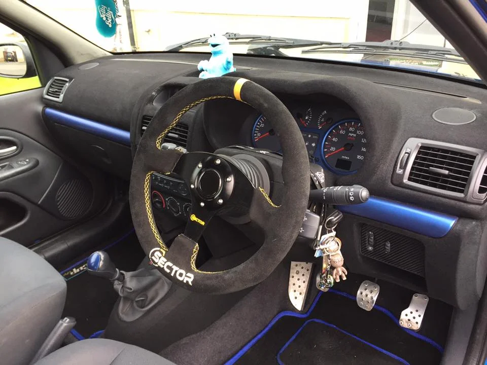

Just thought I'd post a couple of pics of my finished result. Needs some touching up hear and there but overall I'm happy with it.
