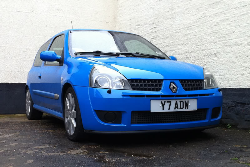

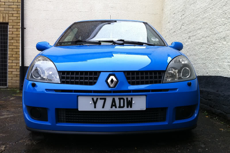

I hit a partridge the other day and it smashed my glass on my right fog light. To stop the water getting in I did a Temp fix and covered them both with black tape, and I actually think it looks alright. My question is, can you just buy the glass or do you have to buy the whole light fitting? and also do you have to remove the bumper to fit it? 2 pics of what they look like blanked out...

Whole unit I believe..cant get the glass seperate (you wont need the plastic surround thouhg)
To change it just remove the inner arch liner and you shoul be able to swap it out without taking the bumper off.
