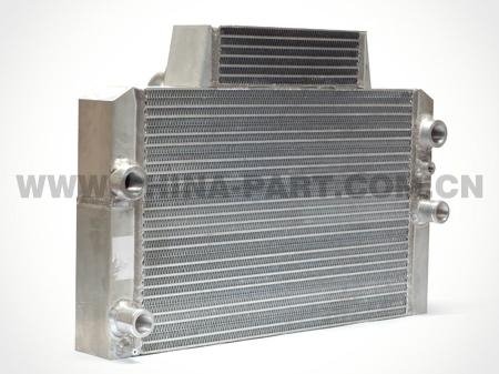

okay, so today i'm at work and im fixing a forklift, head skimmed and rad repair when it hit me, fork lift radiators have a seperate oil cooler part built in for hydraulic oil, now ive not looked into it no further but someone somewhere must have used one on a car, and im hoping the pro's on here are gonna tell me why its a good or bad idea ?
heres one for example http://www.ebay.co.uk/itm/HYSTER-FO..._Vehicles_ET&hash=item27c7459bd3#ht_500wt_927
but linde trucks have some very nice aluminum rads in em ;) for example http://img.diytrade.com/cdimg/731021/22105780/0/1309136588/Radiator_for_Forklifts.jpg

i didnt know that! very intresting, im going to see if i can scrounge one off an old truck lol
Although I now know many cars come with them, I'm still wondering if anyone has put one on a track car instead of having a separate oil cooler? Especially one off a forklift :)
Id have thought it would be do-able, as long as the cores suitable (shape, capacity, airflow, pressure rating etc...) and the whole assembly fits. However, if its air/water and air/oil, you may as well use separate coolers surely..... unless the packaging is massively better...
