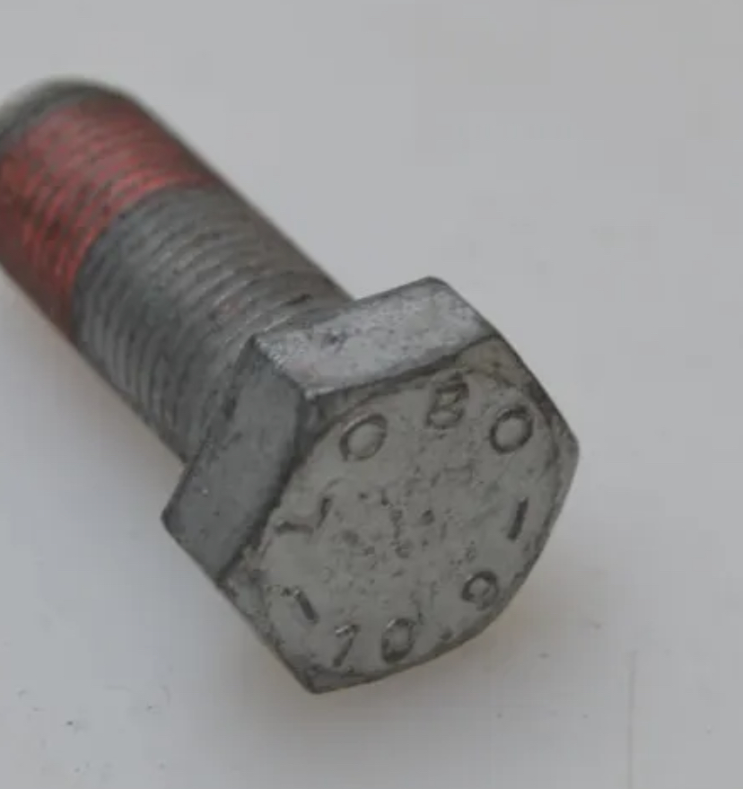

I've taken the calipers and carriers off my 182 for a refurb. The carrier to knuckle bolts are 2 different sizes and they are rounded or damaged in some way. So I'd like to replace them.
I've found from an online parts catalogue that they are M12(1.25) x 32mm long.
My question is what is the bolt grade? 8.8/10.9/12.9?
Thanks
Greg

They’re a 10:9 grade fella.
7703101617. You can still get them new from dealers but flippin expensive from memory.
