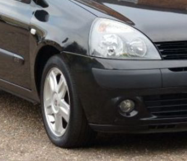

I have a cracked driver side foglight ( the ones in the front bumper ) , looking to buy one on eBay and replace it.
Easy job? Any guides? Pic is for illustrative purposes ( NOT actual car )
