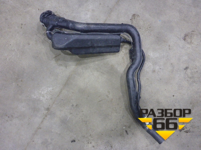

I suspect it might be related to canceling the carbon canister and blocking the pipe from the fuel tank, as I don't seem to find information about any other vents for the fuel tank.
Also does anyone know what purpose does the box next to the big fuel filler hose serve, and if it could be related to my problem as it seems to be there for the case of an overflow?
The box is shown here:
