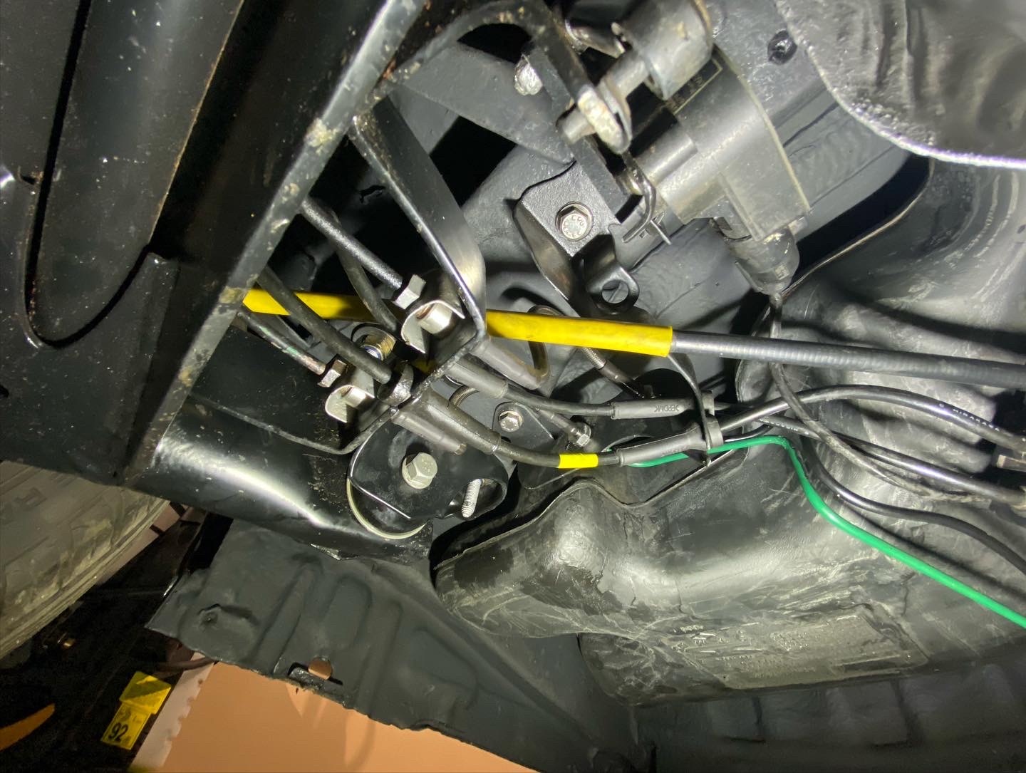

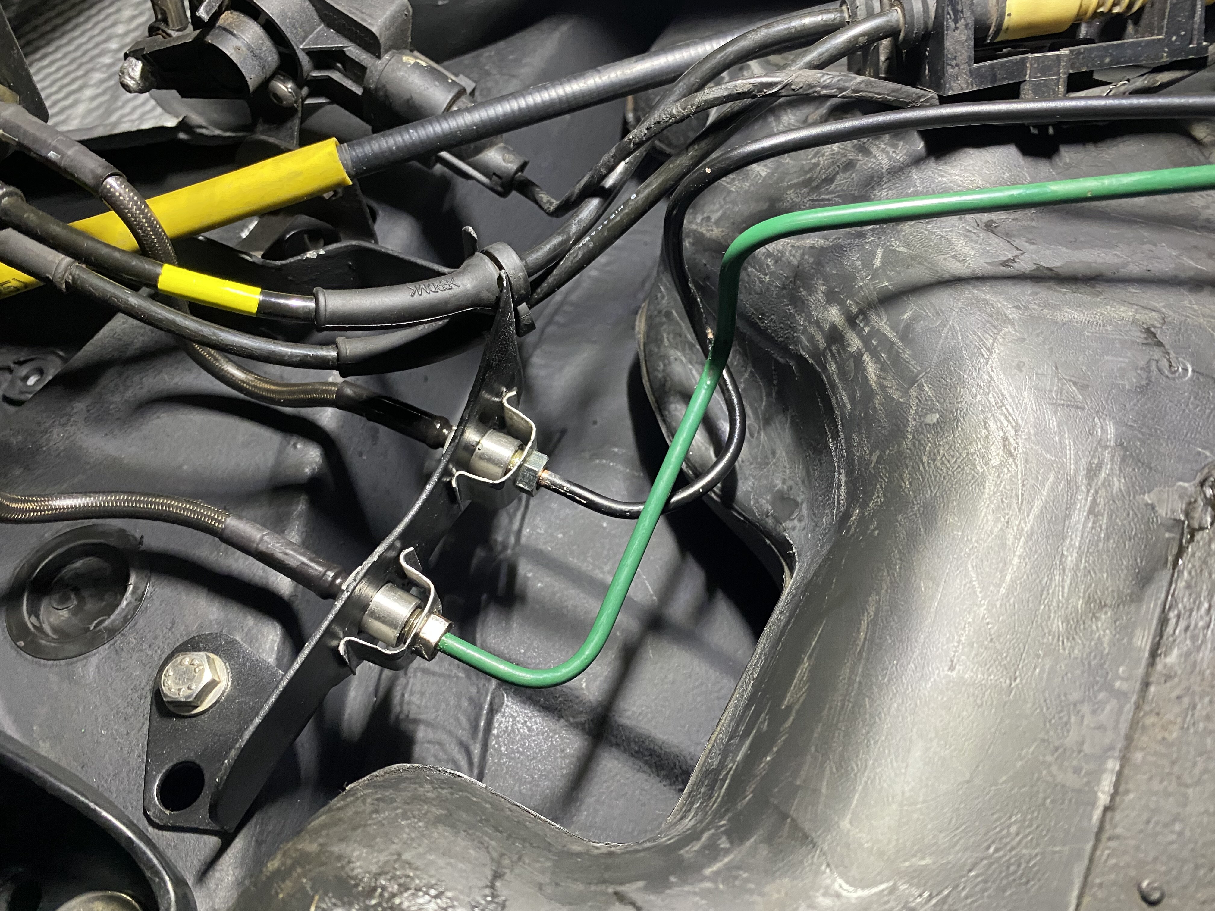

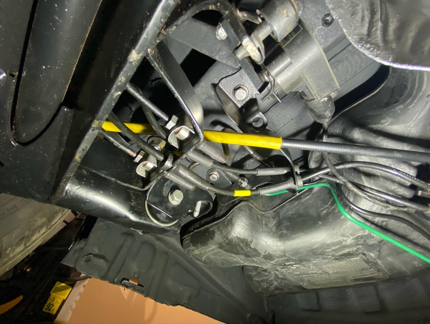

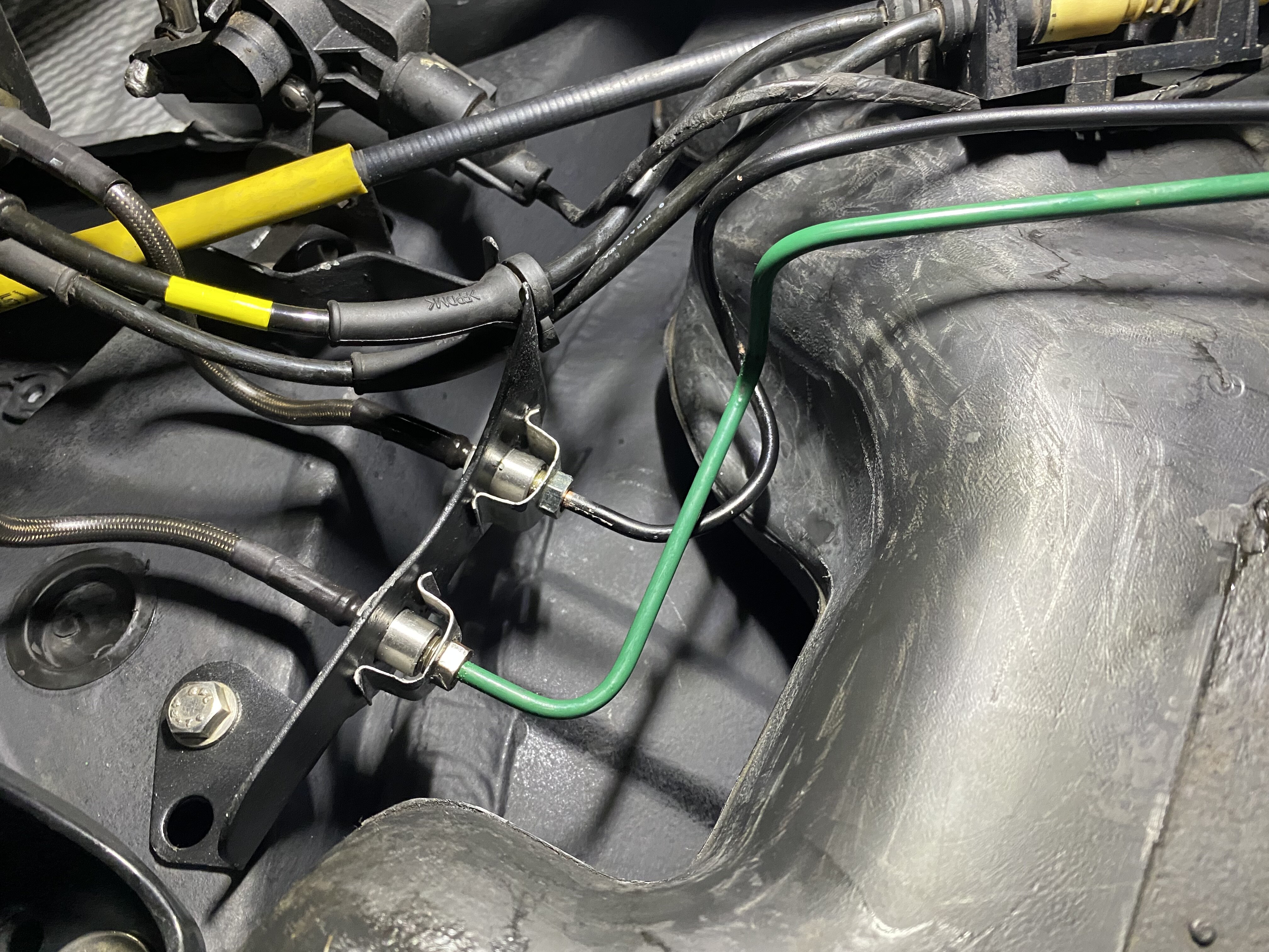

The lines do crossover the tank, youll need to loosen from the beam flexy’s (good luck) then drop from the retain brackets to give you enough flex….however I could imagine they will be in an interesting condition and aged so if you want to make sure you don’t snap them, they aurally join about 12” behind the NSF wheel (just under the passengers door) so you can remove them and either replace, or work with out worry of fracturing. You should have space to drop the tank if you loosen all the lines mind. I made new lines for mine ‘whilst I was there’ as it’s a piece of piss and added piece of mind

The lines do crossover the tank, youll need to loosen from the beam flexy’s (good luck) then drop from the retain brackets to give you enough flex….however I could imagine they will be in an interesting condition and aged so if you want to make sure you don’t snap them, they aurally join about 12” behind the NSF wheel (just under the passengers door) so you can remove them and either replace, or work with out worry of fracturing. You should have space to drop the tank if you loosen all the lines mind. I made new lines for mine ‘whilst I was there’ as it’s a piece of piss and added piece of mind View attachment 1684261View attachment 1684262
Aye, they are beyond crusty at the joint to the beam so can’t see them coming off without a fight. I had a go yesterday and was getting nowhere fast.
I’d agree it’s probably worth replacing the whole run. When I’ve started cleaning them off there are a few suspect looking areas so no doubt the pipe will split if they do come free or kink somewhere when bending. Did you buy them pre-made or just make your own?
RustyMojo
Bon Jovi Officianado
Made my own, it’s piss easy and super satisfying to do! Little tip, before you disconnect them hold the brake pedal down with a plank of wood to stop the system draining all the fluid! That way you won’t have to bleed the ABS system which is an absolute nightmare.
