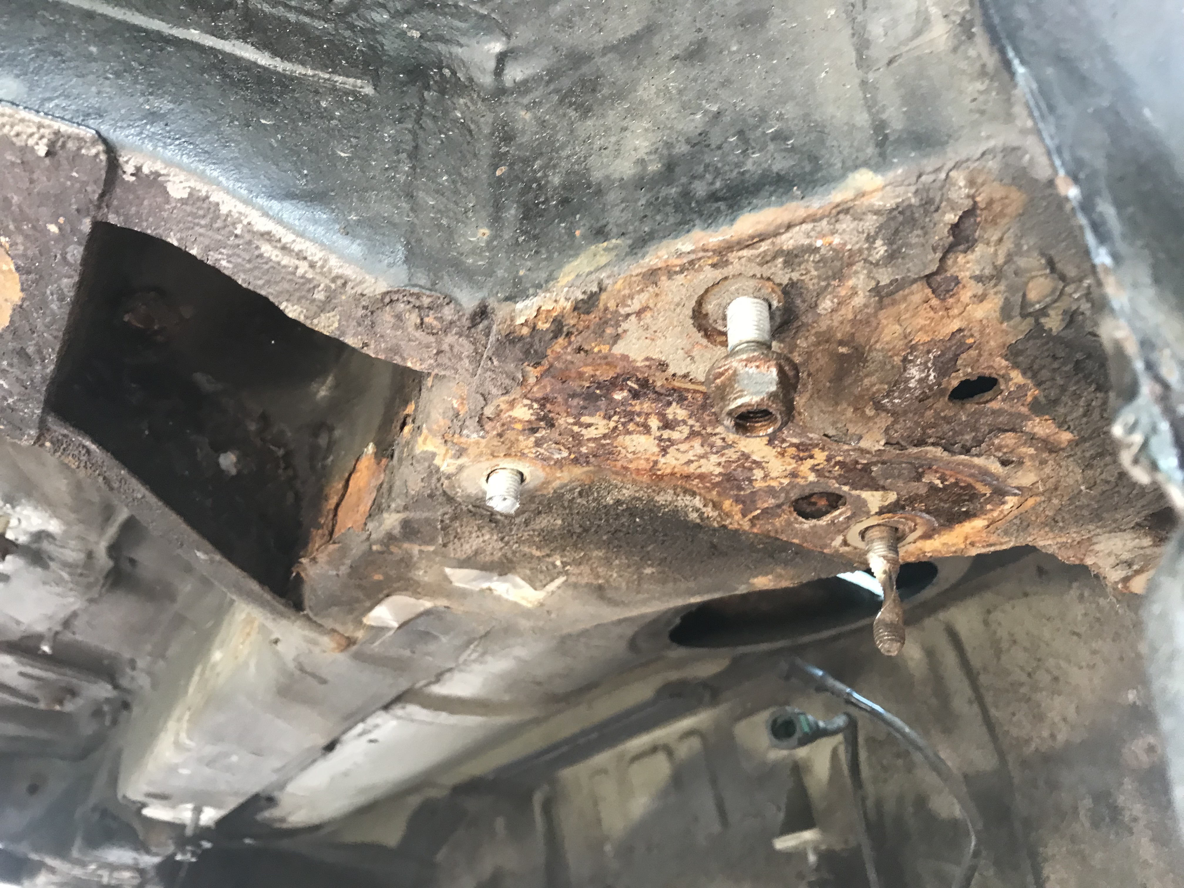

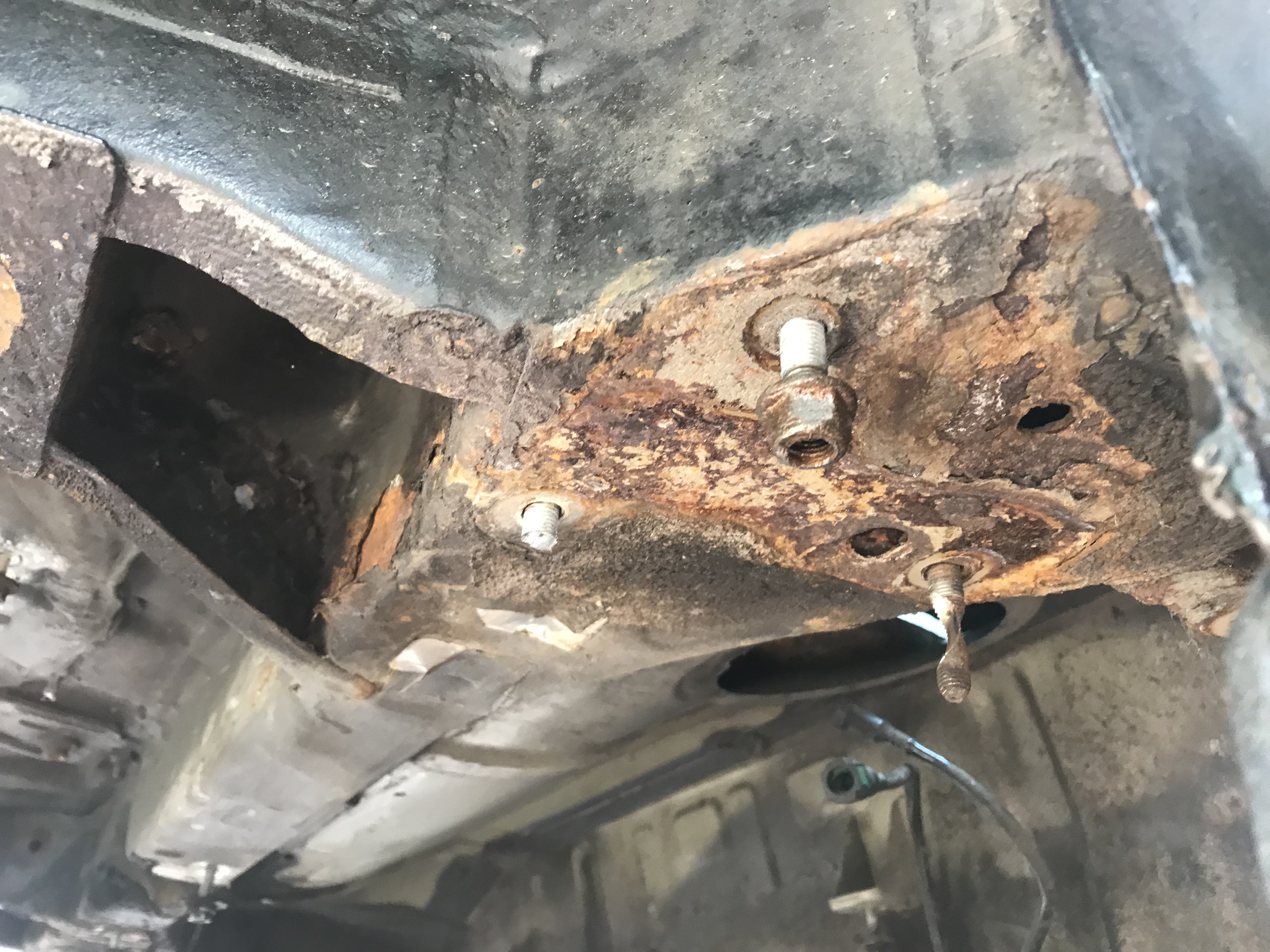

Well tank can of pretty easy , bar one snapped stud, the biggest shocker was finding a big rotten hole under the arch above the fuel filler, so all chopped out and ready for welding up, the arch was like tin foil, But the outter rear quarter and around the petrol cap area ,is in good nik....So good bases to spot weld too, I'll weld it up in two sections....I'm more than confident i'll sort that..Seem as i spend most of my nights watching Yorkshire Car restoration.Lol, I might even put a little gromet in , so i can cavity wax it after welding, Then underseal over the gromet. And the snapped stud for the petrol tank, i'll just drill and retap the.

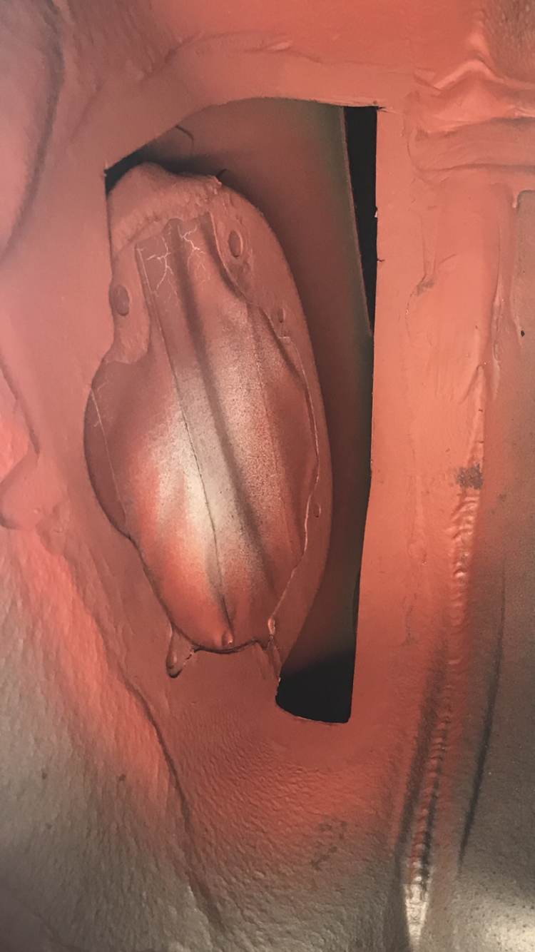

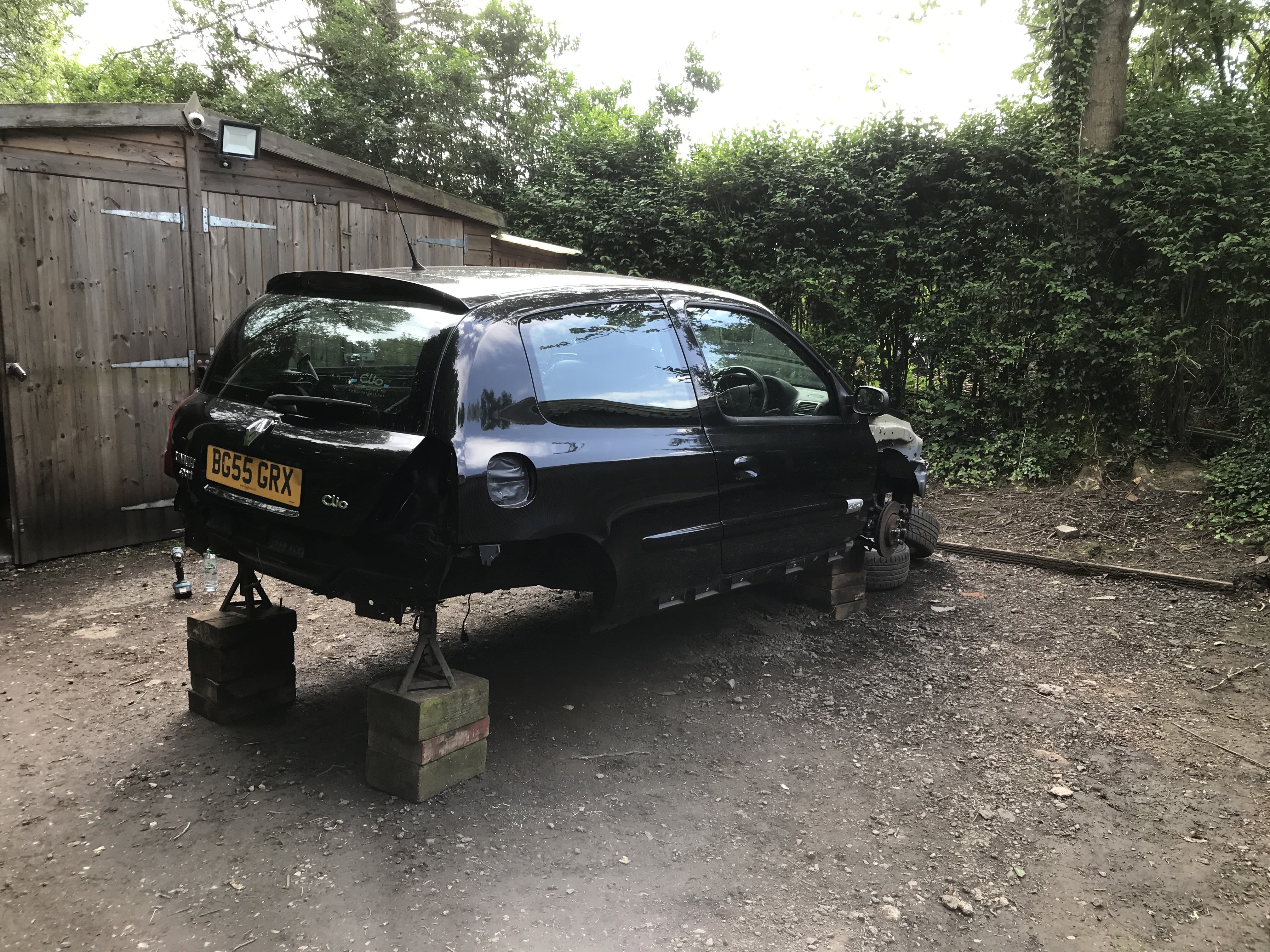

Rot cut out, and a bit of red primer slapped on , Iv'e managed to get on section welding in on sunday afternoon, Then fucked it off coz all mi mates were sat at the pub , plus it was to fecking hot stuck under that wheel arch. I'll do abit more on it this week.

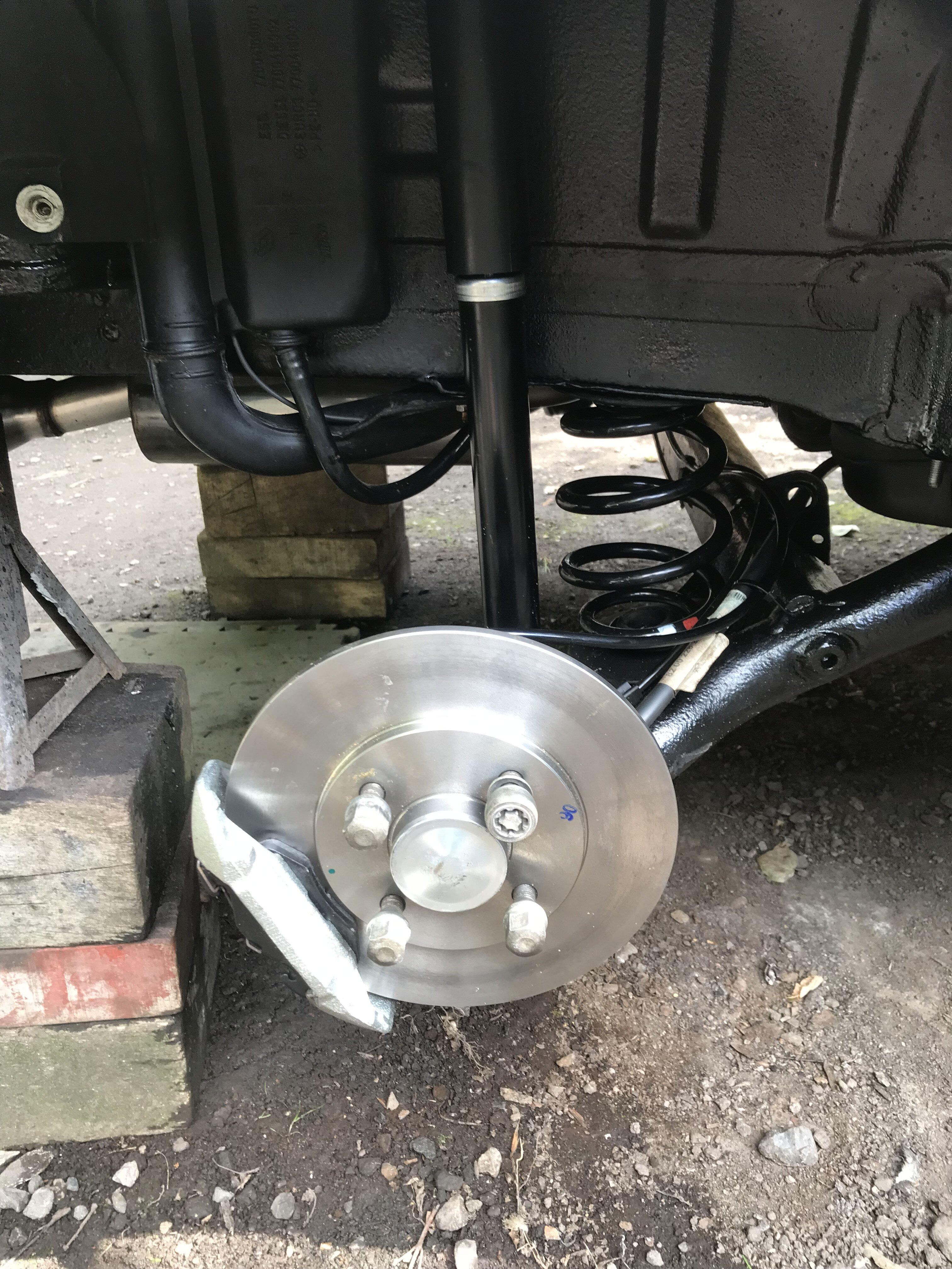

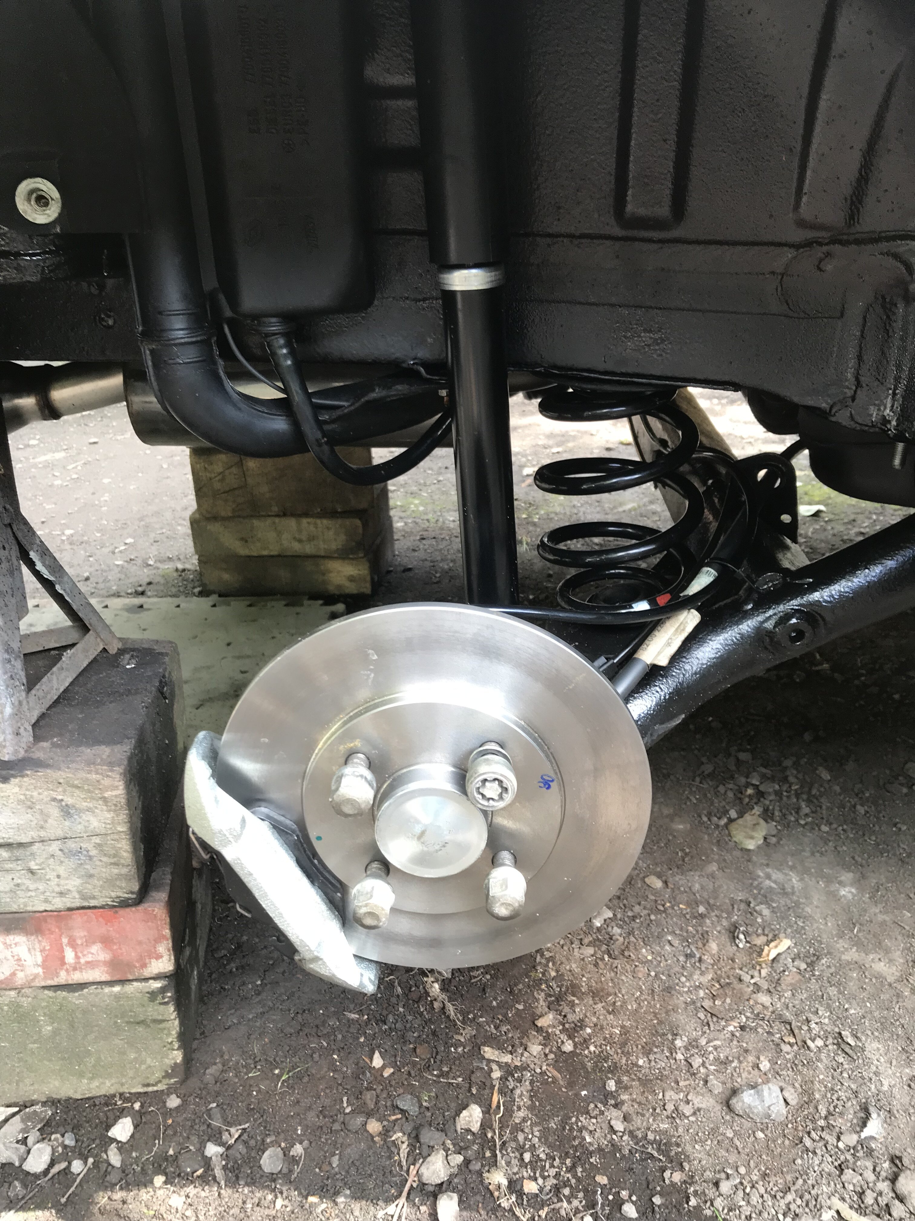

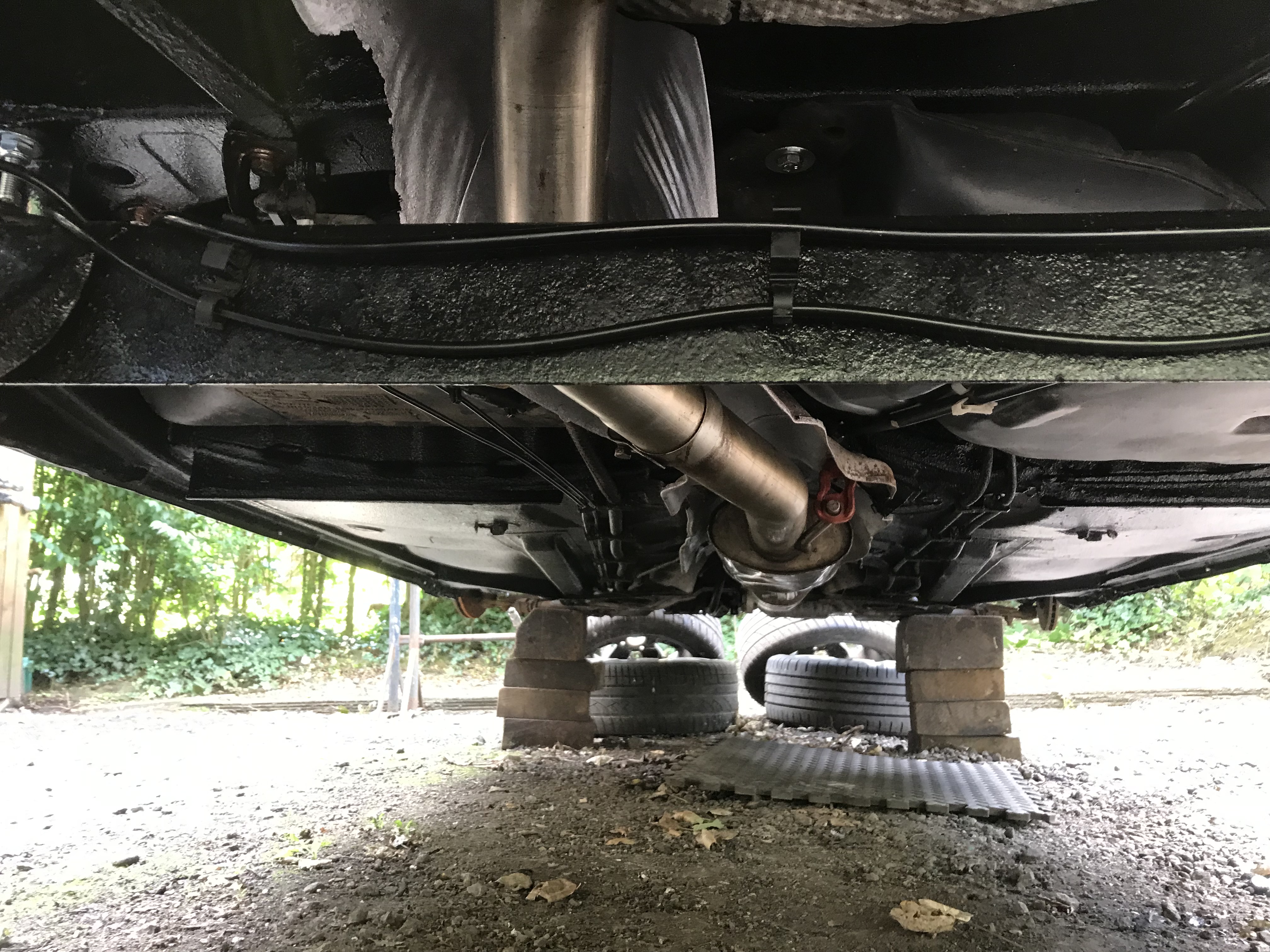

Well that wasn't a quick fix with the welding and sorting the wheel arch out, Then to find the box section for the rear beam was pretty shot, So cut the out , And sorted that , then to find another hole on the rear back leg, Sorted that........Then found a biggish hole in the front box section ,A little bit more prep , then ready for seam sealer, & underseal the job lot. Rear beam bolts are goosed , then parts shopping

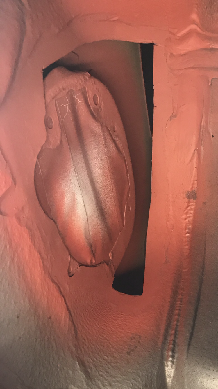

Finally ....that took some sorting out, just the front arches to sort now, but all the box sections are wax oiled . I must of thrown nearly 3k at the BG , and still not finished.

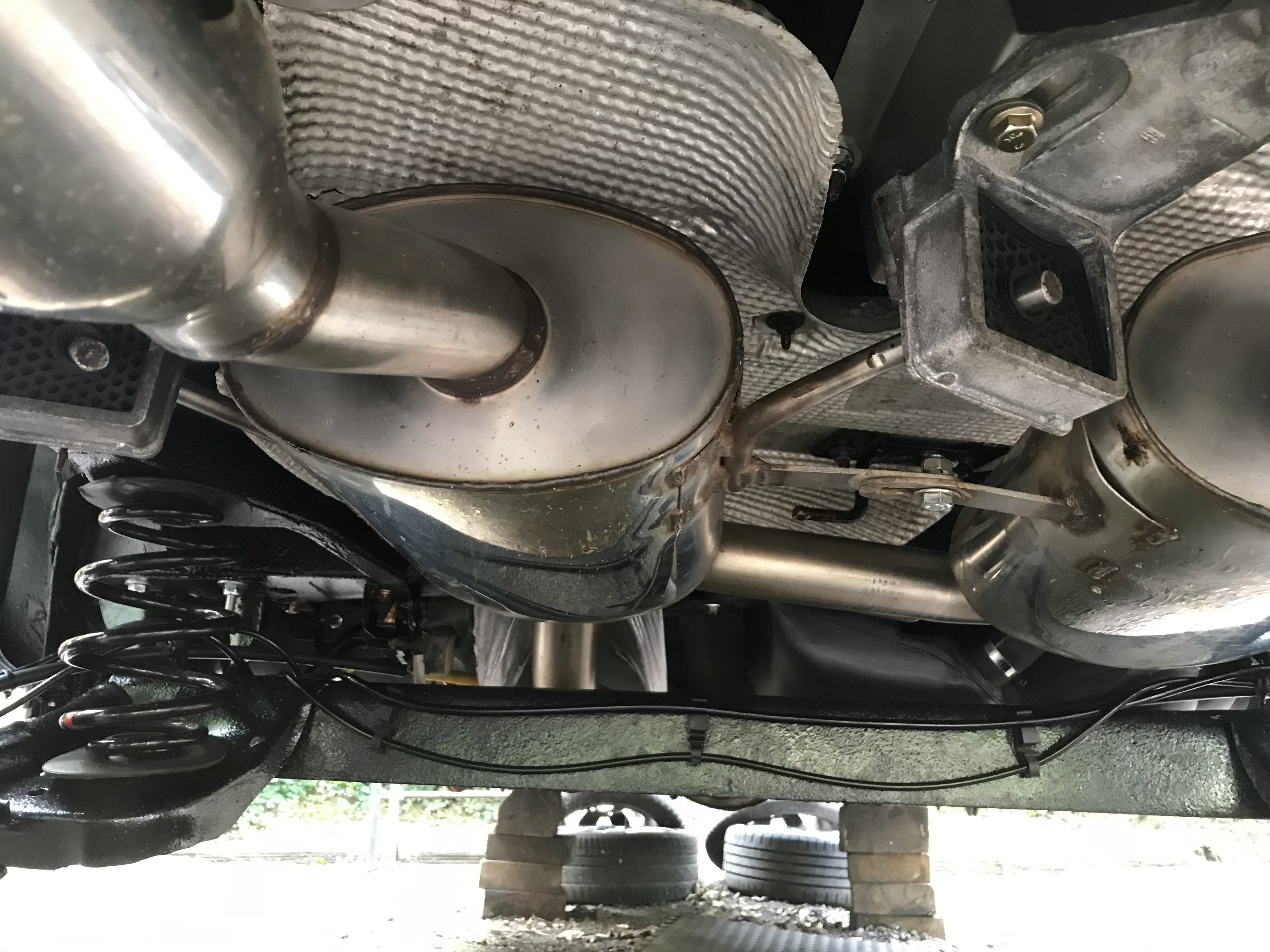

Piece of s**t laptop , i can't use this feckinh laptop of my gf, ff, i stick the pici's up from my lapy soon, the stupid b**ch for having a laptop that i don't know how to use , lol,All back end looking totally new & fresh.

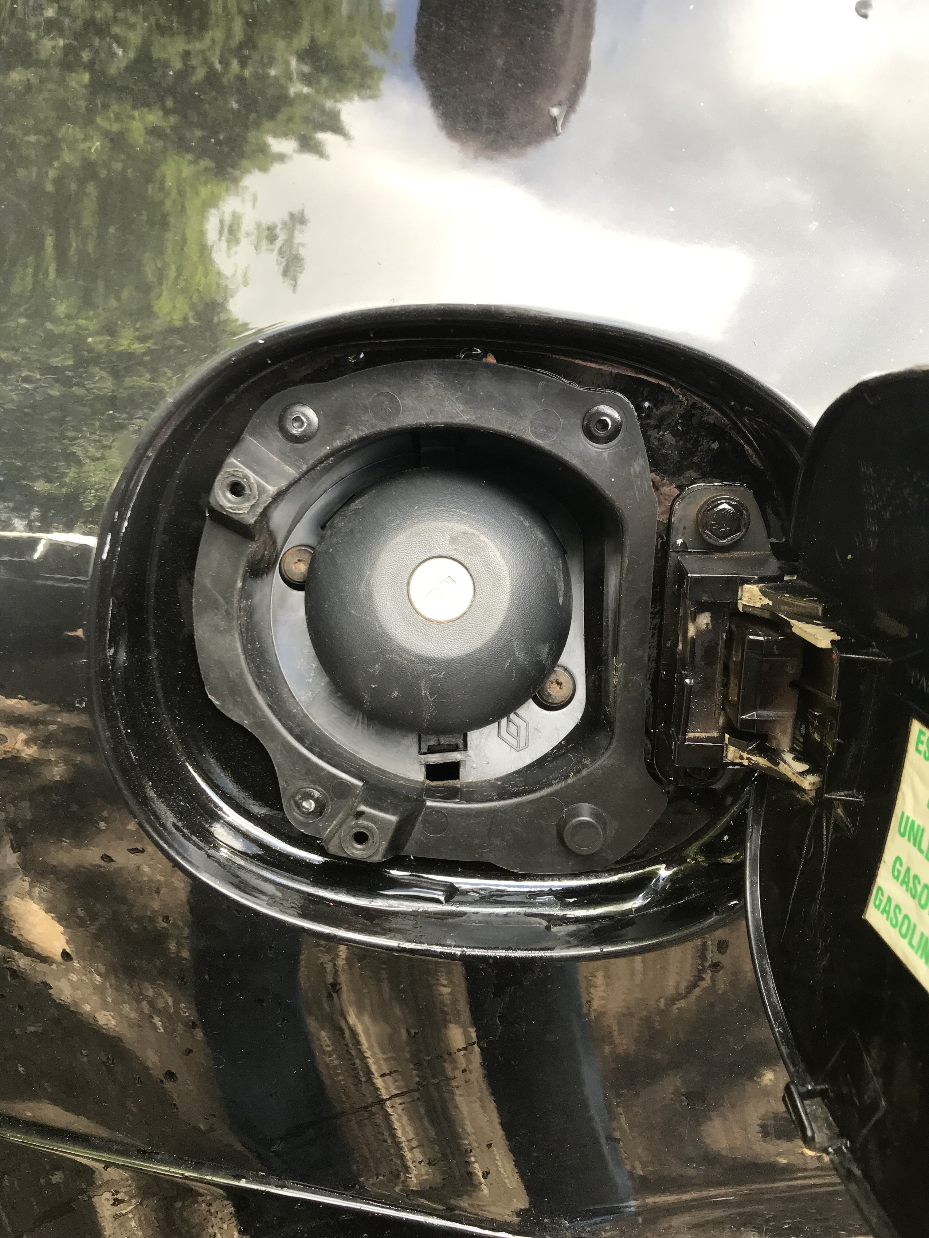

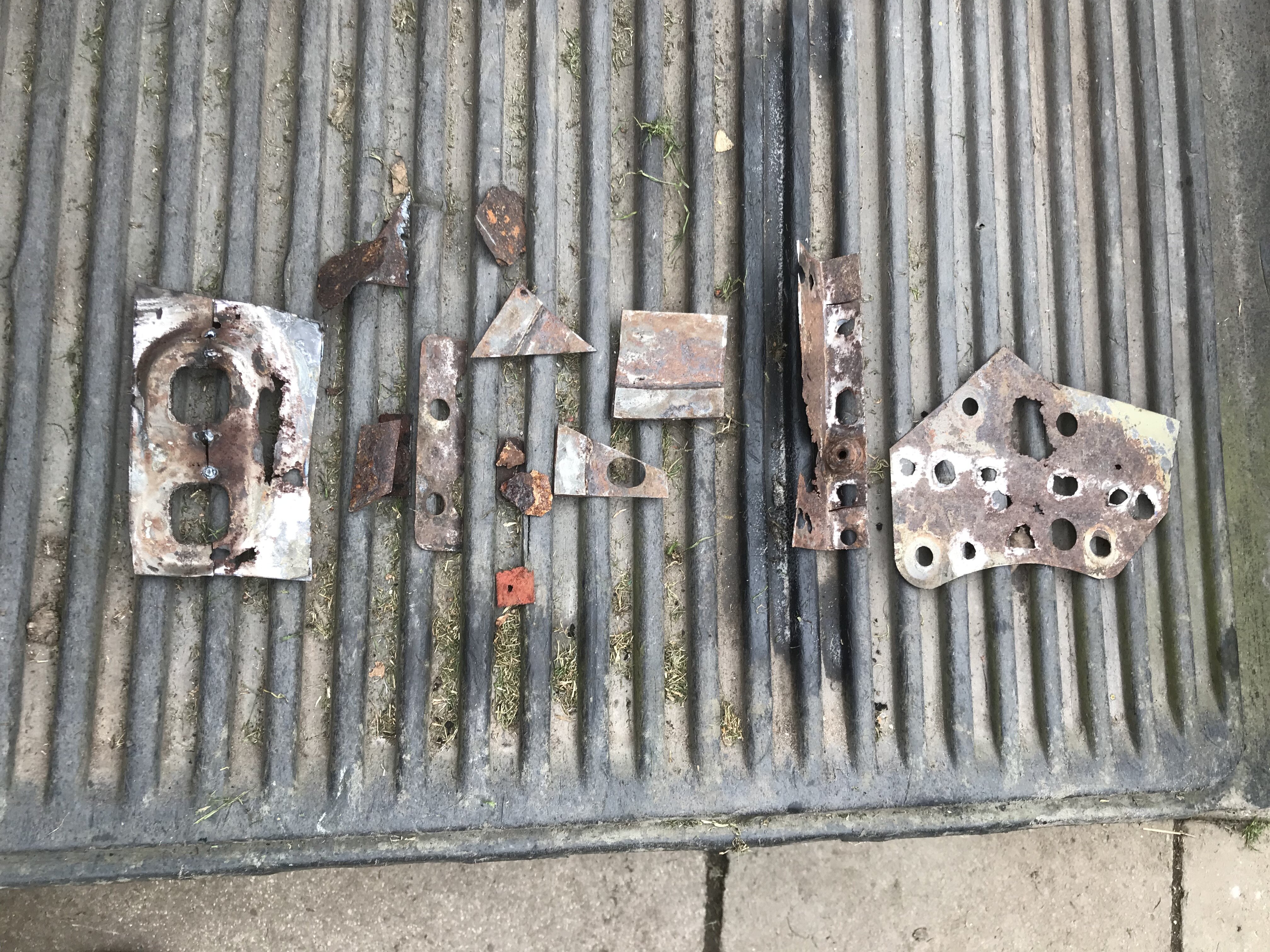

Not the best pici's lads but you sort of get my drift.....i've spent weeks & weeks under the BG cleaning , preping , welding, seam sealing & using the shultz gun, the most thing i'm pretty pleased about is repairing the inners of the petrol flap, seen as it was rotten as f**k and was nearly falling off..I'll try and get a few before pici's up soonish .

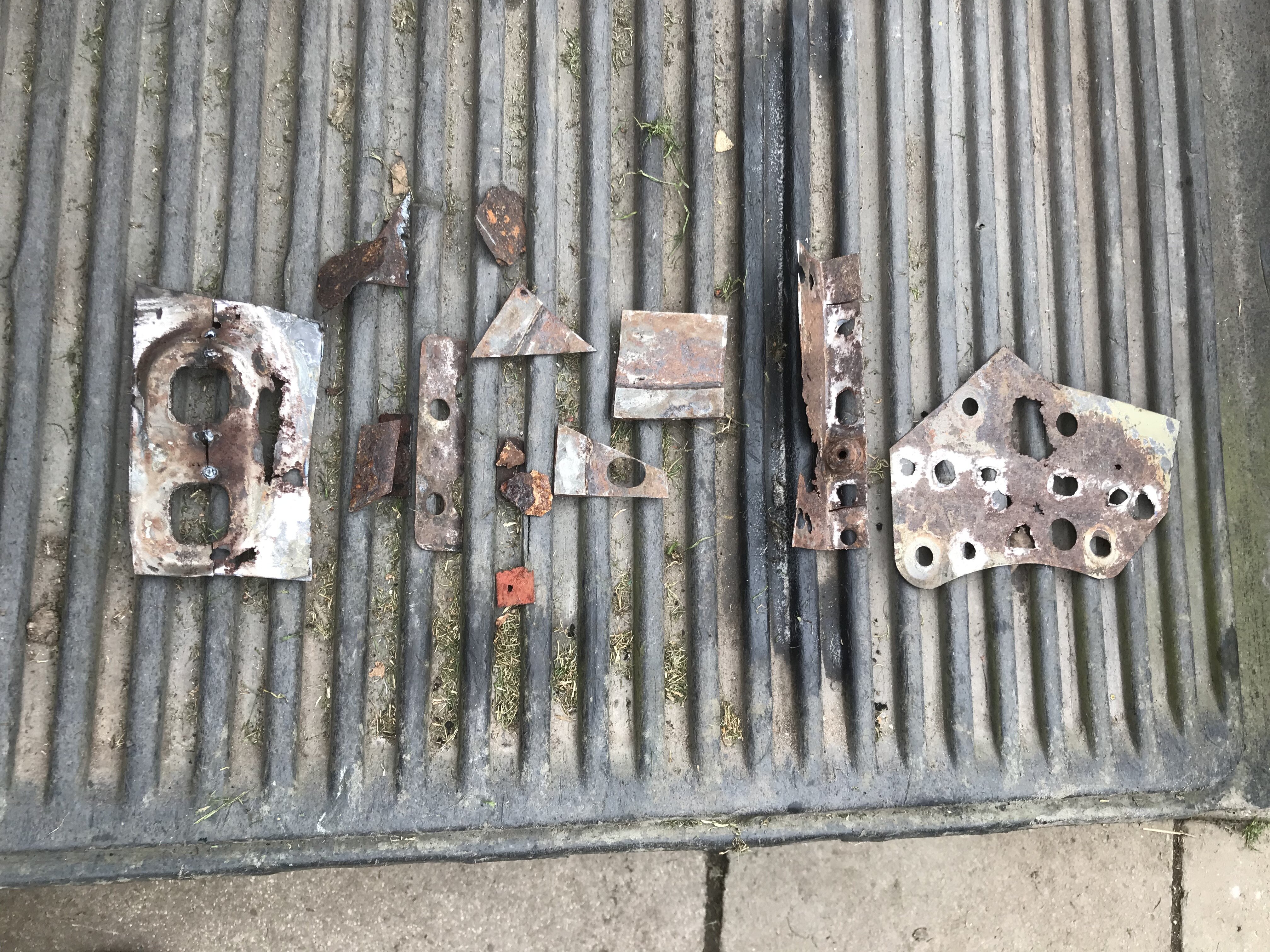

that's all the rotten shite i cut out and replaced with fresh stuff...
