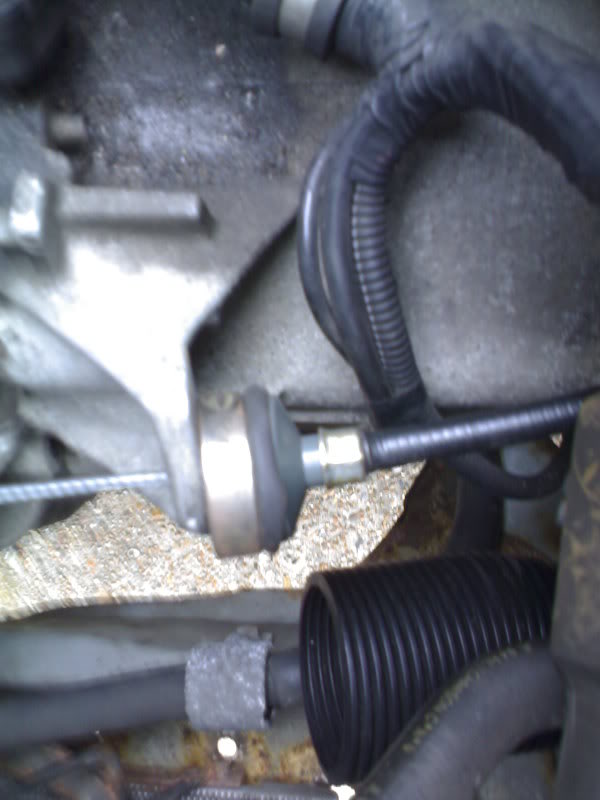

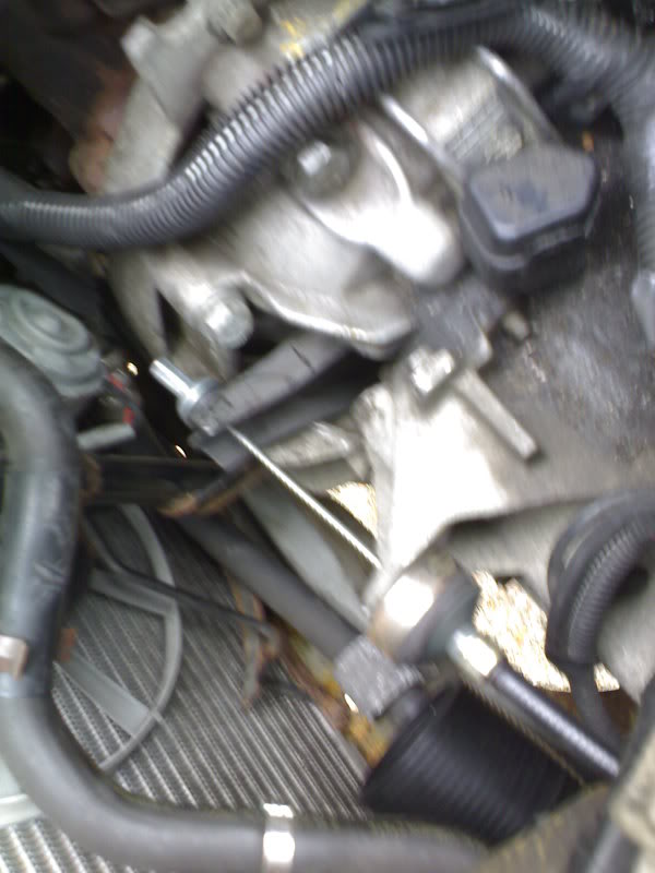

I took the air box off to find this:
Notice the rubber is flat as a pan cake. That would explain the hot engine bit. As adviced by Dan off ClubClio (might be on here too) I was going to space it. Took offf the cable to find the fork was all loose. It's totally fallen to bits. Bear in mind it was only chaged a few weeks ago. It doesn't look genuine mind you. The metal disc is a spacer put in by the clutch centre.
