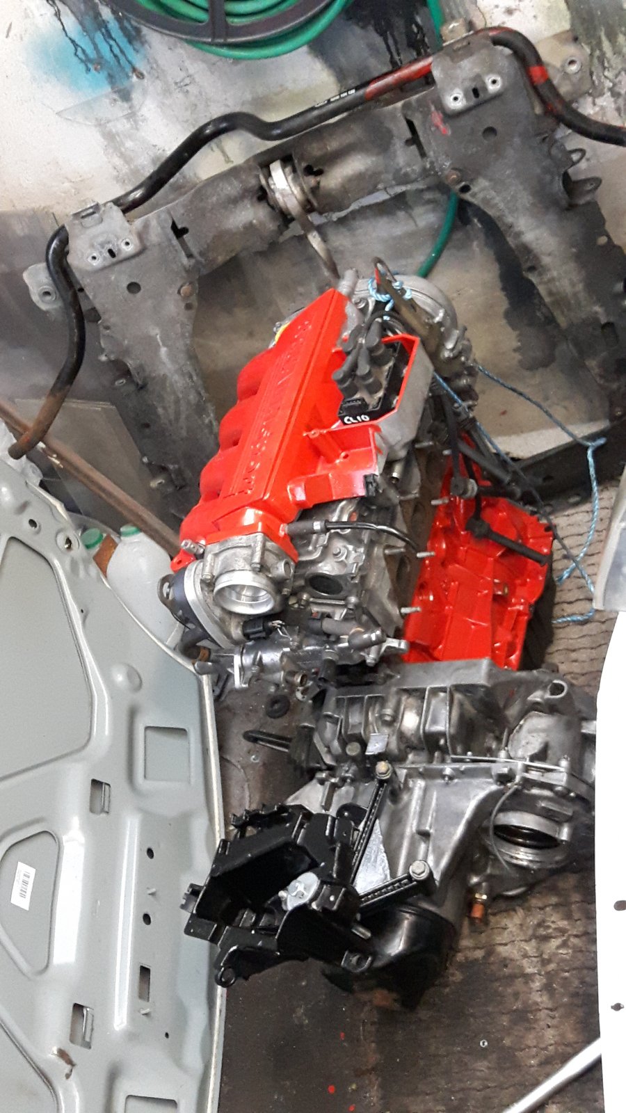

Gents anyone shed any light on the bolt size i require for the gearbox bellhousing to block.
Many thanks
Ah s**t alright mate.
My building a rally car at the moment.
Sourced a car with no engine and box.
So ive bought them sperately. And now ive come to put them together i have none of the bolts. Im guess 3 on top and a few underneath
Yeah 3 on top, 4 across the bottom, a stud and nut either side and 3 bolts for starter motor, I can give you the renault part numbers but I'm struggling at the moment with actual sizes
Ok I think these are correct, obviously if you can get hold of their sizes then you'll find them cheaper elsewhere
3 bolts across top of bell housing
7703 002 687
4 across bottom
7703 002 961
There are a couple of different part numbers for those above but I believe the ones listed are correct, I'd personally check against your chassis number first though
3 for starter motor
7703 002 710
Hopefully it's of some help
