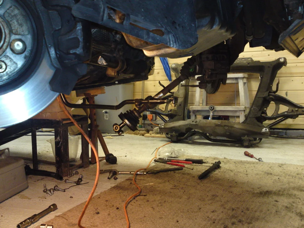

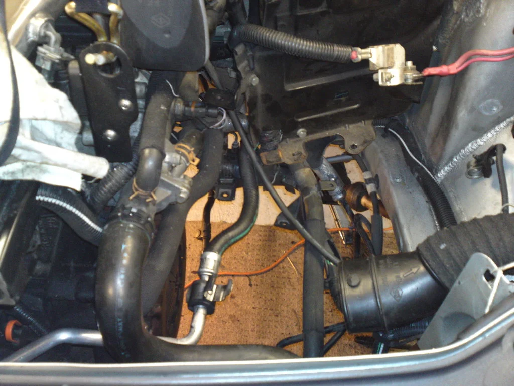

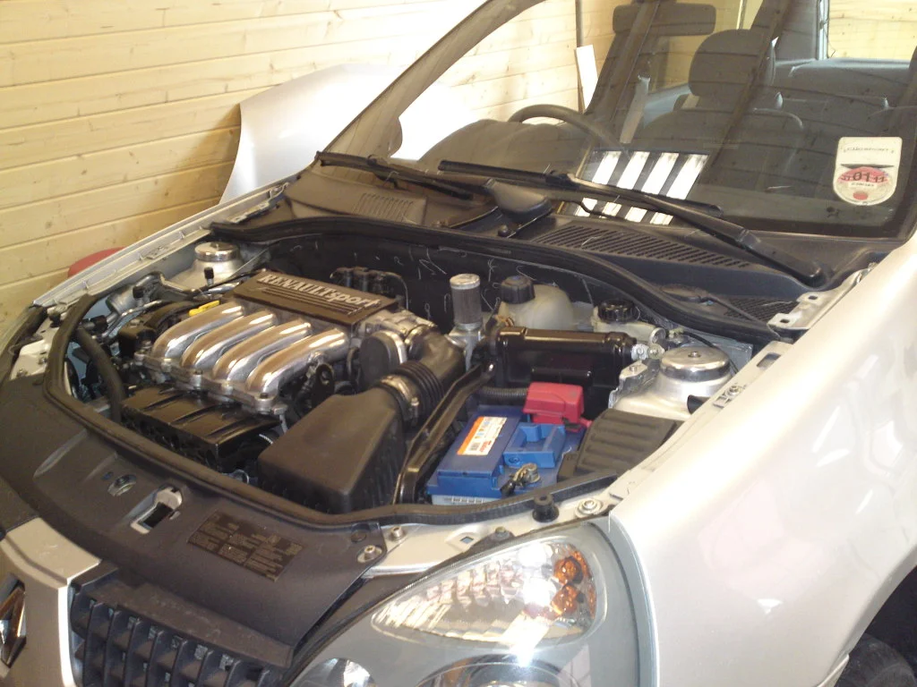

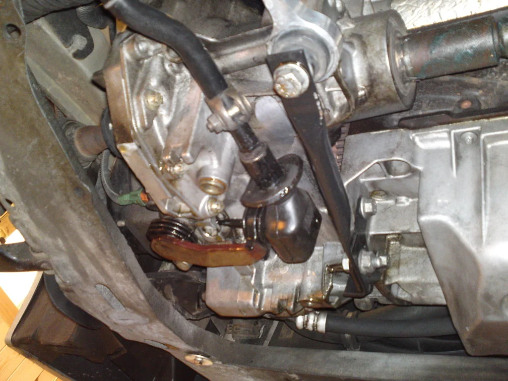

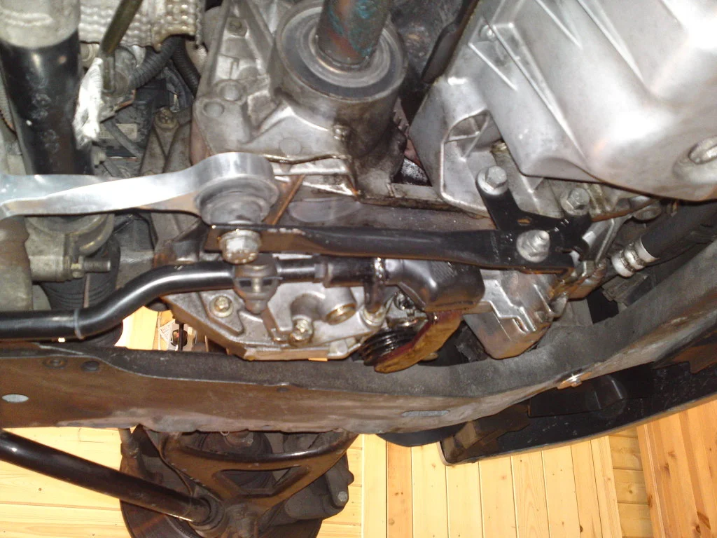

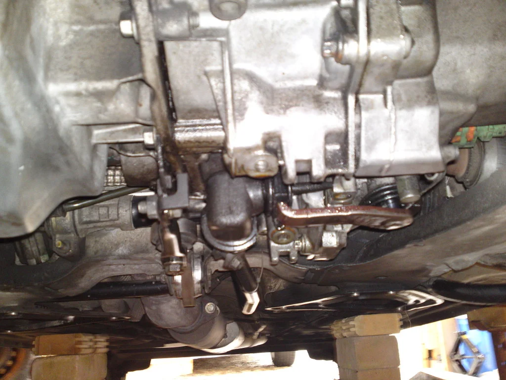

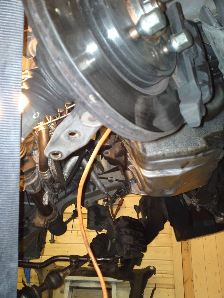

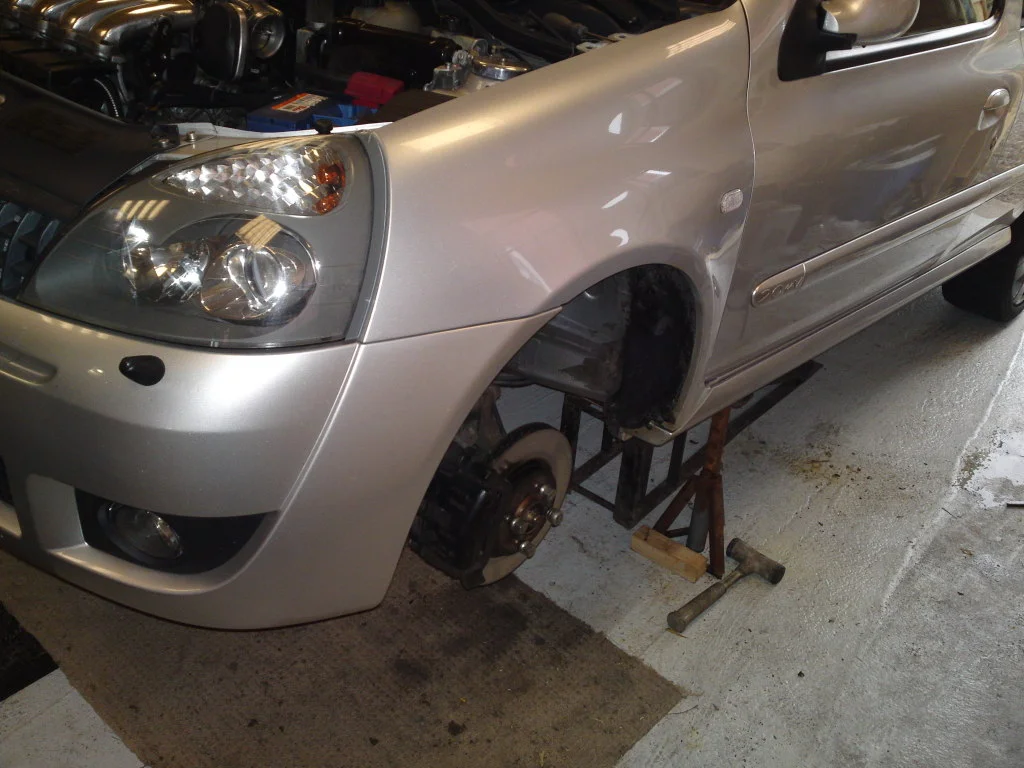

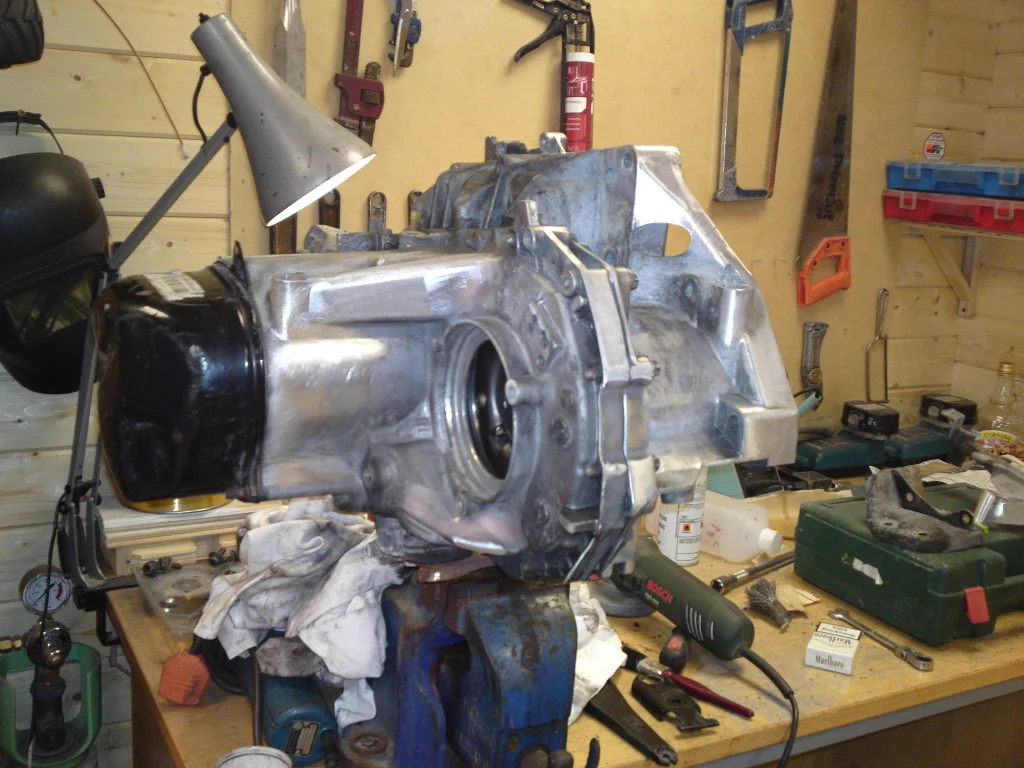

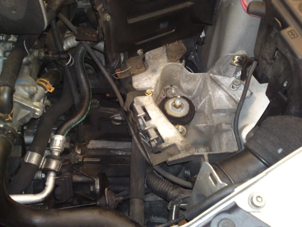

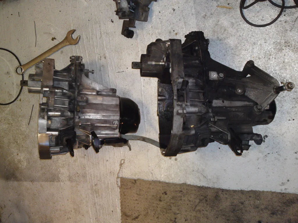

Right got it in. What a t**t of a job.
Only bad bit though was when it would not start after. But sent a text to Budgie and he was able to tell me what to look at.
Wanted to try and take some pics to show how to do it but kept forgeting sorry.
Here are the ones i did take.
