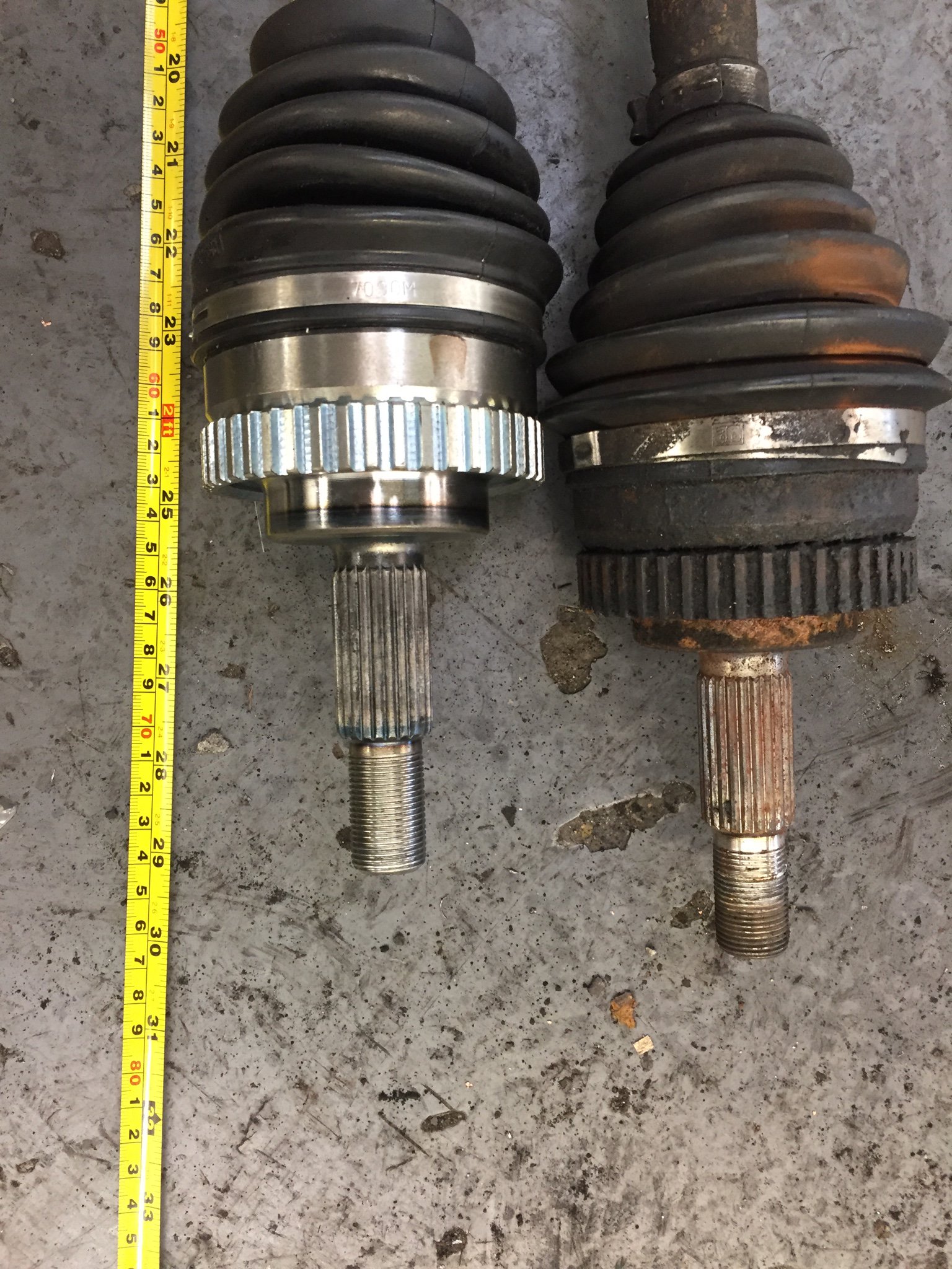

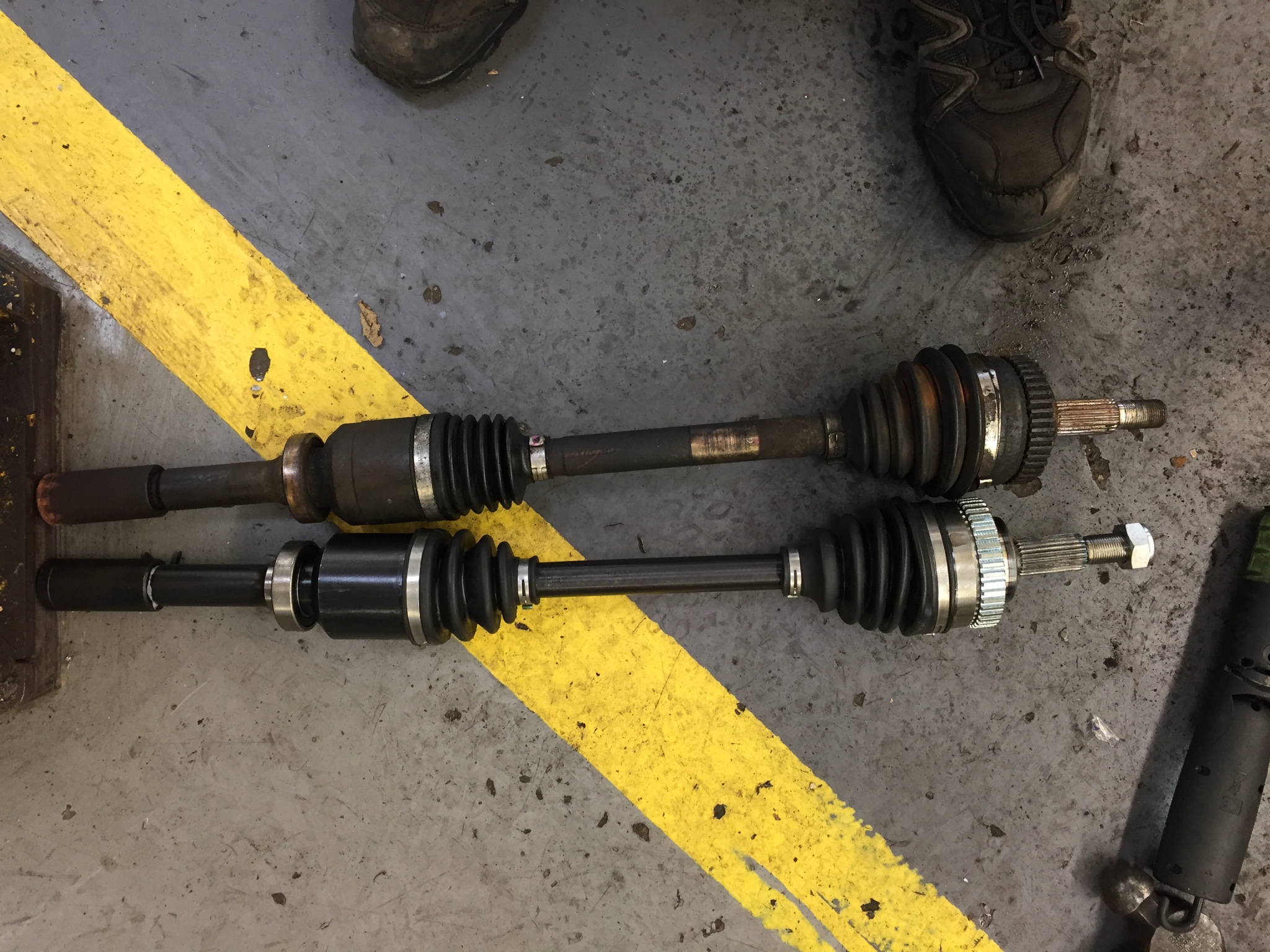

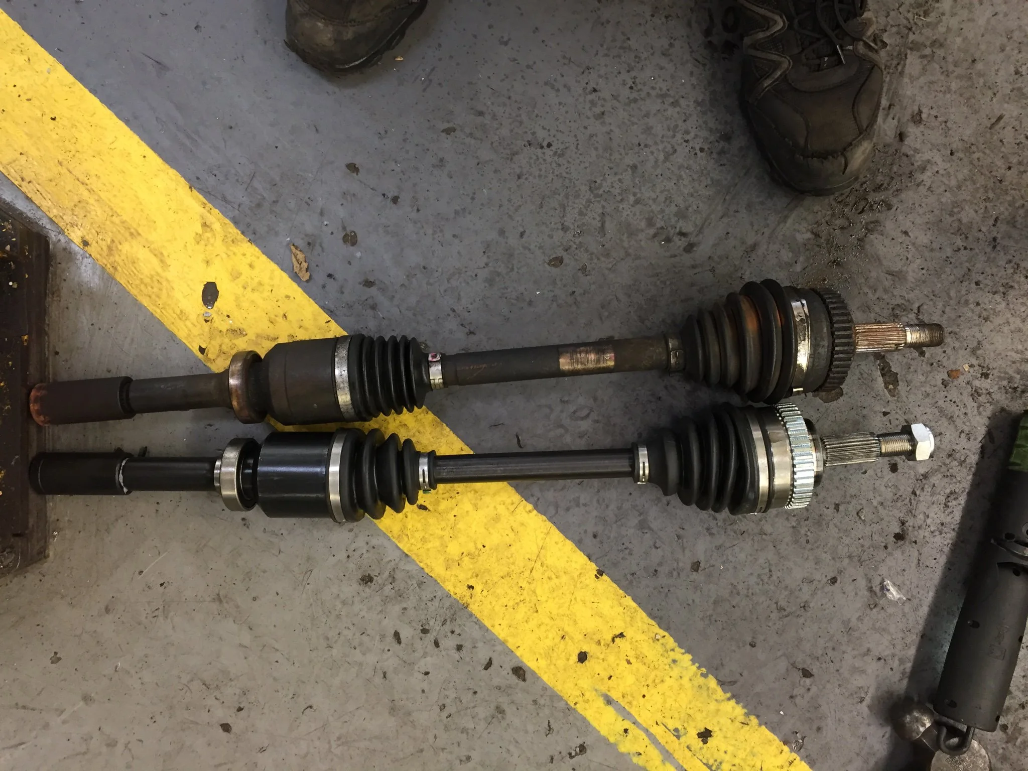

Has anyone got the part number for an o/s/f 182 cup driveshaft?
U ordered one from j&r on eBay which they said was the right one but it must be for a non cup as its shorter.
  PH2 172
I`d start by asking for confirmation from the OP that the Internal Diameter of the wheel bearing on his/her car is 40mm, not 37mm.
As an observation, the inner boot on the J&R item looks baggy, which may result in making contact with the engine block, which has been mentioned in the past.
Shaftec number is R396R. OE 8200372166 or 8201187789.

Got the shaftec one the inner boot is baggy, I made modifications to the back of the block to fix this .
