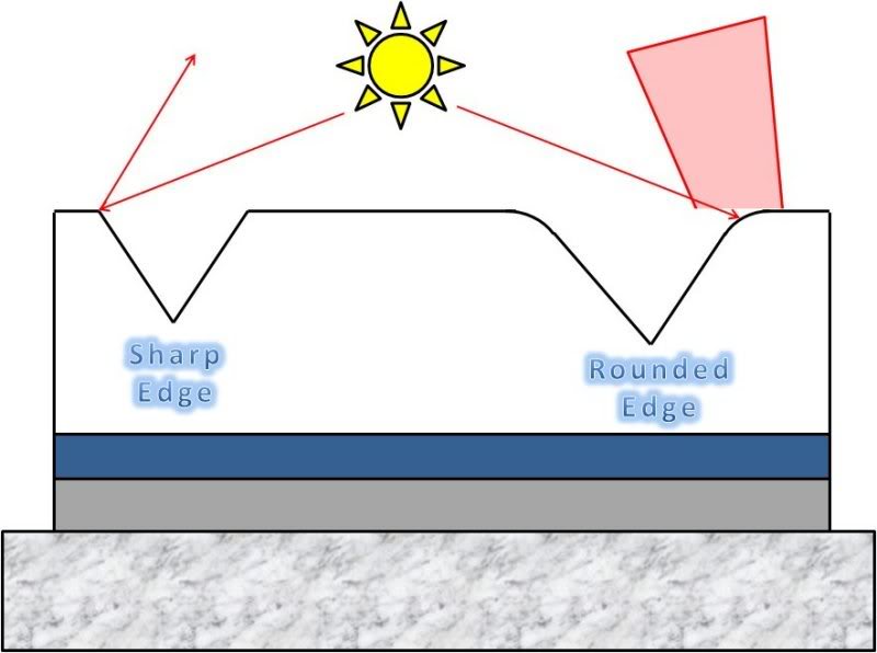

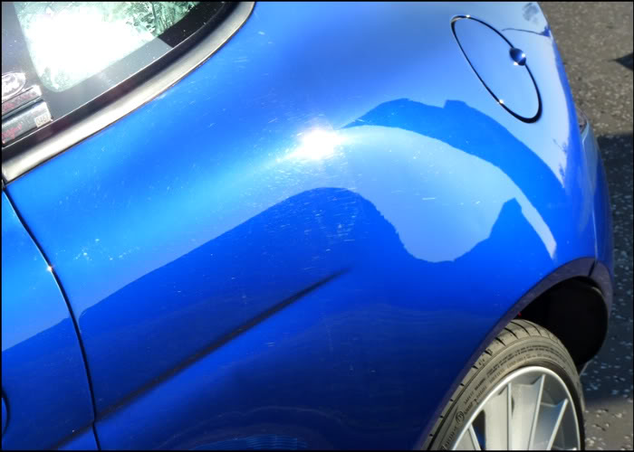

A lovely picture courtesy of Dave KF on DW and a comment...
The sharp edges of the deep mark catch the light and it is reflected back in an intense ray allowing you to clearly see the scratch in the finish. When the edge has been rounded off, there is no intense reflection of the light. It is instead spread over a wider area and it doesn’t appear as easily to the eye that there is a deep scratch there.
This process is not fully removing the marks in the paintwork. Instead it is making them harder to see by essentially softening the edges, which acts to scatter the light rather than reflect it. This in turn makes it harder for the eye to see the marks. They are not fully hidden, but they appear a lot less severe.
(Bare in mind this was for polishing but the light comments remains the same)

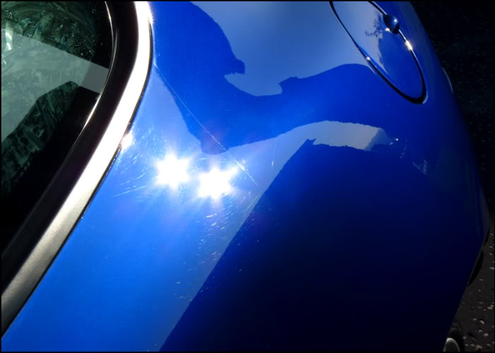

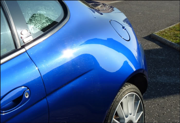

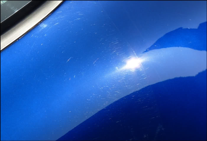

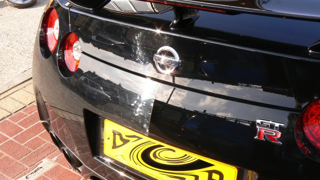

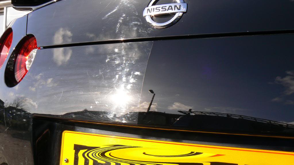

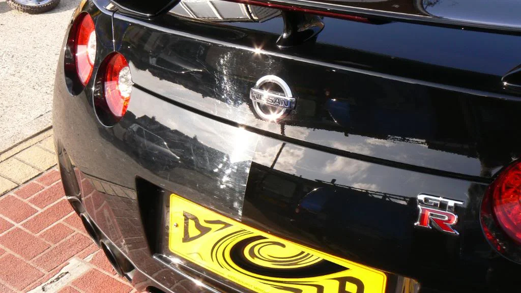

Here are some pictures of what a glaze can do, please bear in mind this was on a finishing pad no polishes of any kind were used...
You can clearly see the filling ability of the glaze, in this case it was Chemical guys EZ creme glaze. A very good glaze I ight add but we'll get to that. As you can imagine after the rest of the car was done, most of the lighter swirls marks were filled and the paint is clearly more glossy and wet if you will.
The above pictures and the thread above were a test of products, i'm lucky that my car has been around 95% corrected with a lot of wet sanding done, what people sometimes forget when looking at DW and all these detailing threads is there is only so much polishing you can do (ClioToby take note! :eek:) and cleacoat you can remove.
In the ideal world, polishing the car once and then using the correct washing methods etc you should have to correct your car every year. I've seen an old daily driver after 2 years have less swirls on it than my car has. All because the wash and dry technique was spot on.
Sadly in the case above the car after it's MOT made it's way into the hands of said garage's valeter, the message was sadly not past on not to clean the car.
At this stage I could have polished the car and got it back to a decent level of pure correction but I was already planning on giving the car a full detail before CSS, using common sense, I didn't want to be polishing the car twice in such a short space of time hence the glazing.
So to summarise this part: Glazing can be used as a safe substitute to polishing for a temporary fix. After Glazing a nice wax or sealant can seal those fillers in for longer and after they are "washed away" you can re-apply in no time at all.
