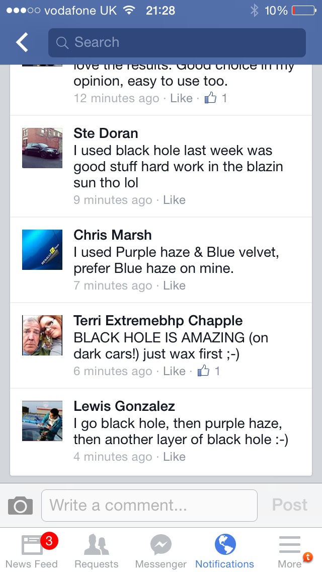

What's everyones opinion on a sealant Togo over prima amigo on my trophy? I'm looking at zaino z2 at the minute. Process will be strip the old lsp, clay, prima amigo then a sealant Any good?
Gally
Perfect. Get 2 layers of Z2 on mate. One of my favourite combos. :)
Sunglasses_Ron
ClioSport Admin
Is it me being a t**t? wax before glaze?? Is that just pointless?
Gally
Lols. Guy is a mong. I've no idea where he would even come up with that idea!
