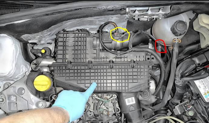

So just changed the standard air filter to a ramair, connected maf sensor back on but noticed there was a little wire connected to the old air box anyone no what that was for?
also glow plug light just started showing once turned it on any idea why? thanks

Glowplug light is the engine management light. Probably on due to the sensor not connected

cheers bud ill check tmor morning maf sensor connected but ill disconnect and try again there a little wire that was connected which isnt connected to anything now not sure what that is for tho.

Get a pic up mate. Get it plugged into clip for diagnostics, fault code will be stored

Here a pic from online mate, red one is the little wire attached to the old air filter and the yellow is the MAF sensor as your aware,
