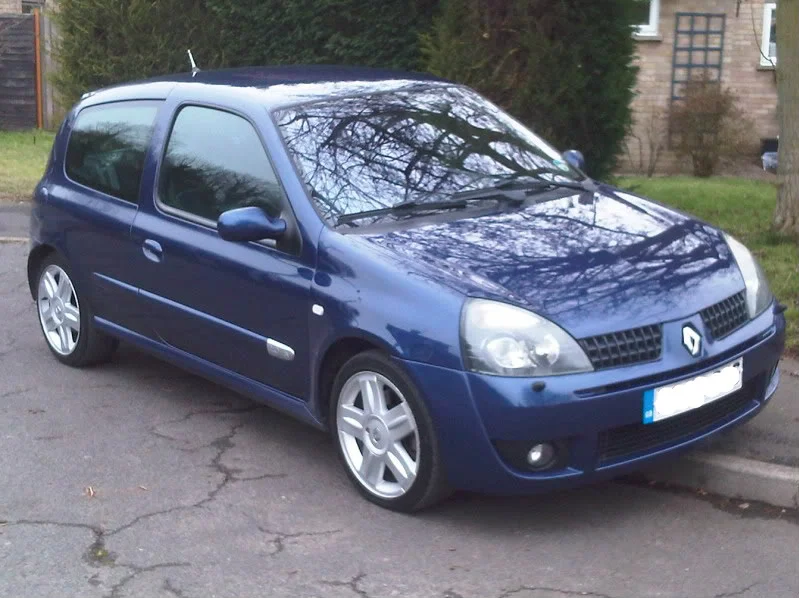

well my headlight lenses look like someone has washed them with a scouring pad so tomorrow i'm gonna have a go at cutting them back to something that resembles headlights!
not a close up view but you can just about make them out.

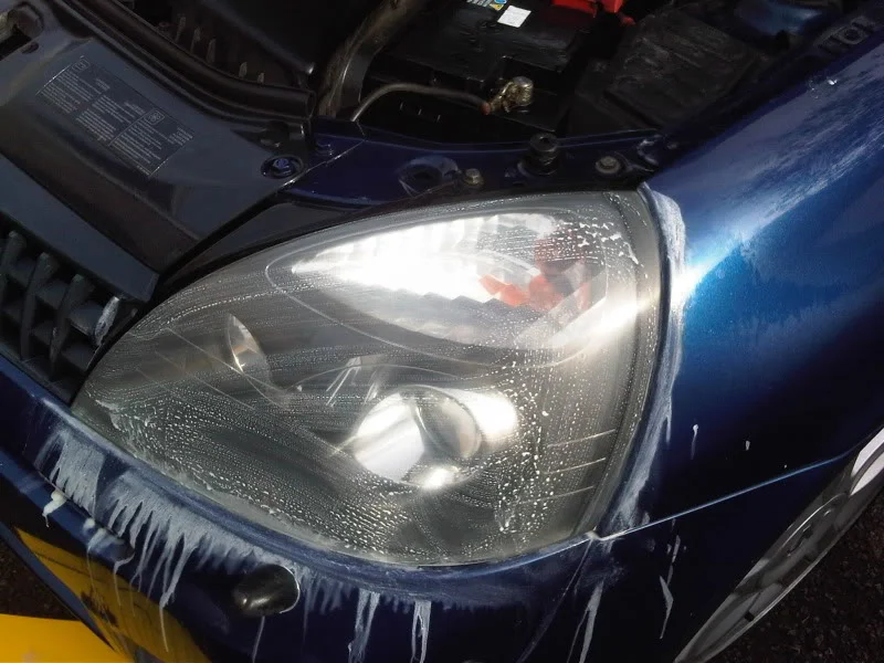

Well I went with the method of.....
Firstly a damn good clean up with white spirits

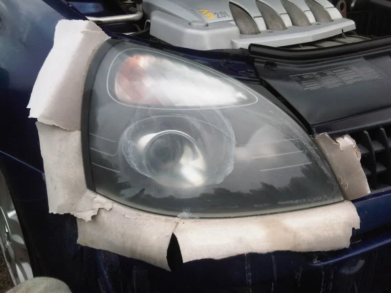

used wet n dry sandpaper throughout
started with 600 dry
then 600wet
there was what looked like a laquered layer that had worn off the top quater of each light so the rest had to go too! :cool:
then stepped up to 1500 wet
2000 dry
2000 wet

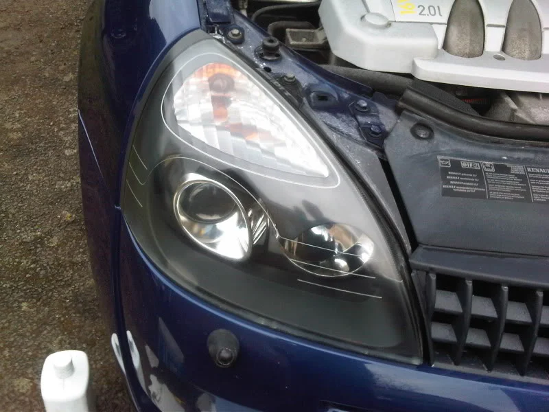

cut it all back with some halfords cutting paste (yellow tube) as it helped to identify any areas that needed a bit more work.
then i went for 2500 dry
then 2500 wet
another going over with the cutting compound
and then a damn good polish with autoglym products
A couple more bits to have another go at but its a huge improvement, thanks for the tips guys :approve:
