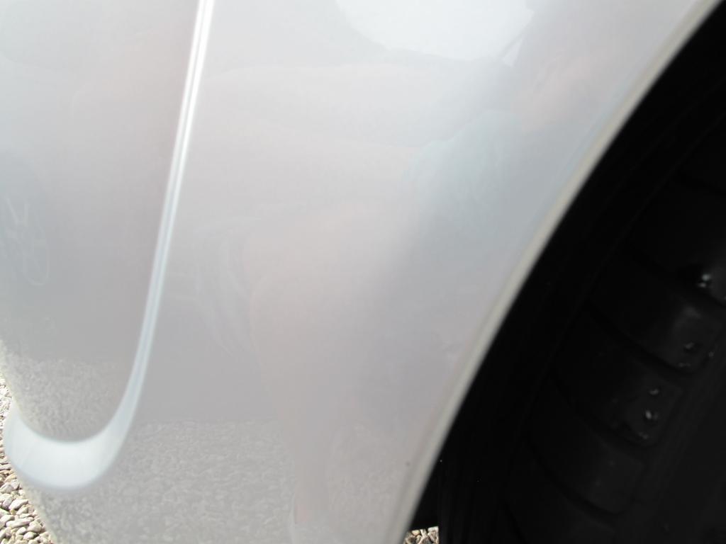

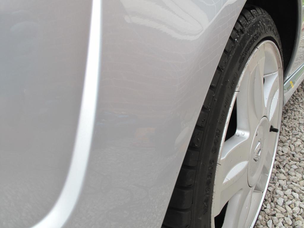

For bad scratches I have used Megs 105 and 205 with a DA. They got this scuff out my rear bumper after some prat hit me and drove off!
Before
After
You can use it by hand as well and its just as effective, just might take a few more goings over than it did with the DA.

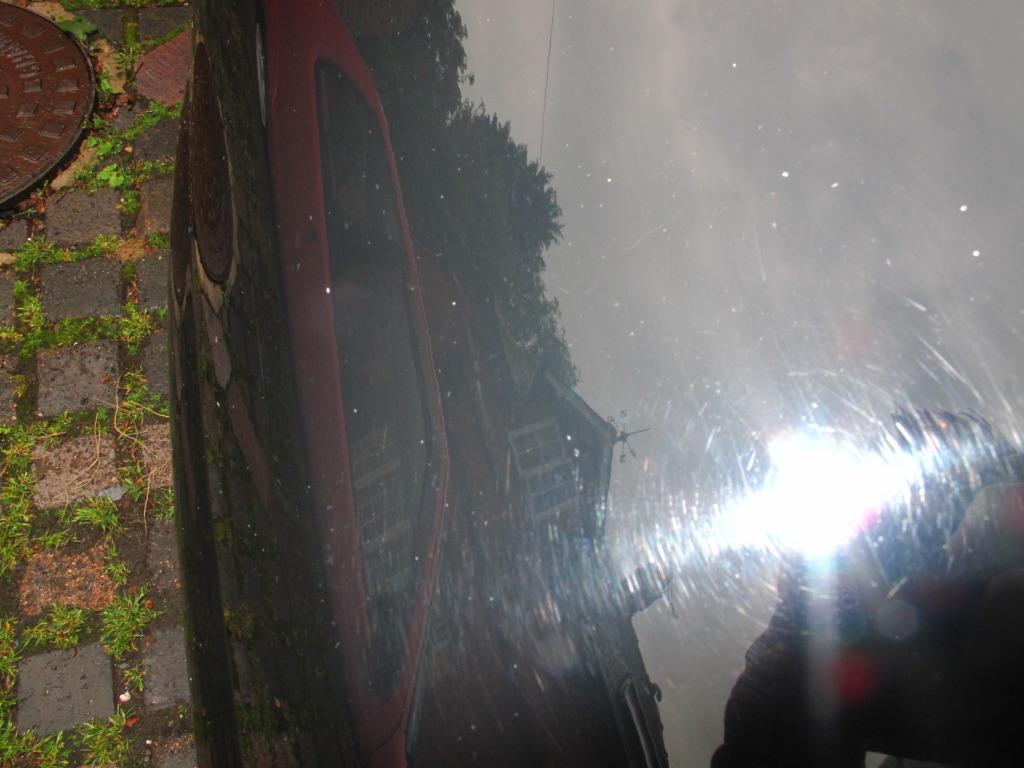

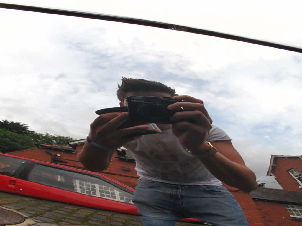

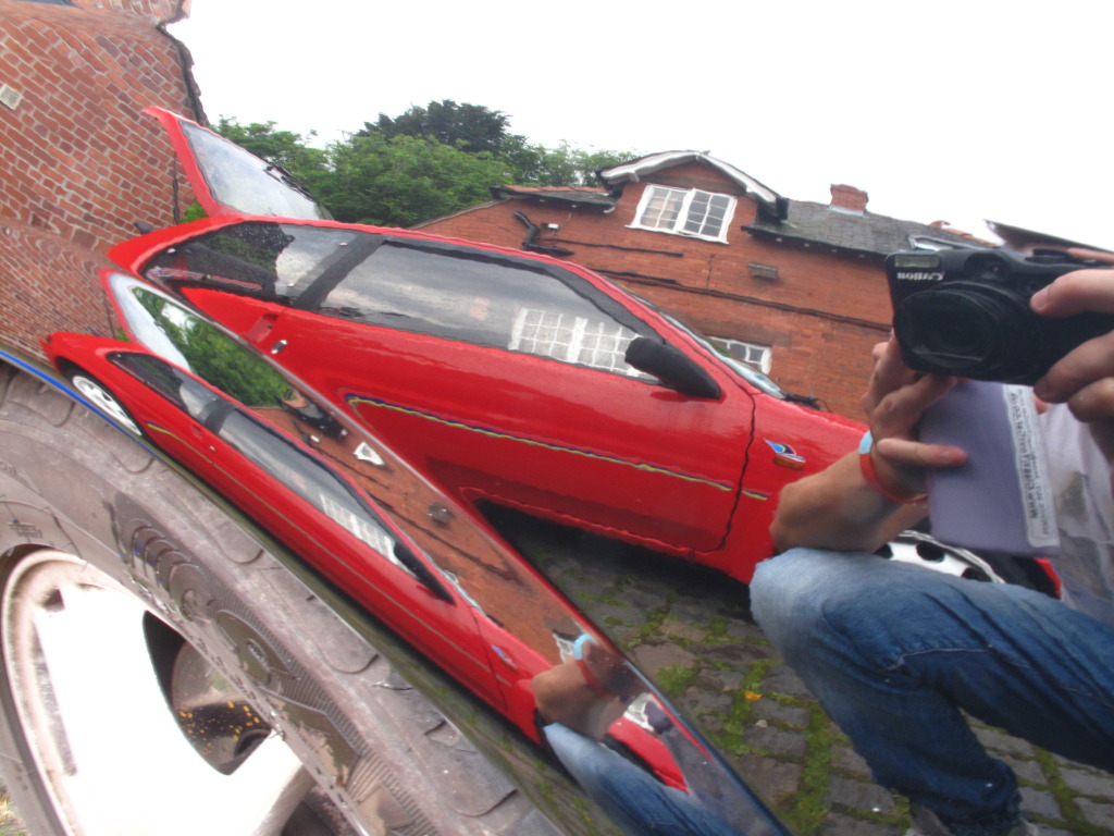

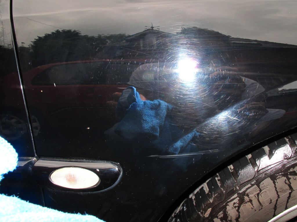

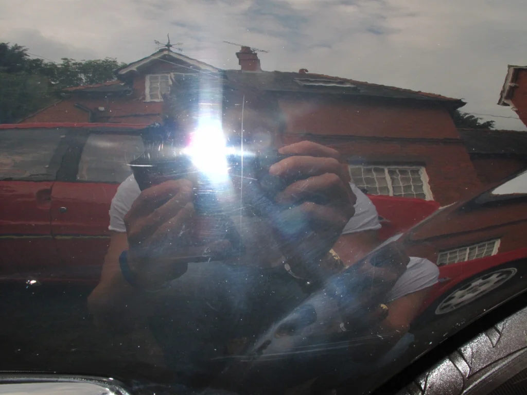

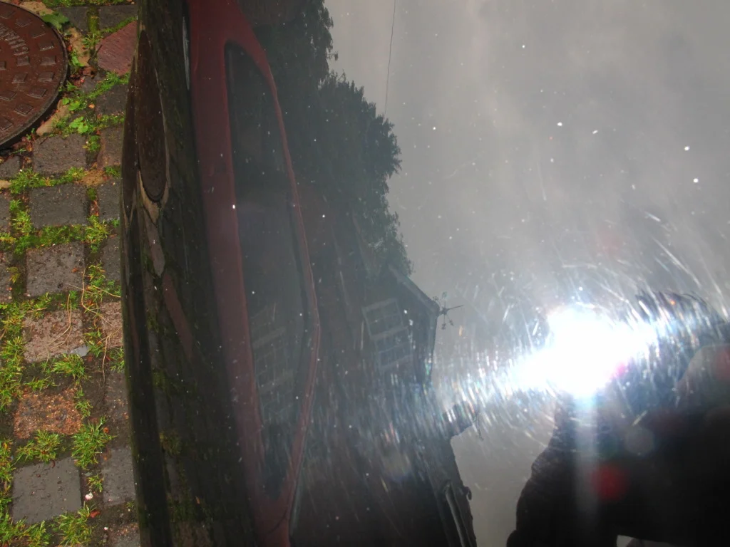

I tested out some new products on my mates car to see how they worked on black paint, all done by hand.
Start:
During:
After:
That was with Megs 105 and 205, a glaze and wax coat. Hand polishing gets some amazing results if you take your time.

Im not familiar with megs but is that a cutting polish or a filler?
Looks good but obviously if its just fillers then the scratches will still be there
  Clio 172
the 105 is a cutting polish, the 205 is a finishing polish to buff the clear coat back up. :) I tend to couple it with a polymer Glaze to help fill and remaining scratches that i missed by hand and then wax it all in!

Great improvement
  Clio 172
Great improvement
Cheers. It wasn't perfect as can be seen in the last picture, still a few swirls and scratches, and the residue around the indicator and bump strips. I was just playing with product combinations and hand polishing cloths to see what would work. The rest of the car was bloody horrible! haha

@JAMason what sort of hand pressure were you using with the megs? and how long on a panel?
Sorry for the late reply, iv been on holiday. About half an hour or 45 minuets on that panel. The pressure varied from pad to pad and the differing products. Just usining common sense and your eye you can work out what pressure to apply and if it needs going over more than once. :)
