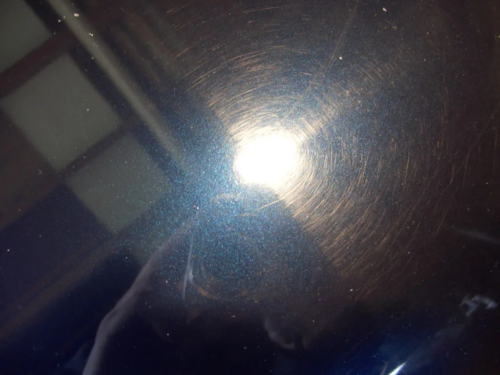

My G220 arrived on Friday and I had a quick session on the wifes 106 GTi to try it out...
As you can see, it was swirled to death originally and the G220 got them out :cool:
Not done the whole car yet as I didn't have time, but will be doing it soon and it should look amazing, just in time for it to be sold

that pic shows it after a hit with Poorboy's SSR2.5 and a Sonus SFX-1 (yellow) pad
I then followed up with Autoglym SRP on a white pad, which didn't remove any more defects but brought it up to a superb deep shine, ready for wax over the top, which I'll do by hand
it's a 1999 car with 79k miles, but it's not been looked after well in the cleaning department, we've had it 3.5 years now and I never really bothered with it, but we're selling it so it's getting sorted :cool:

I use the Sonus SFX pads, in both 4" & 6" sizes, with the Poorboy's SSR compounds and Autoglym SRP, finishing off with Collinite 476S wax by hand
see my previous post for pad/polish combos
