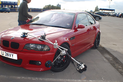

Here is mine - The Pro Mount SM8 kit via Fast Films
As you can see, its a pre-built rig and then just gets put together on a car via suction cups.

That rig looks incredibly hard to PS out! And I would know, I used to have one with the same design, Ive since upgraded mine though.
Agreed! I did hit a big barrier when I figured out that how difficult some clone situations would be but I have figured something out. I have a second mount which I can clamp to a tripod. Remove the rig with the camera clamped and just take a stationary shot. then just blend the two shots together.

awesome guide man. i really like your shots aswel. any links to where this rig can be purchased?
  Renault Clio 1.5 DCi
Judging by the information in his first post I think it must be this one dude: http://www.fastfilms.co.uk/camera-suction-mounts.php
Edit: Oh and the fact that they've used his photos as well lol.
Spot on. I was a bit worried about weight but the guys were very helpful. Was happy with results so provided them to use,

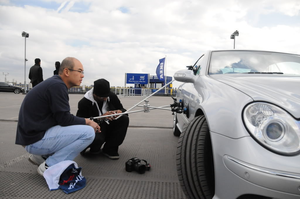

Ive just finished making my new rig (revision 3!), and basically it's a copy of the one in the photo above, but it didnt cost me £500+!!
I cant provide any links, but tbh it's pretty simple.
Alu pole
Steel cable
Pivot
Lots of jubilee clips
Clamps to bolt it to underside of car :)

Only got pics of the clamps at the moment, but it is VERY similar to the one above.
The cable is what holds the two poles joined at the pivot, and determines the angle (you can see it on the pic you posted)
I used to use IR on my D70s, but I sold that, and my D200 doesnt have that function :(
But as Im always concerned about the welfare of my precious camera (;)) I always walk along side the rig and just take the photos as normal (with someone else driving)

How easy is it to swap to different cars? Those bolts must make it a little harder to swap over?
This design will take longer to set-up for each shot, but thats a small price to pay for the better photos I should be able to get with it!!
Im taking it for a test friday night in a multistorey carpark (as the weather is looking crap :() so I'll have a play then :)

i might sound stupid, but what is stopping the grub screw type arrangement your using slipping down the sill? Is it ridged on the other side? Or are the grub screws/bolts pointed?
  1.2 Dynamique billabong
No not a silly question. Tbh I thought exactly the same thing when I first saw the idea! BUT I have tried it out quite a bit over the past few evenings to make sure it is stable, and the fact is that they just hold fine lol!
No problems at all so far!

I assume you mean the pivot part that the two poles connect to.
If so, it does lock yes, but that would be no where near strong enough to hold the pole up on its own. The main part responsible for that is he cable that joins the two poles.
The photo above shows it at its longest setting, with 4m of pole coming from the pivot. Tbh, I wouldnt use it much at that distance because it is quite far from the car lol! I will probably use it at its 3m setting, which is still quite a bit futher from the car than I had previously....so Im extremely happy with the setup so far, and I cant wait for tomorrow eveing for its first test run!
It is remarkably sturdy despite the look of it lol!
I got home to test it with the vision of having all sorts of problems, but I didnt have a single one! The clamp holds the entire rig with no problems.....so far!

Is there much flex in the tube that sits up at an angle? What kinda Dia and wall thickness is it?
Looks good for a DIY job!
A little but nothing unbearable.
The most flex occurs on the pole that runs underneath the car, as it flexes between the two clamping points, but I have a proper pikey solution to that.....stick a bit of wood between the pole and the underside of the car, then the pole cant flex upwards!
All of the pole is 2" diameter, wall thickness is 16SWG (1.6mm). I could have gone for thicker walls, but then of course it would be heavier!
