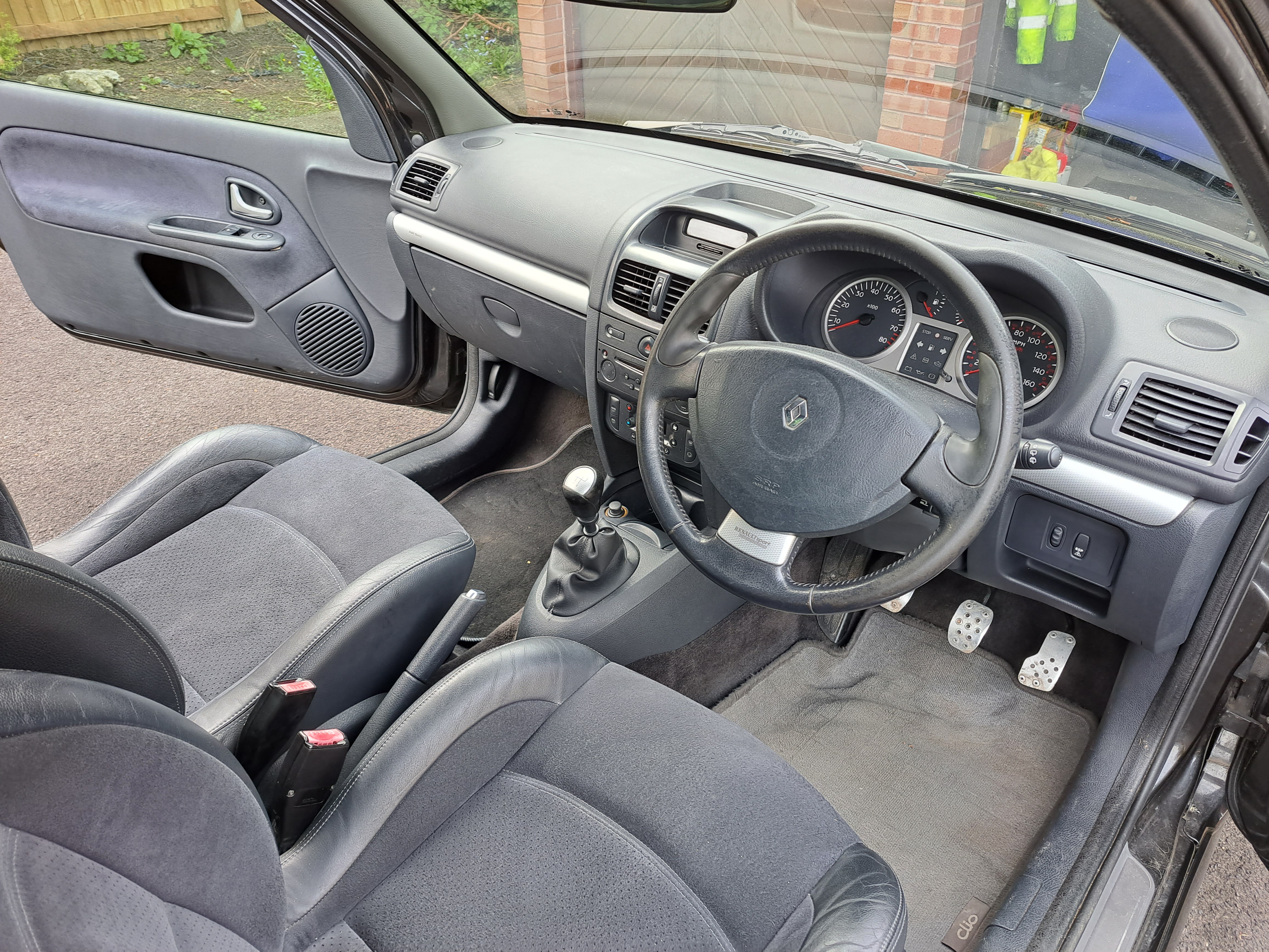

With that in mind, I set out to find a reasonably tidy but standard car which possibly needed work anyway and take it from there.
After a few months or so of browsing I became the owner of this 53 plate 172 with 100k on the clock:
The car was a very long way from my house, but the price was right and it sounded like the perfect starting point. It was advertised as spares or repairs due to having the engine warning light on and a few bits of body damage, but it was in daily use and had an MOT. I noticed the power steering was squealing during the viewing but the rest of the car was tidier than described so a deal was done. The chap I bought it off seemed pleased that I was going to do something with it, as all the other enquiries he'd had were from people wanting to break it.
It drove the 250+ miles home without incident, and thought about the next steps for my 'cheap' rally car.....

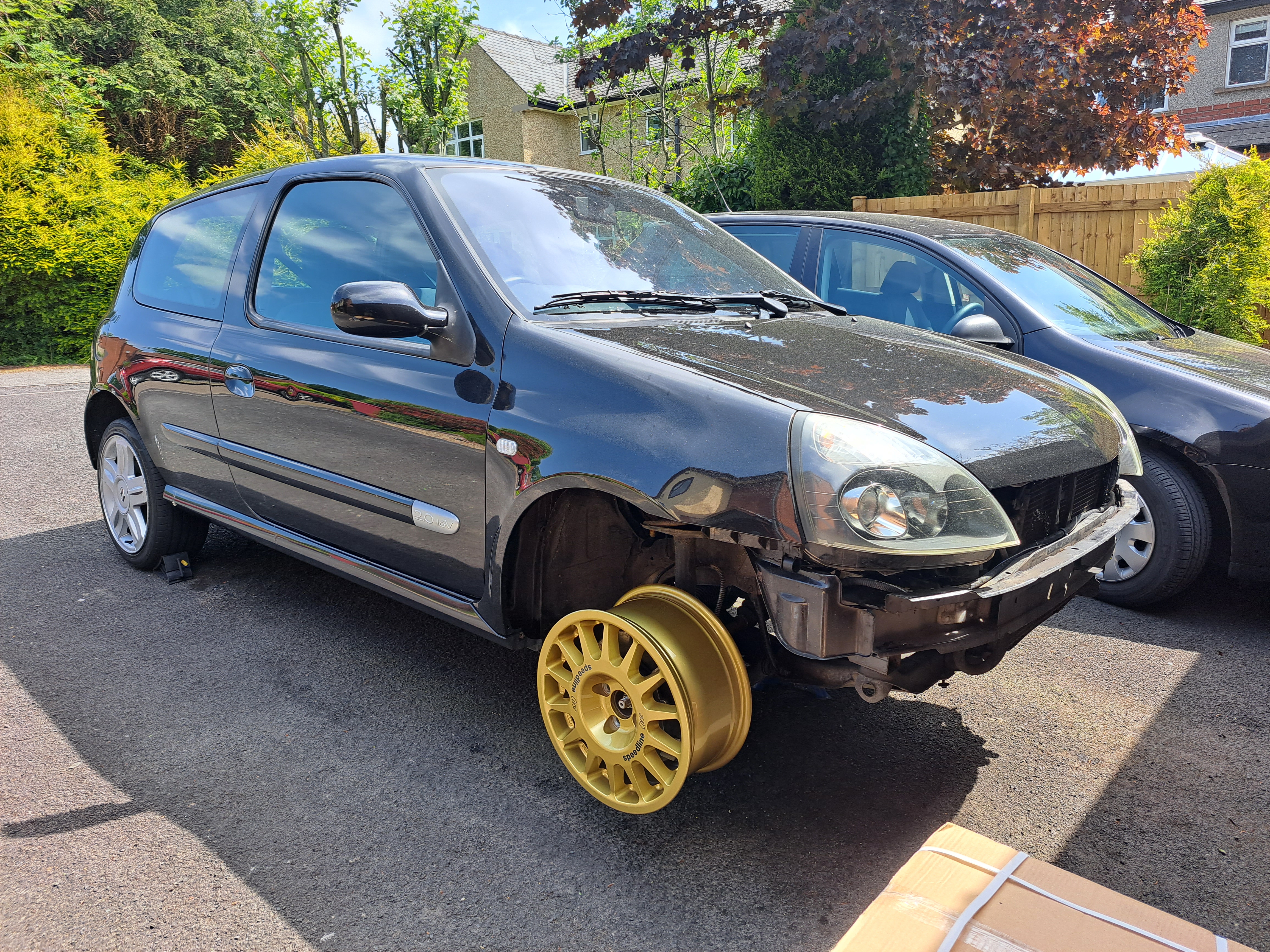

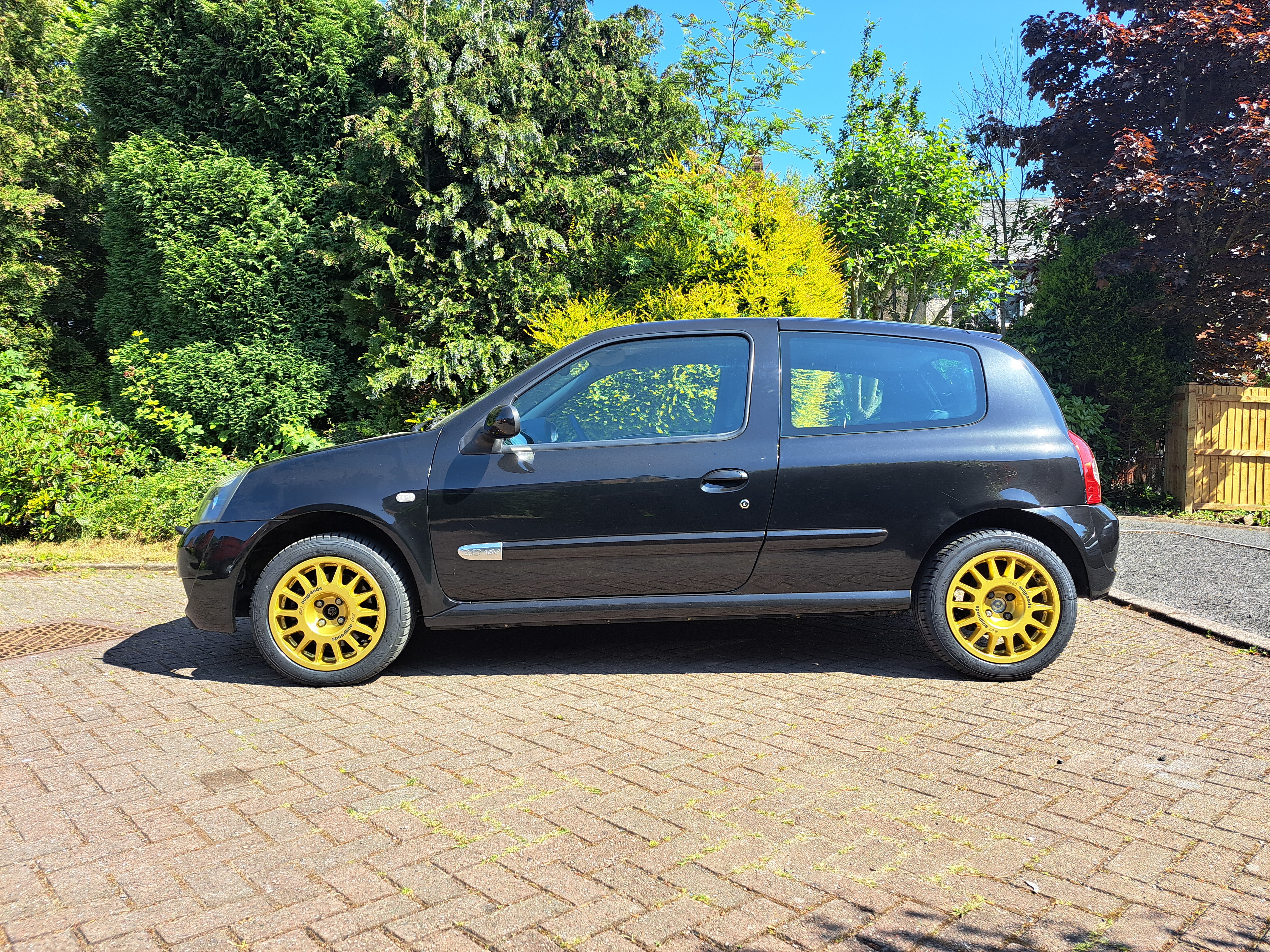

Now came the first significant decision... I knew that long term I wanted to run 15" wheels as having the option for a much deeper sidewall is good news when you're dodging potholes and rocks (or not), and good quality 15" tyres are generally noticeably cheaper than their 16" equivalents. The problem was that the tyres on the car were rubbish and I didn't even want to potter around on them whilst I assessed whether the car was fundamentally sound, but I didn't want to shell out for some 16" tyres I wouldn't keep.
Inevitably, I decided I should just go straight into the 15"s. Originally I was considering some turinis, but I was advised that I would possibly find myself breaking them if they took a hard hit. I therefore decided 2118's would be the better option, and after a few weeks not finding any for sale second hand at a reasonable price, I had a moment of weakness and....
I would have preferred them in silver but the 15's are only available in white or gold, and I wasn't going to have them resprayed - this is a CHEAP rally car remember...! My logic was that the wheels would still be worth good money if I bailed out of the project early anyway. A set of Michelin Pilot Sport 3's later and we're back on the road.

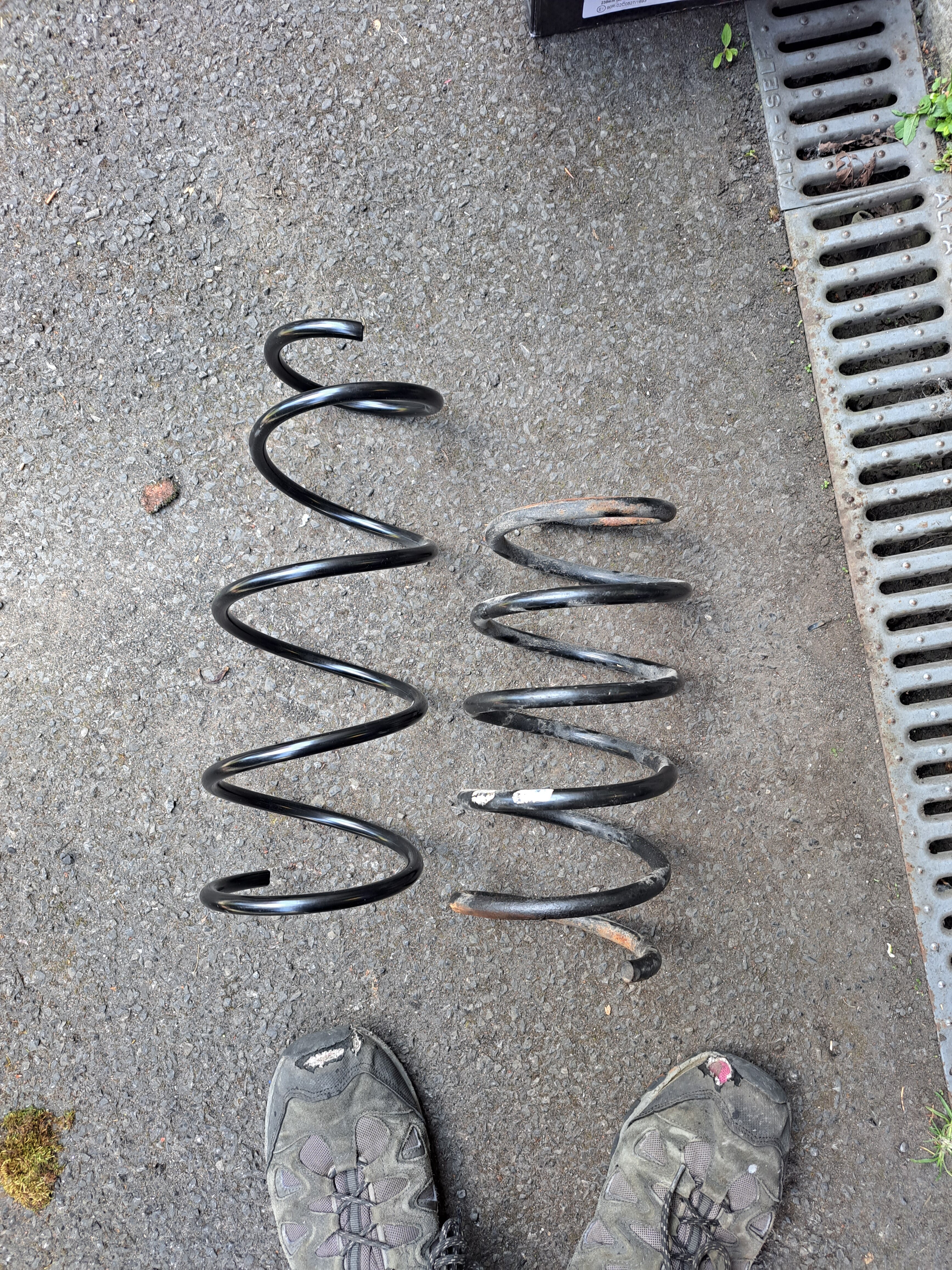

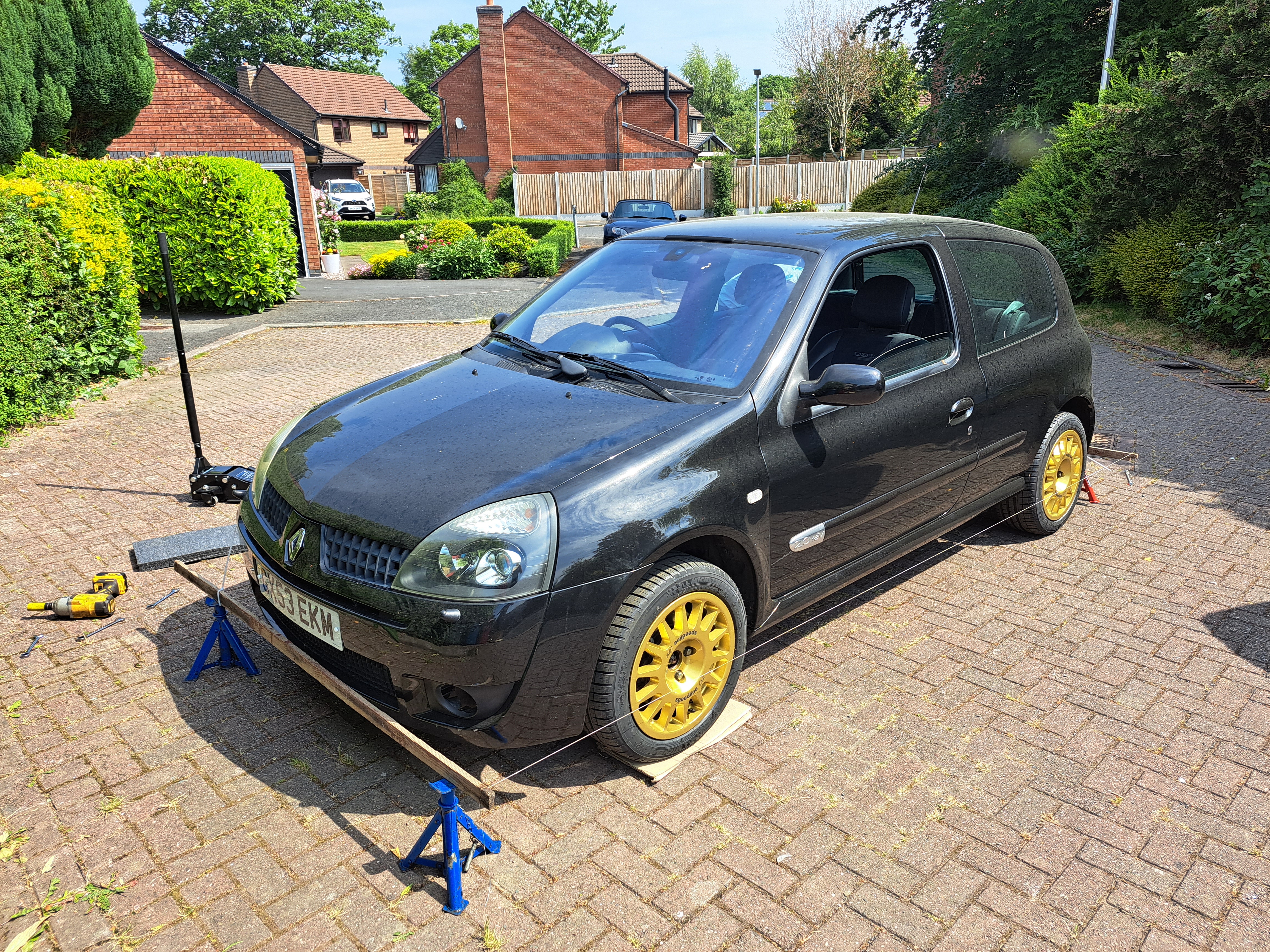

I then turned my attention to the suspension, I had decided that I wanted some more ride height to deal with the rough stuff but wasn't going to shell out on some mega expensive suspension. A lot of the usual coilover kits (Bilstein etc.) for the Clio 2RS actually give you a ride height drop even at their maximum extent, so I was limited to standard damper options to begin with. A quick and dirty solution seemed to be to get something from another Clio, so £30 later I had a set of big boy springs from a 1.5 DCi, they are shown below next to a standard sport spring.
After compressing the springs into the struts with my basic spring compressors (which felt like arming a bomb), I had some ride height.
A quick job with the string kit got everything back in alignment as far as possible for a job done in the street (I have very understanding neighbors).
Rather unsurprisingly the new springs did have a significant impact on the feel of the car, certainly the ability to absorb big bumps was improved, but it spoiled the feel of the handling, which is such an important fact of the Clio experience. Most noticeably the car car felt unsettled during compressions in bends, I suspected that because it was tracked up at a neutral position, but with the wishbones now sitting far from horizontal, when the suspension compressed it effectively just gave it super bump steer. I considered camber bolts to try and correct the problem I had created, but decided to leave it for the time being and see if I could get used to it (spoiler alert - I couldn't).

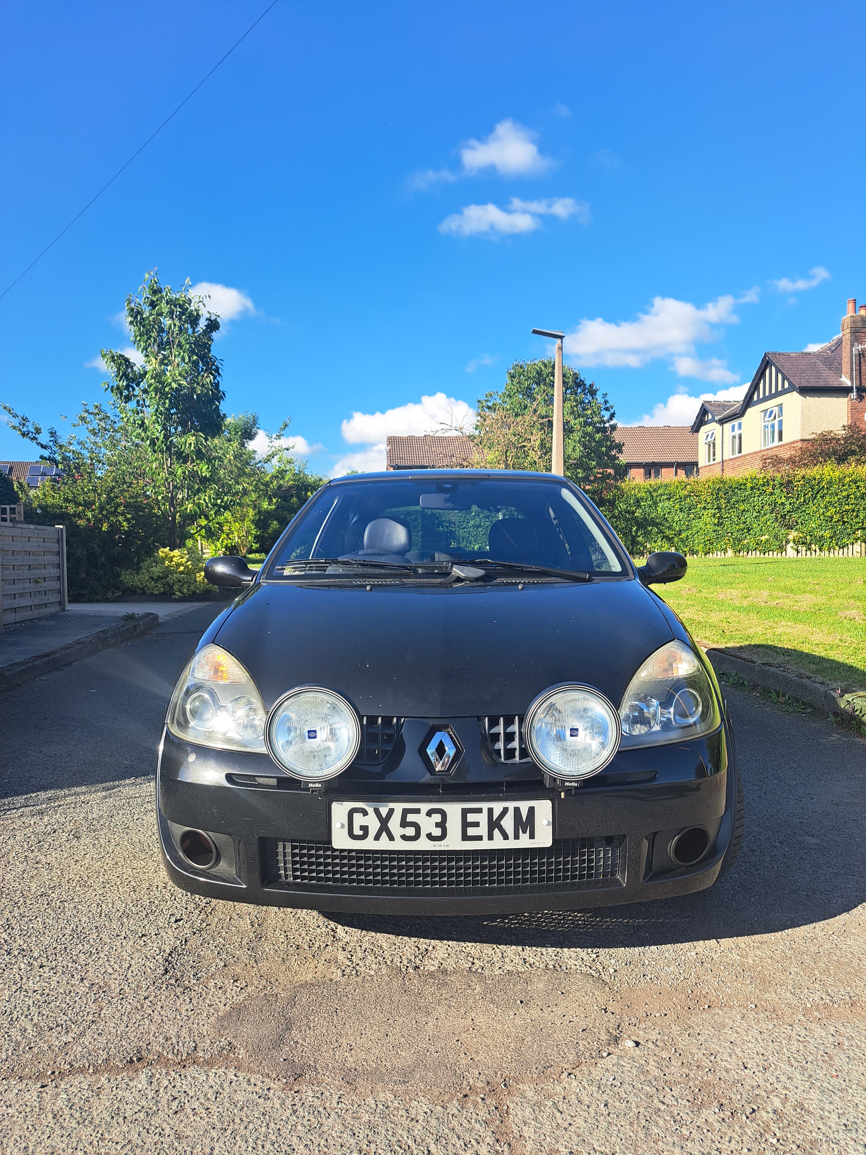

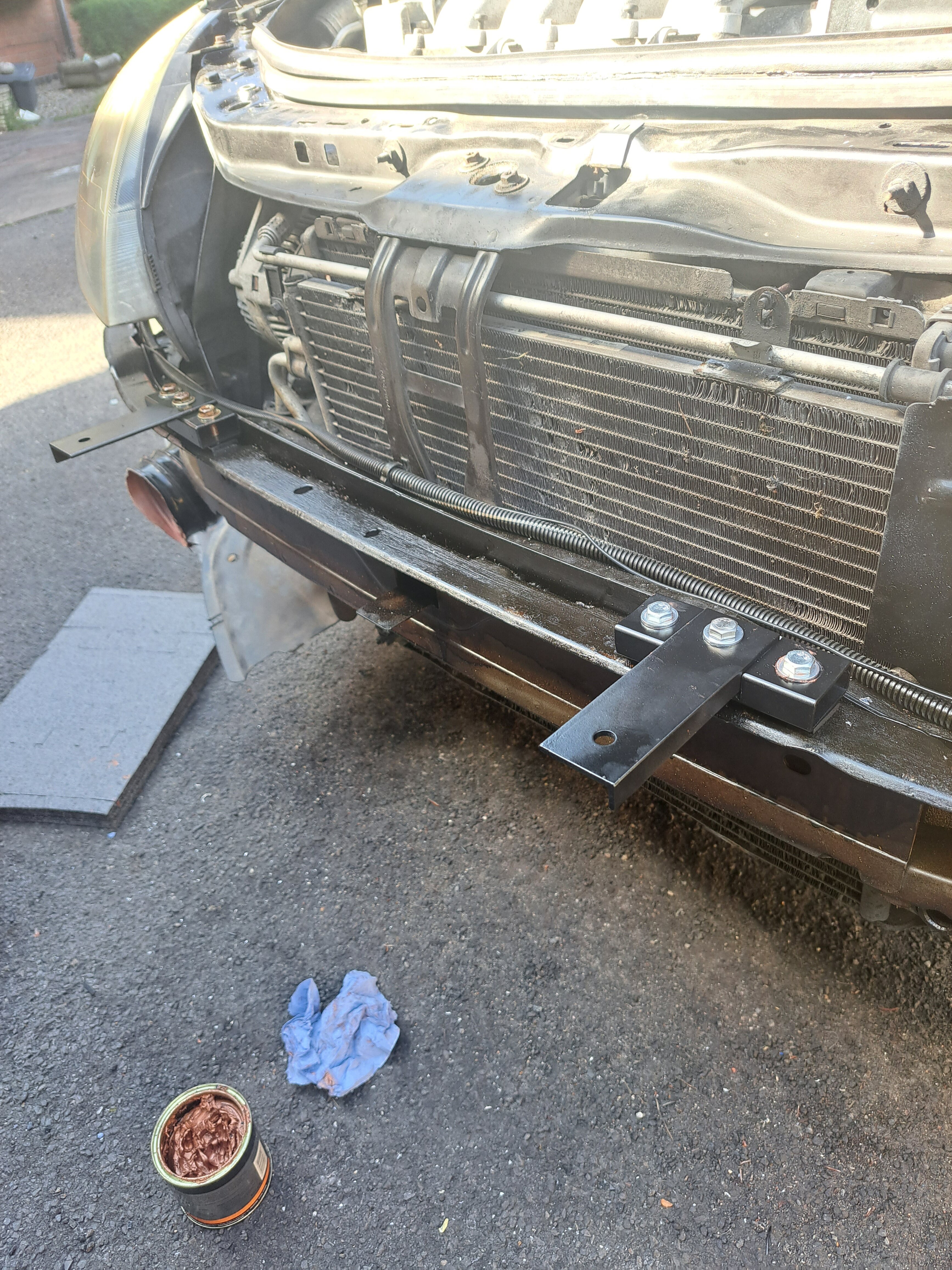

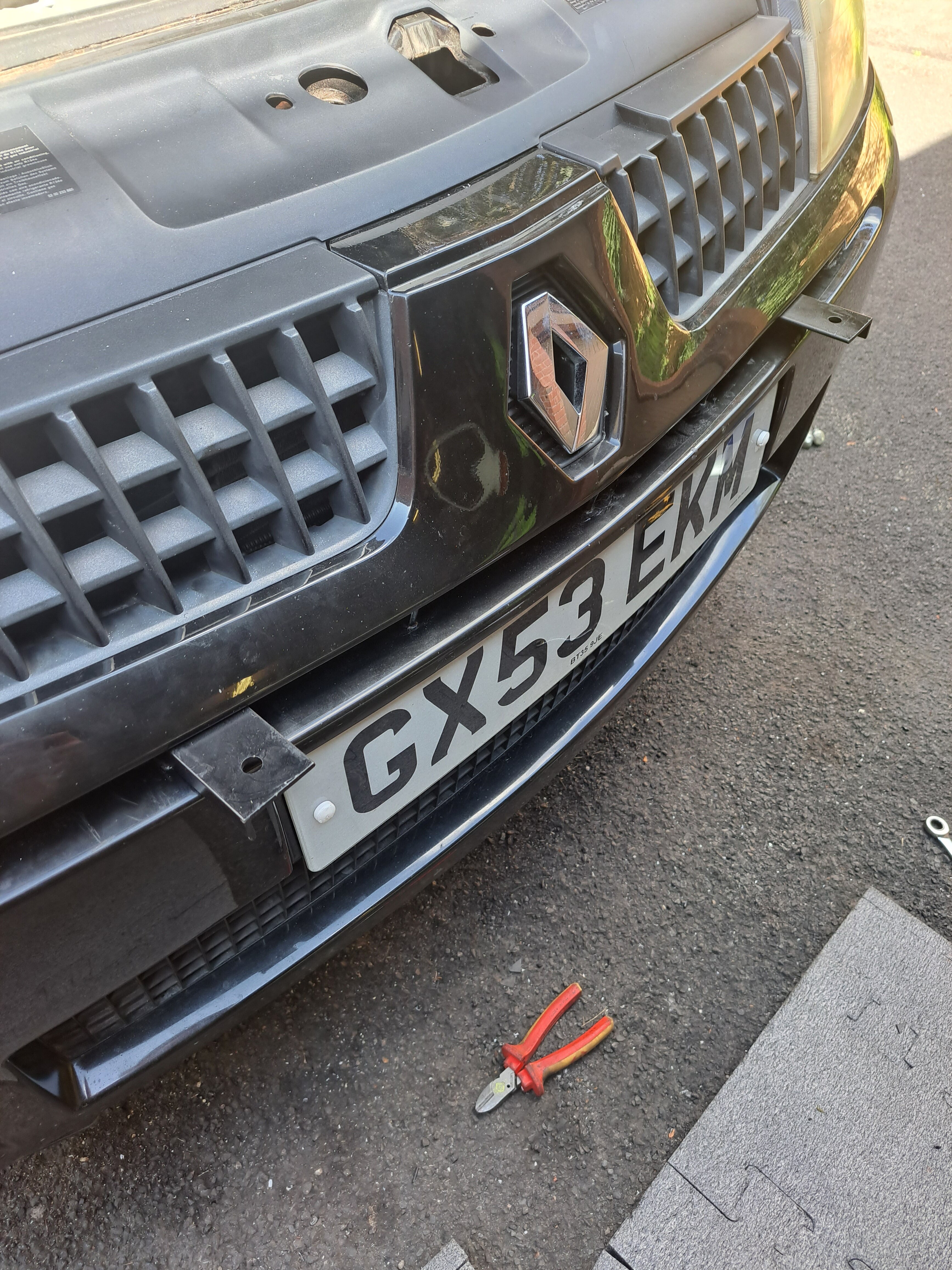

First things first, I secured a pair of second hand quality Hella spotlights from a friend, and set about thinking how to mount them. Some road rally cars you see on events have really been thrown together and although functional, can look pretty rough. Now as this is a hobby car not just a pure competition machine, I knew I couldn't tolerate something which didn't also look right as well. The vision I have in my head is that it ends up looking like a 'clubsport' style car, i.e. almost OEM in its fit and finish where possible.
With that in mind I didn't want to go cutting big holes in the front bumper, but I did look at that useful slot Renault put right across the whole thing. The challenge was now to get some angle bar (the L shape giving strength) to protrude through, mounted on something solid enough behind. Now I also can't weld, so it needed to be a mechanical solution. After a bit of pondering, I came up with:
And with the bumper fitted:
The eagle eyed amongst you will notice the rust proofing all over the place, I had taken the bumpers and sill covers off previously and given everything a good seeing to with Bilt Hamber Dynax.
Lights need electric, so I dropped a relay into the main beam circuit which triggers the switched permanent live straight off the battery. This means that the spots turn on and off with main beam, but also you can have main beam without the spots on (for daily use). To aid easier removal of the bumper in the future, I put some IP65 rated quick release connectors between the car wiring and the spots.

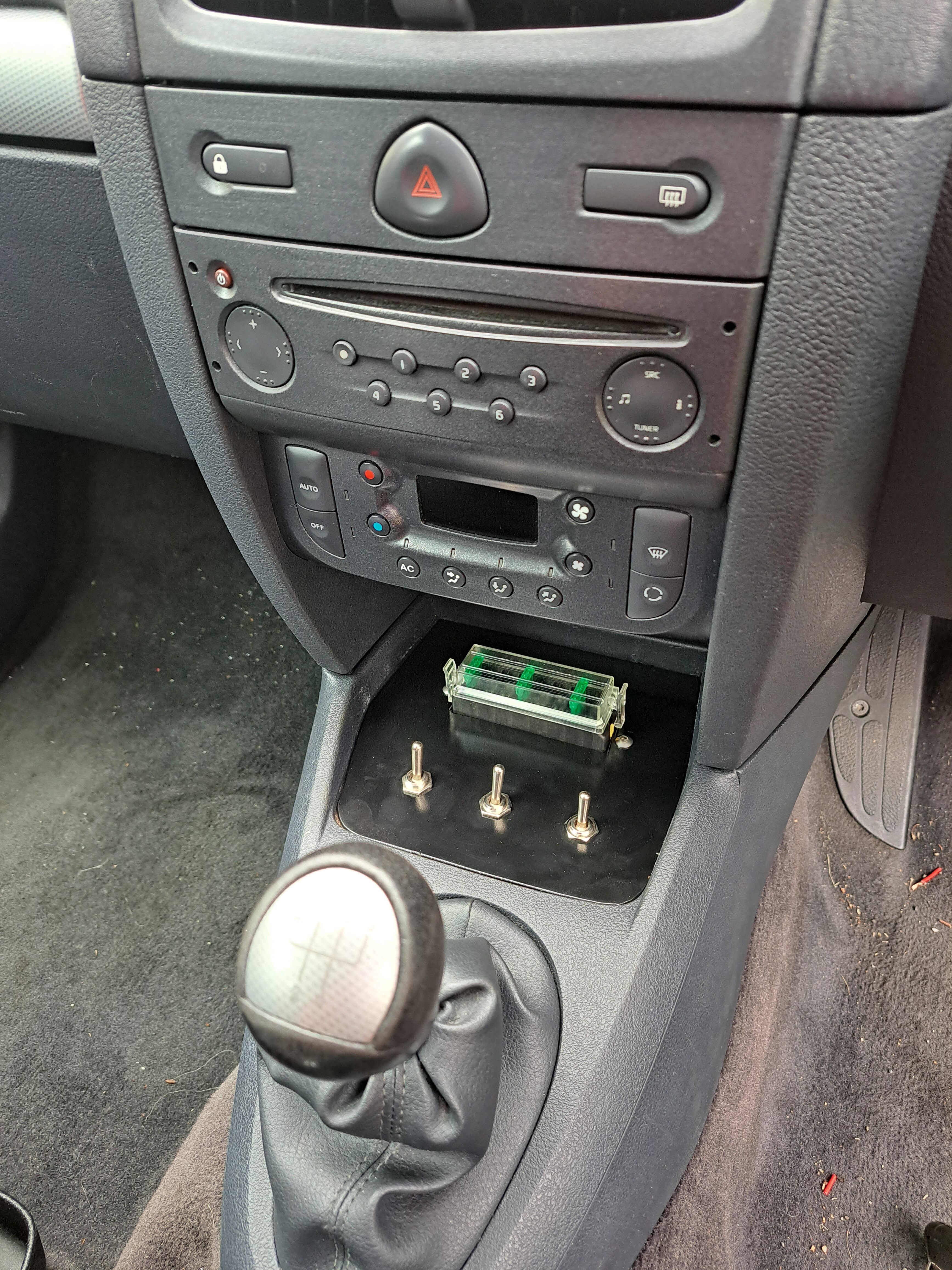

Inside the car I set about making a switch panel, disposing of the cup holder and fag lighter gave a great place for an extra fuse box and switches I'll want long term. The panel itself is a piece of painted aluminium. Long term the switches will control the spots, the interior lighting, and marshal lights.

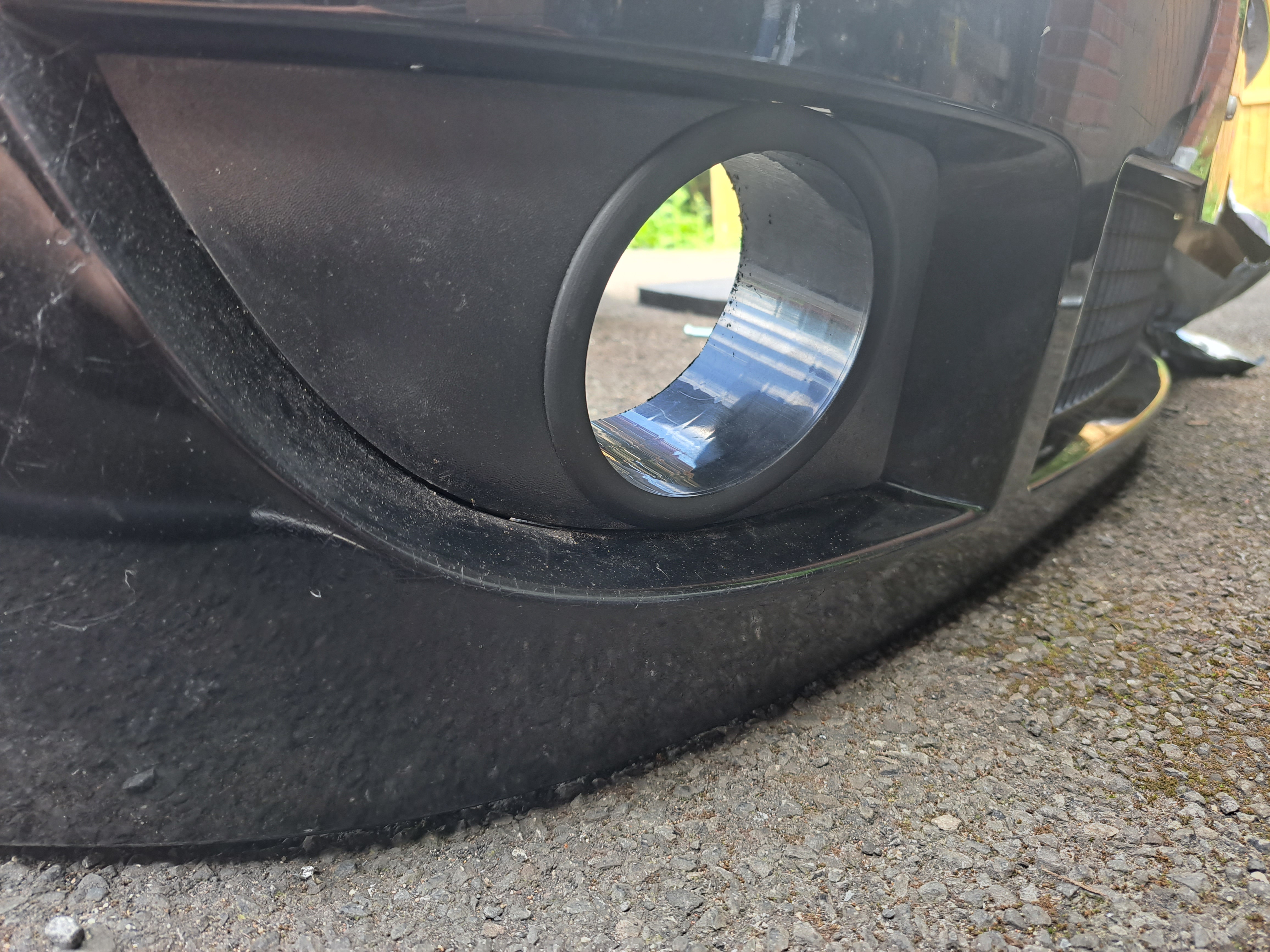

Those with their thinking caps on might have realised that adding spot lights actually takes the number of forward facing beams up to 6, because of the fog lights fitted to a 172. Although some scrutineers would turn a blind to a set of poxy fogs, I would prefer everything to be above board.
That meant taking out the lenses and doing something with the holes that remained. I thought about just blanking them off but it made sense to go for some brake cooling ducts instead, the impact they have is probably negligible but a bit of airflow flying around the wheel arch can't do any harm. What I wasn't prepared to do was pay the £100+ for a pair of 3D printed bits though!
So I bough a length of proper automotive ducting for circa £20, and went for a nosey around my local hardware store. I came away with some 4" flanged inlet pipes (£3), and a pair of 4" to 3" inch stepped drainpipe reducers (£7). A bit of fettling later and it was done:
And the look from the front:

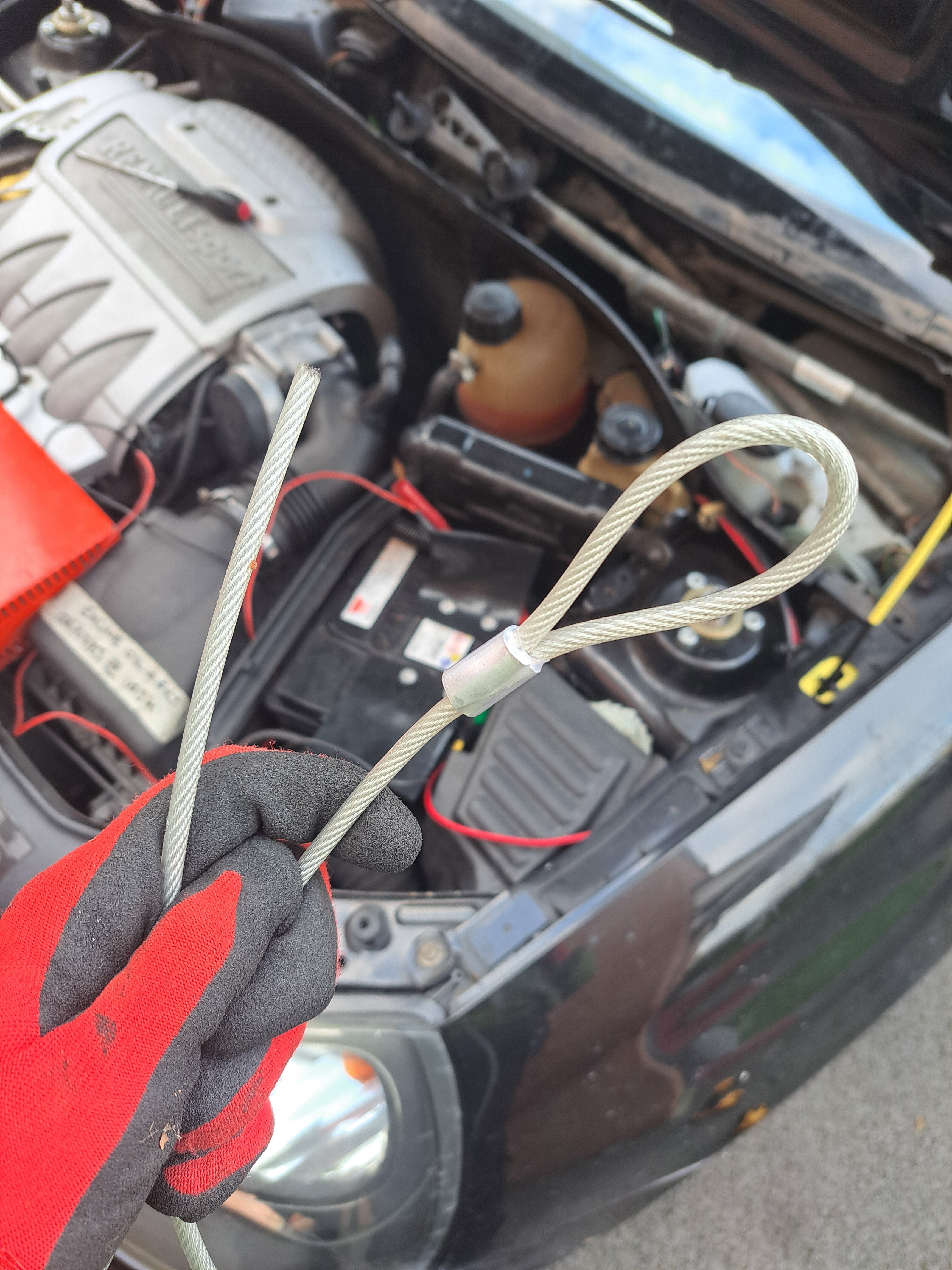

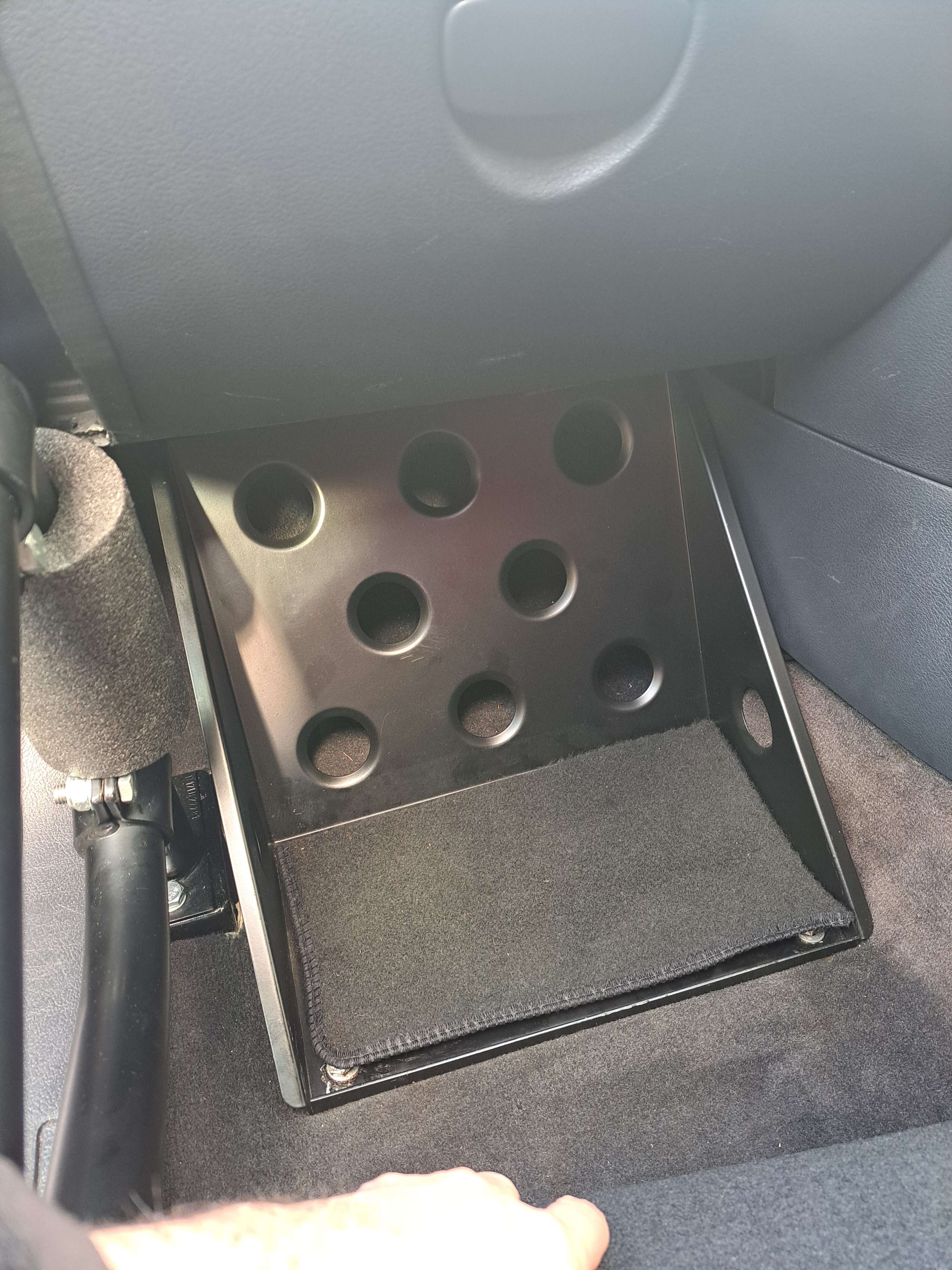

This was also the perfect time to think about the all important sump-guard. Unfortunately none of the UK suppliers offer new sump-guards for the Clio 2 anymore and I didn't want to wait for a second hand one to appear so after some carboard aided design I came up with a template and bought some material, I opted for 5mm thick aluminium 6082 T6 as it's one of the toughest grades of aluminium commercially available, and the thickness is probably sufficient for my application without getting prohibitively expensive (it was still the best part of £200 thought!!).
I drilled 6 holes and fitted rivnuts in the 'flat' of subframe for the first part of the mounting, but will come back to the sump guard in a later update as I didn't finish it straight way. Here is was for the moment:

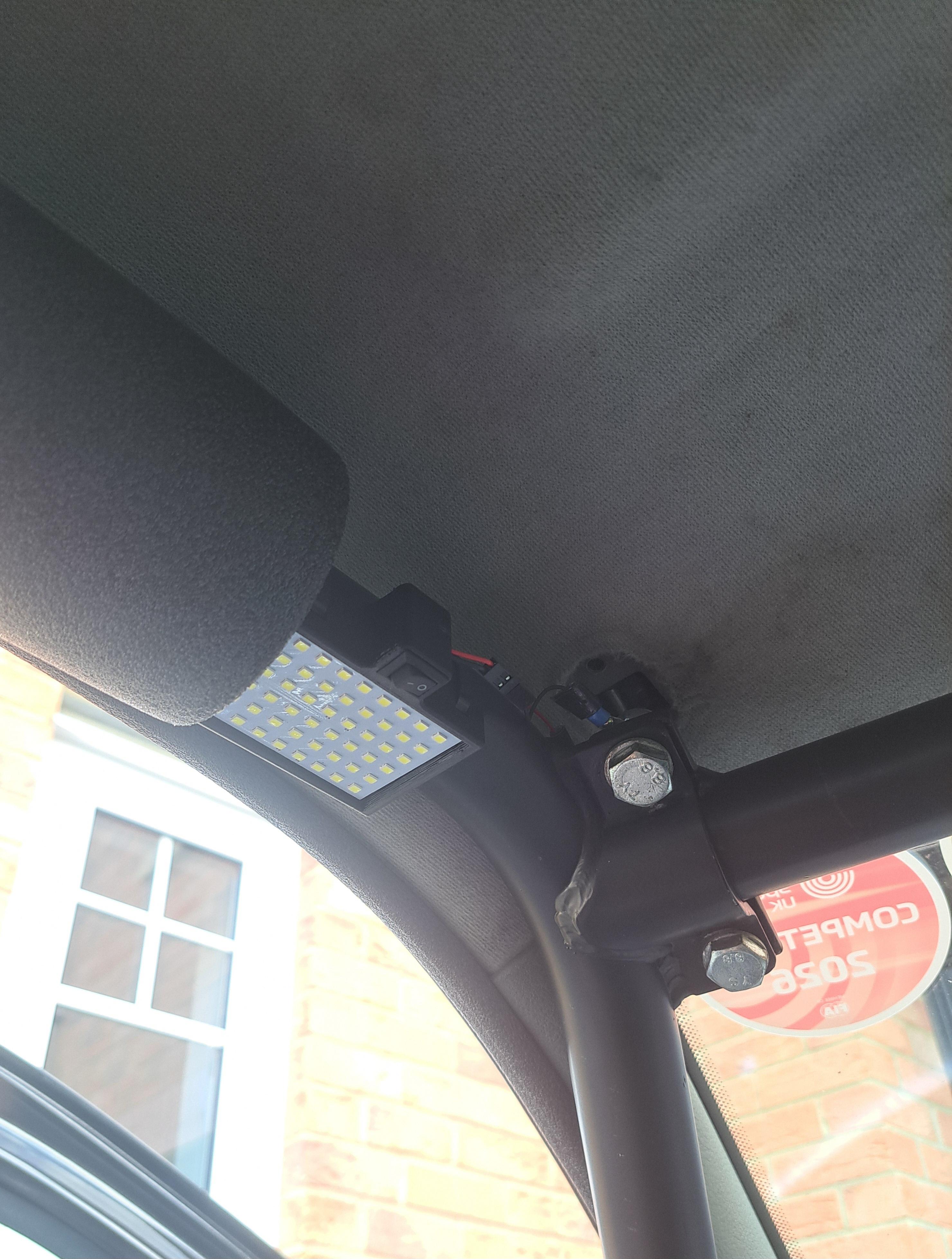

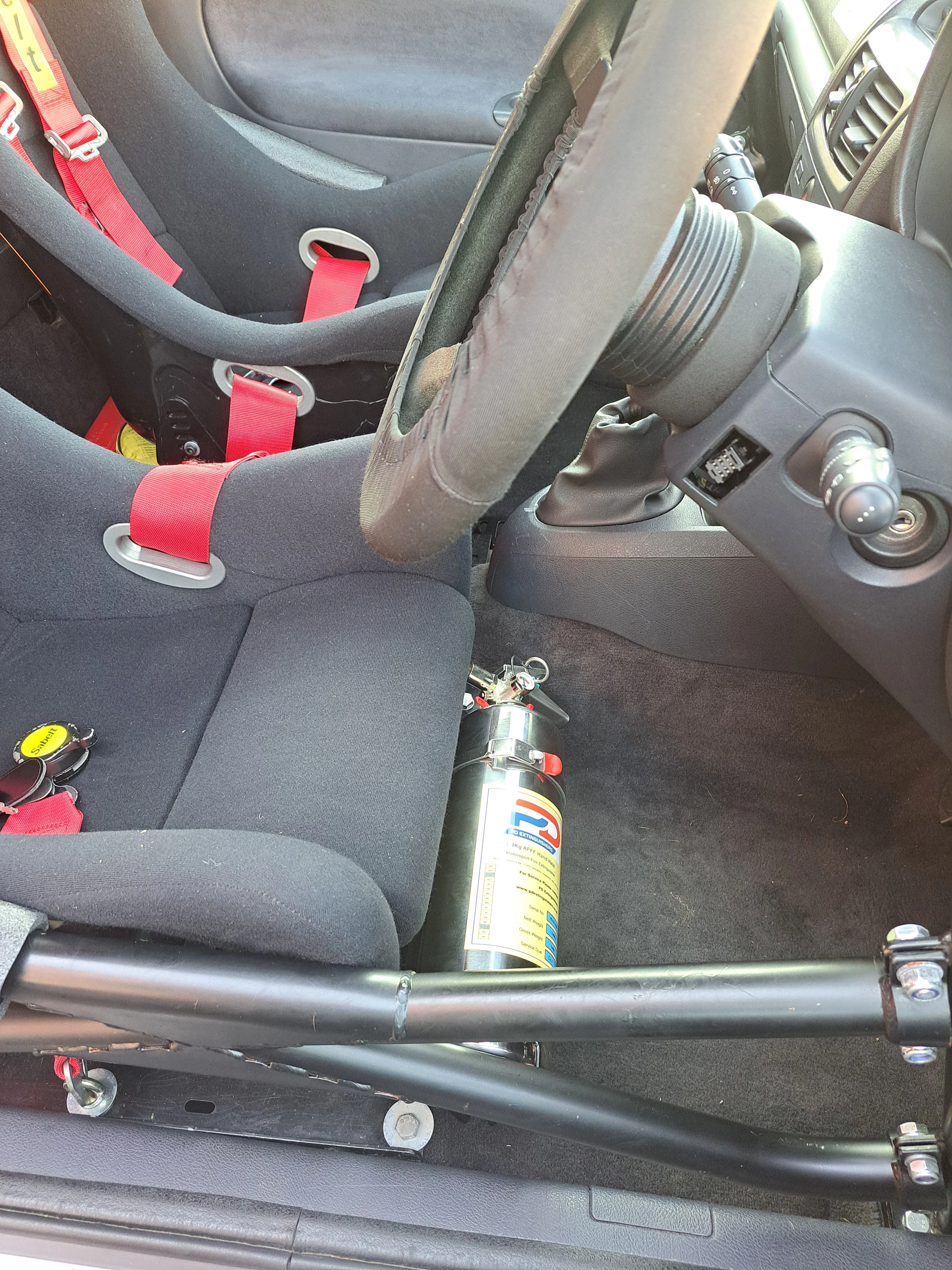

When it came to the rollcage I was sure of a few things, it had to be a quality bolt in cage, I wanted harness bars and double door bars, but I wasn't concerned about it being a dash-dodger or not. After a bit of research I settled on the safety devices R017. I was days away from placing an order for a new one when I saw one come up for sale fairly locally in exactly the spec I wanted for about £500, so I snapped it up. Safety devices sell full fitting kits which include all the required weld-in bits plus the hardware, so for another £100-ish I was ready to go.
In road rallying, the cage doesn't have to be to any particular specification (you don't actually have to have one at all) but you do have to retain the car's original trim (it can be cut to fit safety equipment, but not removed). This includes the backseats, carpets, and headlining, but not any boot trim.
First up was to strip the interior and remove the airbags, it looked as though one of the previous owners had been unlucky enough to have their car broken into at some point, judging by the broken glass I found under the carpets.
The neighbors cat wanted to get involved (i.e. claw the s**t out of the seats and carpets):
Next up was stripping some of the sound proofing, before dry fitting the cage:
For the welding, I wanted a really good job, so I moved the car over to a race-fabrication specialist who did a lovely job of welding everything in:
Whilst the dash was off I neatly fitted in the rally clock, with the controlled positioned near the handbrake so you can use it with the harnesses on:
The the refit began, I wanted it to be as neat and tidy as possible so I took care trimming the carpets to fit snuggly around the new cage. The eagle eyed amongst you will spot the Jon Foz subframes which came with a set of Sabelt seats I picked up off a track Clio which was being broken (as they do). They are held to the floor on the rear mountings with bloody big eyebolts for the belts.
Next time I'll share some finished photos of the interior all together, I don't have any to hand.
Cheers!

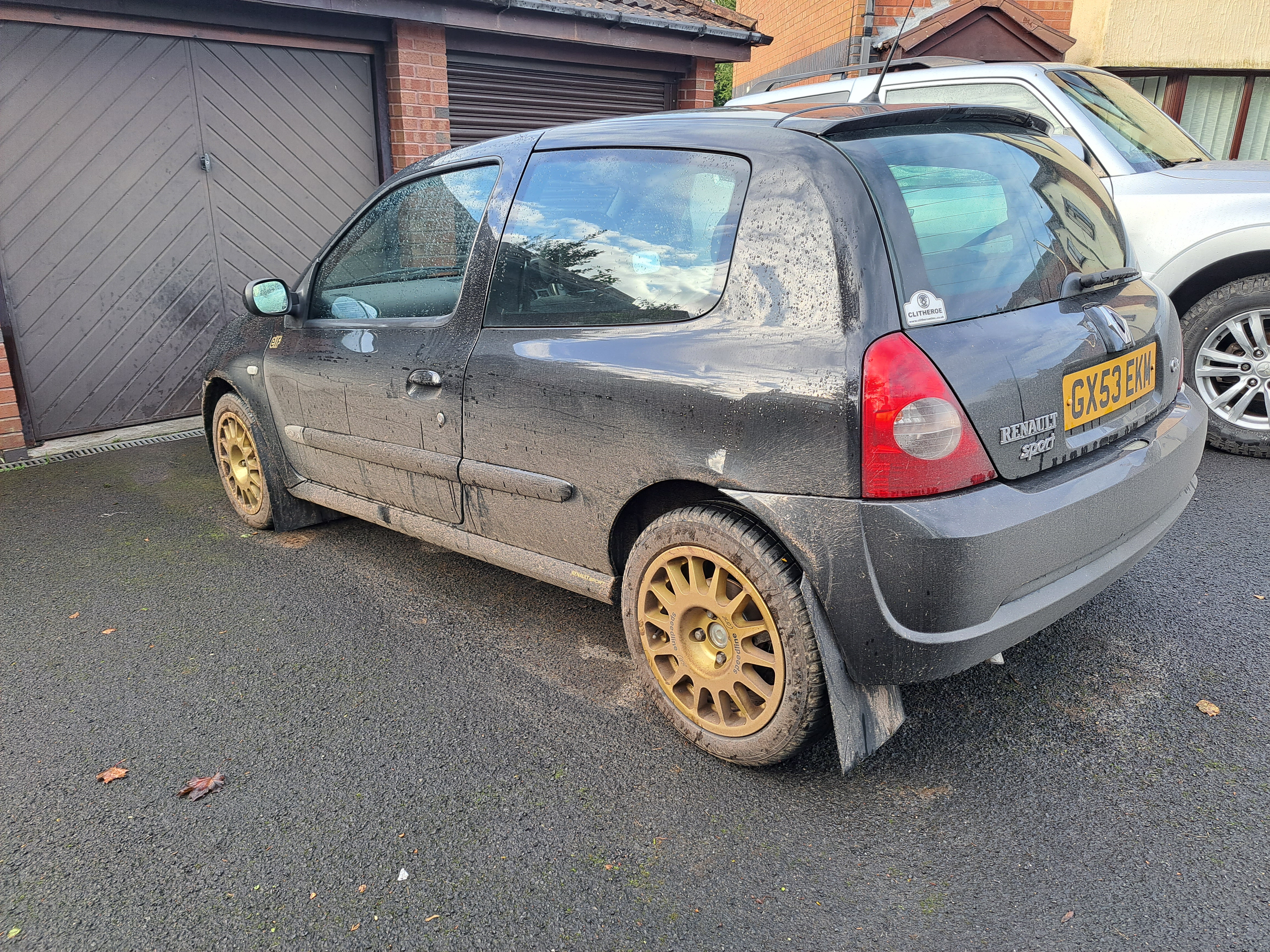

This post finally brings things up to date, as I took the car out for a shakedown run at Anglesey for the rally track day.
The rally track days are great events, they run 5 stages during the day which operate on an open pitlane principle, starting at 30 second intervals. So you get plenty of seat time and get to use all the track in both directions, plus infield and outfield. It's a good crowd with a great range of machinery on show and (in my experience), no idiots. Here is an example stage diagram:
My plan for the day was to get some seat time, check the car was all good, and enjoy myself. No heroics!
I didn't fancy wearing out a set of PS3s so I had some Toyo Proxes put on my 16v wheels for the front, I've used Proxes on the road on other cars and found them quite agreeable for the money. I was surprised at how awful they were on track but more on that in a minute!
Here we can see the two ends of the rallying world, driven to the venue with spares in the boot, or a six figure car arriving in a massive wagon! (I'm only jealous).
After three runs through the shortest stage I came in for a spanner check and was met with a geyser of power steering fluid! I had heard they like to overheat so I kept it to a max of two runs then a 5 minute break for the rest of the day, I think a cooler is on the cards (the pump and fluid is new, although is was over-full).
Back out on track I was really enjoying the car, with the engine, gearbox, and brakes all strong, I was just experiencing hilarious noisy understeer from the tyres, with very low front end bite and plenty of wash out.
At the lunch break I could take it no more, and fitted my PS3s I'd still brought with me. The car was transformed! Although a set of proper semi-track tyres would still be far superior. Here's an action shot:
It then came to the last stage of the day, I had been having trouble getting the car to rotate on the handbrake through the hairpins all day (driver problem not car), so after some tuition from my experienced navigator I gave it some on this last run...
Success! A solid 180 quickly executed, the only problem was the big pothole I hit with the front wheel on exit which pulled the front tyre off! Remember my shiny new speedlines?
The circuit obviously doesn't want you dragging a rim across their lovely tarmac so we had to pull over and wait for recovery, gave us a good spot to watch some action from though:
Back in the paddock on the recovery wagon of shame:
Tyres changed, we headed off home after a great day! A spanner check after getting back found no further damage thankfully, and after a run around with a torque wrench the car is good to go again.

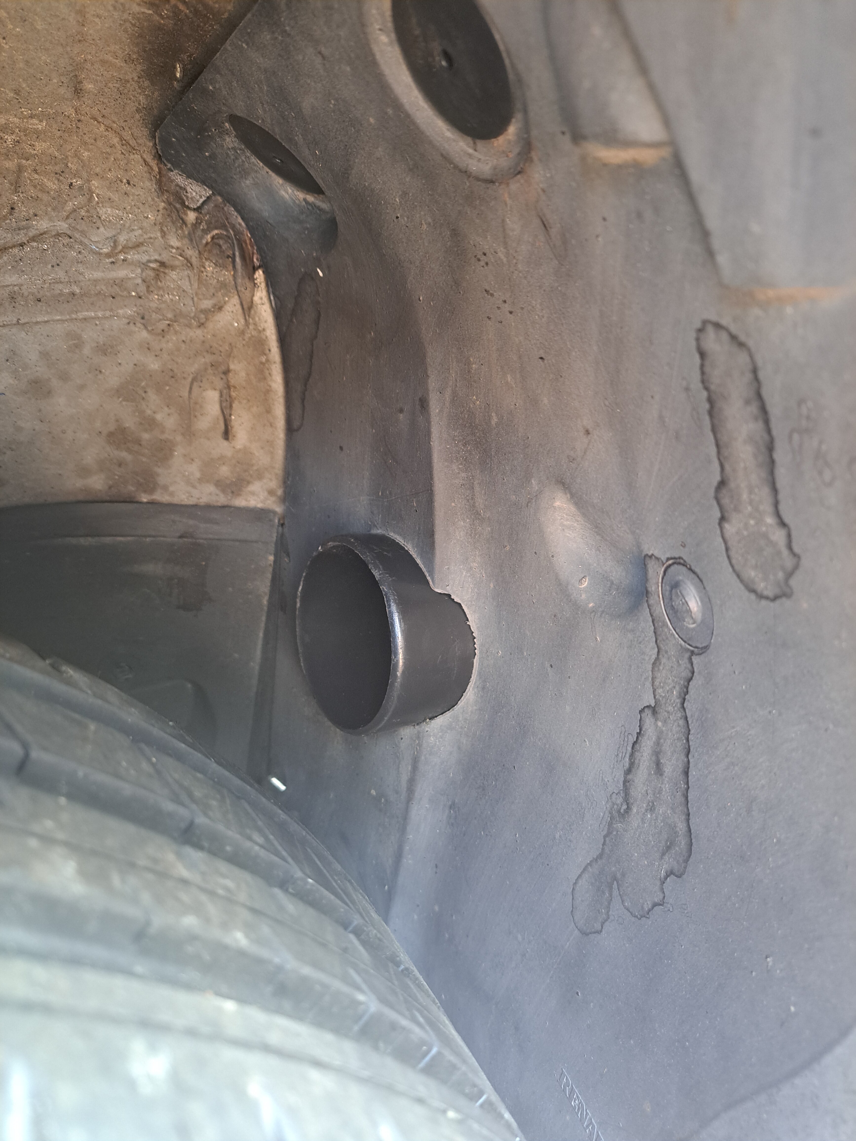

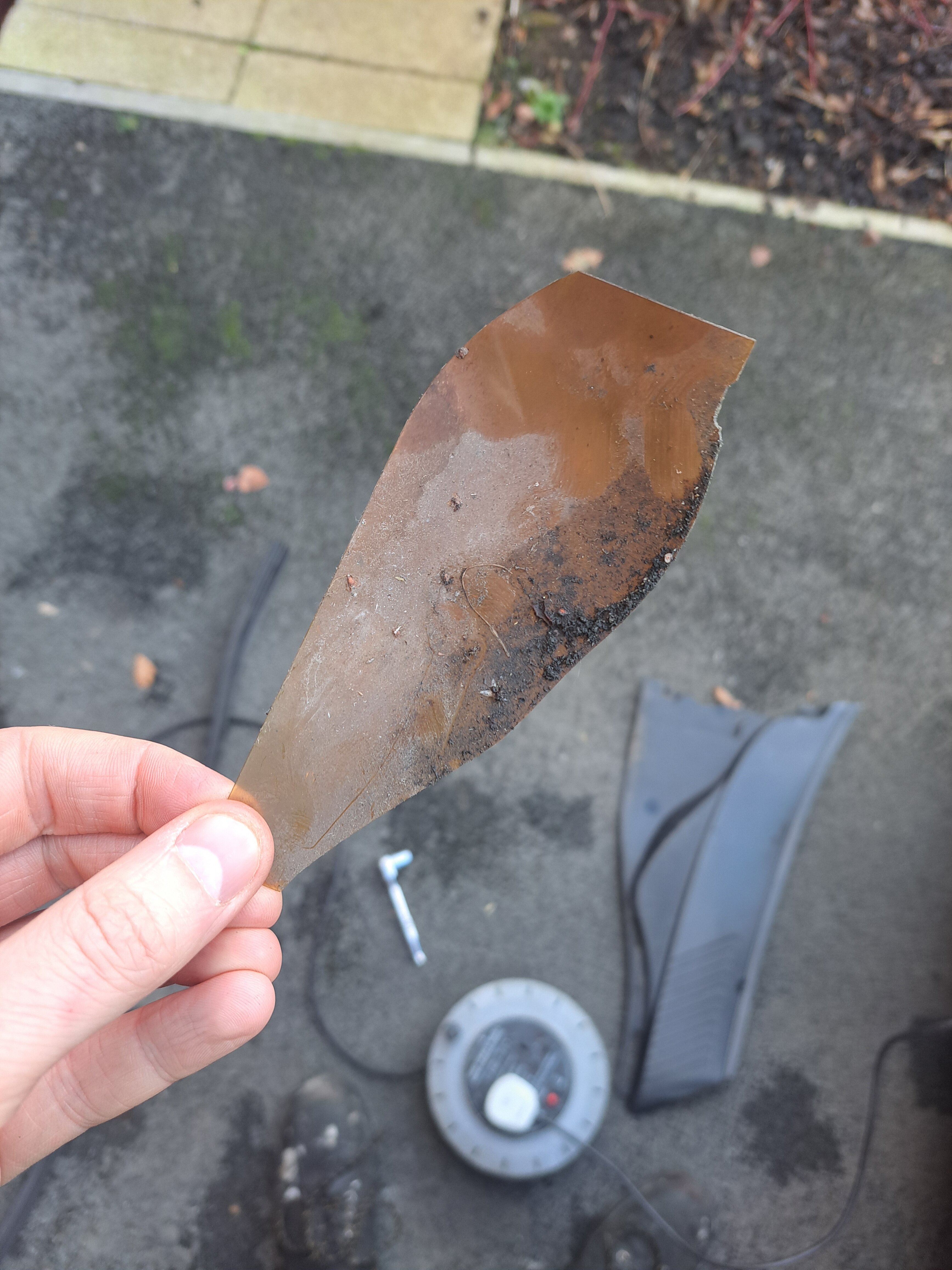

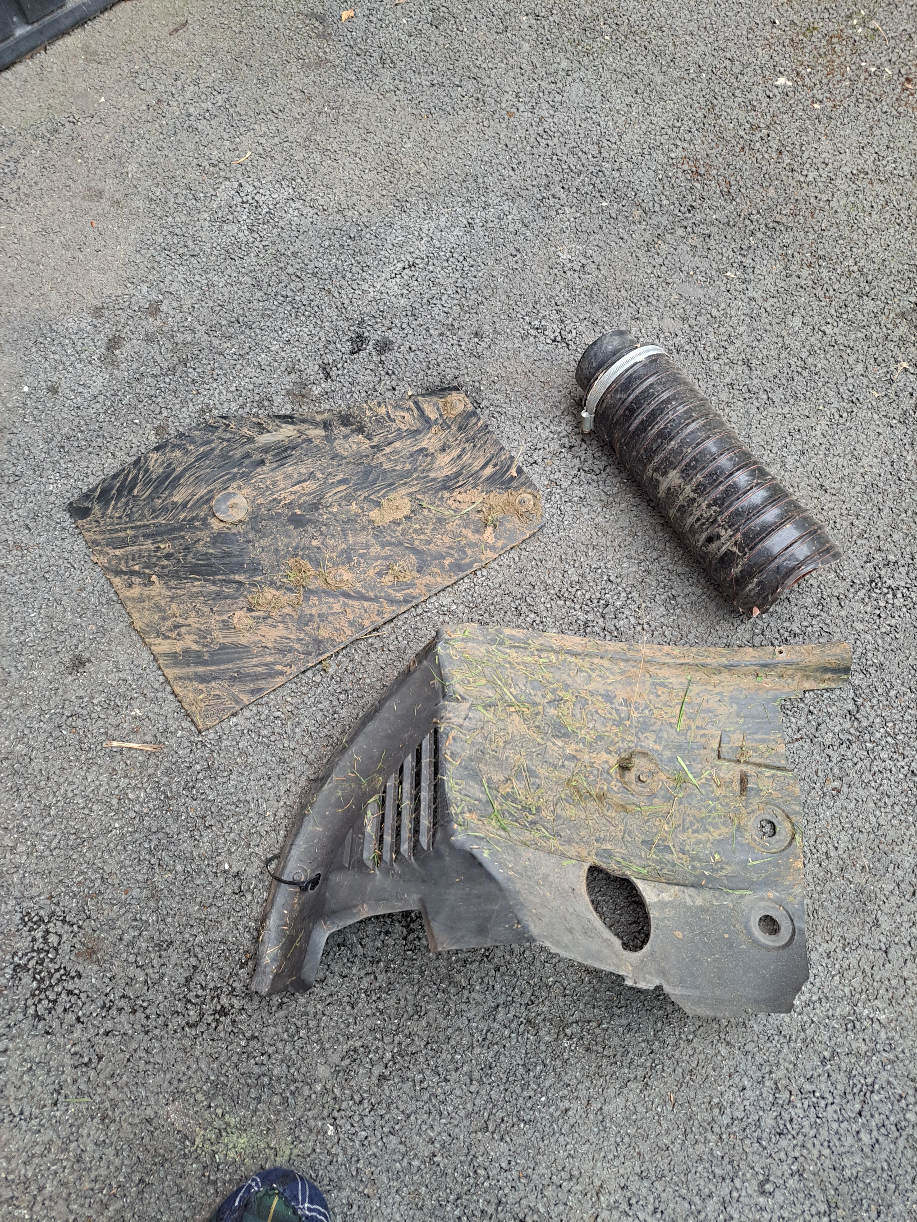

After sitting a while immobile on the drive I noticed it was filling up with water, researching the usual suspects suggested the central drain hole under the scuttle.
Wrestling the wipers off required bashing them with a rubber mallet to free the splines, and a usefully sized length of steel cable was used to clear the drains properly, surprisingly the blockage was caused by whatever this was, I don't think it is off the car so I have no idea how it had got in there!

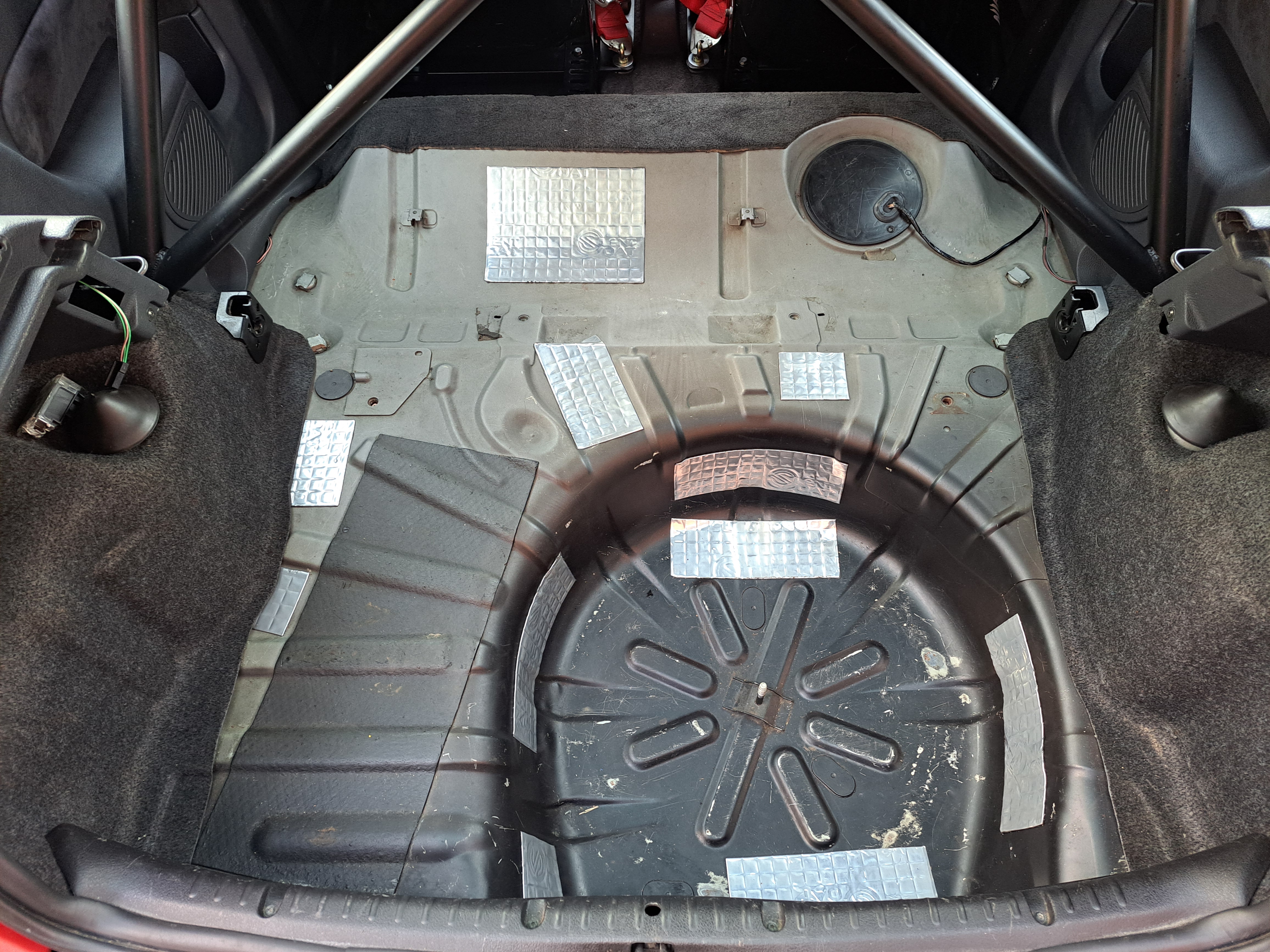

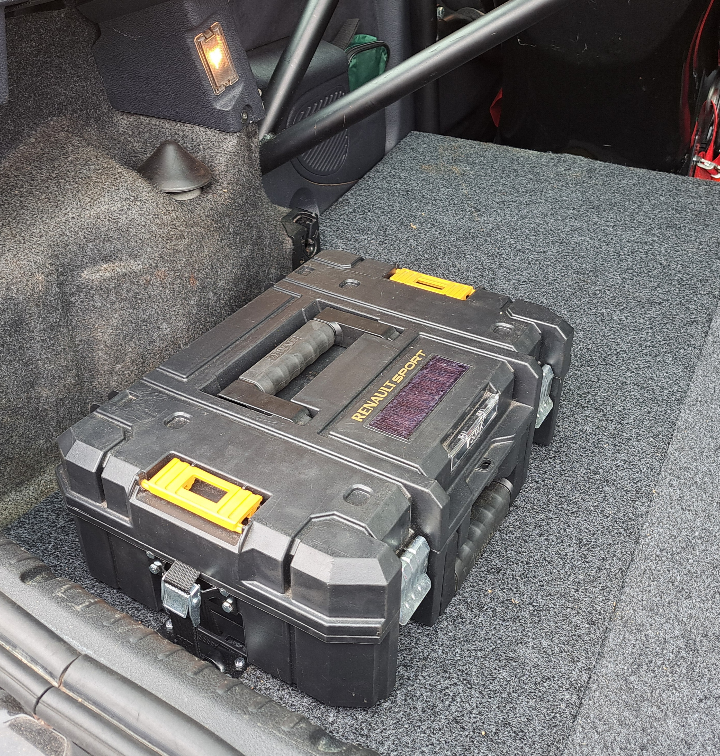

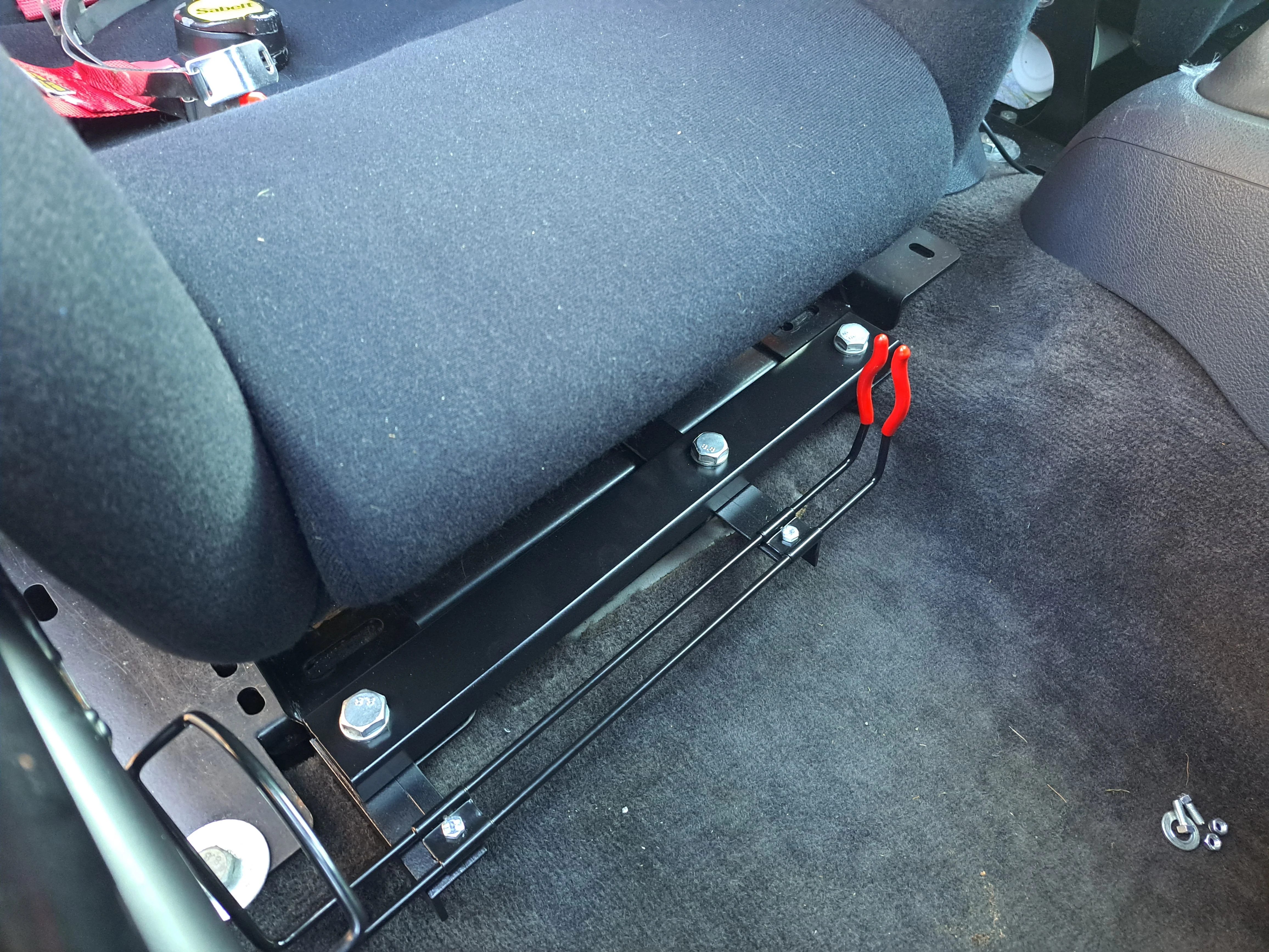

I'd also decided that I wasn't keen on the look in the back of the car since removing/moving the rear seats to fit the cage, and the noise of the new exhaust was getting a bit irritating. I plan on doing quite a lot of miles in 2026 so I wanted to do something about it.
First up was to add some sound deadening to the back, its a very satisfying job tapping the panels and seeing which ones are ringing most (hence transferring the annoying noises) and adding some material to change their frequency.

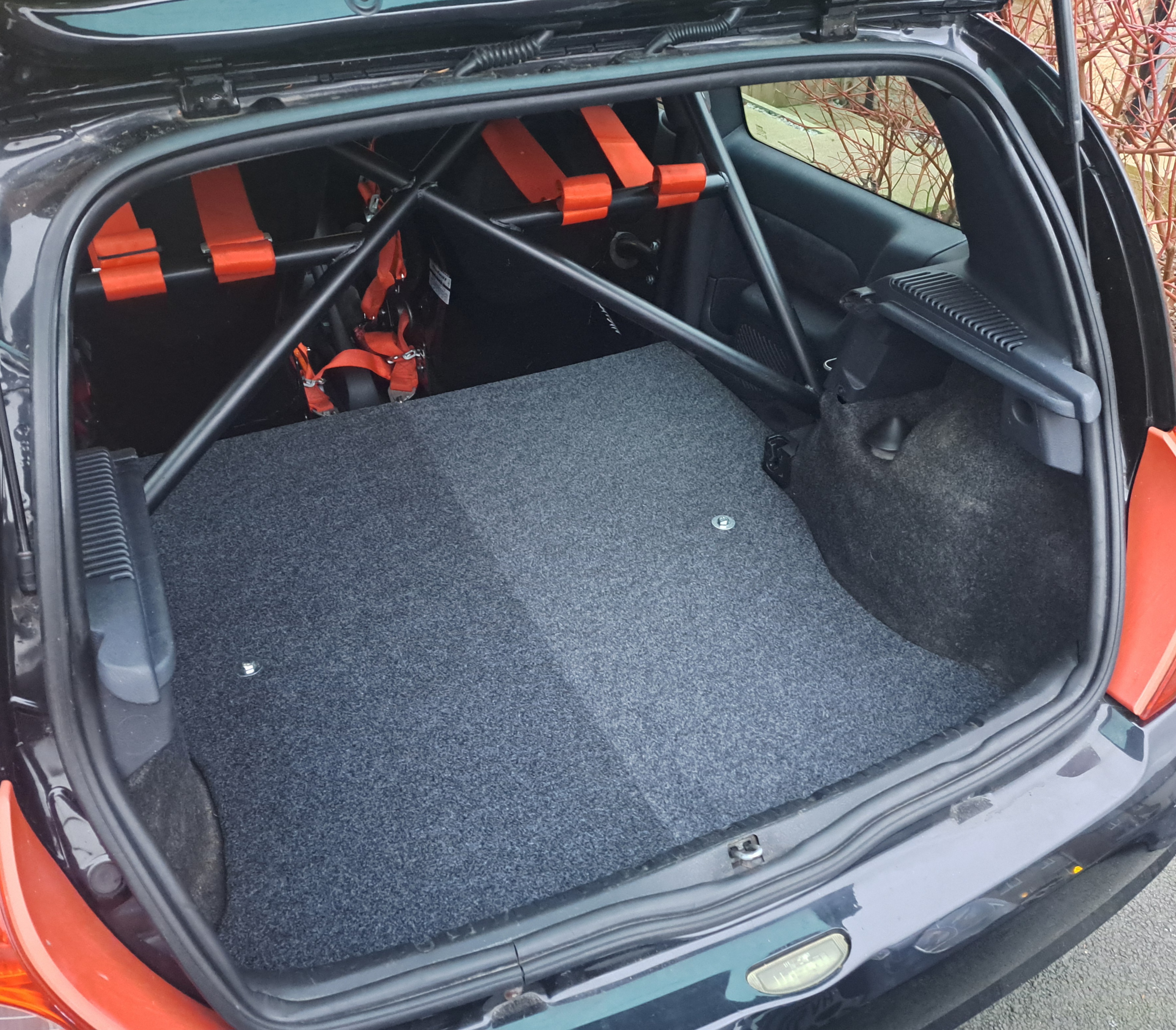

I then got some 6mm MDF and cut some templates, before backing them with some cheap automotive carpet and attaching a few small spacers so it lies flat. I'm really pleased with the result and I think it gives an almost OEM style look which I was aiming for. The only thing which detracts is that I didn't consider the ply direction of the carpet, so the colour looks a bit different left to right even though it came from the same role!
Long term I am going to get some quick release handles rather than bolts through the ISOFIX bar holes, add some mount points to strap down the rear seats (some event regulations require you to have them "in" the car), and create a method to fix down a toolbox (I have a plan). I might yet modify the design to make it easier to access the spare, or even carry a second one, but I'll see how I get on for now.

Flat floor in the rear looks good, tidy job.
The plastic blocking the drains is part of the shield that goes over the top of the wiper motor, they are brittle thin plastic which falls apart. Not needed, i dont think any of mine are intact.

The flat boot floor looks great! Very OEM looking.
Due to panel size. Did you add sound deadening to the underside of the MDF boards as well?
Thanks for clearing that one up, there was no sign of the rest of it under there!
No I haven't bothered although its an option, depends how I get on over the next few miles.

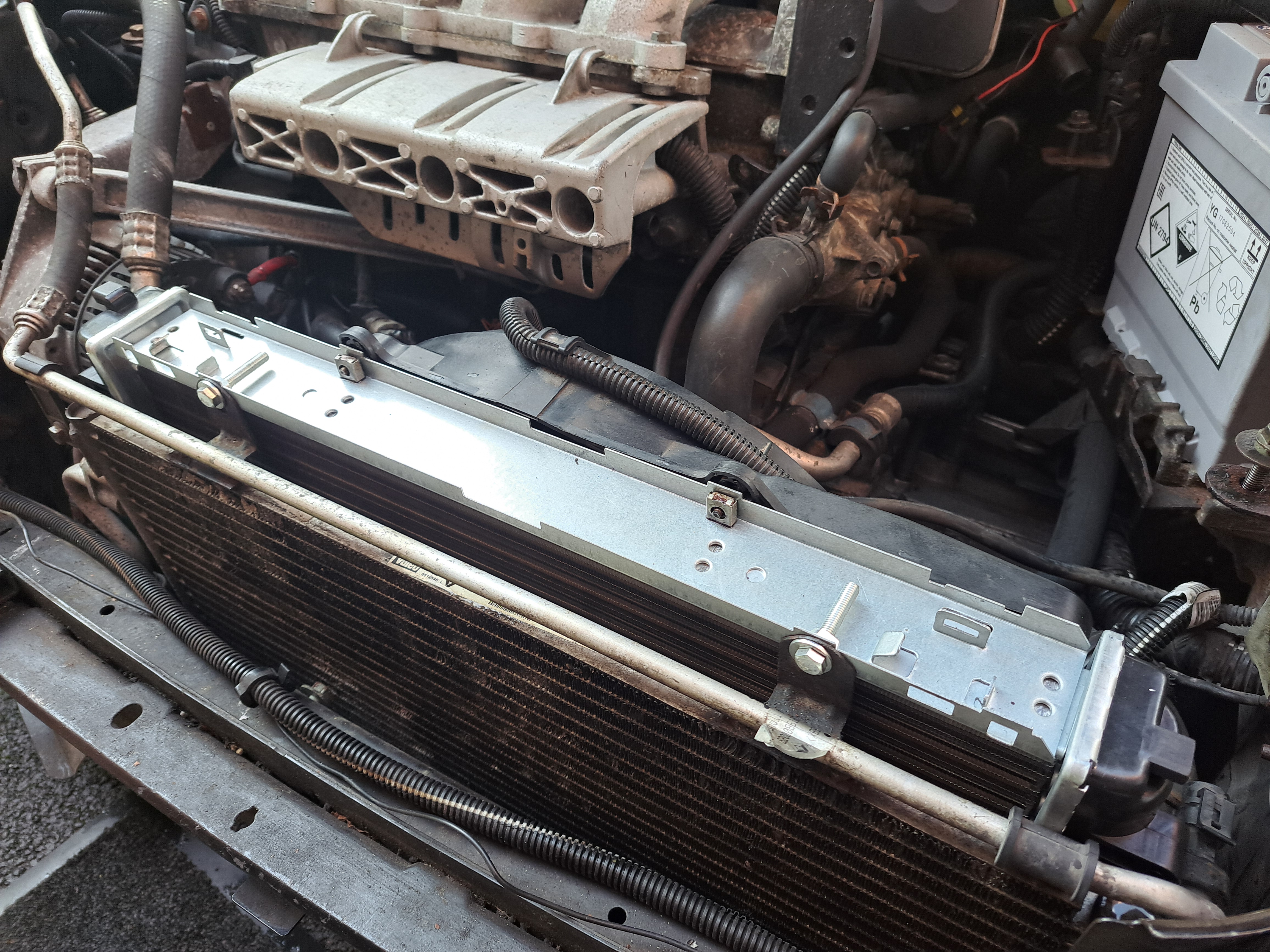

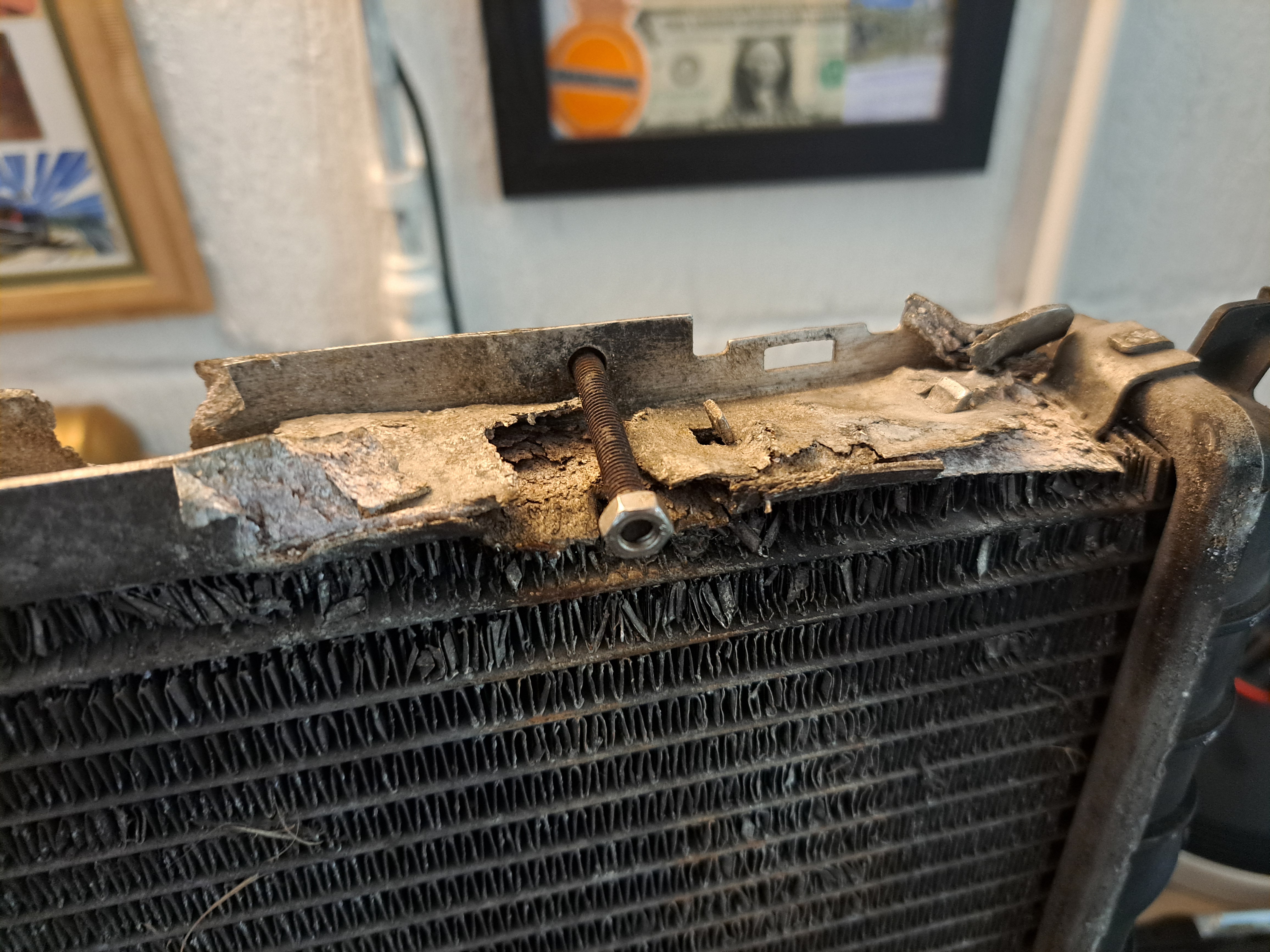

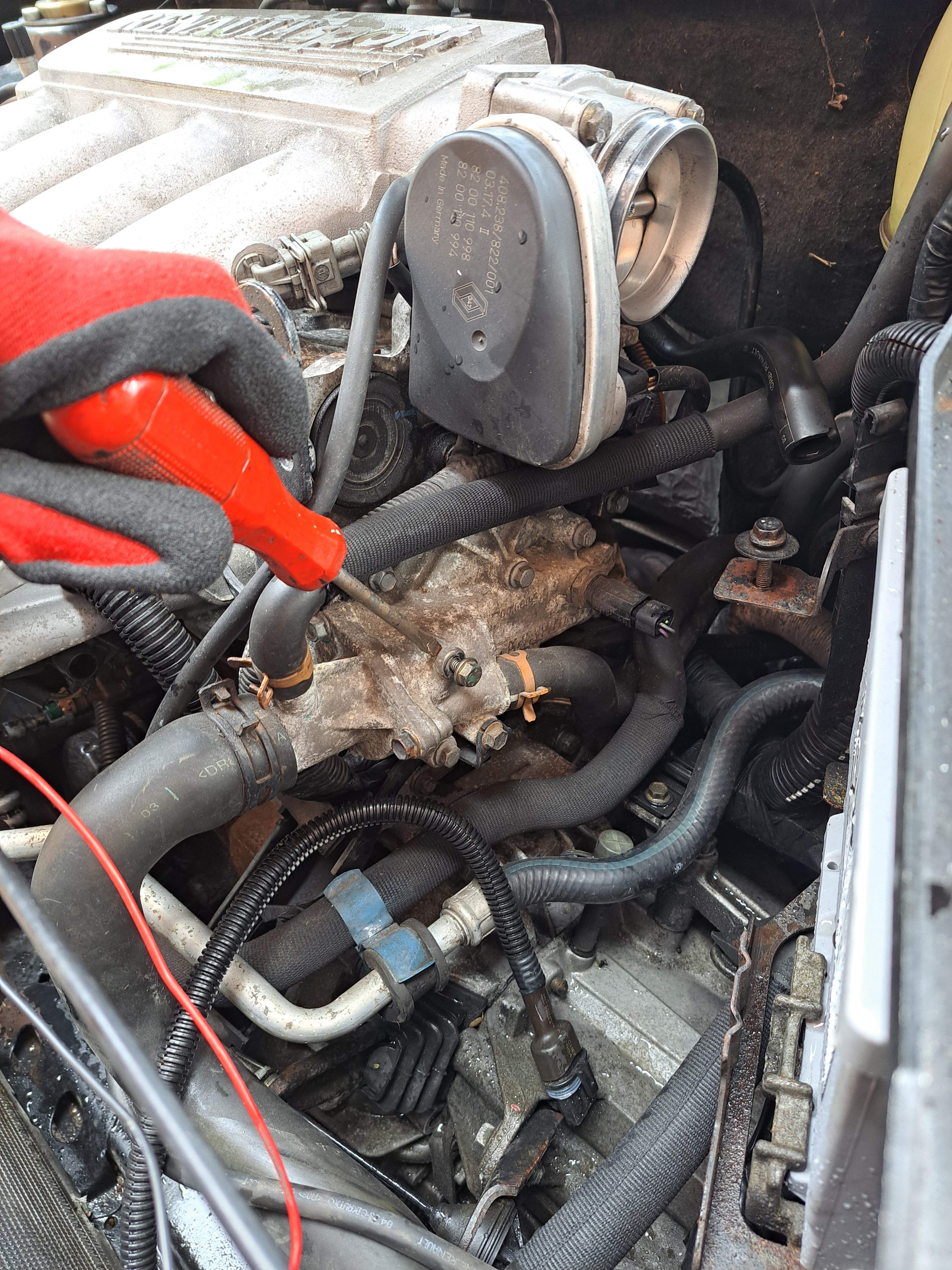

Although the radiator wasn't leaking, it wasn't properly attached to the car due to all the mounts having corroded away so I decided to replace it before it fell apart somewhere inconvenient. I bought a Renault/Motrio replacement, as it was the most cost effective solution and I like using OEM, although the quality is notably lower that the original item.
The original wasn't too difficult to remove, although the hose clamps are a pain! I've bought a proper removal tool now for when I have to do it again. This is what the radiator was like on all 4 corners:

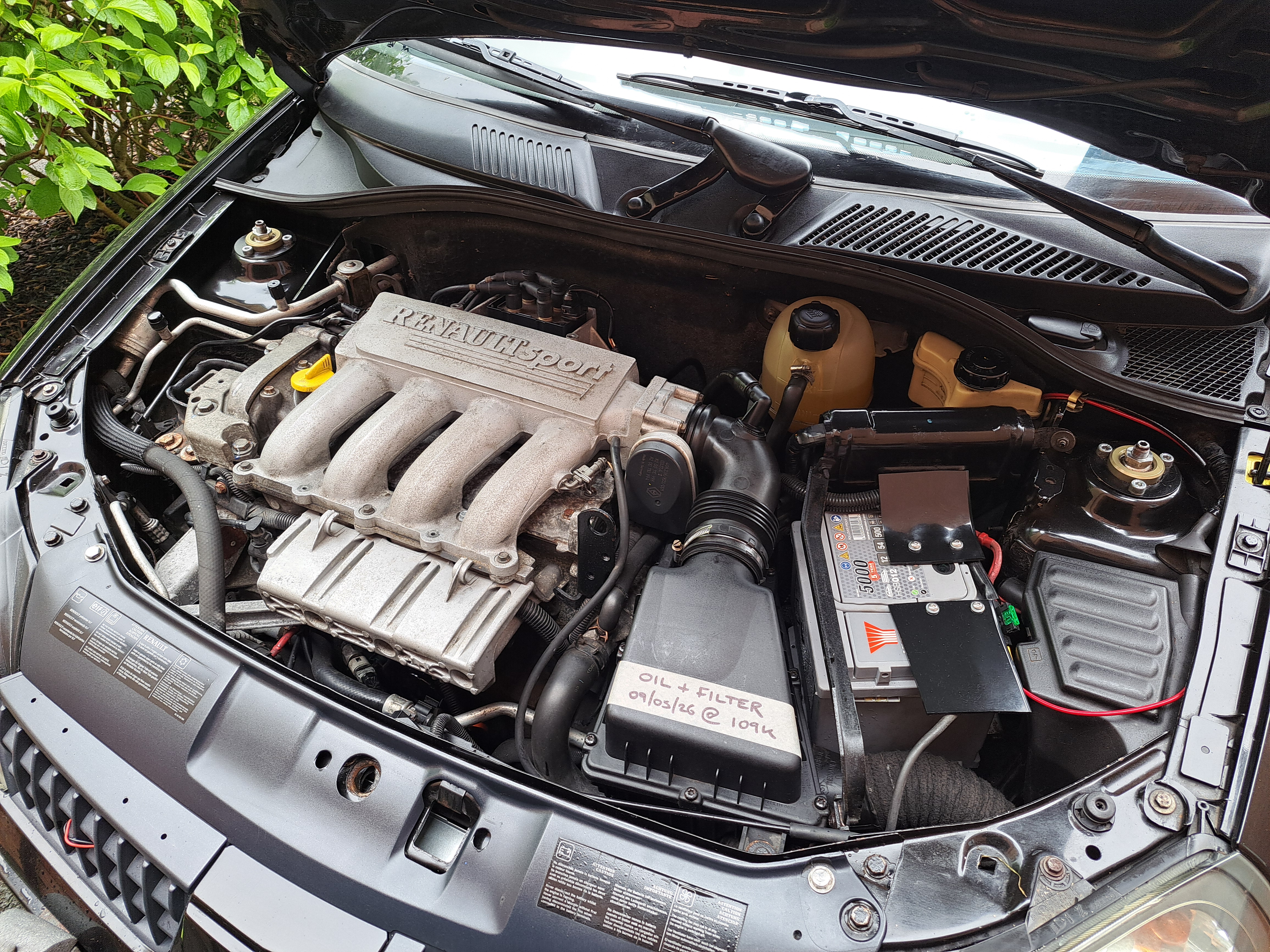

When I drained the fluid I noticed it was red rather than the expected yellow, so I flushed the old radiator through with the hosepipe and then refitted it loosely a couple of times so I could flush the block and heater matrix etc. through with just water.
I surprisingly had some trouble finding some Renault Type D coolant but I wanted to use the proper specification, although I know newer alternatives are probably completely fine. Eventually I bought some Holts branded stuff from Ebay.
For anybody from the future who has found this thread via a search, this is the bleed screw for the thermostat:

I then took the opportunity to do a full service and give the engine bay an 'oily rag' restoration:
I then did a couple of other little jobs, including fitting the navigators footrest, and some internal lights:
Last little job was to modify a Dewalt T-Stack box and fit some strong brackets to the flat floor, so that I can more safely carry a toolkit in the car, but still quickly remove it should I be doing a track day or whatever. I cut three layers of shadow foam to keep everything organised and filled it up with my 'lower tier' tools. Next up I want to adjust the boot space to carry a couple of spares, but that's a future project.

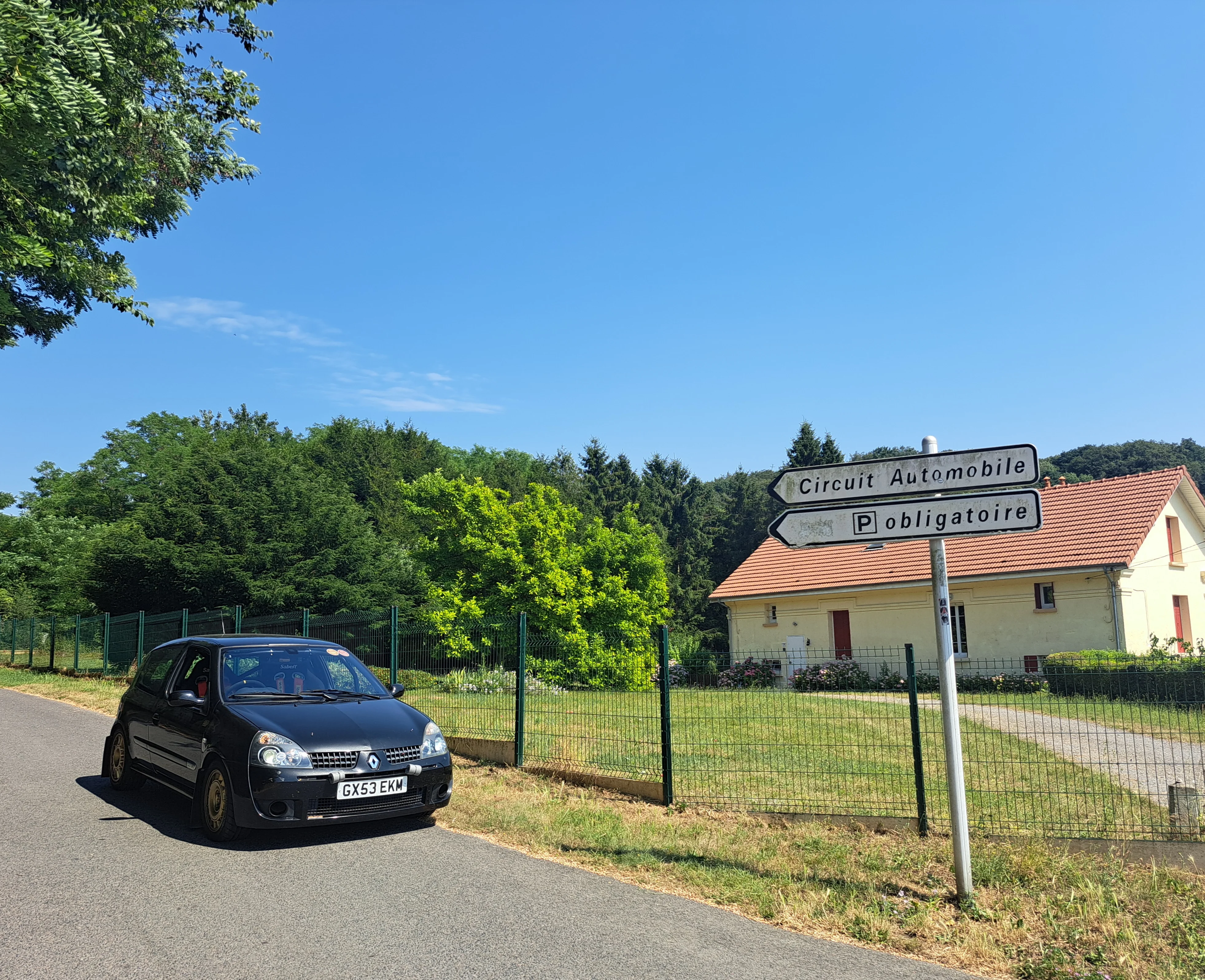

Being in France, lunch was of course une baguette:
Outside the circuit I understood this sign to mean photo obligatory:
After a successful day, I left early the next morning and headed directly west across France, had a leisurely drive up the coast back to Calais before driving through the night up to Lancashire. With the temperatures easing just a little bit by now I enjoyed the journey and won't bore you with too many holiday snaps:
