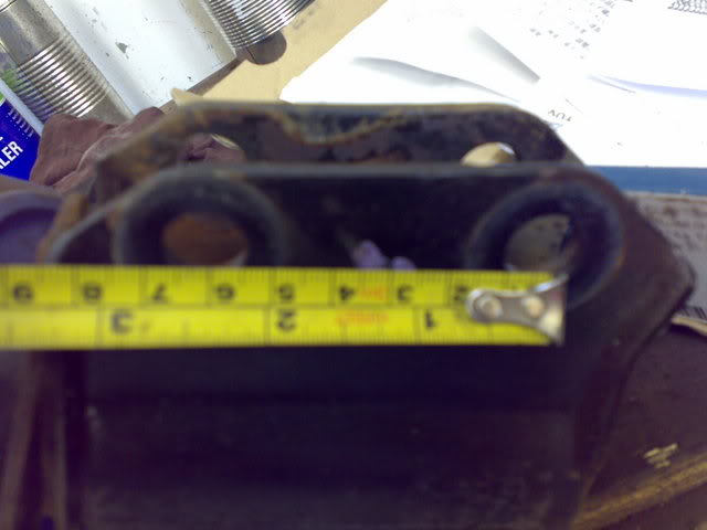

Options on the 182 included Cup suspension and splitter packs. The suspension pack lowered the car a few mm made the dampers, springs and shocks a bit harder also the wheels come in a darker colour. Included in the Cup suspension pack was different hubs which have 60mm hub bolt spacing they are also up rated as they run about 1 degree more camber vs none Cup packed cars
The last of the production models was the Trophy. It was produced using the 182 Cup body but the dampers were changed for Sach's remote dampers at the front and Sachs (none seperate reserviored) at the rear. Springs at the front were changed and suspension camber etc is changed.

182 cup, 182 cup-packed suspension (anthricite alloys) and 182 trophy all have the same hubs. These are fitted with bigger bearings etc. A standard 182 (with silver alloys) has the 172 hub set up. Simple. :)

yeah the 172 cup (ragnotti) ;) has a wider front track simply because of the alloys, nothig to do with the hubs. If you changed your hubs, to 182 units the suspension legs will have to be changed as the bolt spacing is different too.
The 182 cup has 60mm (seen here on my 182 cup-packed car), the 172's are less.
