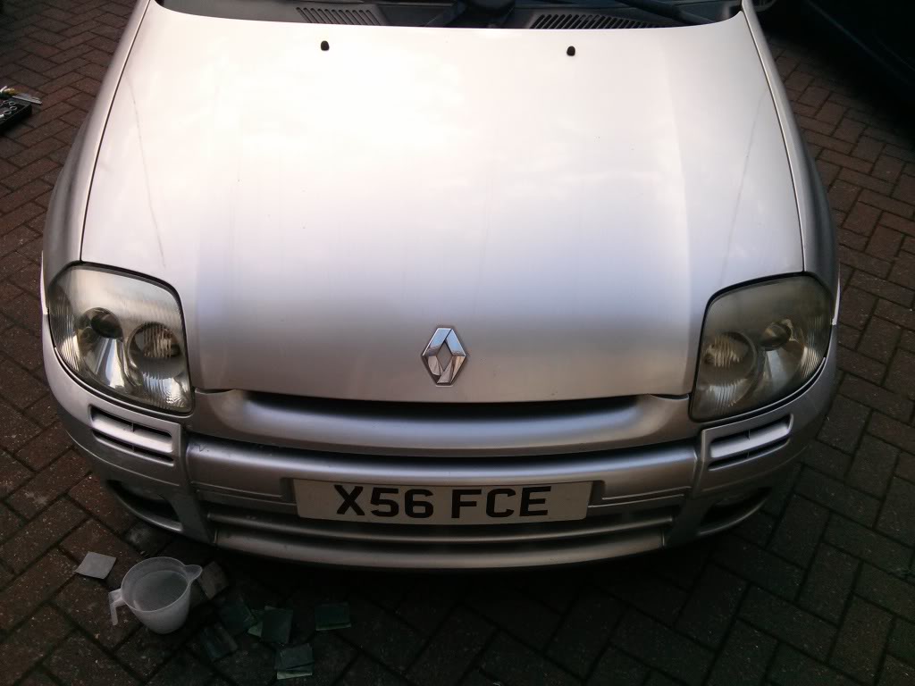

Before:
An example of the patchiness someone left behind last time:

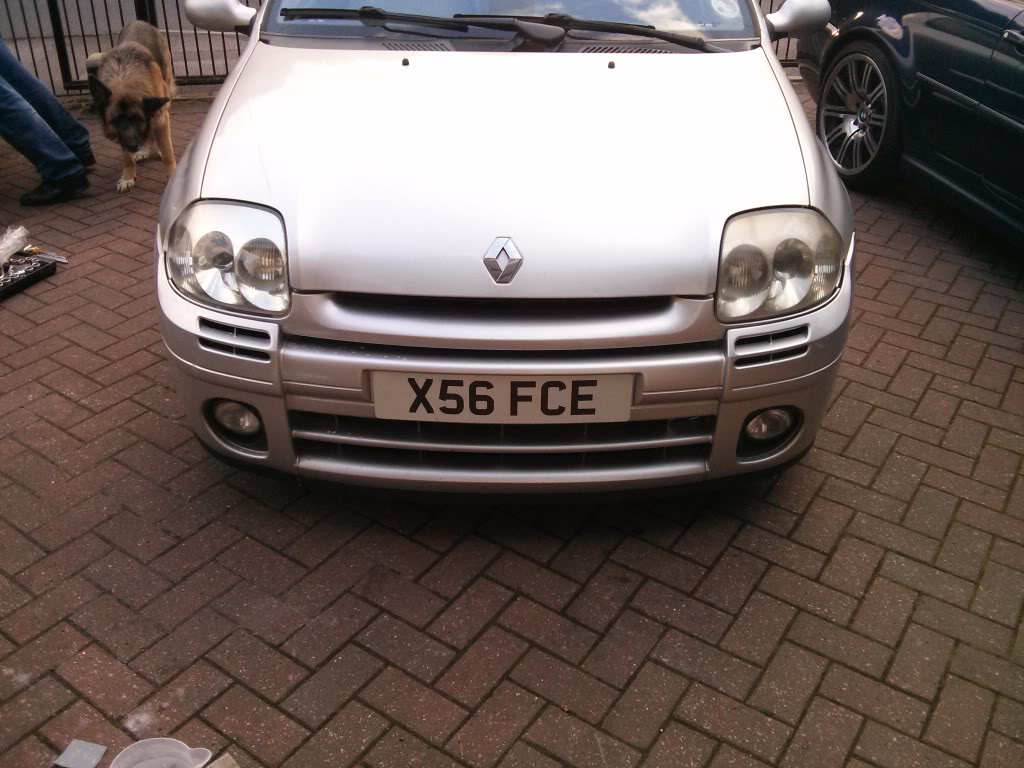

After a quick wipe down of the headlights I got the wet and dry out.
800 grit first (in hindsight I probably could have got away with starting at 1000 grit)
Next up 1000 grit:
Then on to 1200 grit:
Followed by 1500:
Then 2000:
And 2500 which was the last of the sanding:

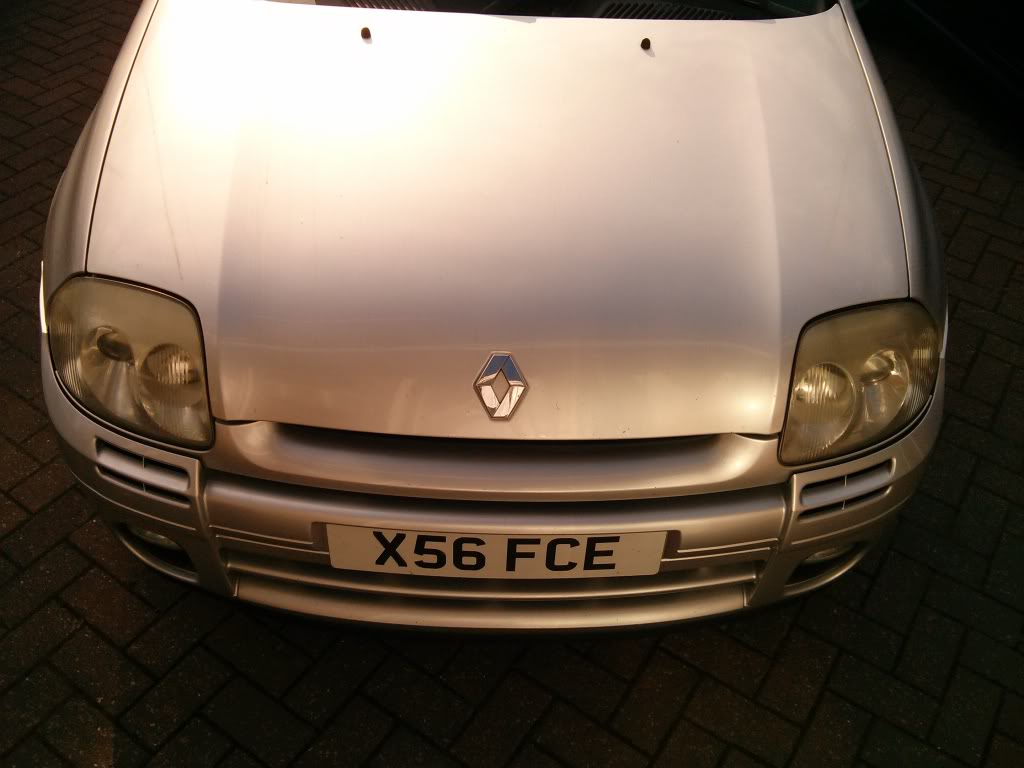

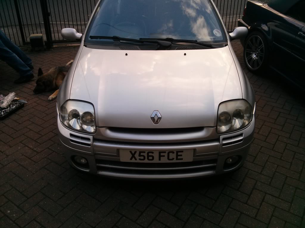

Then I polished it and applied some Gtechniq C4:
And a few shots to show the comparison between before and after:
