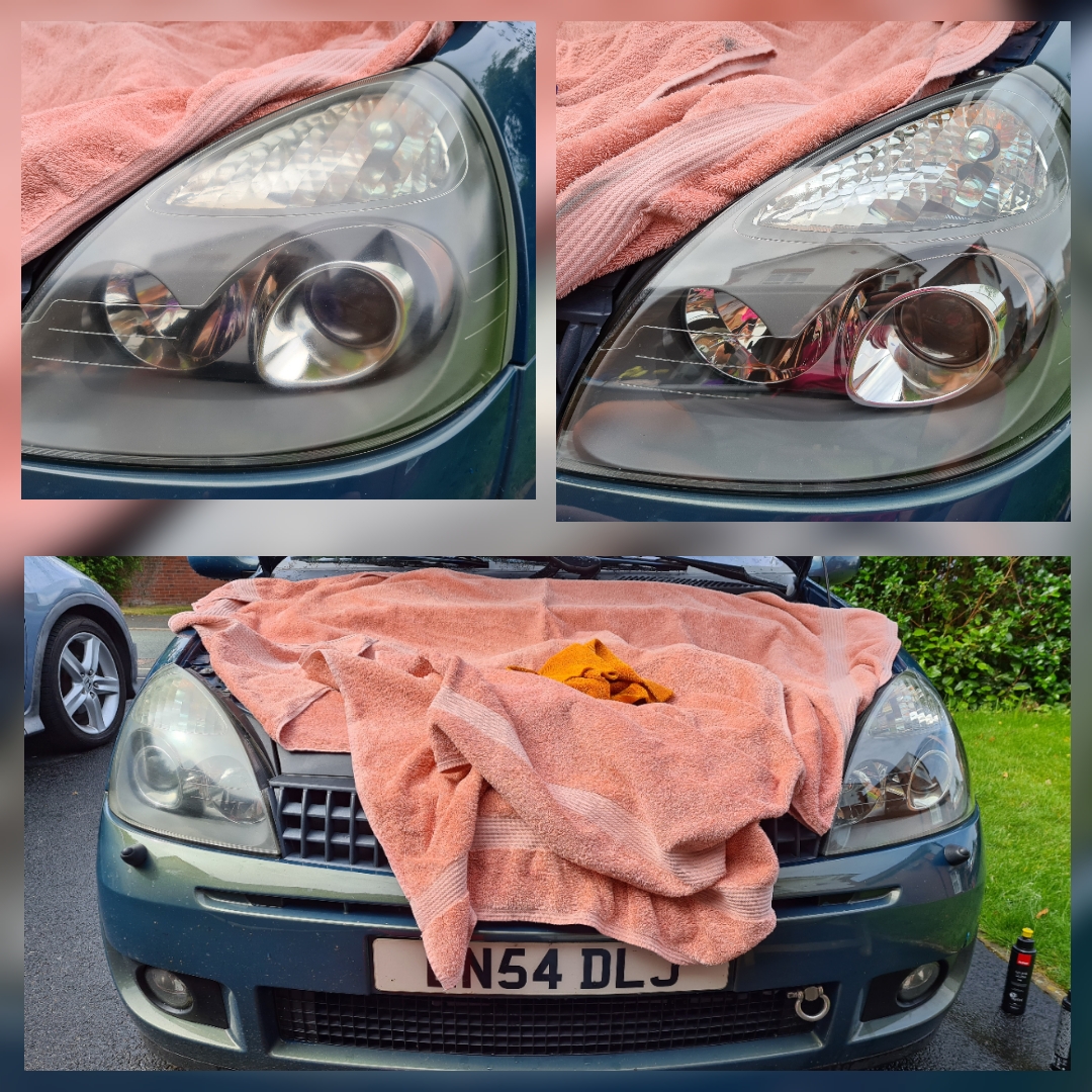

This thread reminded me to get my arse in gear and whip over my headlights again. The rest of the car is skanky, but at least the lights are clean!
Another go with The Chemical Guys Headlight Restorer and two cloths.
Such a shame that the plastic is cracked in the nearside unit at the top and the xenon shroud all pitted. Trying to get another in the dark grey is proving very, very difficult. :(

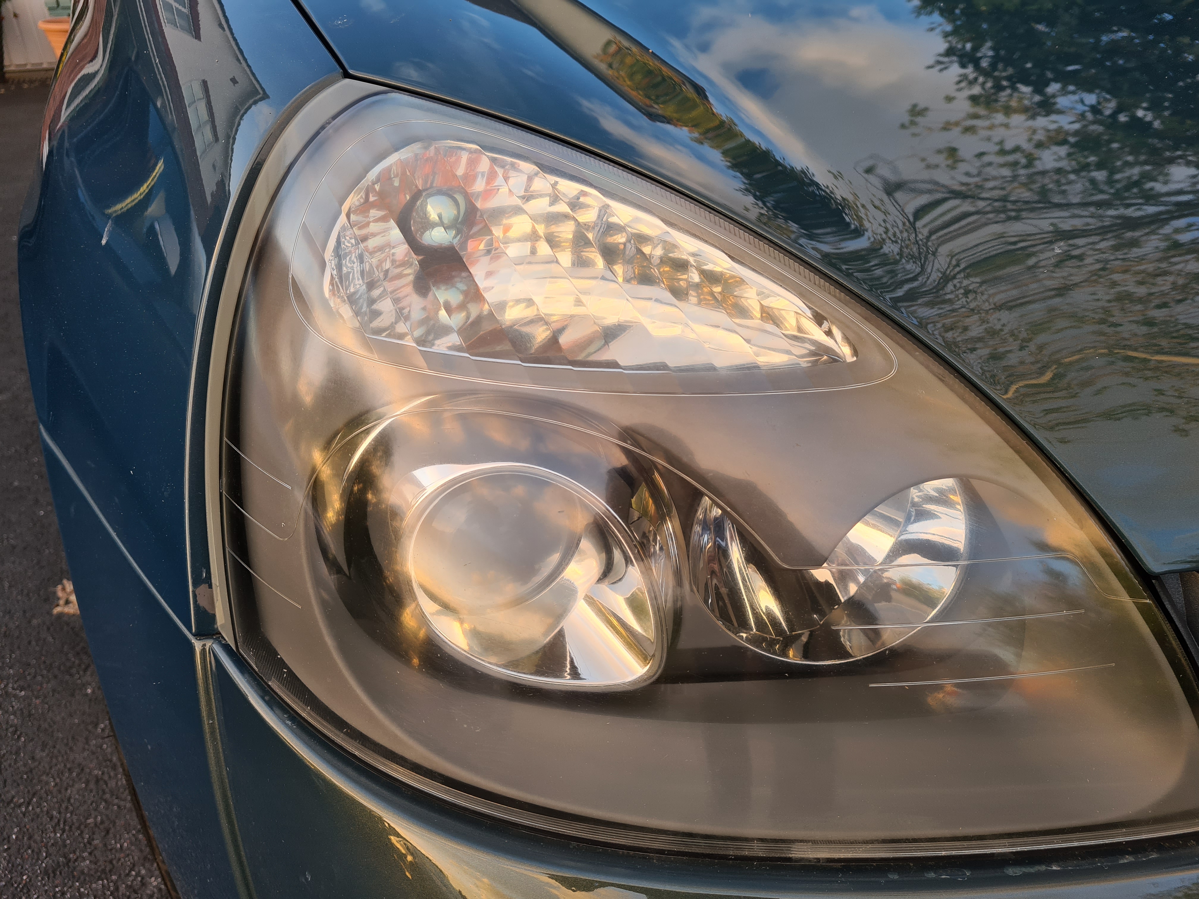

It definitely messes up a ceramic coated headlight. Done our Civics headlights which were ceramic coated last year and still looking nice and clear. Initially looked alright but now they look all smeary and dull.
As for the Clio headlights, they've already lost their crisp looking clearness and ideally would need redoing.
