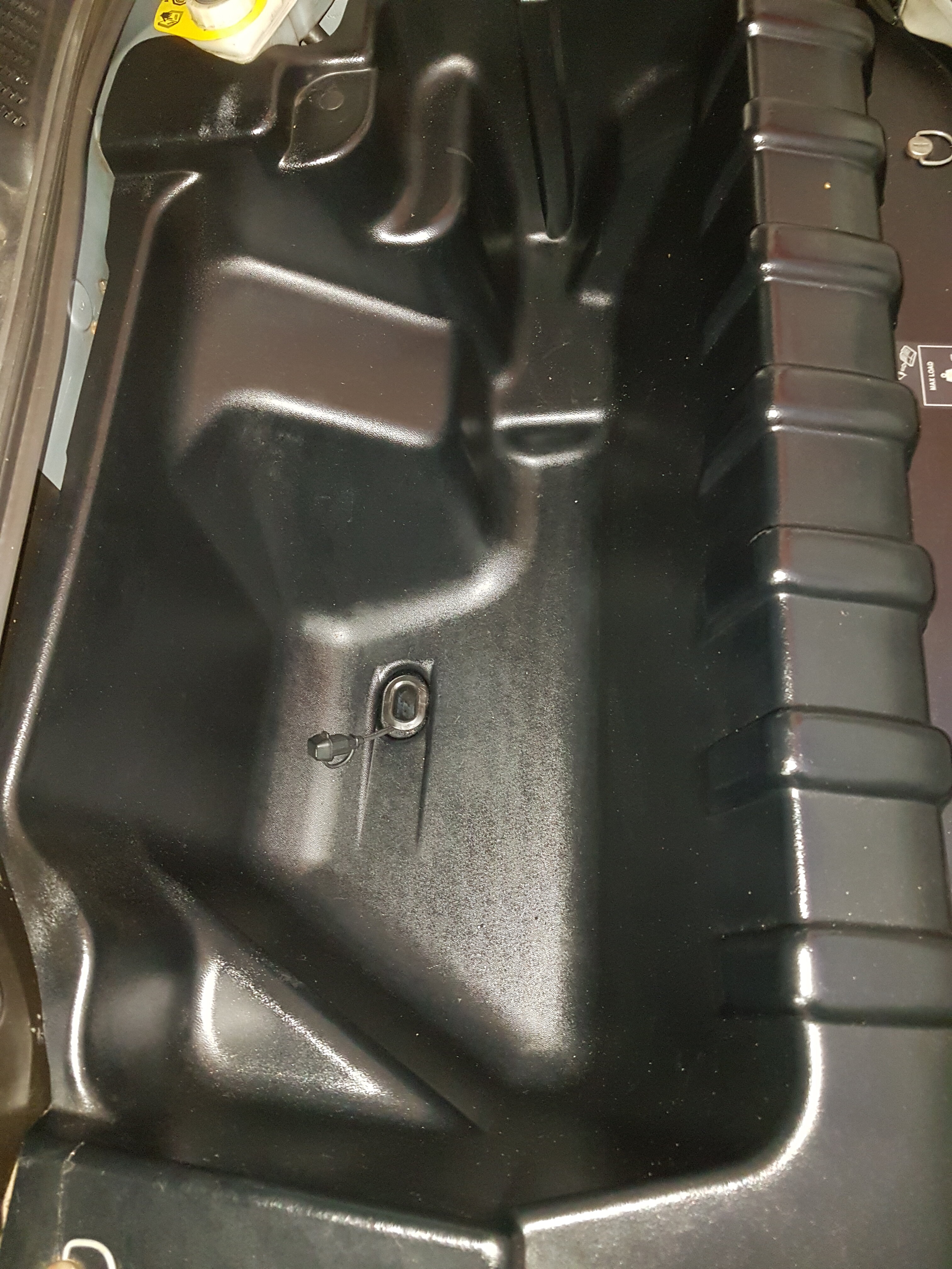

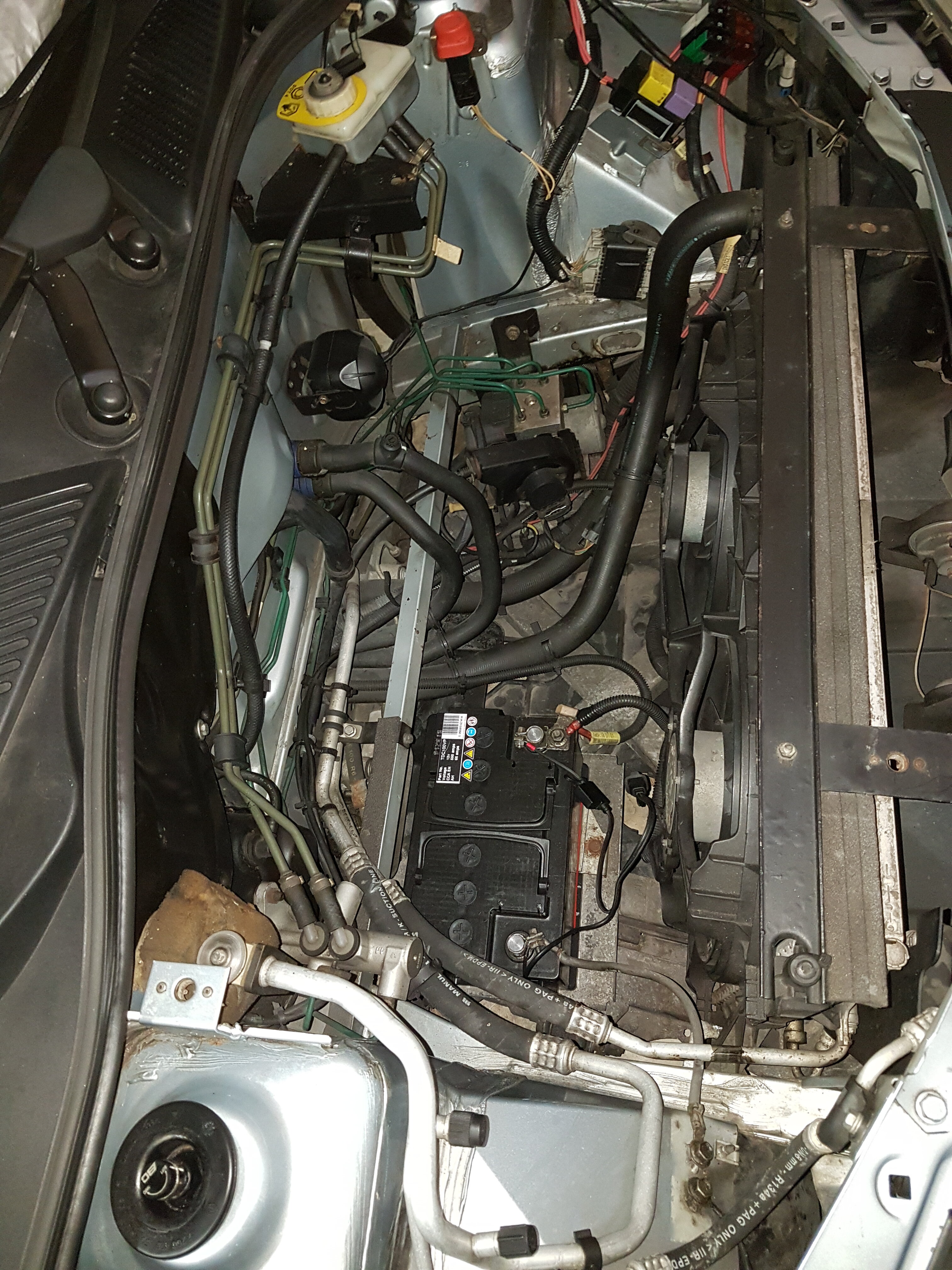

OK, some good news! No cutting required if you are using an Accumate - the lead will stretch to the 'kitchen sink' plughole at the bottom.
Thus, wired in:
Brought in through the plug hole and drain pipe fed back in.
Really simple to do, but a clean, neat, safe and waterproof charger. I'm a happy chap.
