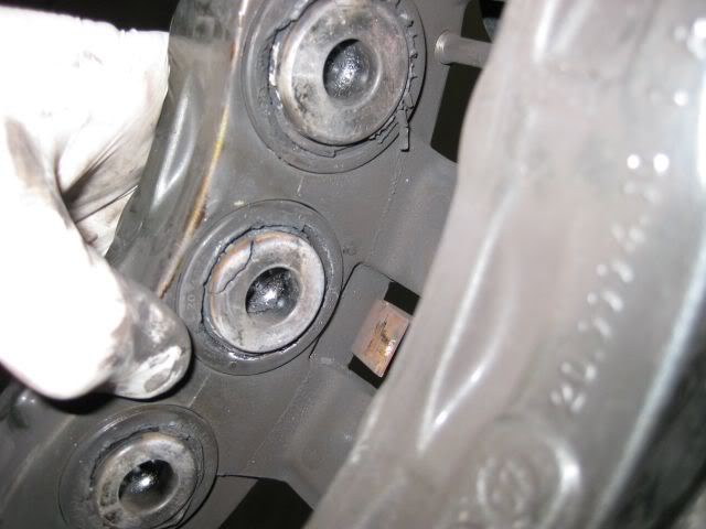

Andy's solution with the BMW Performance calipers is great VFM... only thing is some people in the US have had trouble with them. In an ideal world you'd get to try everything out beforehand, but i might of crossed my fingers and gone with that kit instead of APs if they were around when i bought them.
Who's Andy?:p
The problem in the US was a race team running 135s. They used the stock setup (pretty much this setup) for 5 races problem free.
Then they sourced a different pad (not meant for this caliper) and cut it down to fit and didn't use the titanium backing plate that helps to dissipate/distribute the heat. This all came together and cracked the ceramic material on the pistons.
Performance Friction are developing pads for them as I understand.
