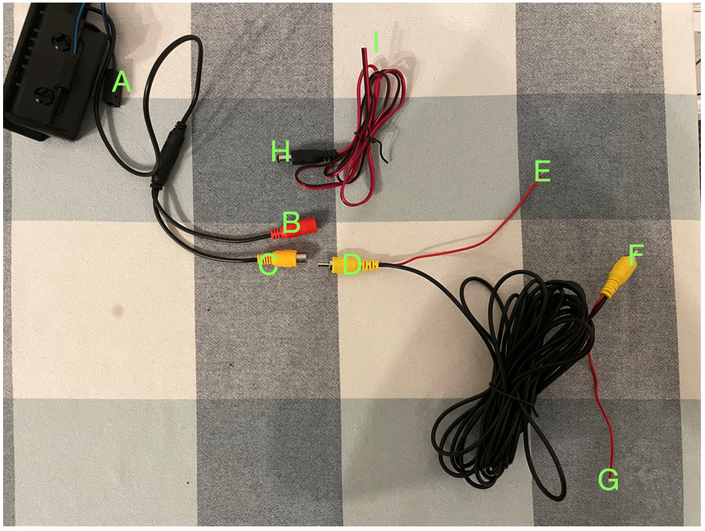

So this is the wiring on the camera is this:
From what I can work out is:
  • A is the boot release switch
  • C and D go together
  • B and H fit together
  • other end of H is a red and black wire. The plug looks like a typical charger/power supply thing
  • There is enough wire between D and F to go through the car
  • There is continuity between E and G (red wires coming from the yellow connectors)

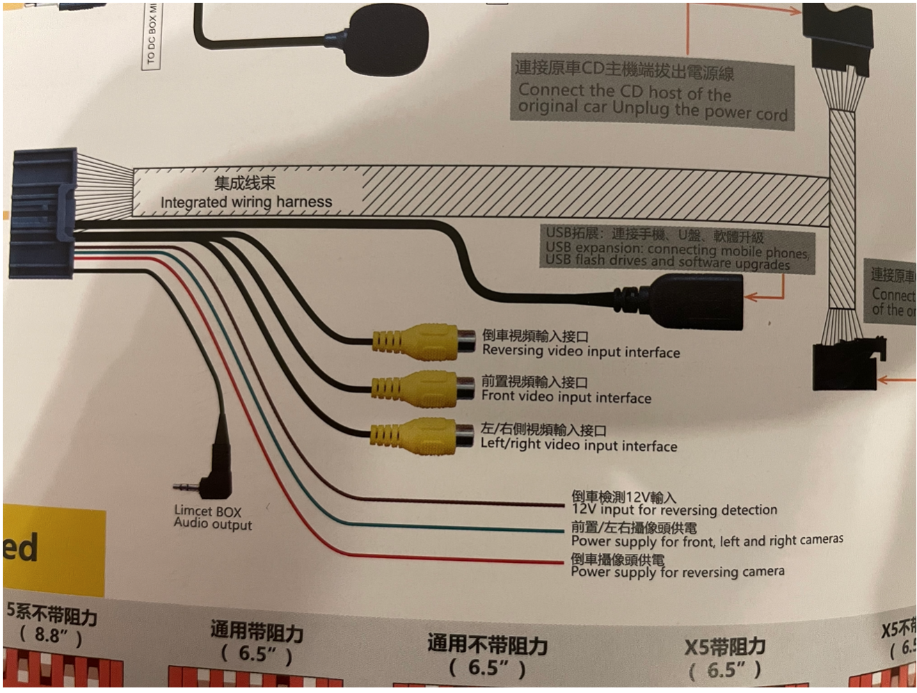

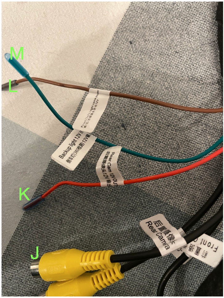

Then the other end of the car play unit has these wires:

  • I don't think I need L and I don't have front camera
  • I know I need power and a signal to tell the unit that the car is in reverse to turn the camera on (other reverse cameras I have seen jump off a reverse bulb)
  • Not sure what M is with "Back up light"? Is this just bad translation and means something like "reversing light" or a light back up?
  • But then I want to connect F and J together then put G to K for some reason.
  • This just leaves the plug H with the wires I (red and black)? Now do I put the red of I into E and then the black of I into the reverse bulb?

Actually just watched this and is a better video. Pretty certain it is a different unit and camera to mine but the wiring looks the same. Says the didn't need a reverse trigger as his head unit knows what gear it is in (the parking sensors come up on the screen so maybe it can work it out from that feed?). If so then it is simple. Don't need to attch M as I now think that is the reverse trigger. Black wire of I goes to ground. And red wire of I goes to E. That sound reasonable?

B to H to 12v (powers camera, can be linked to rev light so it only comes on when in rev.
Can also be wired to earth and connected via E/G to gain power from the front of car, via K or a switch.
If powered via H, E and G can be ignored.
M is if you have a camera with LEDs that have a separate 12v feed, might be what B/H is for, depends on camera. try it with and without the 12v feed.
L is if you have front/side cameras what link to the phono cables next to J and shown on the instructions, I assume the DVR/Screen/headunit can be used as dashcam recorder
KitsonRis
I see what you mean, it can either be powered by the head unit (E,G,K)
