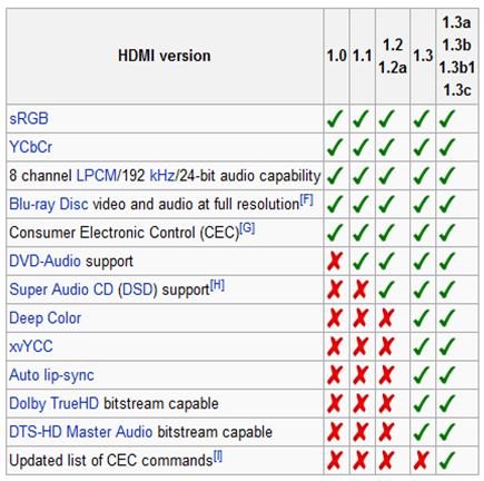

Well technically there are.
HDMI 1.0 to 1.3
1.3 being the best supporting all fronts of HD signals.

Well the latest version is 1.3c but the 1.3a version had the next stage of updates...
HDMI 1.3a
Released November 10, 2006
Cable and Sink modifications for Type C
Source termination recommendation
Removed undershoot and maximum rise/fall time limits.
CEC capacitance limits changed
sRGB video quantization range clarification
CEC commands for timer control brought back in an altered form, audio control commands added.
Concurrently released compliance test specification included.

All 3 "Tiers" they are selling are 1.3A thats what makes it so stupid
It depends what you consider the 3 tiers, if you include Logik cables then they are not 1.3a, where as the grey series and black series are.
