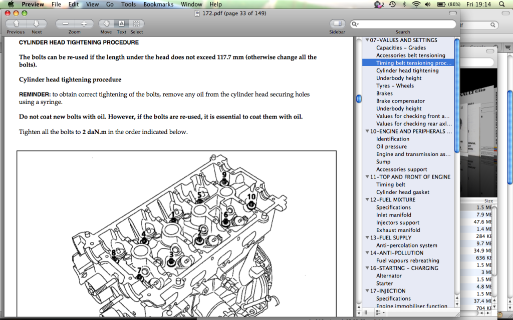

its in the CB0M assembly manual available on here somewhere, or it might be on the fastchip.nl site

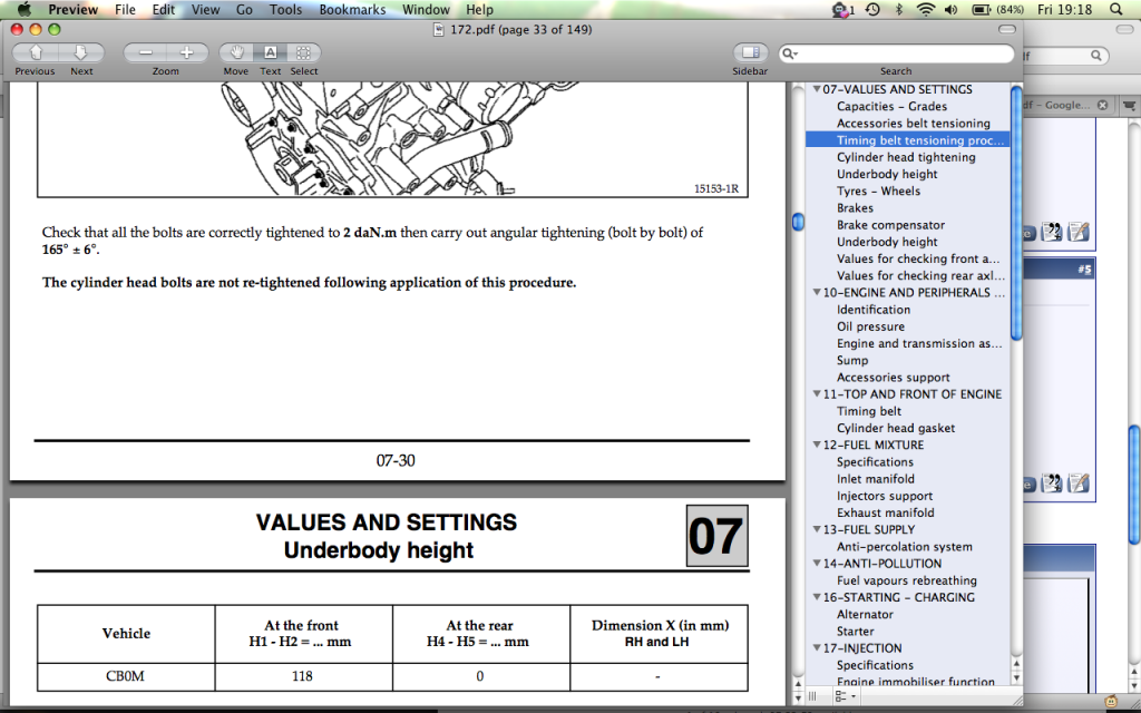

the 20DaNM is just the 1st procedure. You follow that with angle tightening (I can remember the angle)
tighten them all in that order above to 20 newton meters
then tighten them a further 165 degrees in the same order
