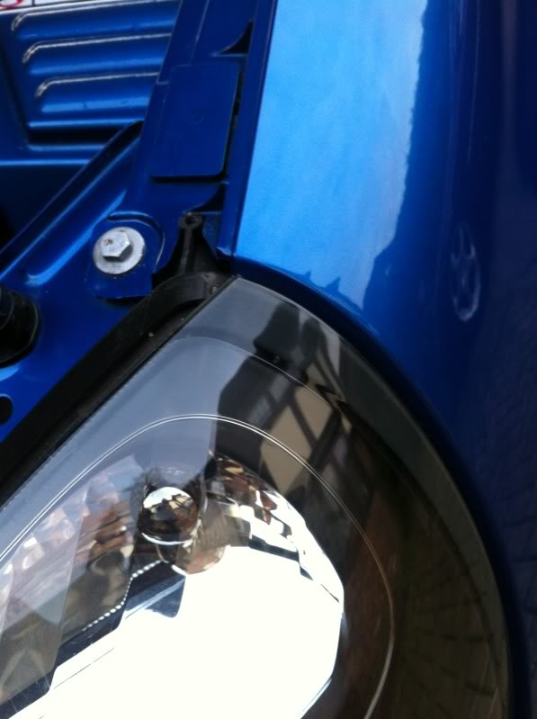

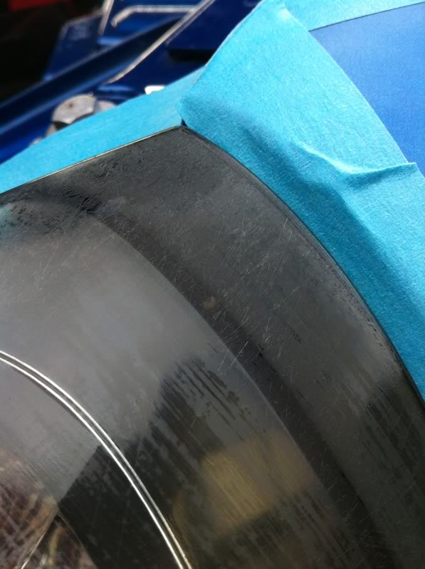

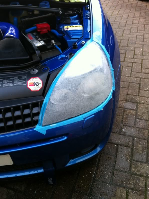

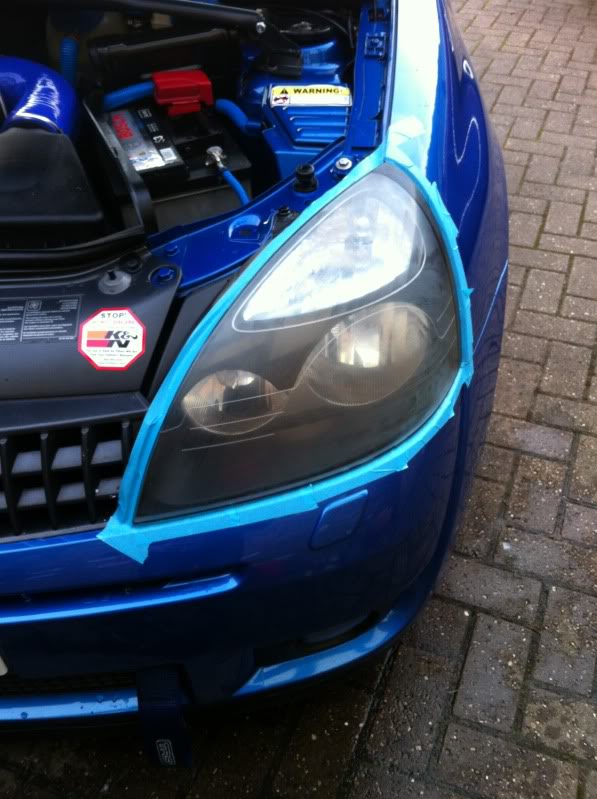

Well I thought I would give my headlights a little love today and tbh I think the results came out alright.
Only too about 1 hour to do both headlights, I'm sure I could spend a little more time on them and they would be perfect but tbh I can't be arsed and the pub is calling.
Before
After 2500 Grit Sand Paper
A Lick of Polish
After

lol its well worth it and a piece of piss to do. Just stick with the 2500 grit wet and dry otherwise you'll be there all day afterwards buffing lol
  BG 182
Looks loads better mate! I did mine yesterday and they're better but not perfect. I've still got weird patches/blotches across the middle of the headlight, anyone got an idea what this is and how to get rid of it?
  BG 182
No I used 2000 then 2500 and polished up with that Mcguires scratch x stuff. Its come out really well tbh apart from the patches
  172 Cup 181bp 165lbf
All I used was 2500 grit then compound with my machine buffer then a small amount of Auto Glym HR polish. I stuck with just the 2500 sand paper because a friend of mine told me it would take ages if I used a lower grade. I had 1 new blotch come up the other day (hence the reason to do this) and it just sanded out. A lot of sanding is the key to this. I believe it's the sun that causes these
