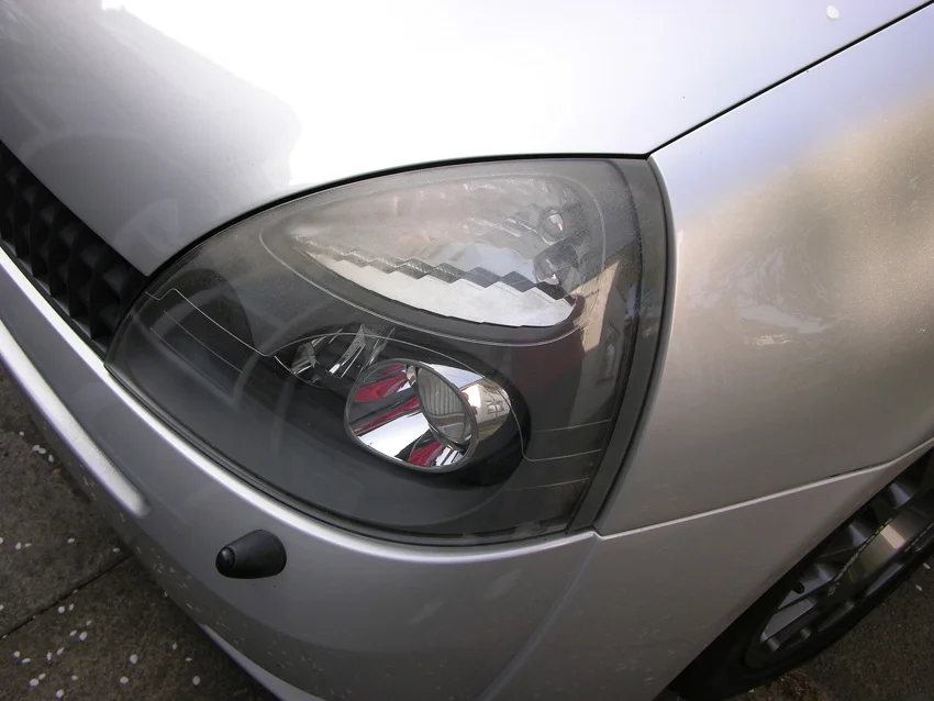

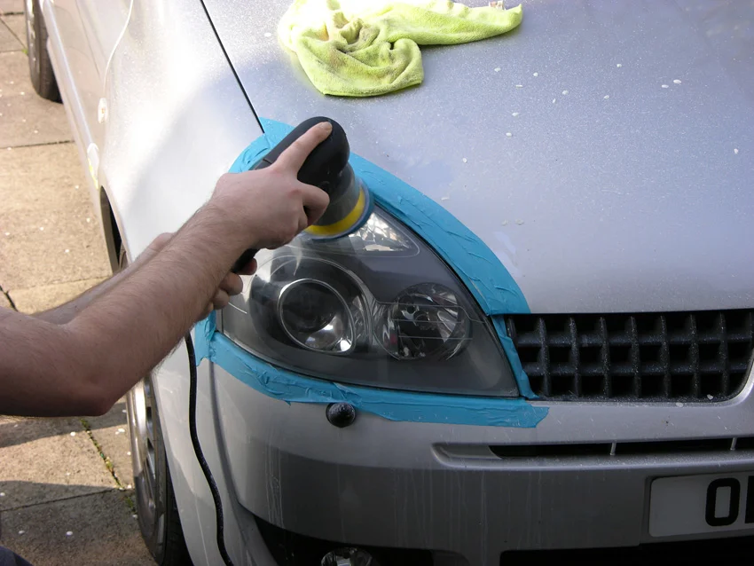

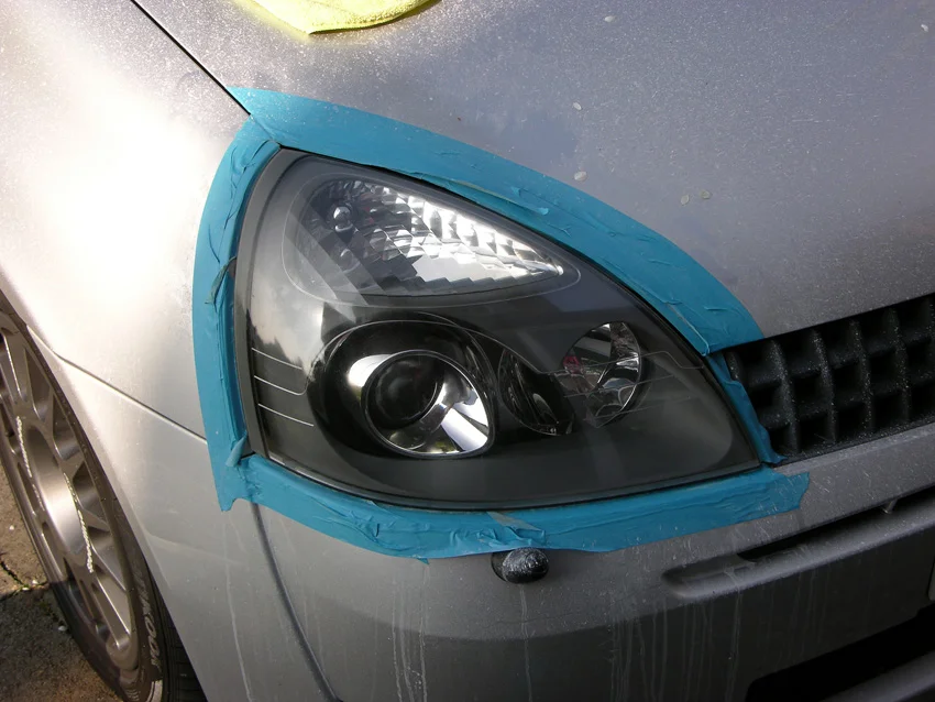

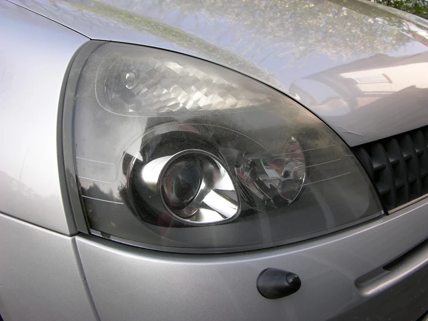

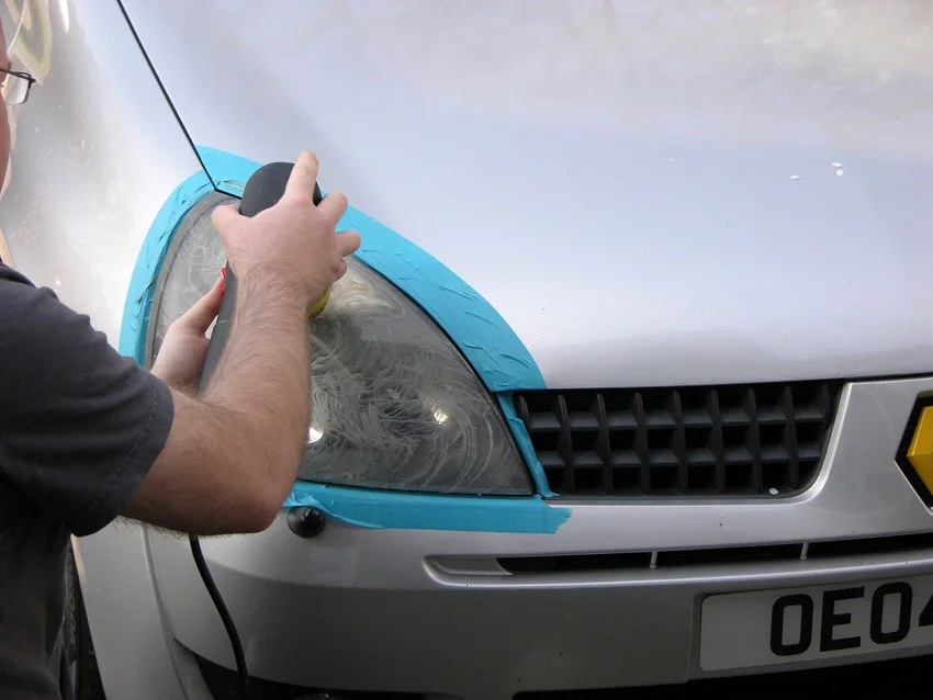

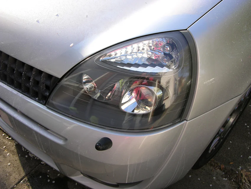

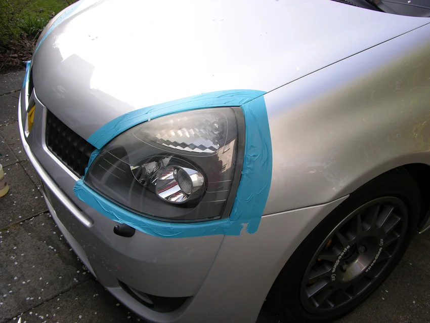

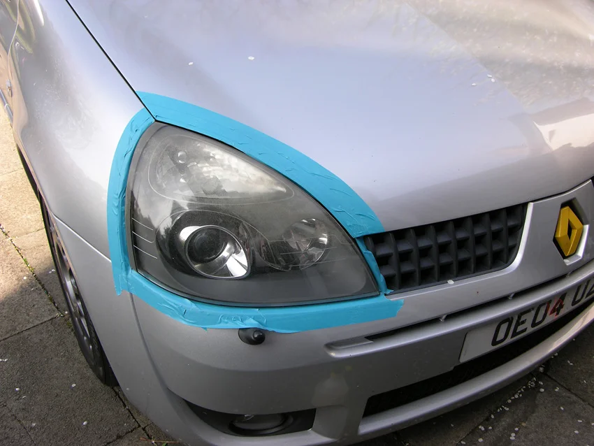

Few pics of my headlights being corrected, taken this weekend, before, during and after. They'd got quite rotten, over nearly 8 years and 88, 000 miles.
HUGE thanks to -J- for taking the time to do them for me.
Awesome change! Do you have to use a da or machine? Or can you do it by hand?
You can do them by hand, just need a bit of elbow grease with the wet and dry and polish to refine the sanding marks.
I just use 2000 grit 3m paper on the DA for speed, then zip over the lights with some polish after.
Stuntys lights can still be worked further on but I needed some paper with a little more bite, I'd say about 70% correction achieved.
See here, I started these lights by hand then swapped to DA
http://www.cliosport.net/forum/showthread.php?p=8518520
I did mine today with 800 thn 1200 then 1500 and finishd with scratch X 2 and all did by hand and what a result tbh....lights look million times better....thanks for the tips lads
