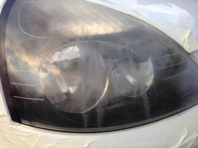

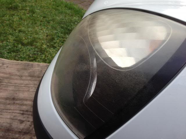

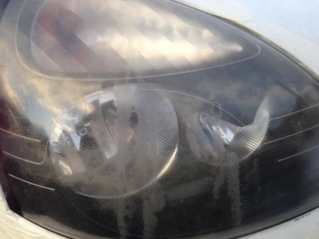

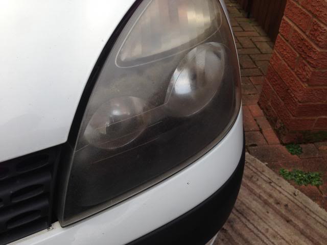

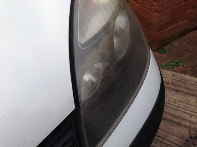

before
passenger headlight
drivers headlight

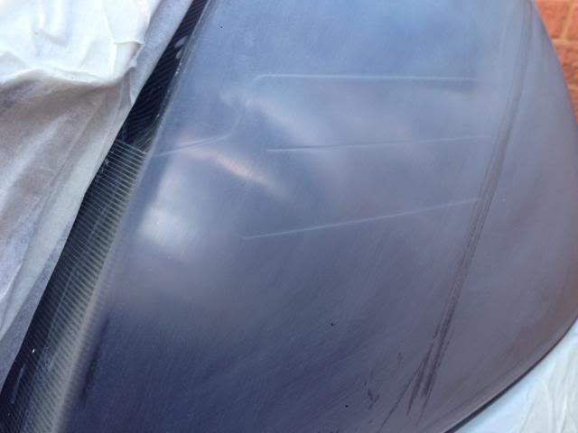

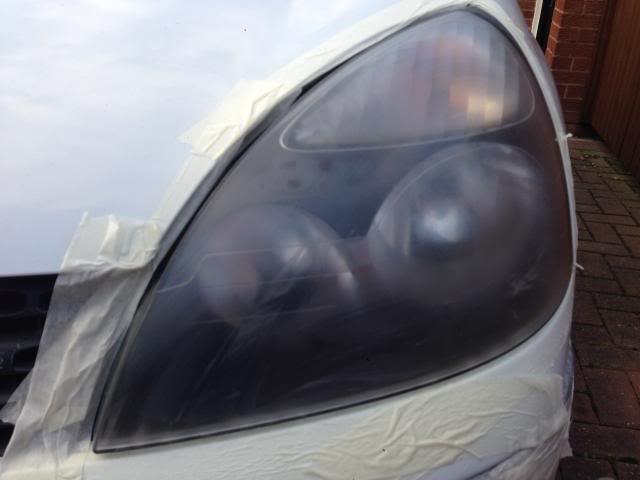

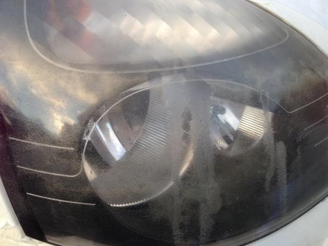

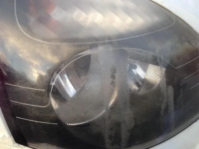

wet flatted with 1200
went on to flat using 2000 then 3000 (sorry no pics got carried away)

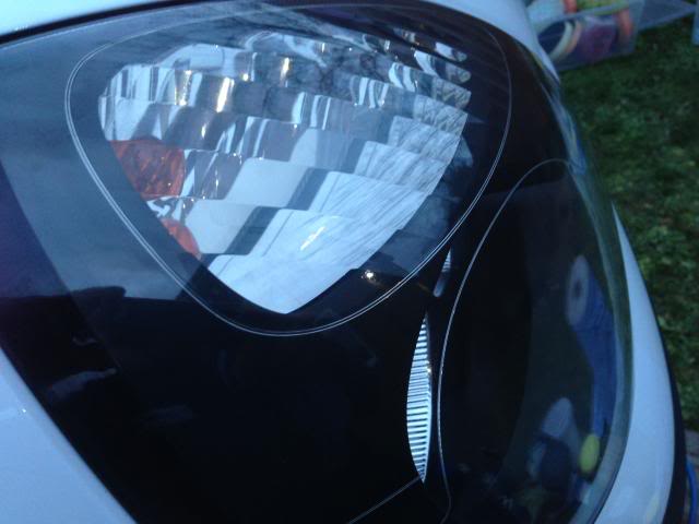

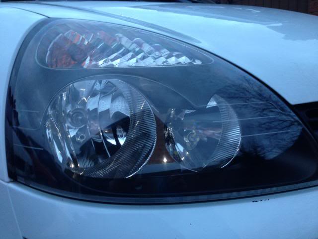

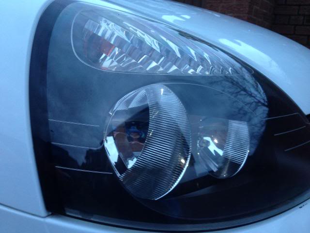

finished headlight (sorry only drivers)
could probably go a bit more but i am more than happy with the results compared to the way they were.
