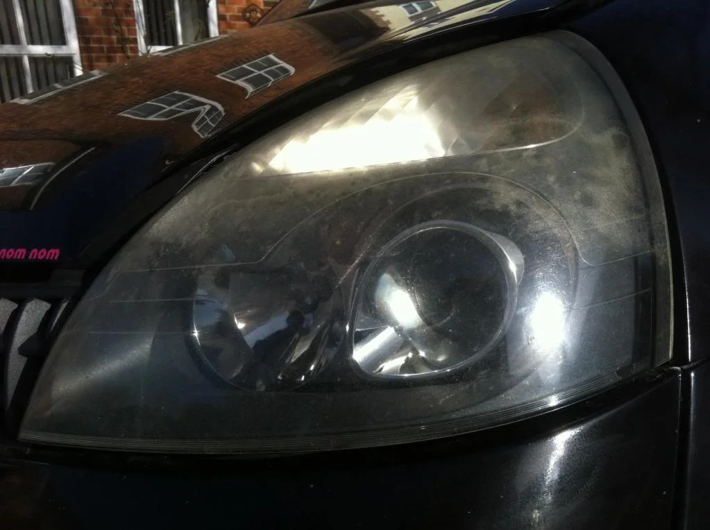

Headlights are a mess!
Car  Liquid Yellow 182

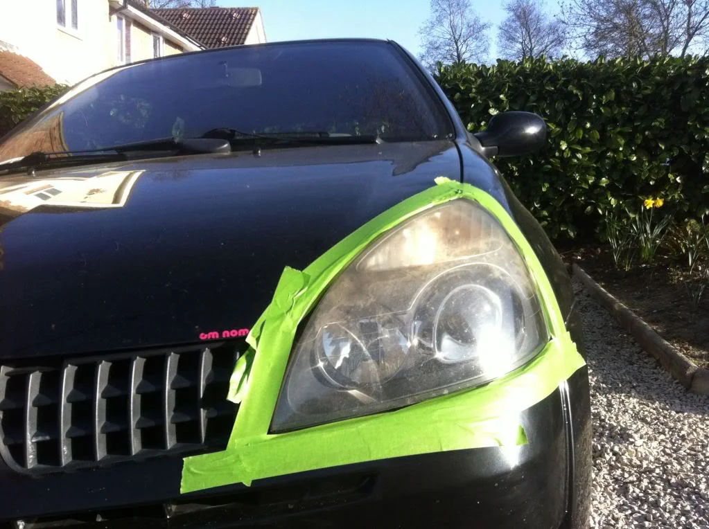

Right I got some 1200 grit wet and dry, do I just sand them till the scratches are gone and then polish? and could I use any polish or is there a certain one that only works?
Most people say work your way though the grades, 1500, 2000 and then 2500 all wet.

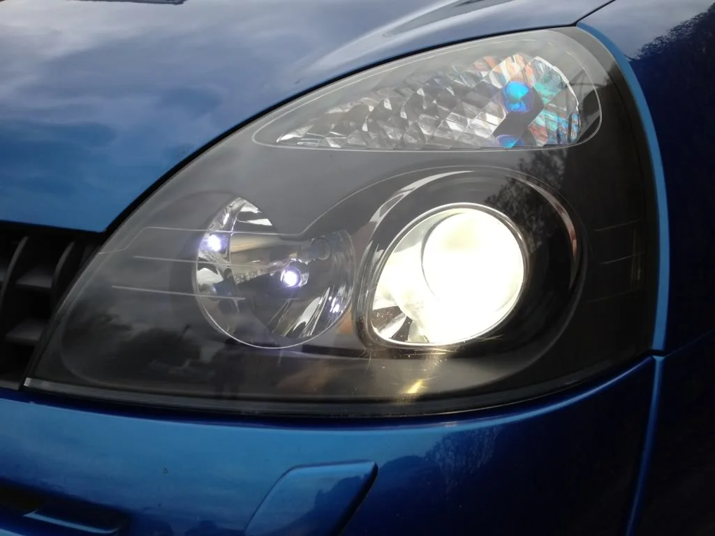

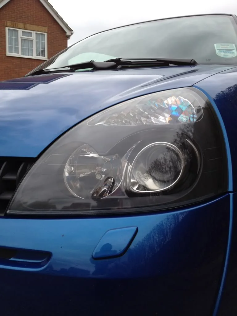

I got mine to come up like this,
From this
And I just used a DA polisher with some Scratch X. Theres still a few light scratches but millions times better than when I bought them!
Good luck:)
