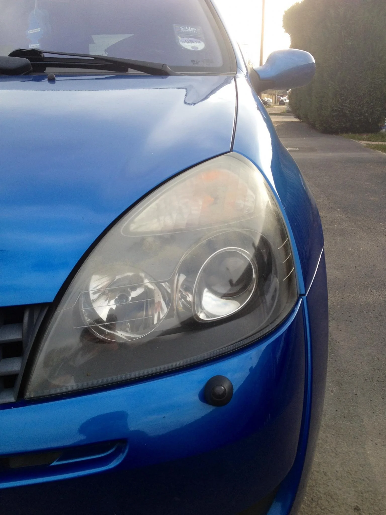

Well then, since I've had the car I've never been happy with the lights on it. I thought instead of just buying new ones ill try and save them. So I had a go by hand with the wet/dry paper etc but didn't get that far. They were still ruined. So I thought I'd bite the bullet and buy some gear and do it properly. Couple of hours spare this afternoon so out it all came?
This is what I started with:

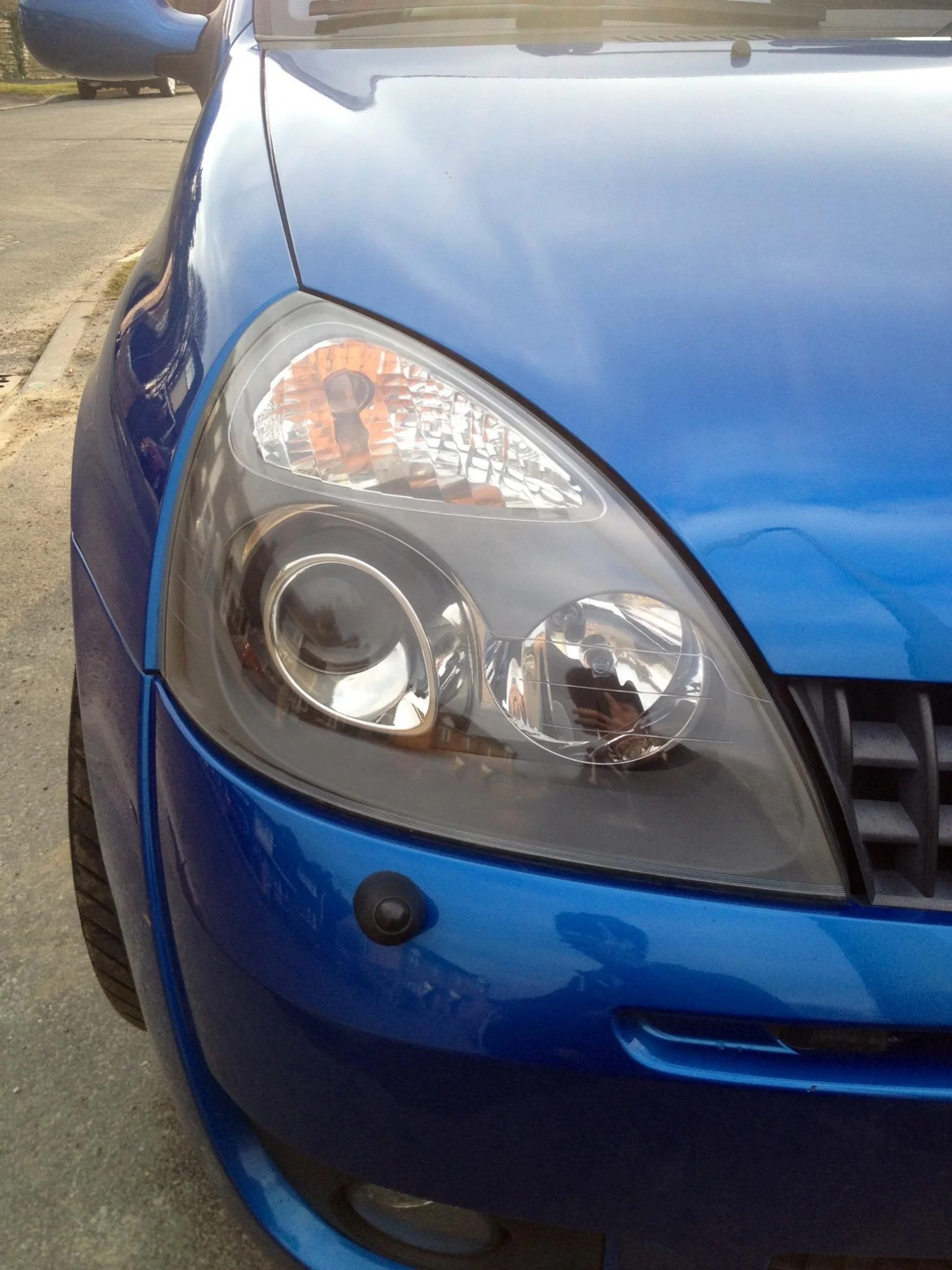

And what they are now:
What I want to do is seal them with something to help protect them. Any ideas?

I used the 3" wet/dry discs, started with 2000 then 4000, then went over that with a 3m green pad (the compound one) with scholl concepts S17+ compound. Then gave it a polish with the 3m yellow polishing pad?

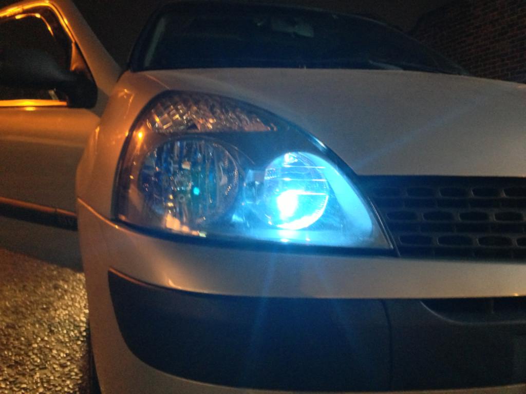

For your sidelights get some T5W 501 LED's (i use these in my non xenon headlights - they should be the same for your xenon projector headlights) in white - they give a nice glow and smarten up the front end.
For a brighter headlight - check out a 6k hid kit. 6k is the "whitest white" you can get. I had them for a while in my old projector headlights. Really improved vision and have a nice crisp white colour.

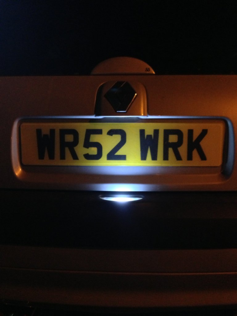

Hmmmm might have to look into them all? Just want to tidy everything up that's all? Got a new rear number plate bulb holder, just need a nice bulb for that too then can fit that? Any ideas for that?
I got my rear number plate bulb of eBay. Can't remember the exact name but it's a 7 led white bulb. Looks like this
And here's what the side light LEDs look like.
Alot smarter than the standard yellow ones pal.
Pick them up off eBay. Mine have lasted months.
The rear bulb was about £10 for 2 and the sidelights a 99p
Yea the new holder was cheap as chips, like under £10? Worth it just to tidy it all up.

A few layers of wax or some sealant should be reet. But then you may end up up restoring them in a years time.

Yea I was thinking just a wax of some sort but wasn't sure if there was anything better? As to the dash will have to do it soon.
Asking in one of the detailing threads will be your best bet, a few layers of wax and some autoglym EGP seems fine for me.
