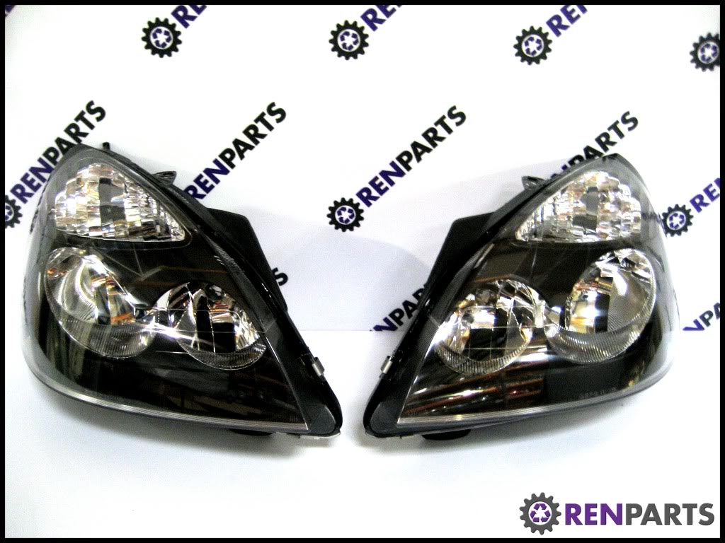

hi I have a 172 with Xenon headlights would the auto levelling work on these thank you
Simon_16v
As Tunst said it's just a little ball joint. If you remove the rubber cover for the dipper beam you can hold the internals and push the auto leveller back into its joint
  PH2 RS172
Just swapped mine over to standard grey inserts from hids. Straight swap on the adjusters and use the same plugs aswell dude
  golf gti turbo
how easy is it to take the bumper off or can I undo the drivers side and get at it that way or is it a full bumper off
  golf gti turbo
just fixed the ones on the car it just came off the clipsbut I think the motor is not working but not shore
