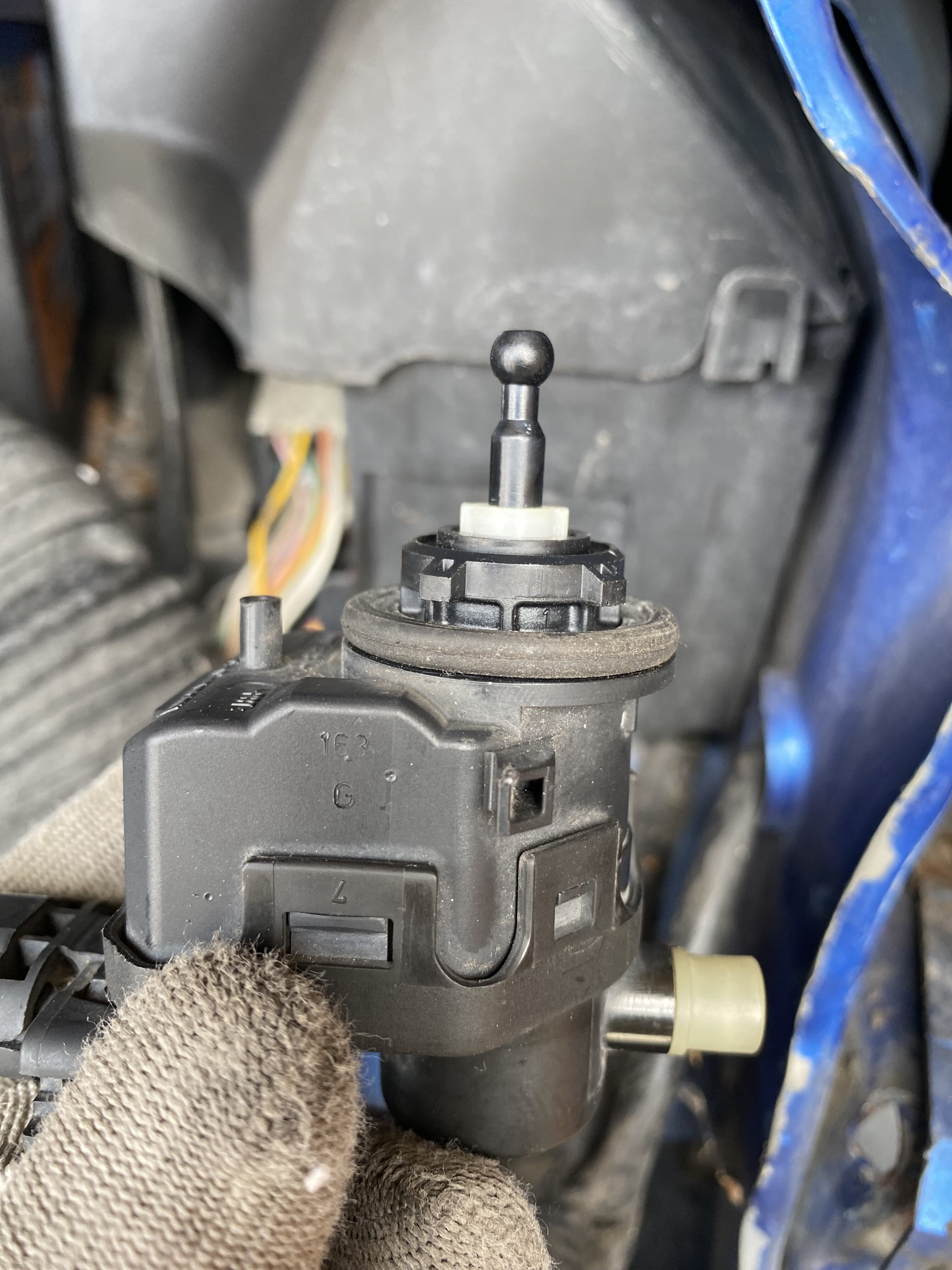

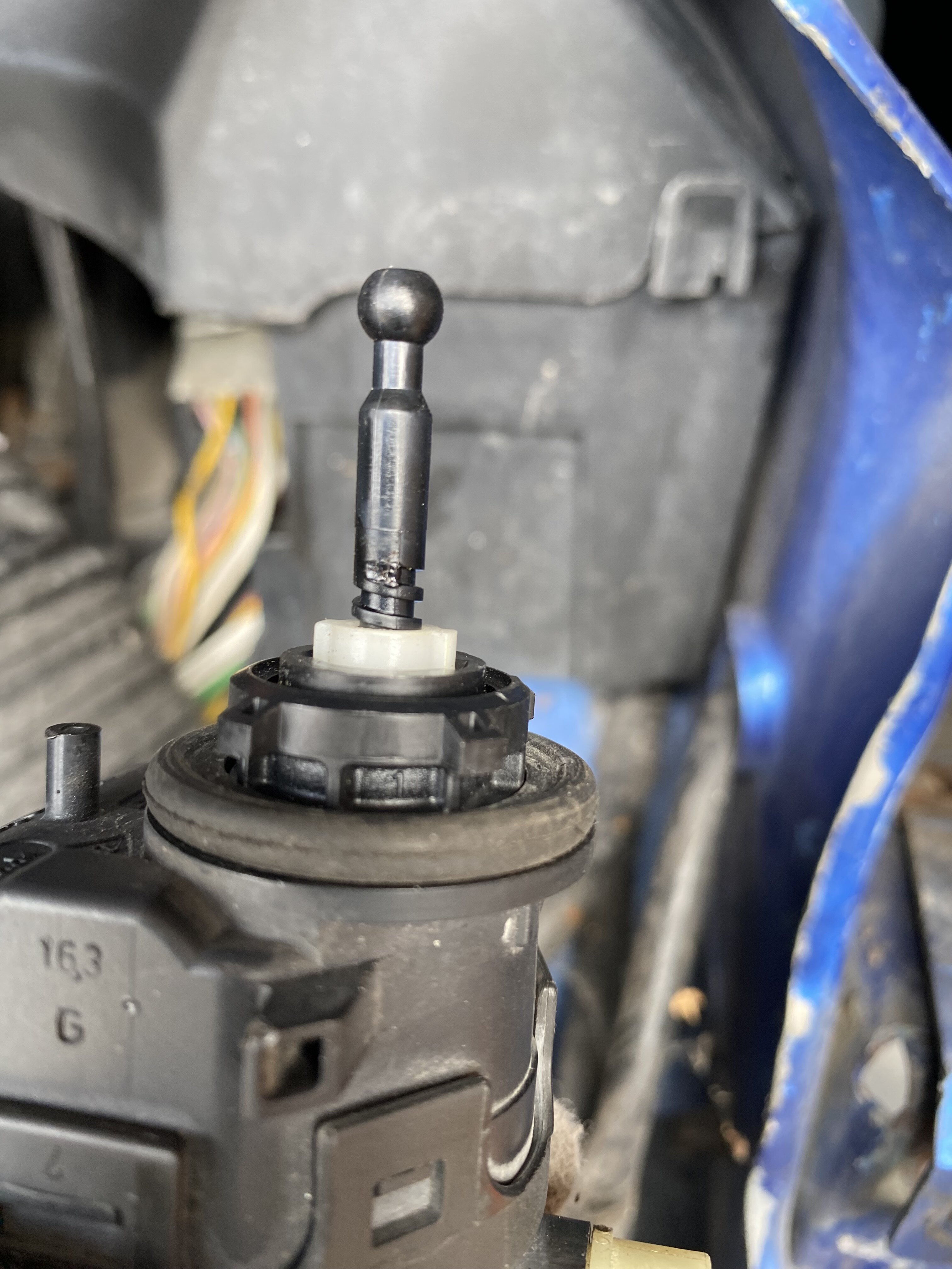

The plastic rod the goes in and out for height adjustment came loose in mine
Depending on airbox setup you can get the motor out without removing the headlight. Removing the headlight is easier though.
Unplug cable. Bend tab on the headlight housing away. Rotate to release from headlight housing. If the end of the rod is still attached, this needs to be pushed down to release from the internal clip inside the headlight.

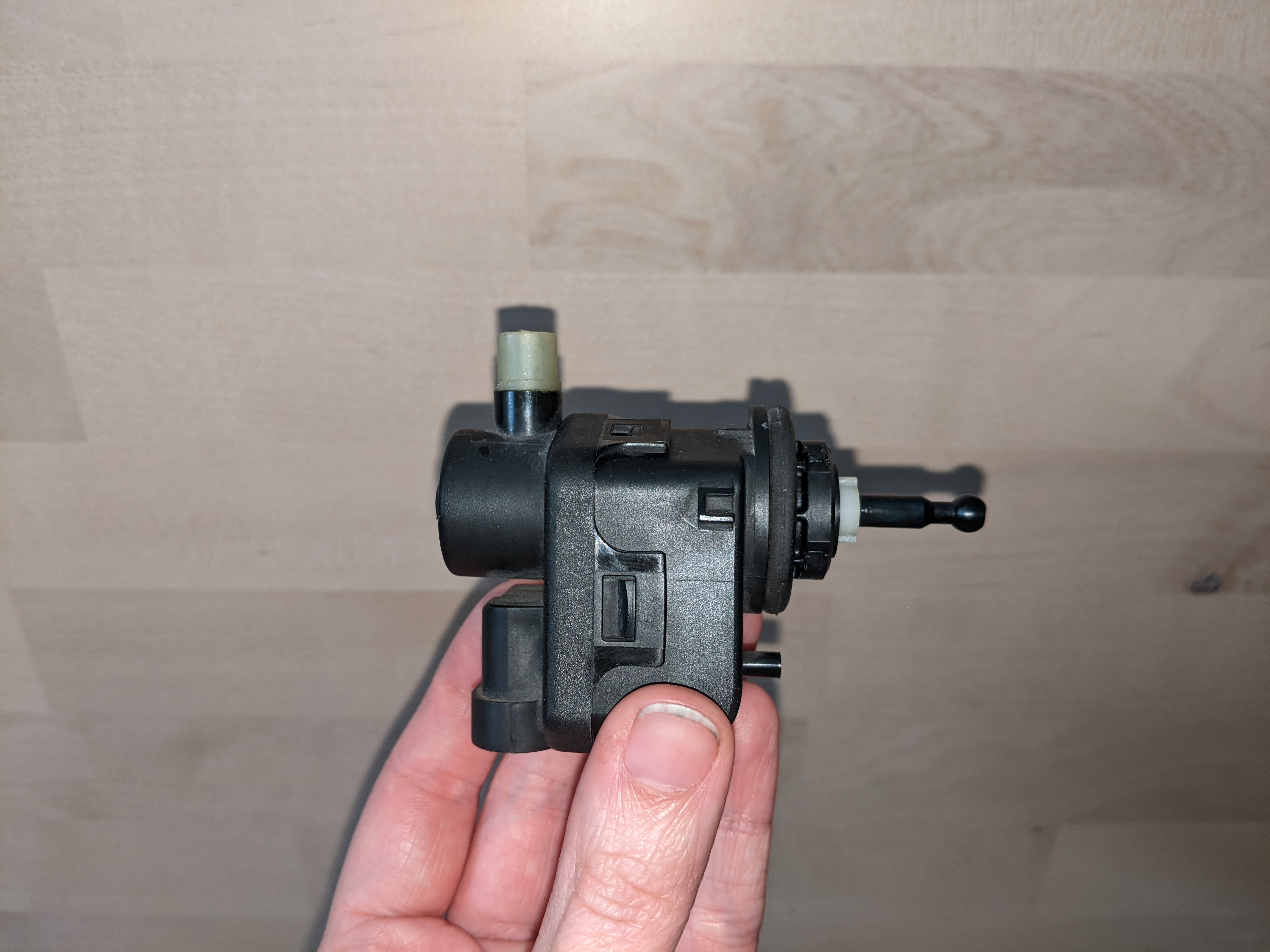

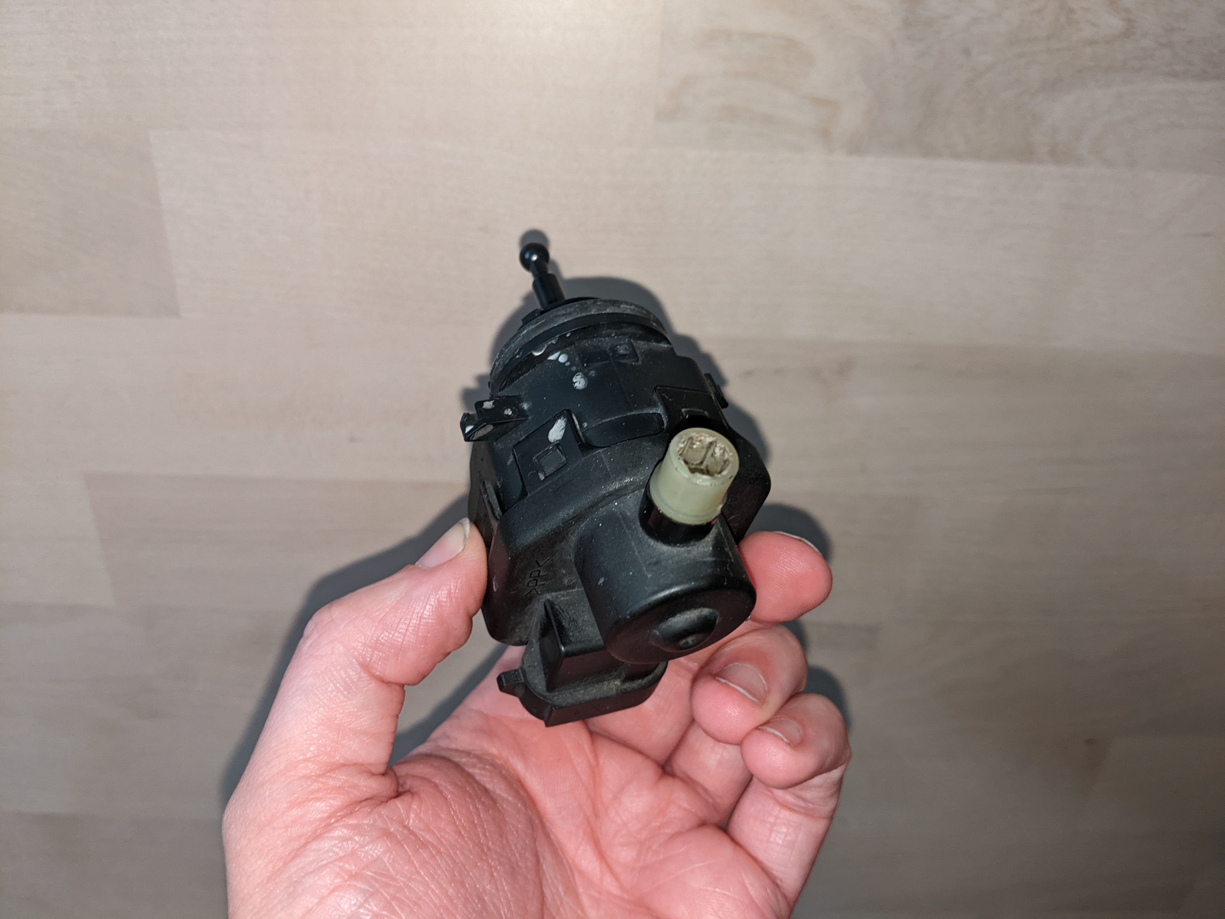

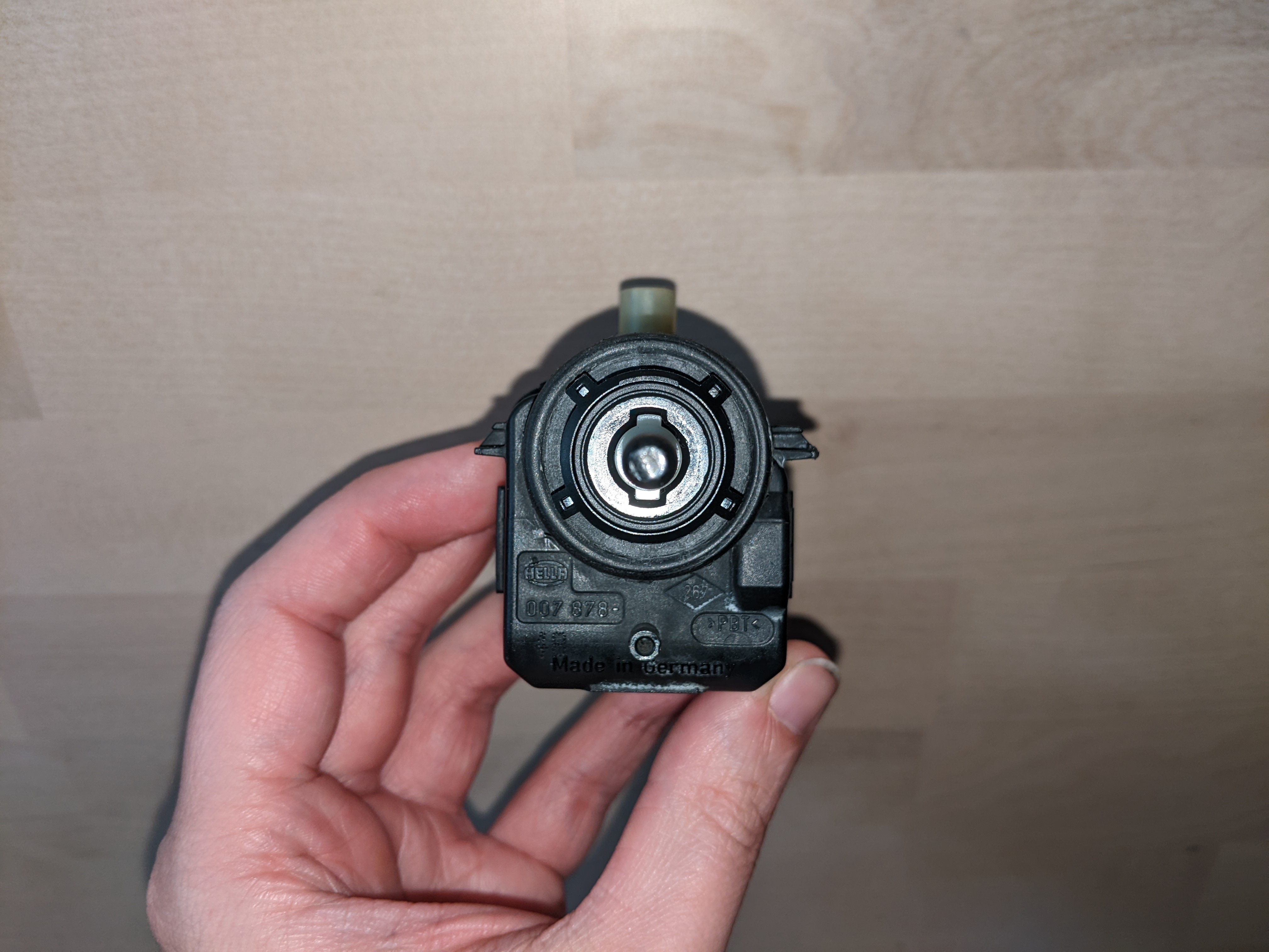

Some quick photos from a motor I have on the side for ref

They can be wound in and out manually with an allen bit. You can see on the second photo the worm drive (?) showing after I wound it out.

To answer your question, both motors move the adjuster arm in and out when I move the dial. I’ve put it all back roughly equal on both sides. Both are wound in so the screw thread is not visible.
