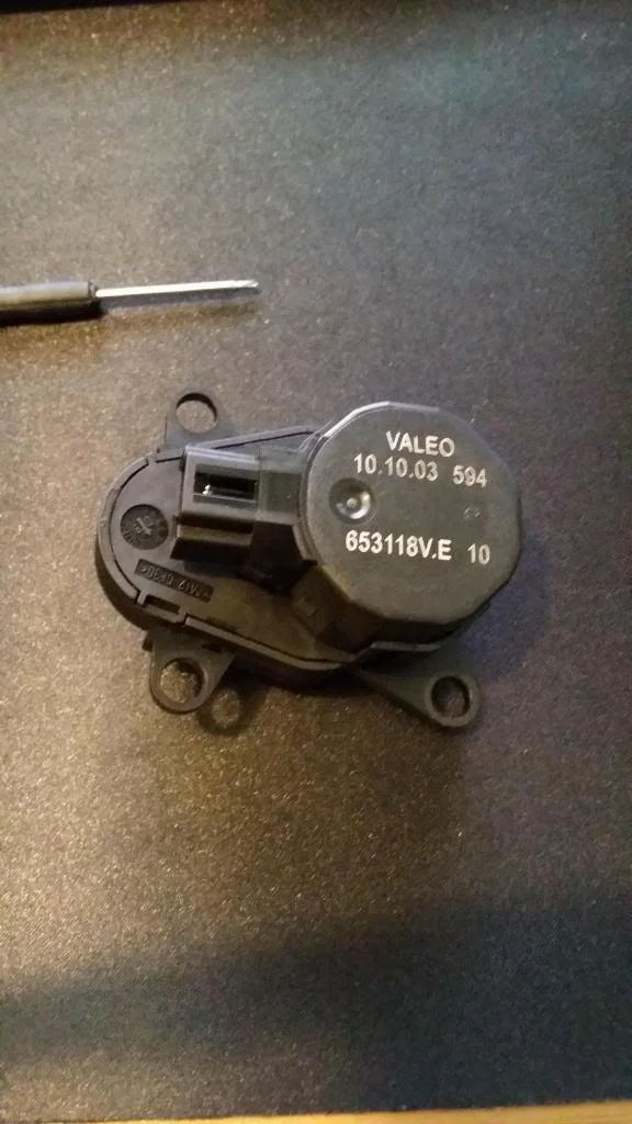

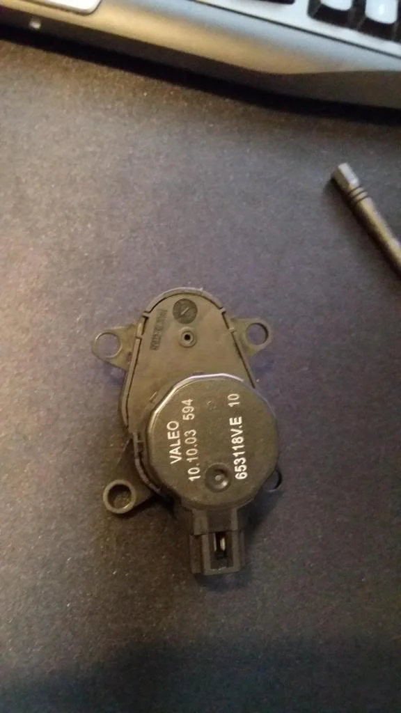

After looking at some pics online of what these motors should look like i noticed that the Motor was incorrect.. Here are some pics:
What it should look like:
What it did look like:

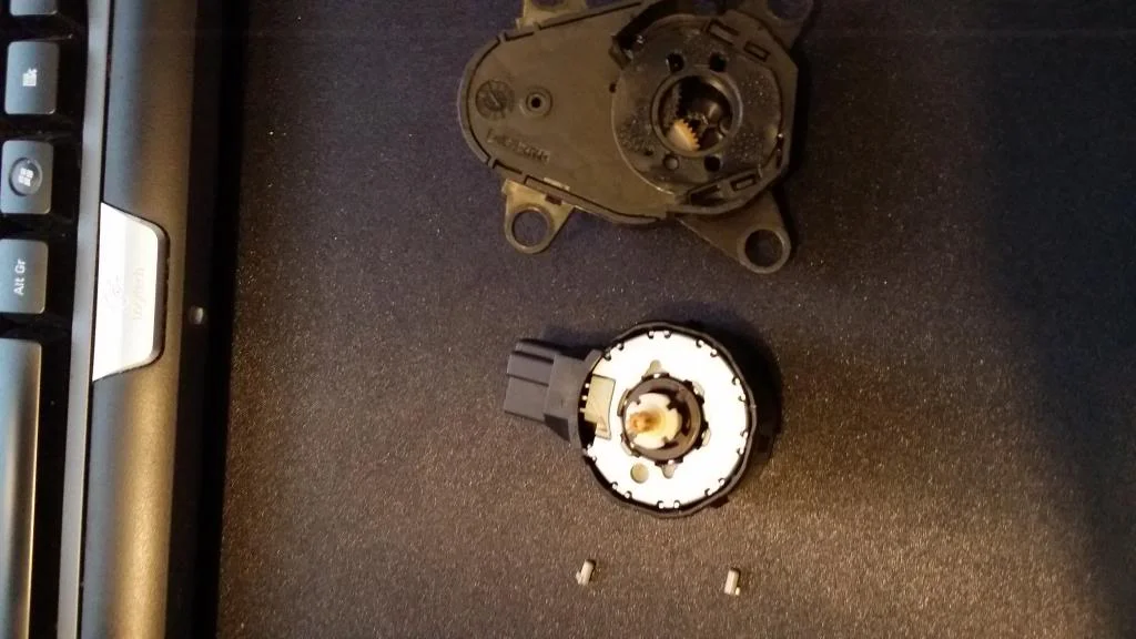

Some broken bits:
Those two grey things are supposed to be on the motor to stop it moving from its place... I will be repairing these and putting it back in and hopefully i will have a nice update for you all soon.
Whilst im in there i will add a zip tie to each cog hole to stop any future stripping like others have had.
