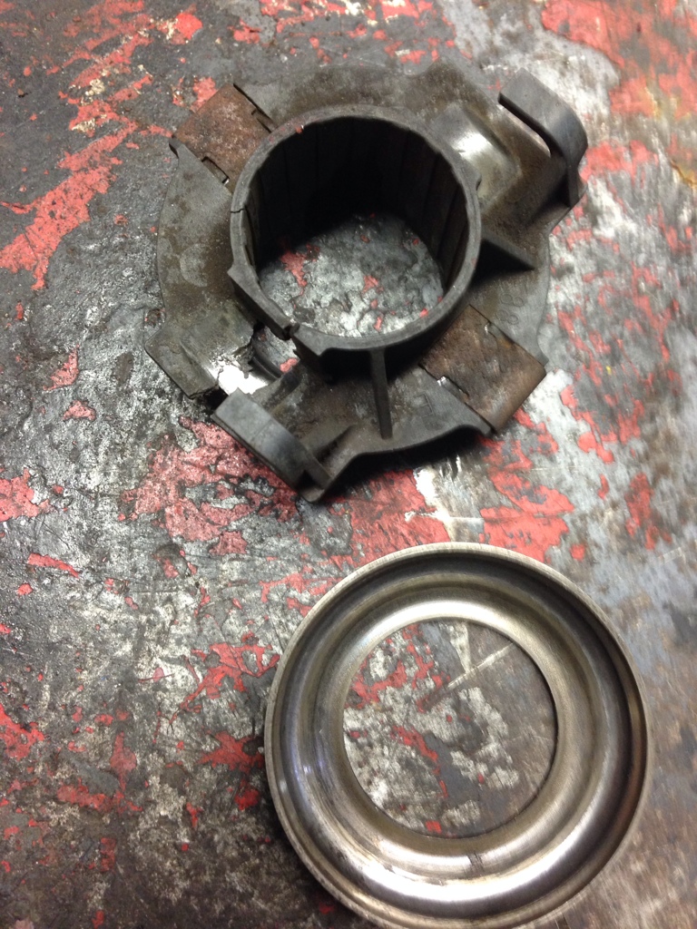

Mileage is 103k but after removing it, it looked like it had been there the life of the car. Didn't have many miles left on it at all. Only reason I replaced it was due to failure of the thrust bearing. Pulled it out and fell to pieces in my hand. I ended up going with a Valeo as that's who makes clutches for Renault and was on offer at ECP for £100.
Thrust bearing .... That should be one piece, all the ball bearing are all over the floor
