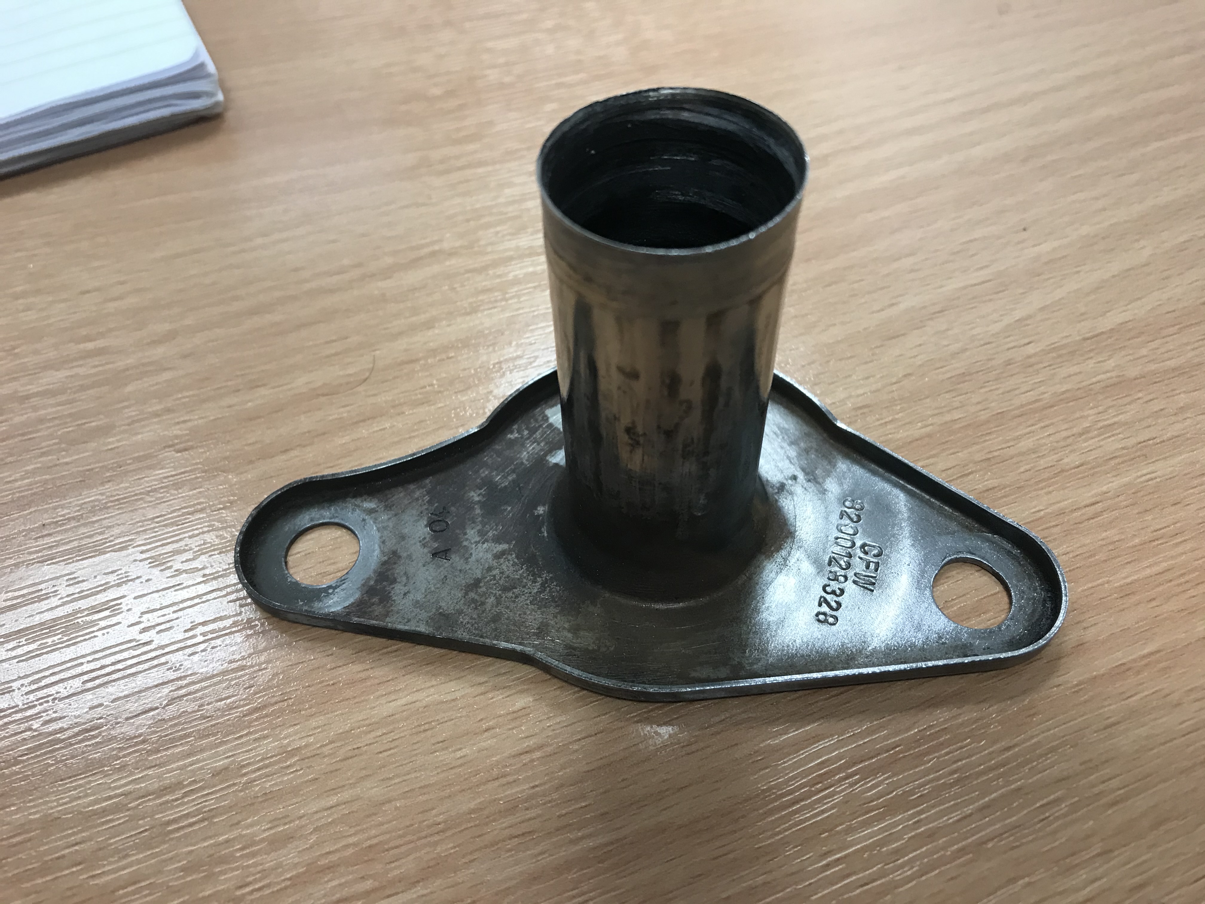

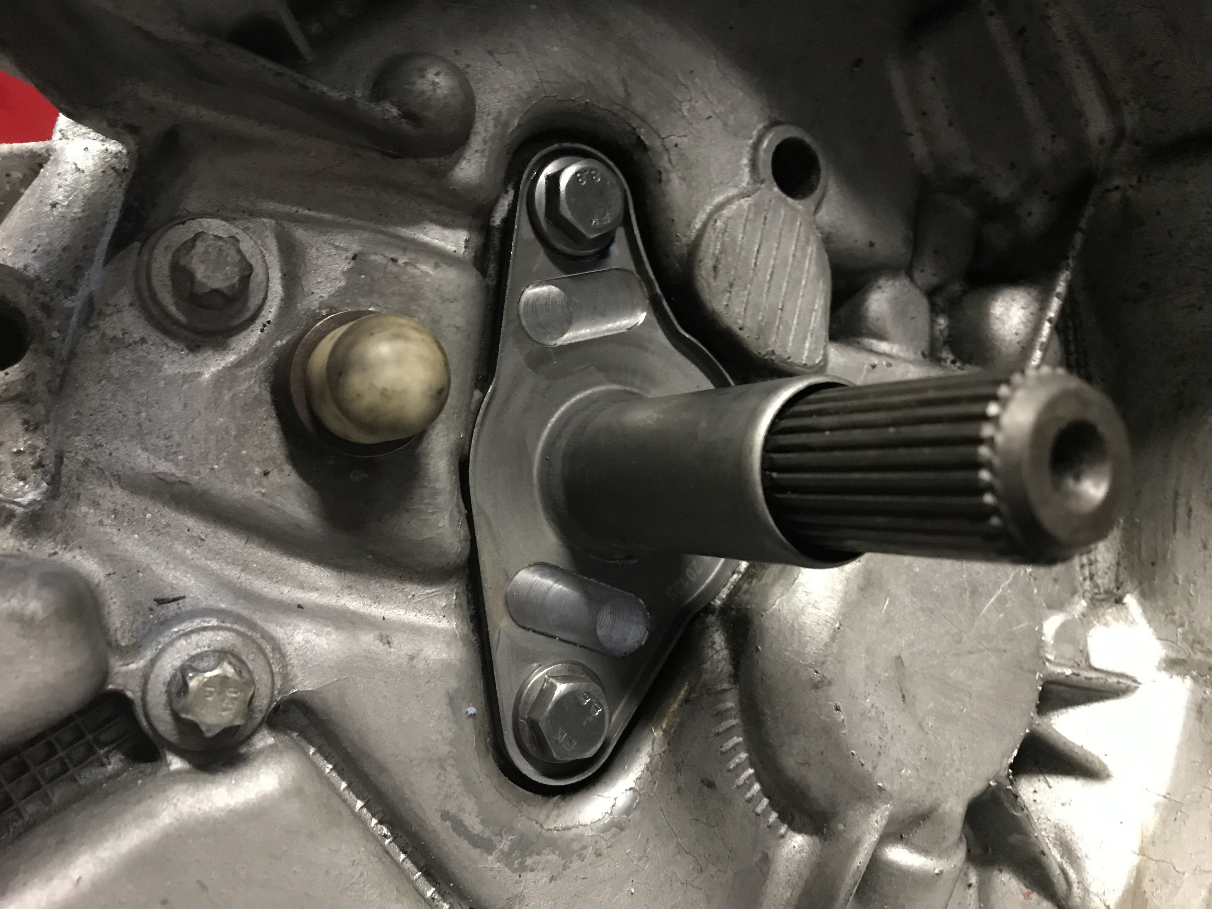

The rattle is wear and tear no doubt. Old cars, poor maintenance, cheap parts, par for the course I’m afraid.
The clutch guide tubes get very worn. Couple that with worn release bearings = rattle.
They can even come loose, although that’s rare.
Sach’s do a decent replacement P/N (8200128328)
The OEM Mfr is Corteco P/N (49376781).
Regarding just getting the bush to test it. I’d just buy the whole kit. Why take any chances if you can’t verify it’s been replaced.
