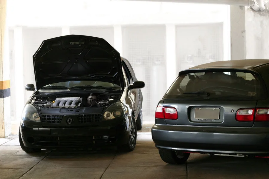

This is one of the only pictures I have of it right now:

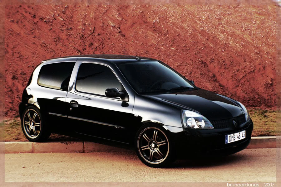

And this is very old, when it still had the 1.0 16v and 5Zigens with R888:
