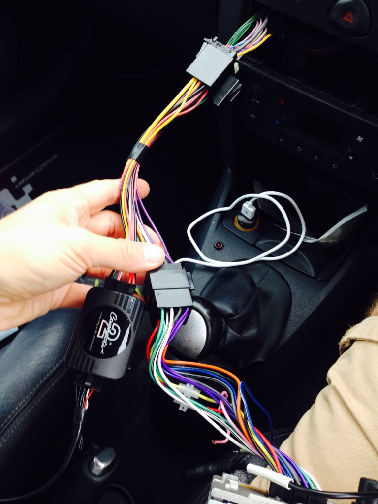

Hi, I bought a connects2 kit from eBay to get my steering wheel controls to work with my Sony MeX bt3900u head unit.
The instructions say to connect in this order
1) car
2) connects 2 harness
3) aftermarket harness
4) head unit
I have done this and also connected the little box which has a phono connection at the end. I'm not sure what purpose this has as I would not use a phono input.
The steering controls don't work.
I don't think it's possible to put the leads in a different order.
Any ideas welcome please?

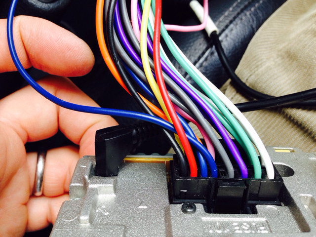

Bottom right on back of hu is a blue socket - plug your patch lead into this :

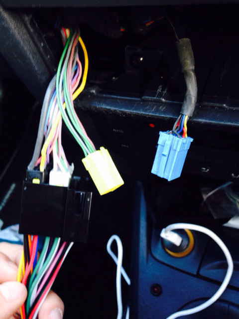

I was pleased to see your reply and tried it but no luck.
Should the yellow or the blue connector go in? One is for the CD player and one the stalk controls.
I tried both but neither work. I know the controls do work as I bought an old OEM head unit and they work ok.
I also made sure the connector was well seated (the photo makes it look like it is not)
  Clio 182

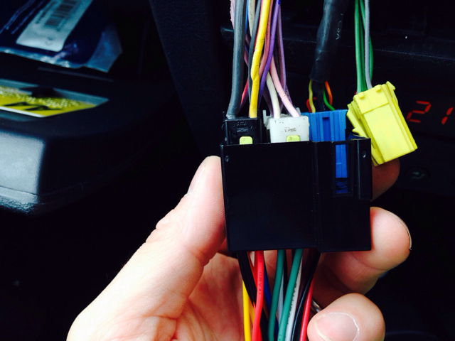

The stalk controls are the yellow block, (in simple terms) in your pic you can see a longer plastic lug this should be facing to the outside of the black plastic block,
To check:
1. Check that all the pins line up and enter into the yellow plug
2. Is this the connects2 'ctsonylead' you are using? Ive seen loads of people try using an autoleads patch lead with connects2 and this doesnt work
3. Try unplugging everything - remove facia from stereo then plug back in and ignition on (dont plug stalk into radio at this point) then re-attach facia and check that the stereo has been reset, then turn off ignition and wait for 3 beeps, then plug in stalk cable (into blue 3.5mm socket on stereo), then ignition back on,
4. If this doesnt work - try ordering replacement patchlead - if that fails try replacement stalk control - connects2 customer service are great at exchanging from my experience (used to work at halfords :p)
Apologies for lack of punctuation/ sentences - on taptalk on iphone so just type away ;)
  Clio 182
(Also) you need to plug the yellow into the opposite side to where the blue is - as the side its plugged into is unpopulated
