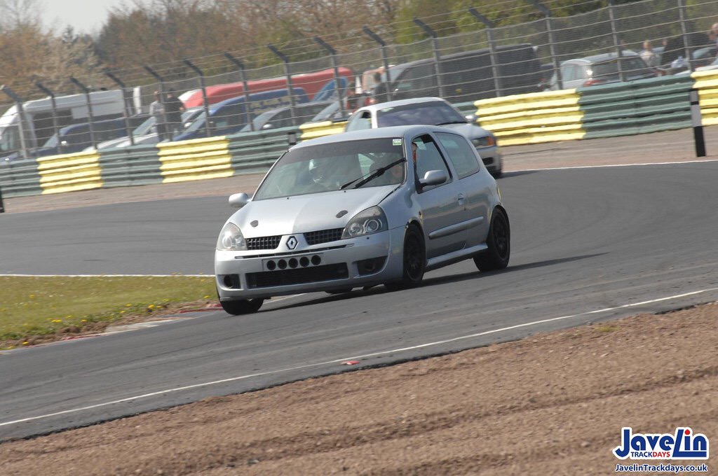

I recently did a track day at Croft, the car performed pretty good to until around 4pm when the brake pedal went solid at the end of the straight causing next to no braking and the car ending up in the gravel. Before that the brakes had been working great with no fade. The fluid level was also fine and the pads have plenty of life left.
