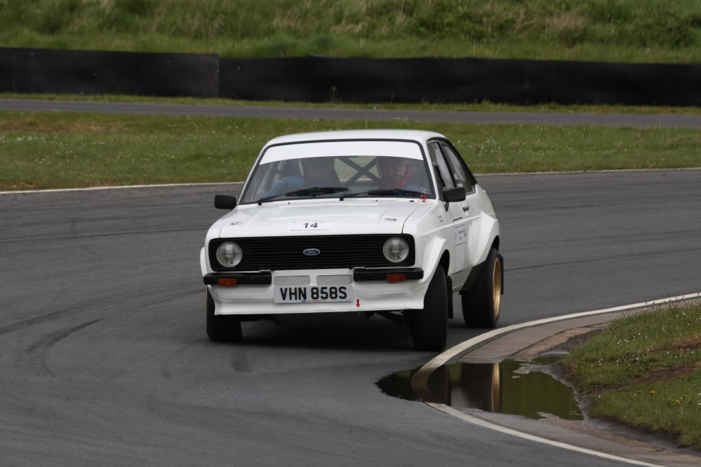

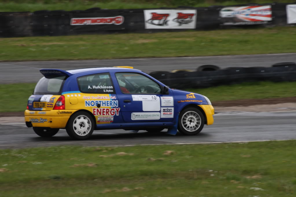

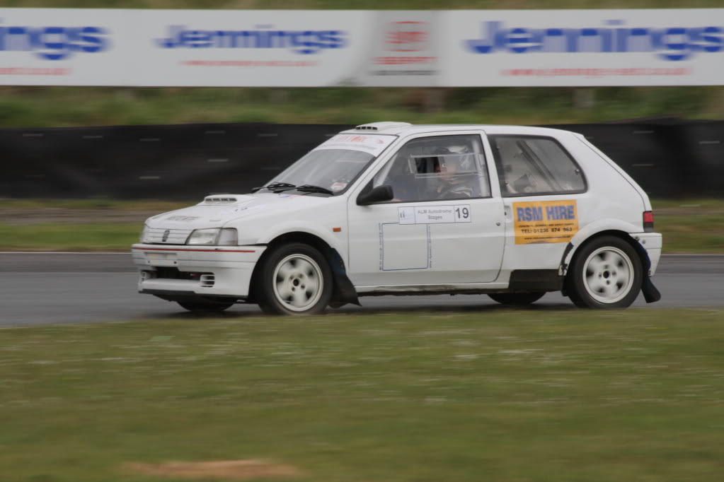

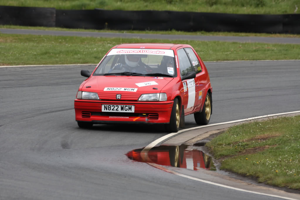

Went down to Teesside Autodrome today to get a bit of practice panning before I go to the F1 in June. With the camera set to auto focus and in AI servo mode they still seem to be out of focus. Not really sure where I'm going wrong or is it just practice?

Nothing horrifically wrong with these.
The top image is 1/100 which is much slower than i would expect to get consistent results. try 1/250 or 1/200 to start with.
Make sure you have 1 AF point set, as opposed to a group of them, otherwise it could be focusing on the back of the car or a tree in a back ground etc....
Once you have selected this AF point as the car comes to the corner, take the first stage of the shutter release (so the camera is auto focusing on the car) get the AF point (which should now be lit up red) on a certain point in the car (if your doing a perfectly side on pan, which is the easiest) then hold the AF point on the door handle or something. Take a burst of shots whilst trying very hard to keep this AF point constantly on the door handle. This makes sure that your panning at the right speed, even if only 1 out of 5 images is correct.
Also use shutter priority not aperture. and for stationary or head on use 1/320.
And i notice your using single shots, i would use High speed multi.
Thats my 2p's worth.

Good advice tbh.
As said, up the shutter speed until you nail the technique. Good work though.
The only thing that will help with panning (assuming you have the camera set up for it) is PRACTICE. Thats the only way you will start to get better results at lower speeds.
I remember when I started out I couldnt go below 150th(ish). Now im pretty consistent at 1/60th, but anything below that is getting a bit hit and miss. And then the fun begins at 1/30th and below!

Nick has covered everything, but the images you've posted actually look ok for the most part. Take the first one for example, the middle of the car is nice and sharp so technique seems fine, a faster shutter speed will bring more of the car into 'focus' for those types of shot where the car isn't running parallel to you.
For 3/4 panning, 1/200 is pretty much reaching the limits of keeping the whole car sharp, for side-on panning, it's pretty much as low as you can physically manage.
